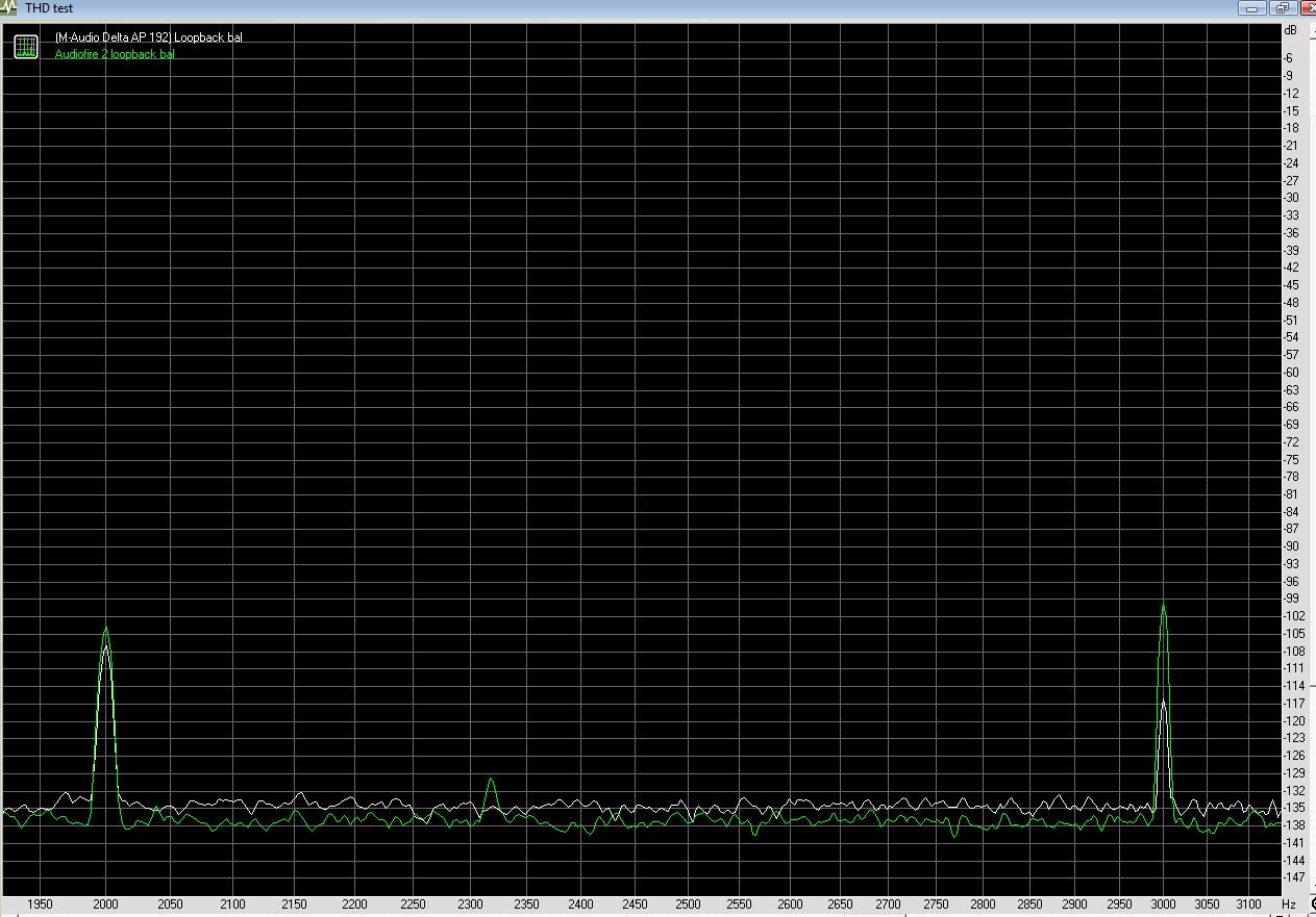

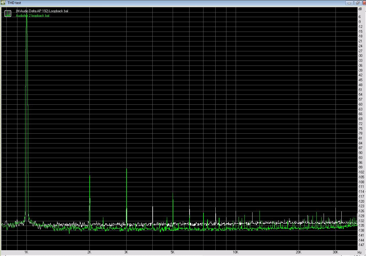

One other offer I'll make to you- I remembered that I have an Echo Audiofire 2 external 24/96 DAC, courtesy of FastEddie. I can use that the same way I use the PCI-based M-Audio. I think it's a tossup from a measurements POV. That involves an extra set of analog stages (the electronic crossover), which is a direction I'm moving away from, but if you are convinced that this is somehow better than using the Behringer, I can certainly do that (while strongly disagreeing with you that this is sonically "better" to me).
The supposedly horrible PC environment is somehow evaded in my cheap HP lab computer. The M-Audio seems to be slightly better than the Echo, but they're both absolutely fine from a measurement standpoint.
