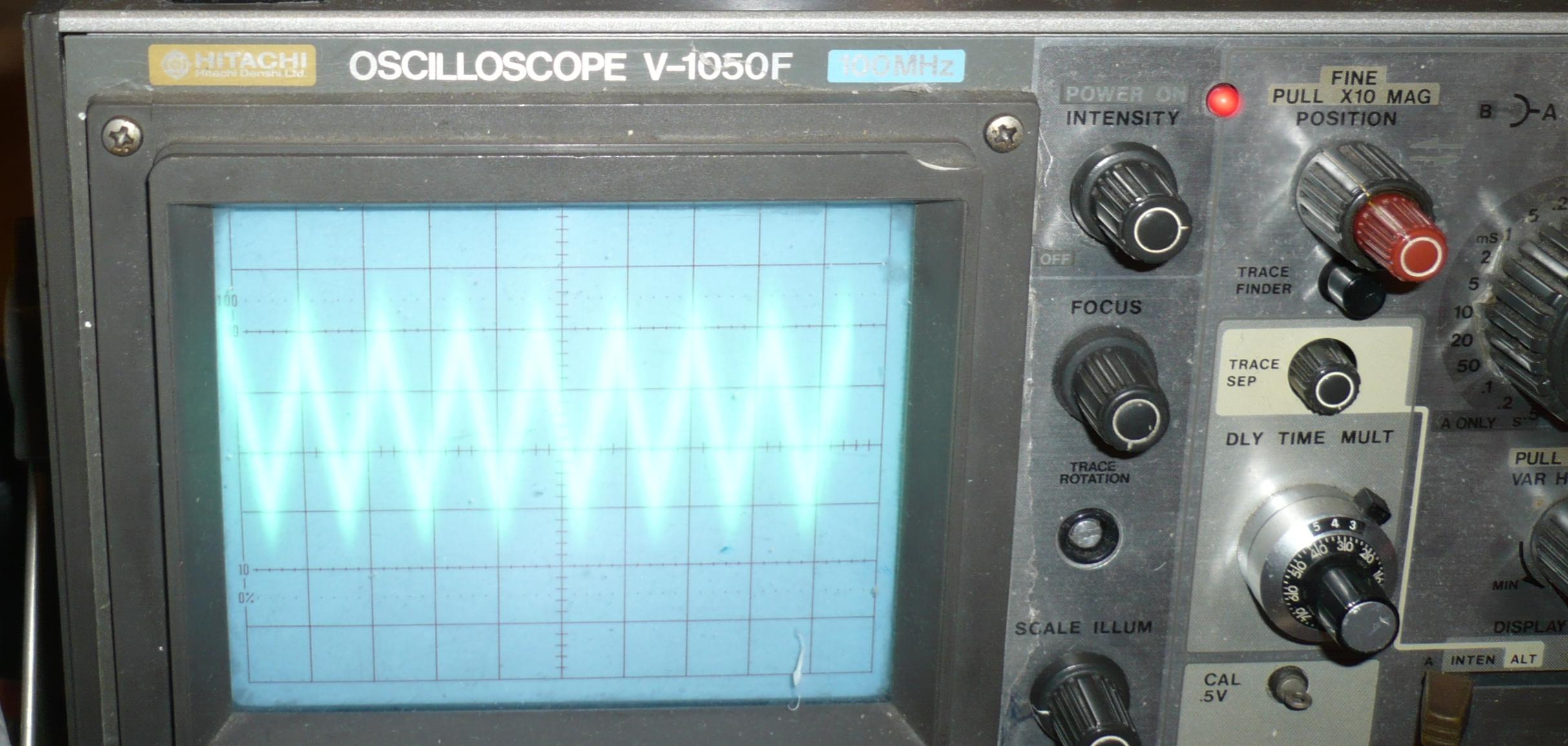

~1.5MHz.. also I was thinking of that.
The spdif bit rate at 44.1khz is 2.8224 MHz. Half of it is 1.4112 MHz, and that is the strongest frequency line if you look at an SPDIF data stream on a spectrum analyzer.
So probably this is the jitter caused by clocking out the data..
The tall line at the bottom of the spectrum is the ~80kHz power supply noise.
Thanks George,
Following on from my previous PS scope shot, here's one so far unseen - this is based on removing the 5V USB supply & replacing with a 5V battery as well as powering the laptop with a bench supply (the previous shot was using a Dell Inspiron laptop powered by it's PS brick & the 5V being supplied from USB). Sorry for the quality
