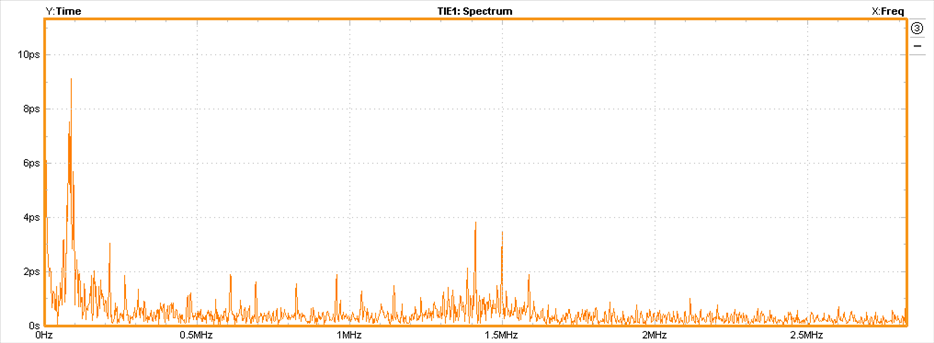

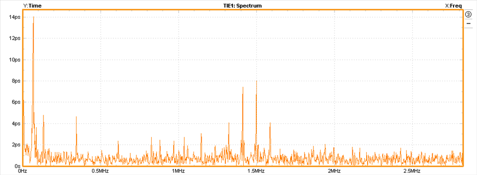

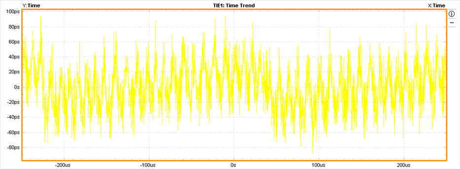

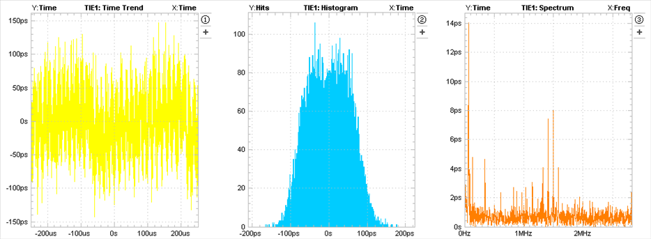

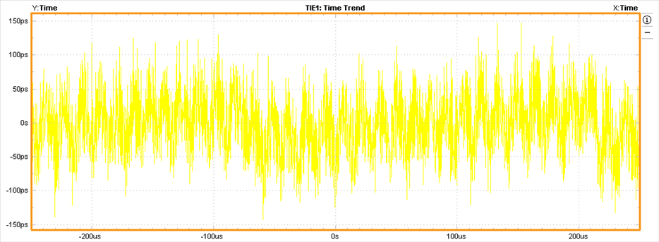

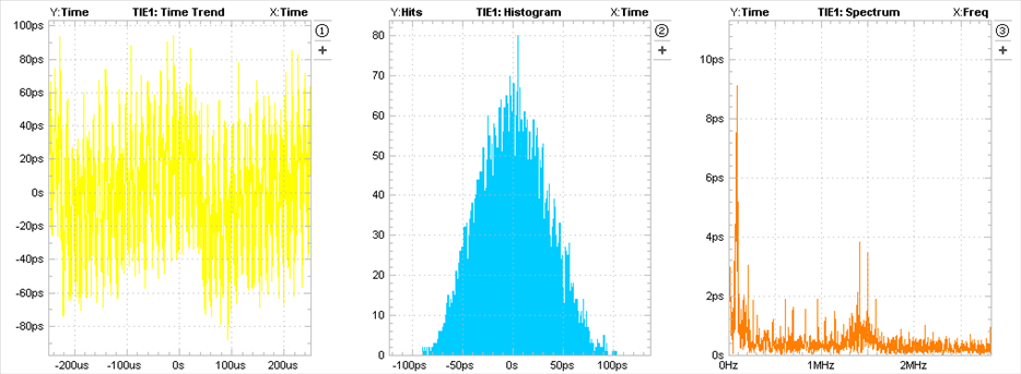

I mean I can take a scope and look at the output from two different CD-Players and pronounce "they look the same". Of course, I would have perfectly wasted my time.

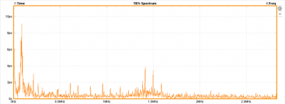

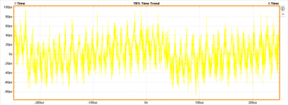

Nice! I have done just that, on a recent unit of a stock Hiface, and the result is:
Of which the most educating is the TIE trend trace and the phase noise plot, here zoomed in:
It's educating, for me, because the TIE trend trace is almost an exact copy of the Hiface clock power supply scope trace posted earlier by Jkeny.. The same 80 khz modulation pops up also here, plus some more low freq periodicity.
Nice plots! What 'scope you got? Looks like I need one.
BTW, Sy and myself where refering to looking at the analogue output from a DAC following the HiFace. In Sy's case the DAC being a Behringer DCX2496 DSP based crossover with a nice Cirrus Logic ASRC on the input to propperly louse things up for good measure.
Ciao T
A TEK 7354. 35 000 Euro, in case You wanted to ask... Stock, without the jitter analysis package. That can cost another 10000 in a worst case..
Short of the story: recently we had been looking for candidates for a possible investment, at my job, not me, naturally!
So I had tested some middle-heavy weight modern beasts - was a joyride.. The most beautiful one was a LEcroy WavePro 760.
6 Ghz/ 40Gsps. Though today it is "low end", their top one is 45GHz/ 120Gsps..
We had concluded that Lecroy is having really interesting offers, - very strange, normally I would have never thought of voting against a Tek scope..
The sad side of the story is that the fun had finished there - now will have to wait until the order arrives. That is, no more tests for the moment.
Thorsten - yes, I had followed the thread, and know what are You talking about.
Also what Sy is talking about. That is why I wanted to post these few shots, to show that "at the source", at the input of his DAC providing his results, there are real differences in the incoming SPDIF data.
And this thread is about characterization of the SPDIF transmitter unit, that is, the resulting SPDIF stream, not the DAC output.
One can just not guess what will be connected to this stream.
If somebody is interested, I'm more than willing to explain more about these graphs. It's fun to see easily all the up to now "suspected" effects - being just that, effects existing really..
