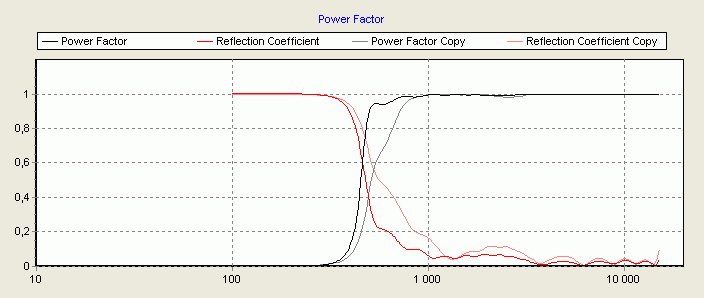

I'm the guilty party here, so I might as well answer. Neither Gary, John Atwood, nor I have warmed up to the sound of small-format compression drivers, but we both like the relaxed and effortless sound of the large-format mids. We've also fiddled and had good results with supertweeters, so the HF rolloff and beaming of large-format is not an issue. What has been an issue is the sound of the horns themselves - Gary is a classical musician and former eXemplar owner - he liked the bass, the highs not so much. Same here.
There's a four-way wrangle between the proponents of conicals (Bill Woods, Jonathan Weiss), OS waveguide (Dr. Geddes), LeCleac'h, and the Altec and JBL traditionalists. I'm not going there - there's models, simulations, measurements, and subjective experiences to support each camp. The argument over horn profiles will probably continue forever.
I've liked the sound of the LeCleac'h horns I've heard here in Colorado, and contacted Martin Seddon in Australia about commissioning a special version optimized for the 288. The AH425 is designed from the latest LeCleac'h spreadsheet that uses the internal flare of the compression driver (8 degrees for the 288) as a starting point for the horn expansion.
The size (and LF cutoff) is limited by the largest size that would fit in an AusPost box - sounds stupid, I know, but the difference between AusPost and FedEx/UPS is the difference between US$90 shipping for two horns and US$600 shipping for two horns. Since a pair of AH425's are quite reasonably priced at about US$500~600 (depending on exchange rate), yes, that makes a difference. Just a little bigger has the practical effect of doubling the price. I'm OK with Martin or Bill Woods getting paid for the great work they do, but the idea of half the cost going to FedEx or UPS box-smashers is less appealing. (AusPost did a great job, by the way - they travelled all the way from Perth to Colorado and arrived in perfect condition. I wish all my Internet purchases arrived in such good shape.)
I use the feeble rationalization that Newell and Holland (page 108) recommend a horn no longer than 12 inches to minimize coloration. This is a pitiful ex-post-facto justification of the AusPost size limit, but I'm sticking with it.
Bjorn Kolbrek has kindly done extensive BEM modeling of the various size and T ratios that I was suggesting to Martin in the early phases of the project. We reached a consensus around a 425 Hz cutoff, a T ratio of 0.707, and the aforementioned internal 8-degree flare of the 288 compression driver. Bjorn's data shows flat acoustical impedance and group delay down to 550 Hz, so a 800-900 Hz crossover should be extremely conservative, considering the midband headroom of large-format drivers. The modeling also shows nothing like constant directivity, with beaming similar to 3" or so direct-radiator.
Once again, I take refuge in Newell and Holland, with a quote from Page 112 (emphasis in second paragraph added):
When mouths are designed from the requirements of associated components and directivity control only, the acoustic termination to the outside air is often very poor. This gives rise to strong reflexions from the mouths, which in turn gives rise to the roller-coaster impedance plots typical of so many of the horns in Figure 4.11.
Conversely, the AX2 was designed to minimise the impedance irregularities, which was clearly successful (Sample 8 in Fig. 4.11) but the size and directivity were the natural result of the design, and could not be controlled. Larger mouths could be smooth down to lower frequencies, but could give rise to difficulties in closely locating the adjacent drivers at crossover points. The practice of mounting high frequency horns and/or drivers on the central axis of the larger horn may ruin the mouth termination of the latter. The AX2 just about defines the practical limit for a MF/HF horn if the highest audio quality is the sole aim.
Ahem. I'm hardly working on the level of Dr. Holland, but I'm willing to borrow the discoveries of others if it suits my goals, which in this case was the smoothest possible acoustical impedance across the working range. The graph from Bjorn Kolbrek shows an intermediate stage of the AH425 design, comparing the acoustical impedance of two LeCleac'h versions - the darker lines are for a T = 0.707 (as used in the production version), and the thinner lines are for an alternative T = 1.34 (closer to a conical expansion). Both are for 425 Hz horns with the Altec 288 8-degree internal flare included.
The red line shows the percentage of acoustic energy reflected from the horn back into the compression driver, and the black line shows the percentage of acoustic energy that makes it from the compression driver into the outside world. This is akin to the SWR of an antenna - obviously, energy that is reflected from the antenna back into the transmitter doesn't do any good, and the same applies to the diaphragm of the compression driver.
The red line is especially significant at higher frequencies - even though the percentage of reflected energy is pretty small at 10% or less, that's 20 dB down - and energy that's reflected back to the diaphragm is likely to end up being re-reflected back into the horn again after bouncing off the diaphragm and rear chamber.
