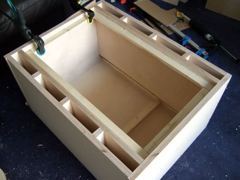

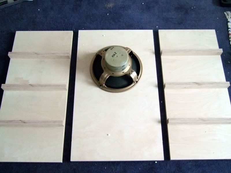

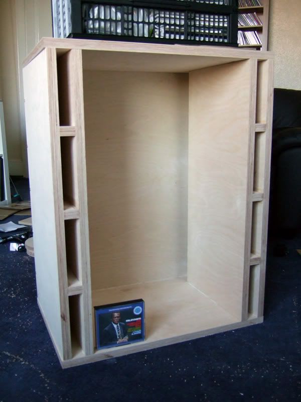

Anyways, been busy with the woodworking the last few days and some progress report.
Side vents glued on.

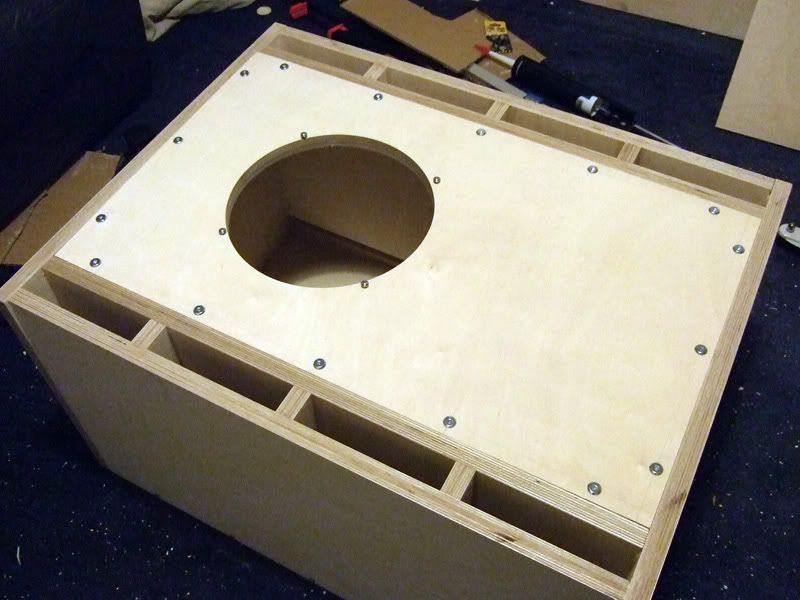

Bottom, back and sides now stuck on. Top has not been fixed yet. Will have to leave overnight now. Decided to glue and screw in the end. Using wood polyurethane glue which is really useful as it also makes a seal. The screws are self-tapping but the way I did was to make the holes first which then acts to align the pieces together.

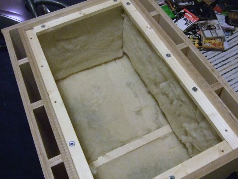

Cleats put in and batten at the rear corners as per the plan. Also some sealant added to some areas where there were gaps. Build wise, they are not millimetre perfect but the dimensions are correct and the joints are sturdy so I am quite happy.
Almost there... front fits like a glove. Bolts screwed in with pronged nuts on the batten.

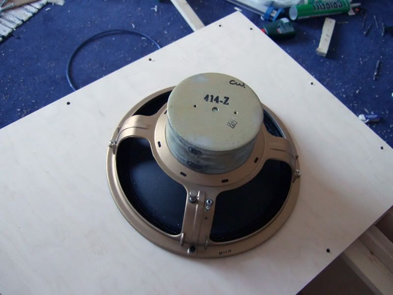

Altec 414Z Bass (Alnico)
Just need to wait for the lambswool wadding now.

I'm using the 414Z and just used the Petite Onken. I'm not really technical minded so just went ahead and built according to the diagram. Very difficult to give listening impressions as I've only got one side built and no wadding. I was tempted enough to give it a listen but to be honest it sounded pretty awful so I don't really want to pass judgement yet before it's finished. My wadding should arrive sometime during the week so hopefully I should be able to post some constructive thoughts after that.
FWIW, I couldn't get the Petite Onkens to fit onto 2 8*4 sheets. I actually gave the measurements to AvonPlywood and they did a great job cutting it for me... down to the milimeter. I can wholeheatedly recommend them. I think they would be rather surprised if another person came along asking for the same thing! I did get some funny looks when I told them what it was for 🙂

Sorry for the long absence but sometimes things get in the way (like work!). Also, I've managed to crack the frame on the 414Z when I screwed it on too tight... that put me off for a while until I found another pair. So been busying away, and now both speakers are complete. They have been lined with Visaton lambswool, roughly 1cm thick.
Lots of hard work, sweat (and swearing) been put into these...
Admittedly, they sound amazing. I know I was initially a little reserved but now that the wool lining has gone in and both speakers completed, the sound is simply sublime. The Altec 414 in Onken has to be commended. The mid has good tone and the bass is fast and taut. A well balance speaker, and actually more of a low mid/upper bass than a woofer. It does go low enough for me though. Coupled with the Onken compression driver and LeCleach, it gives excellent dynamics, hair-raising clarity and insight to the music. To say that I am impressed (and slightly surprised) is an understatement.
