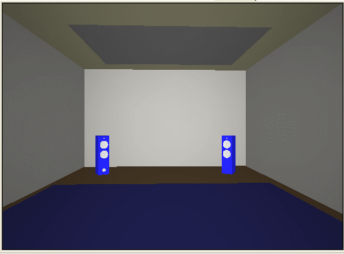

I thought this worth pursuing, to see if my CARA software would simulate a different vent position (it should).
And it does! See image below for an idea of the room and speakers. You will see the dual woofer floor-standers. The left speaker has the vent near the bottom on the front, the right has the vent on the back near the top (you can't see it).
In simulations of the room, there is a noticable difference at many frequencies. I can post captures of the sims, if anyone cares to see them.
So maybe this distributed port thing is what is going on. Very interesting.......

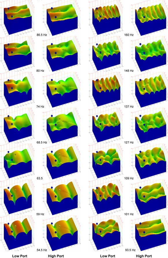

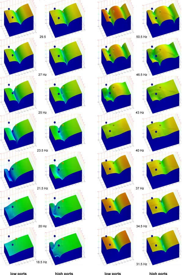

I did the port position simulations - that ws the easy part. Getting them into a format that was meaningful and web friendly was not!
So I settled for 2 strips of graphs that show the SPL at 28 different frequencies from 18 to 160 Hz. The 2 different port postions are shown side by side. The speakers with the port on the bottom is shown on the left - speaker with the port on the top rear is shown on right.
The speakers were placed in what the CARA software found to be the best postion in this room given the restrictions of eqaul distance from back and side walls and pointing at the listener. Both sims (hi & lo ports) have the speakers in the same place.
Here is strip 1.
edit: The speakers are under the blue pins. Listener under the yellow pin.
(you can see both together and larger here🙂
http://www.dactransformations.com/ports/
and the second half of the series is below.
These look like wasves in the roon, but they are not. It's just a 3D view of sound levels at a given frequency. It could be done in 2D, but the 3D is more dramatic.
You can see the the bass levels are higher at a number of frequencies with the low ports (more red).
Other than that, draw your own conclusions.
(you can see both together and larger here)

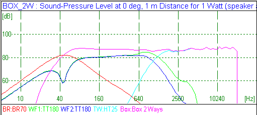

Here is the spl graph for the drivers and port that CARA used to calculate to SPLs in the room. Port is 70mm round.
The room is a bit too live in the low end, it would be boomy. CARA simulated 5 reflections for each ray, the default amount.

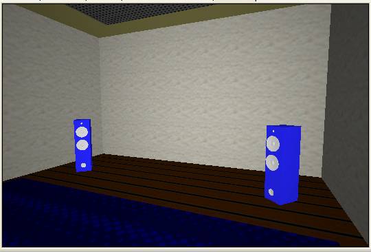

And finally this is the end of the room with the speakers.
Shown are the low port version. Speakers are 80cm tall.
High port version is the same, but port is in on the back behind the tweeter.

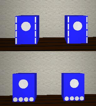

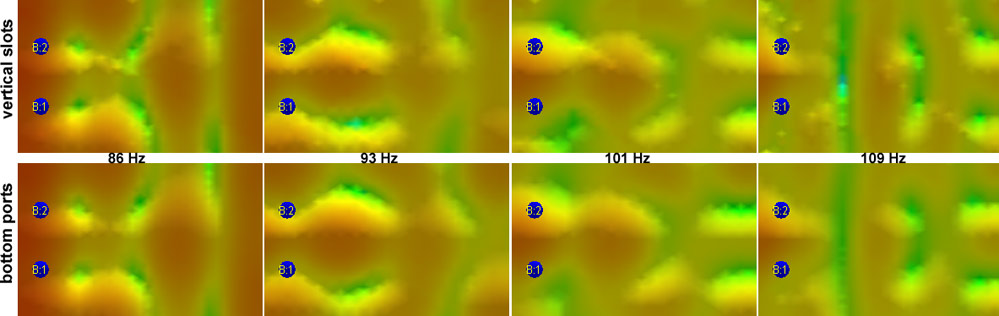

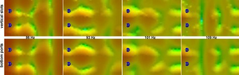

Hi IP,
The calcs are done in 3D throughout the whole room, but shown for a 1 meter hight - ear level. Aprox. 1000 points at calculated across the room at ear hight. All that can be changed in the software - those are just the defautls.
I did build a model of the "Petit Onken" for the 12" Altec.
And a version with 6 rounds vents across the bottom - same surface area as the Onken slots. The in room response does look smoother for the veritcal Onken slots, but the difference isn't huge. I'll try to get the results in a usable format and post them.

Hey, Panomaniac, those plots are very interesting . I went to your link , where the plots are a bit bigger and easier to read .
There are small differences generally, but around 100Hz the differences are quite large . Generally the levels are a bit higher for the lower port, but the nulls are stronger too.
I suppose one low port at front and one high port at rear is as big a difference as you could get, I expect front ports low or high would be slightly more similar . However, having a combination of placements ought to help smooth bass resonse in the room a bit - must be of some benefit .

Hi IP -
Yes, I did change the placement of the port as much as possible to see the difference. Kinda makes me wonder is a low port an high port might not even things out?
As for the Onken, below you will see a sim of the Petit Onken in the same room as the previious sims. This time just 4 frequency slices. There is hardy any difference at all between the vetical slot array of the Onken and the same surface area with round vents at the bottom face.
Yes, there is a but more bass from the botton only ports, but not the dramatic differecne seen in the last sim. Speakers are placed at the blue dots - firing straight into the room.
Caveats: It's only a simulation. SPL is shown at 1M hight in the room - ear level. SPL is calculated from reflections and absorbtion throught the whole room.
Frequency slices may not be fine enough. E.G. there may be a peak we're not seeing between my slices. Have not yet found a way to go to finer frequency slices.
