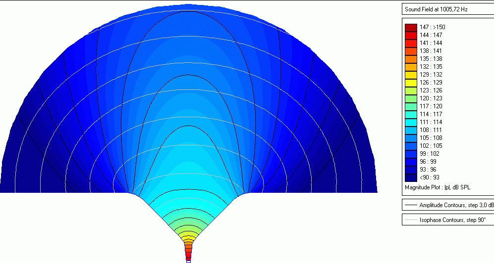

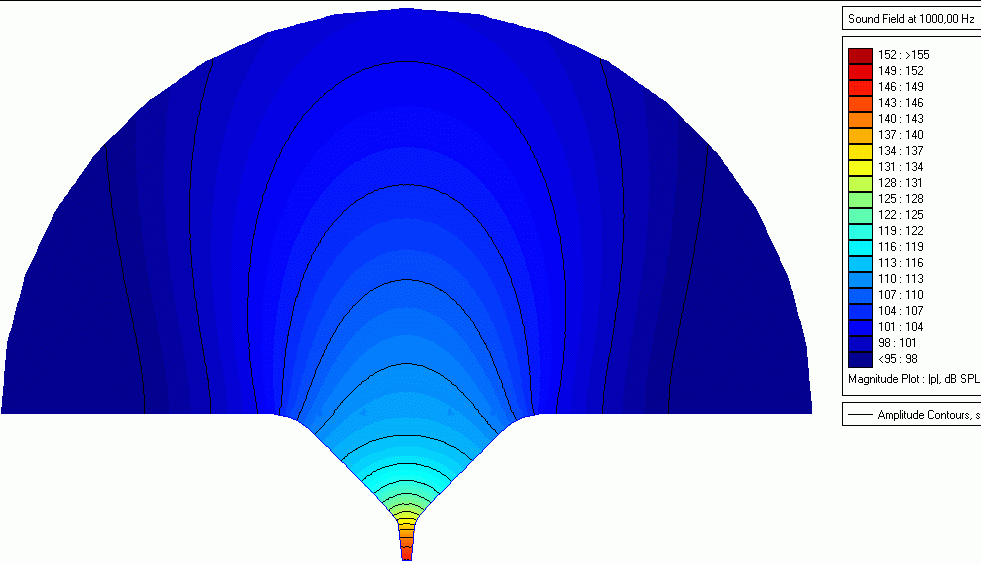

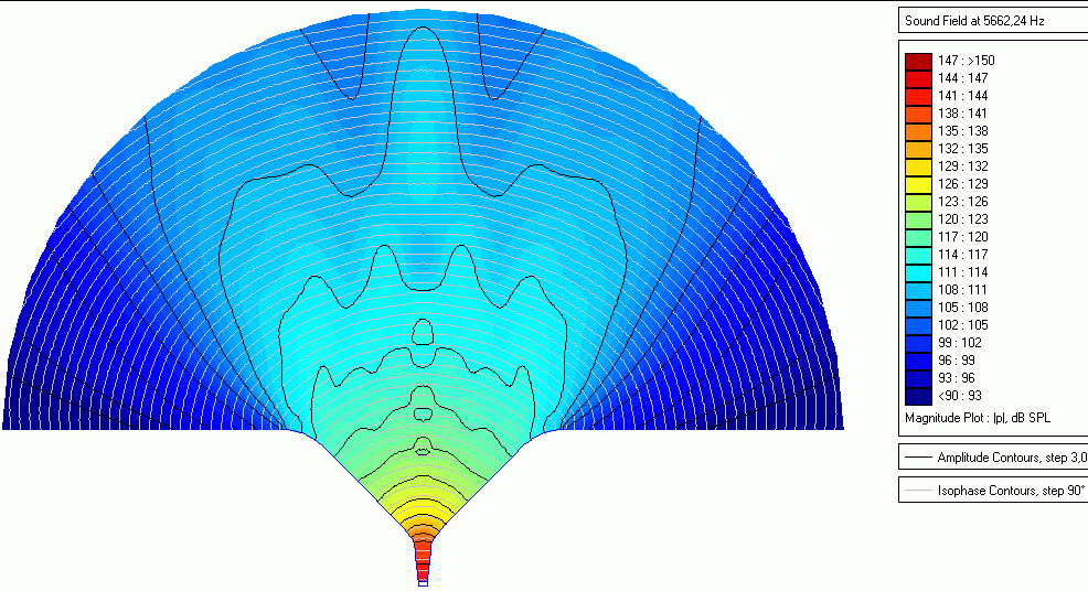

You were asking about polars. Here's the 288+AH425 at 1 kHz, with the black lines representing 3 dB contours.

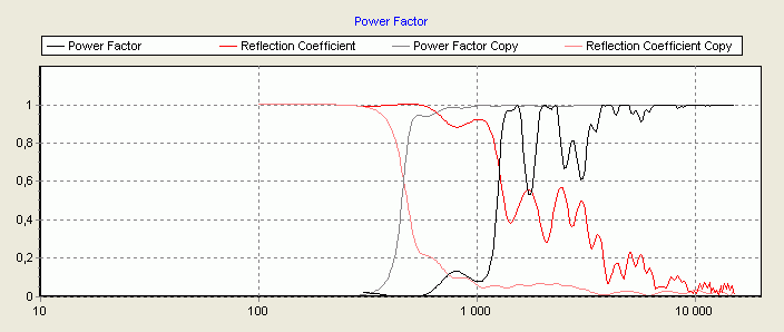

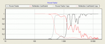

Here's a power factor comparison between the 288+AH425 (thin lines) and an OS waveguide with the simulated DE250 driver (thick lines). All drivers are idealized "perfect" drivers, with the internal throat flare of the driver as part of the horn or waveguide BEM simulation. The phase plugs are NOT part of the simulation, and the drivers are assumed to be free of resonances.
The black line in the power factor is a "bulk" figure; it tells us nothing about where the power is actually going, just that it's leaving the horn and entering the room. It could leave the horn at any angle; this graph doesn't tell us where. The red lines represent the percentage of the energy reflected back into the diaphragm.
The complexity of the preceding figures - all idealized simulations with "perfect" drivers - should give an idea of the complexity of what's going on in the horn, and how FR graphs measured at one location don't tell the whole story. We haven't even looked at the time domain, CSD waterfall plots, headroom, or distortion.
Throw in diaphragm resonances and the complex behavior of phase plugs, and now you get to have real fun. Imagine a different set of CSD waterfall plots for every 7.5 to 10 degrees of emission angle and you start to get an idea of what's really happening in a physical system.

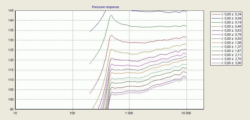

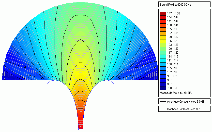

Not done yet; here's the 288+AH425 frequency response at different distances. Again, an idealized "perfect" driver with no resonances, flat power response and no phase plug aberrations. Real drivers aren't this good, thanks to the phase plug and the limitations of physical driver materials.
Based on the data, measuring or equalizing the speaker at 1 meter or less would be a bad idea, but 2 meters or further away starts to appear more uniform and stable. You can also see why I'm contemplating a crossover topology with a series-cap highpass filter followed by a parallel notch filter to get the desired curve on the highpass function, with additional shelf-EQ to taste (this depends on listening angle, etc).

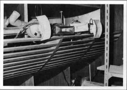

The soft or progessive edge was one of Mr. Iwata's big points. You can see it as progressive slots in the photo of his bass horns below. Oddly enough, he did not seem to use it at higher frequencies.
