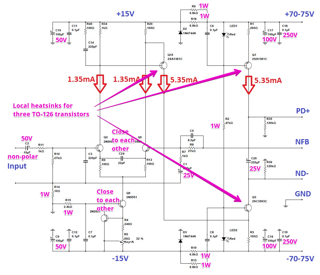

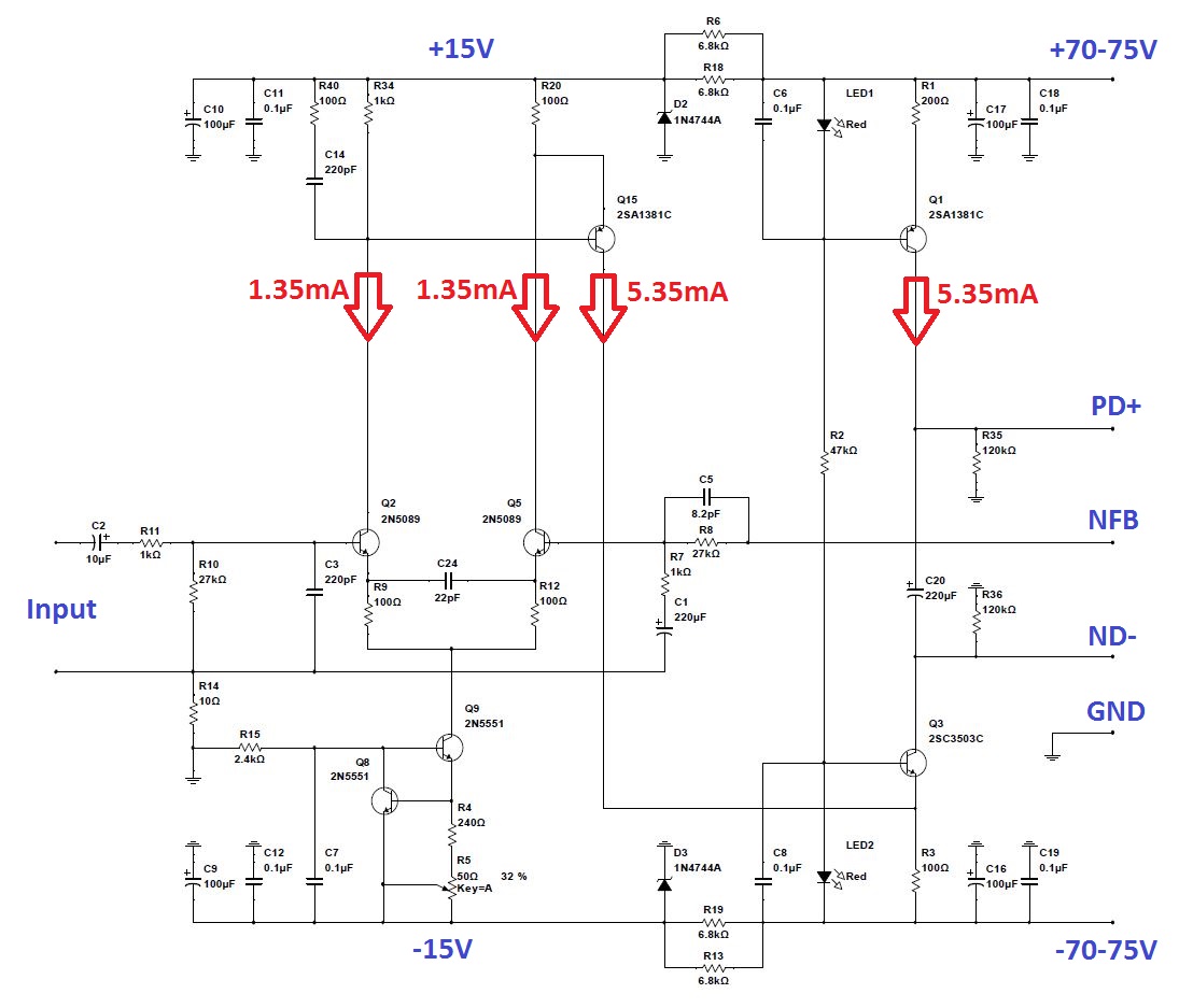

Hello All,
I continued thinking about the ways of making the VAS faster, more linear, keeping it stable at the same time. At some point, an idea came in - why don't I try to arrange the VAS stage in such a way, that it's somewhat "current-driven"? After trying some possible options - attached is what I came up with in the end - see attached.
VAS output is arranged as two current sources, looking at each other. One of them is driven by the current from the single-ended VAS input transistor in a way, that its current is subtracted from the current, set by the bottom CCS's emitter resistor. The structure appears to be extremely linear and stable.

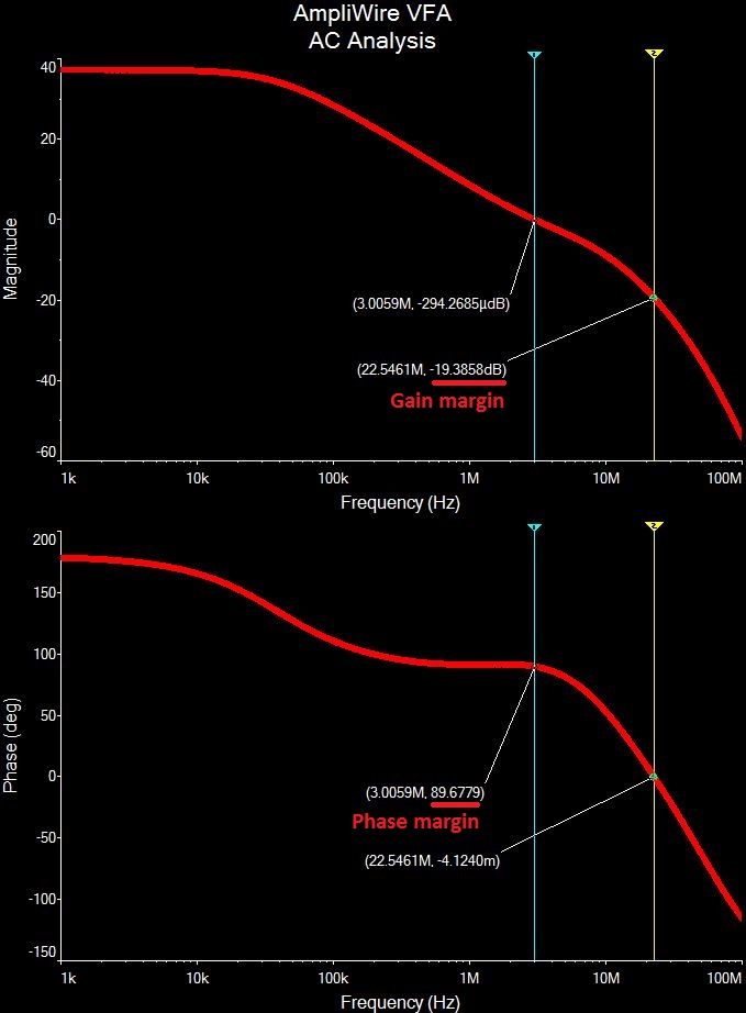

Note - there's no Miller compensation in place. Only RC in LTP and some light lead compensation. See AC analysis - very clean curves, single pole, 89 degrees / 19 db margins. Rather low loop gain.
I have simulated with GNFB loop open. 65 db overall gain, 0.06-0.08% THD throughout the audio range. With the loop closed - gain is 28.5 db, harmonics are below -100db. Clean clipping, symmetric slew, rather fast.
I have tried a number of fully symmetric configurations - driving both output CCSs - but no real benefits. This "pure" configuration is the best so far. Simple and efficient. Well, symmetric ones are good as well, but no justification of almost doubling the components count at the moment.
I suppose, this "current subtraction" approach is going to be useful in CFA front-ends as well. So far, I'm going to prototype and carefully test the one attached. BTW, this topology would be a great basis for a hybrid 😉 So many things to do! 😀
If somebody wants to play with this thing - you're more that welcome 😎
Valery

I have to simulate it, looks as good idea.
Valery your picture are readable finally, not so big as before.
Damir
I can connect traces. Getting the parts in the right locations is what I struggle with.You're getting better at that. This looks like a good one for you to lay out.
You guys seem to do it with ease.
Start with the board outline, screw holes and output connectors first. They have predetermined locations. Then put the parts on as they are in the schematic and connect the dots. You'll see what parts need to move quickly.
I'd be happy to play with it if you want to do a single layer layout. 😀
Terry, I will make it single layer - simple enough 😉
Hope it will fit 3' x 3' inch 🙂
Hi Valery,
As i am workshop forbiden yet for 4 weeks. I can try to layout this during weekend if you want : same form and board layout than other well known IPS (3"x3.937" =>76.2x100mm). Just if you could specify parts voltage rating...
Marc

This is taken from my simulator - it shows schematics pretty well 🙂

Hi Marc,
That would be great. I have marked all the important things (hope so 🙂). All unmarked resistors are normal 1/4W, all small caps are normal ceramics.
250V sort of rating does not mean we expect 250V there - I just would like to have this kind of size / pin spacing for those caps 😉
Please try to keep the input stage compact and make the "star" for the main ground - always good to have. This is going to be a cool one 😀😎
Valery
Are C1 and C20 bipolar electrolytics?
I usually use the normal polar ones - at couple of volts they see as a maximum, it does not really matter. Practical tests show they are ok - no difference.
I guessed right on the resistor wattages. I've got the schematic drawn. I should have a board done later today.
