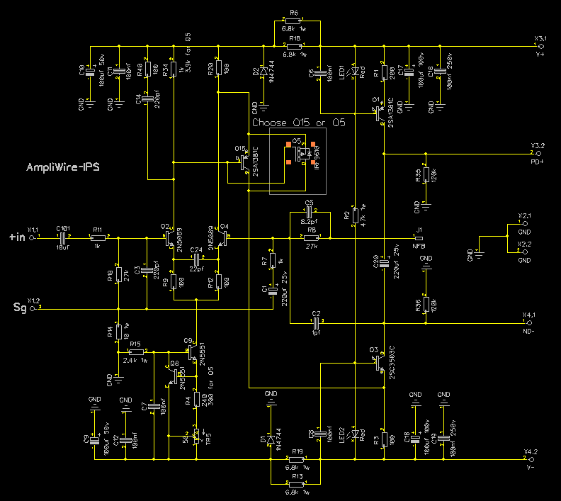

Just tried an interesting option with IRF9610 as a VAS core.
Around 10db higher loop gain, a bit sharper square wave response.
Although - very close to the original version.
It can be built on the same PCB - just the FET needs to be flipped over:
BJT pinout is ECB;
FET pinout is GDS - after flipping over it will be SDG - just what we need.
I have also added an optional C9 (1pF) cap from the VAS output to NFB side input (negative) - it would be good to add it to the PCB for either option.
All the values, different from the original design, are shown in RED. Sorry for an accidental RefDes "renumbering" - this illustration is just to show a few value differences.
Keeping in mind overall simplicity of the design, it would be interesting to see if somebody will notice some audible difference between those BJT/FET VAS options in a proper A/B test 😉

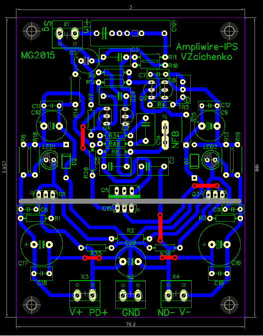

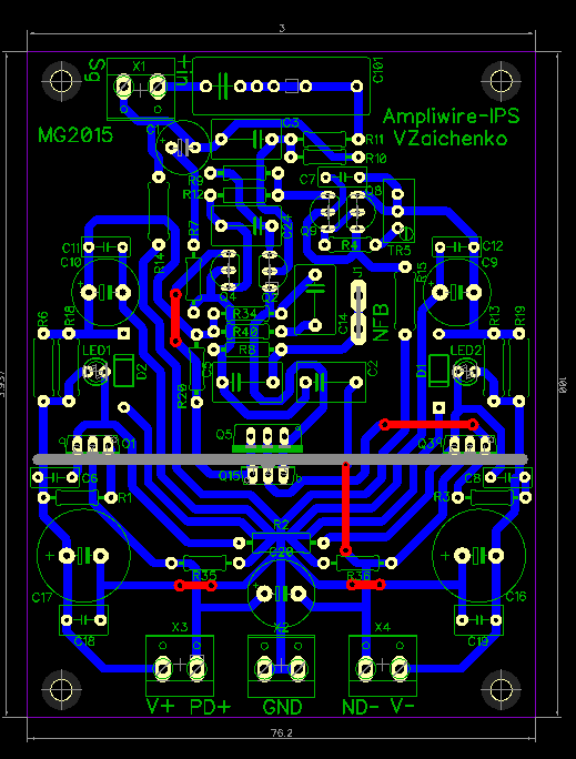

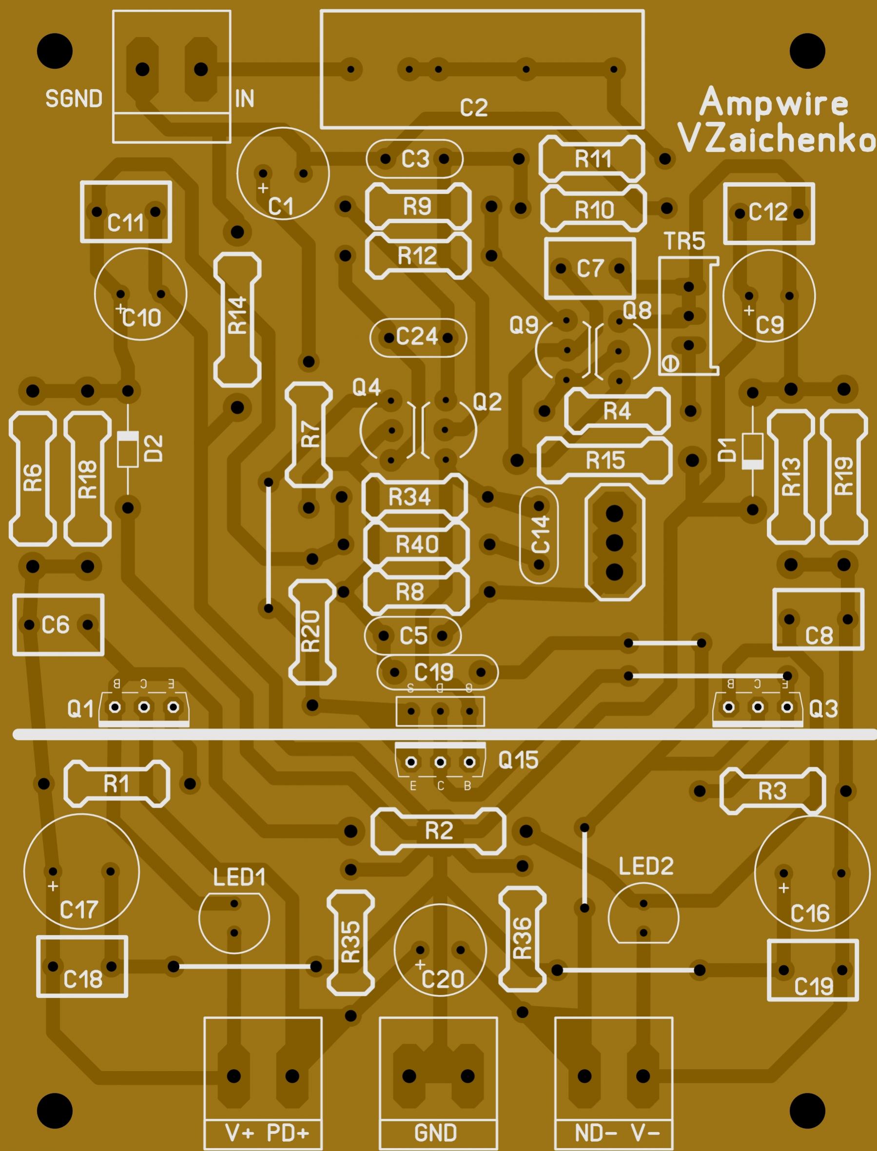

I tried my hand at following Marc's layout in Sprint. I added C19 and a place to use a FET in place of Q15. If youhave a chance would you look it over and see if I have it right?
Thanks, Terry

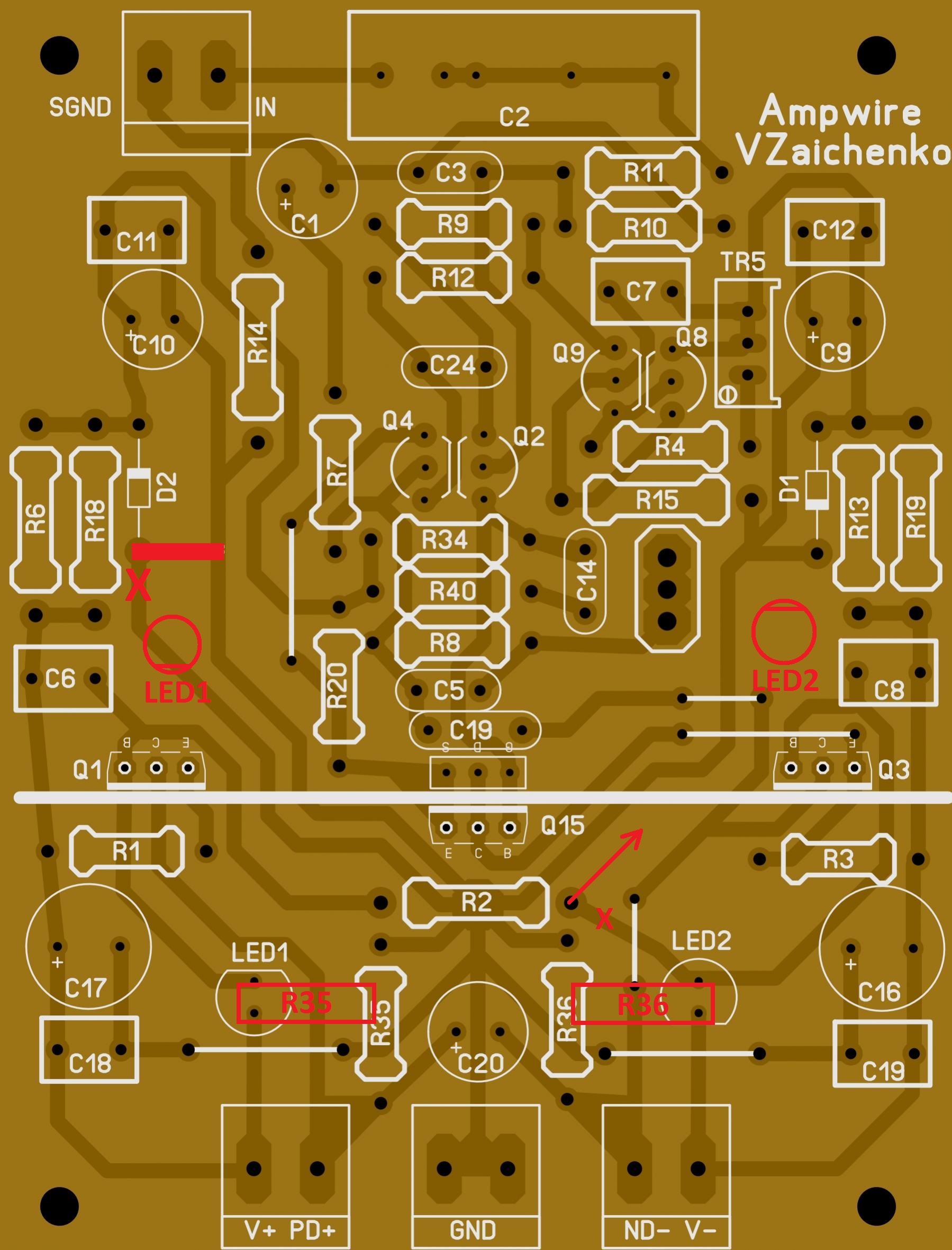

Hi Terry, in this case I would move the LEDs and turn R35, R36 90 degrees, making the bottom area even less "busy" and saving one jumper wire (vertical, near R36). Cool variant :up:

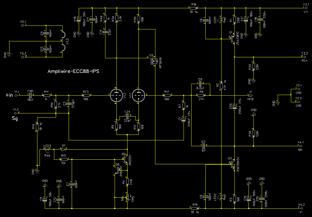

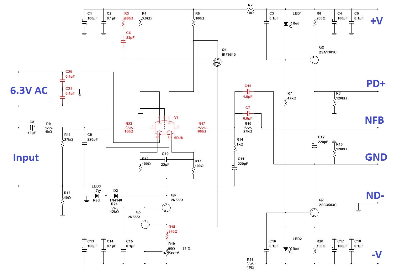

And finally... Tubie
Rather simple hybrid with 6DJ8 tube at the input.

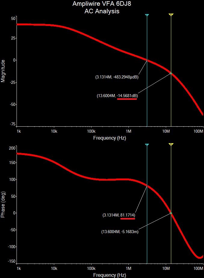

Interesting to hear the prototype. Same high open loop linearity, rather fast.
Which one will show less noise - the one with low noise BJTs or the one with the tube at the input? 😉
It will work fine with the rails from +/-35V to +/-75V (with possible adjustment of R7, R24). 😎
OK, I will stop here 😛 Let's build and see (and hear) 😀
Marc has already got a draft layout for this one as well 😎

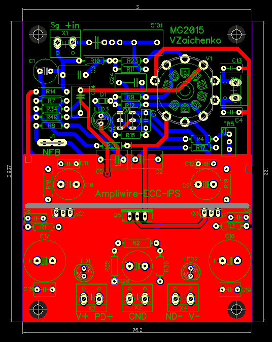

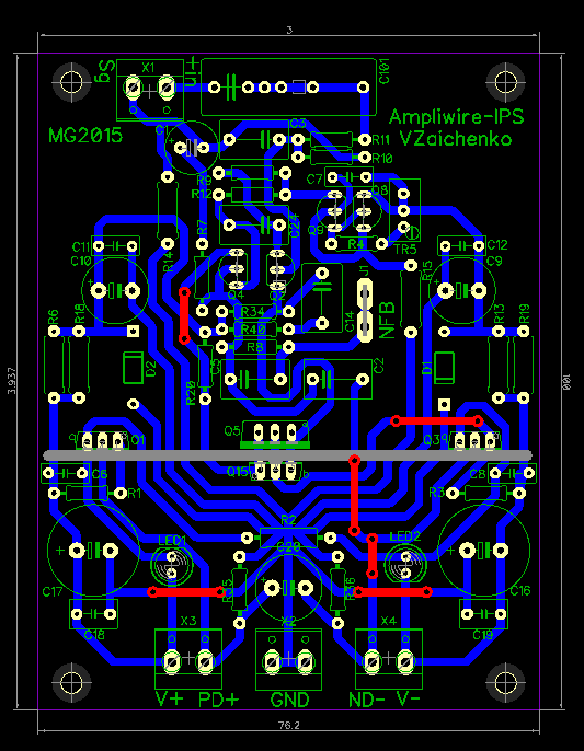

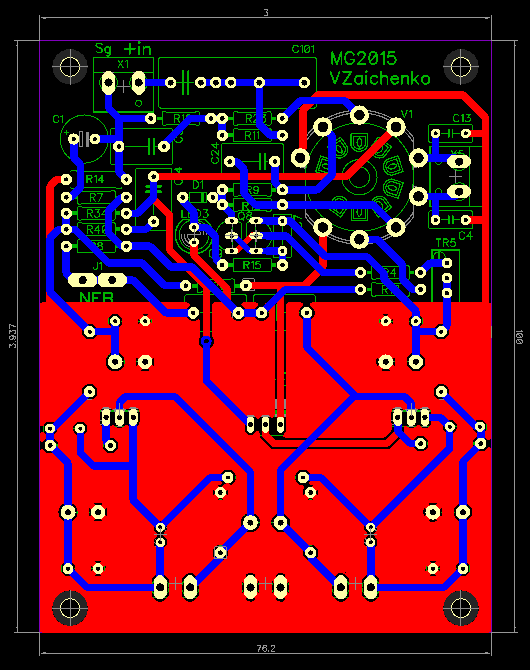

Here it is :
Schematic
top layer
Botton Layer
I will try if i can made one layer PCB...

It's better to bring each part of the circuit back to a central point so noise from one part won't effect the next circuit as much. I usually bring complete parts of a circuit back if possible. For example if there's a zener regulating a circuit, I would bring the ground from it back with it's following capacitors. All input lifted grounds would come back together, ect.
Exactly. It also makes sense to group the ground traces in a way that you isolate relatively high-power areas from the low-power ones (as high-power ones may have some ripple, the longer the trace is - the higher the ripple is).
But a zener and a couple of capacitors can easily be ganged together, as those capacitors - both filter the rail and reduce the noise from that zener.
