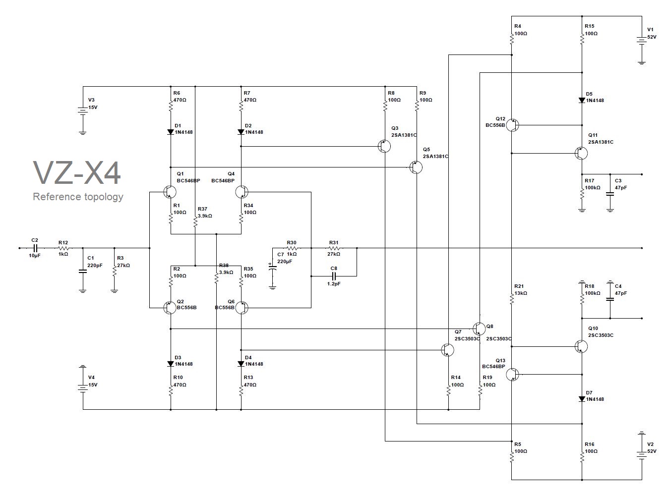

Hi Salas, thank you for a friendly reminder Sure, the full schematic will be published as usual - preparing a more practical version, with rails filtering, etc. As well as the layout. PDFs (if I succeed to design a single-sided for etching) are normally published here, gerbers are available on request.
This particular one went here right from the simulator - simplified, cleaner view for demonstrating/discussing the principle.

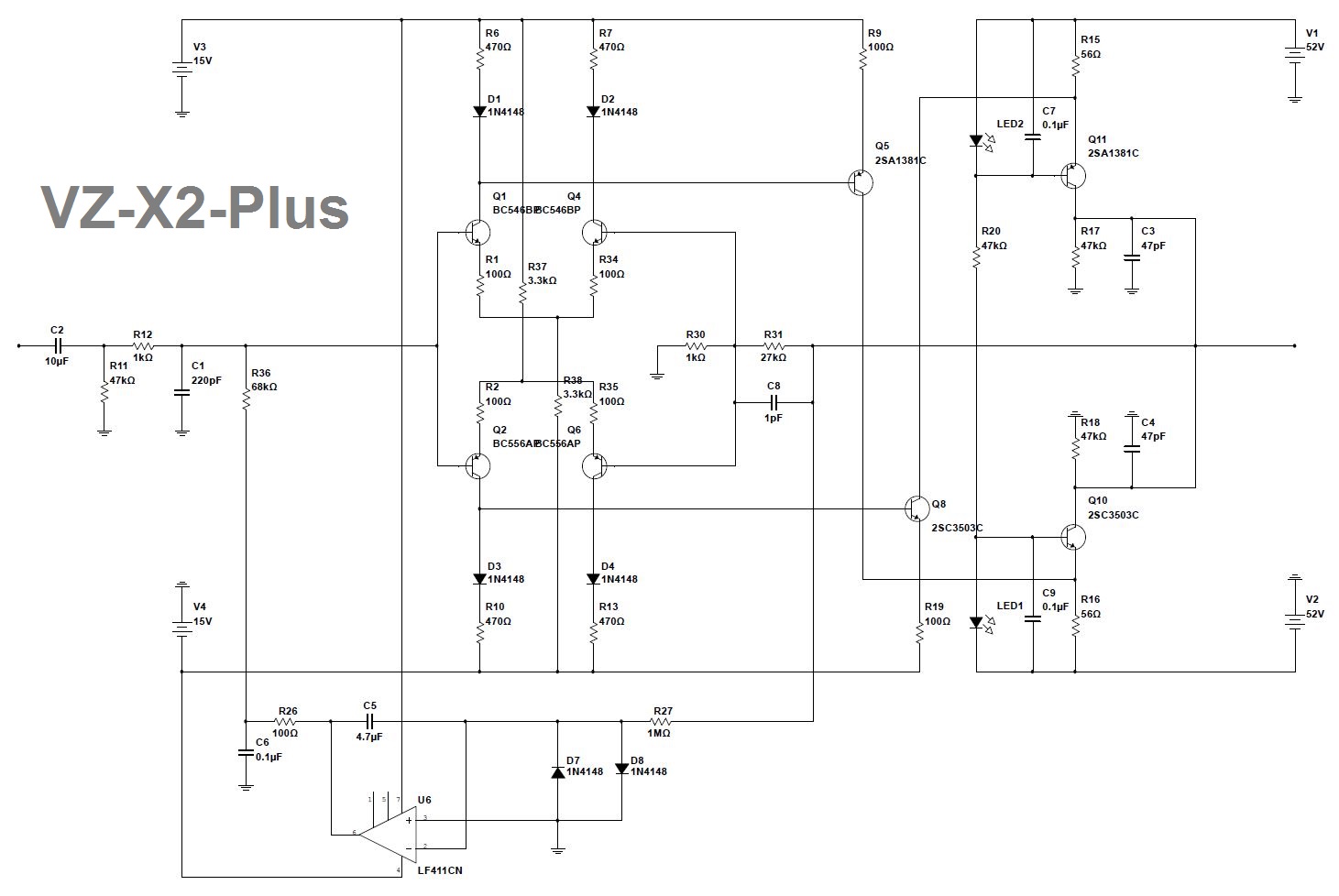

I continued playing with the topology and eventually a simple version with 2 x CCSs at VAS output showed the same performance as the initial "reference" topology - see attached.

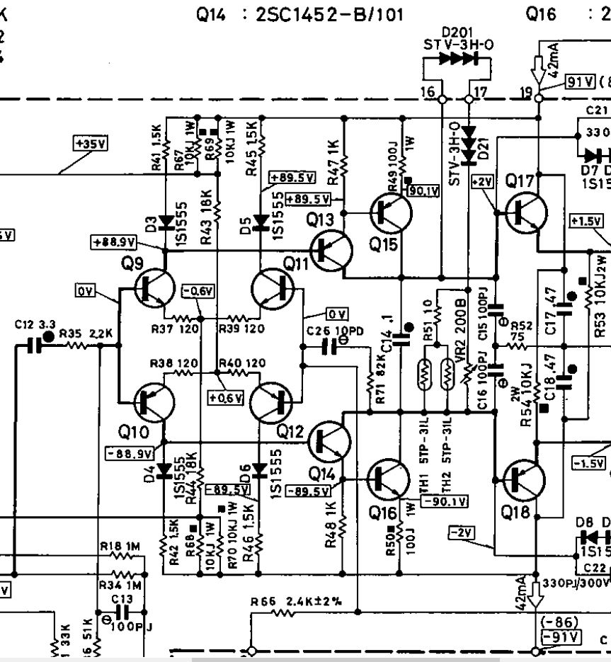

Then I touoght... I've seen something rather similar in some well-known commercial design. Looked up my archive - Bingo!
What happened? I have practically re-invented the front-end of Accuphase M60
I consider it as a good "proof of concept" confirmation
Well, there are still some improvements - I can use excellent low-voltage duals in input LTPs, easily scaling the output swing to any desired rails voltage, modern transistors are faster and higher beta, etc.
I have already tested this configuration earlier, but with no broken mirrors in LTP collectors. This one - with the mirrors - is better. Perfect phase response and better open loop linearity and bandwidth.

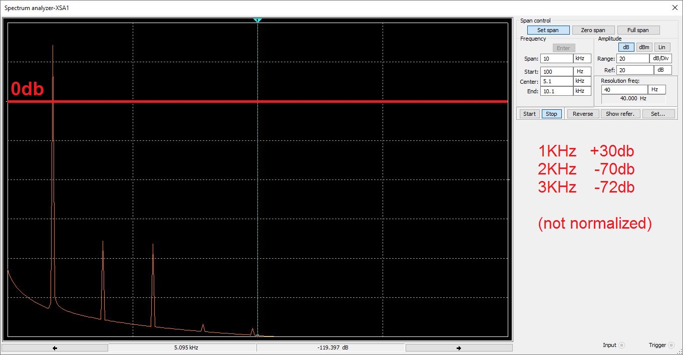

Simulated spectrum shows the dominance of the 2-nd and the 3-rd harmonics, and ... nothing above them.
OK. So far - so good. Coming closed to a "build-able" version.

Hi Valery,
One issue I have with this new version is the use of the two CCSs at the top and bottom of the VAS. This could be a potential place where the classic problem of symmetrical topologies shows it's head. The problem of the two halves fighting each other. Would be good to implement some sort of common mode control loop here? Have been thinking of how to do this but not worked it out yet...

Hi Paul,
The problem of the two halves fighting each other happens when LTP collectors are mirrored to each other. This is not the case here, so the VAS quiescent current will be constant and CMCL is not required.

This makes sense but should we be concerned about the effects of temperature? I'm thinking we need perfectly symmetrical current subtraction.
Or am I worrying about insignificant details?

This one is a working circuit, I have on my desk:
Vertical VFA front-end
Well, it worms-up during a few minutes - during this time the VAS idle current increases a bit. Then it settles and stays very stable. Well, different topology, but - also two halves, "looking at each other".
Valery
It''s starting to resemble a symmetrical V-hex input.
Yes - that's actually the one, with addition of two "broken current mirrors" at LTP collectors. And then - made symmetrical. VHex (as well as Ampliwire) is its "parent"
Valery, what do you call broken current mirrors?
Hi Damir,
The ones where one of the diode-arranged transistors is replaced by an actual diode. It's less precise as a mirror, but when used with gain (2 resistors have different values), plus two of them are used symmetrically - lack of precision does not matter any more.
I use similar CM in my CFA but as a CCS. Who was first to called it broken mirror?
Just saw it somewhere on the forum here I find this name good enough for distinguishing this one from the "normal" mirror (with 2 transistors).

OK, I have returned to 4-points drive of the VAS output CCSs.

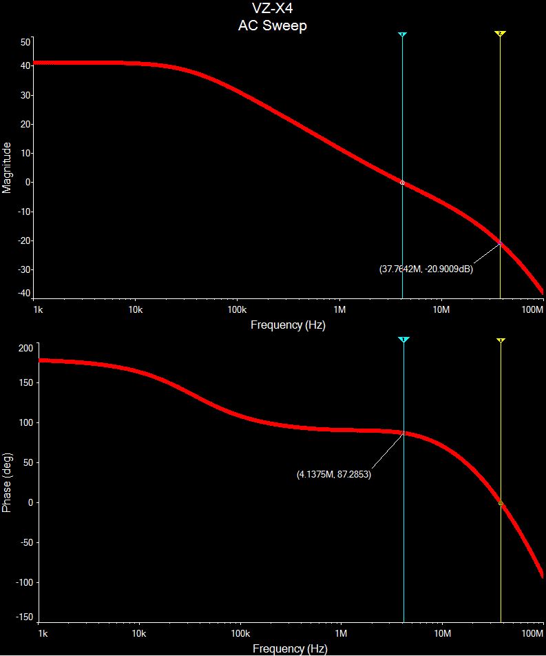

Excellent simulated performance - distortion, speed, phase response, transients handling, very clean clipping. Loop gain/phase curves are incredibly clean, the front-end is not "nervous" at all
OLG is 70db throughout the audio bandwidth, CLG = 29db, LG = 41db.
Still not sure if I want to split R21 in 2 halves and ground the middle point or leave it floating. We'll see at the prototype

R21 = you may put npn transistor with grounded base, thermal loss at top and bottom half tranies should be splitted 50/50. It should work nice.
VZ drive looks like a cherry on top of cake
In this latest version I've got identical mirrors on both the top and the bottom sides, so one transistor with grounded base will not help any more. Possible solutions:
- one floating resistor as it is now (the simplest one );
- two resistors with grounded middle point;
- one floating CCS;
- two grounded CCSs.
I plan staying with the resistors for now.
