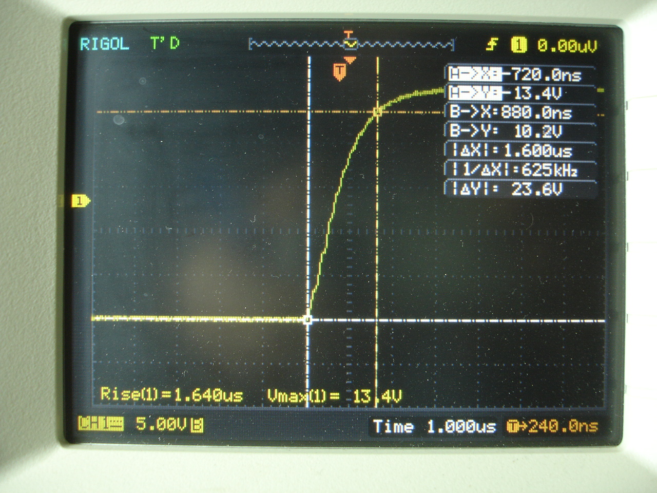

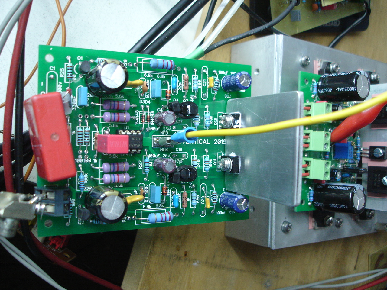

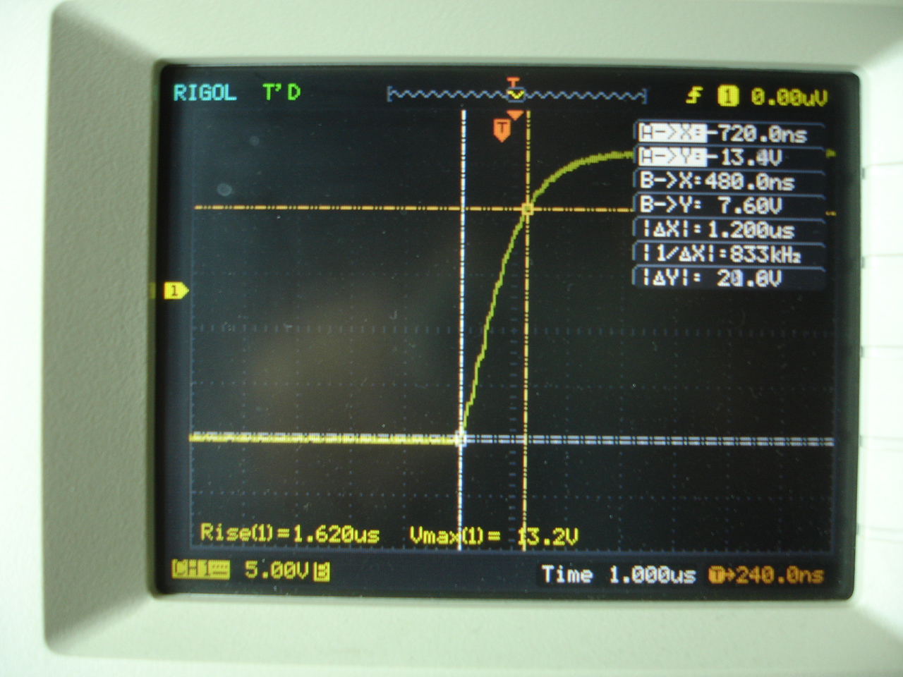

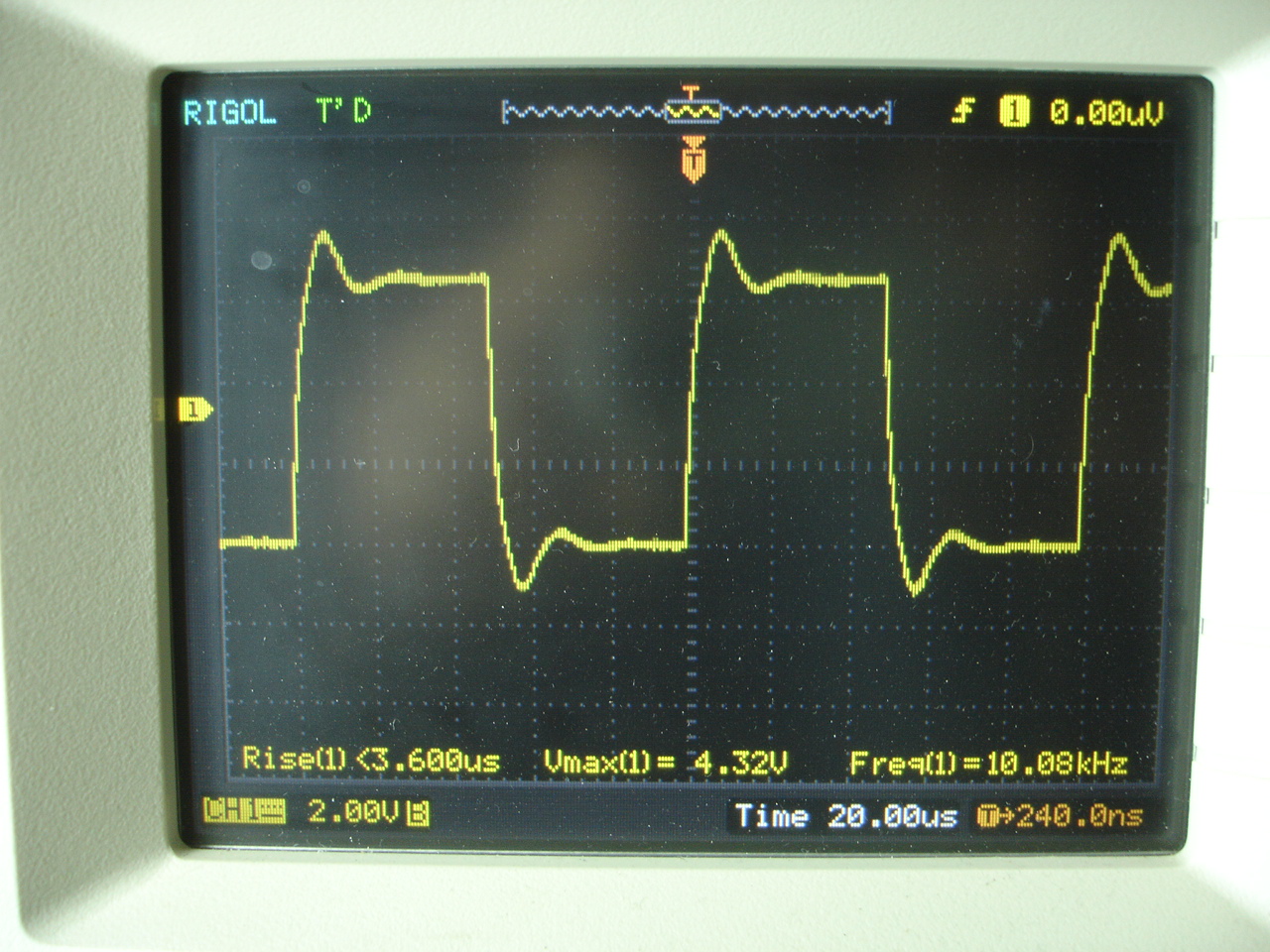

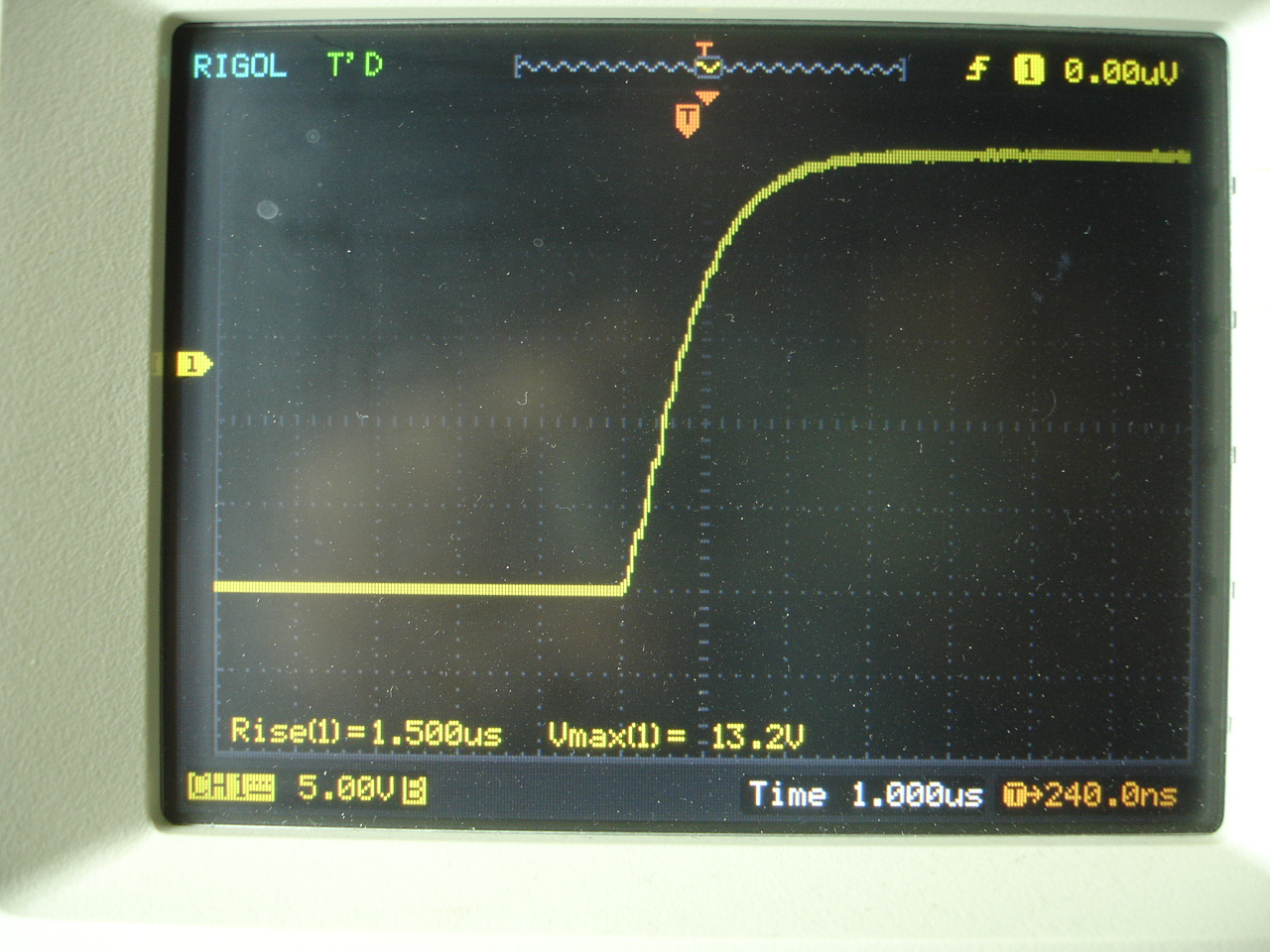

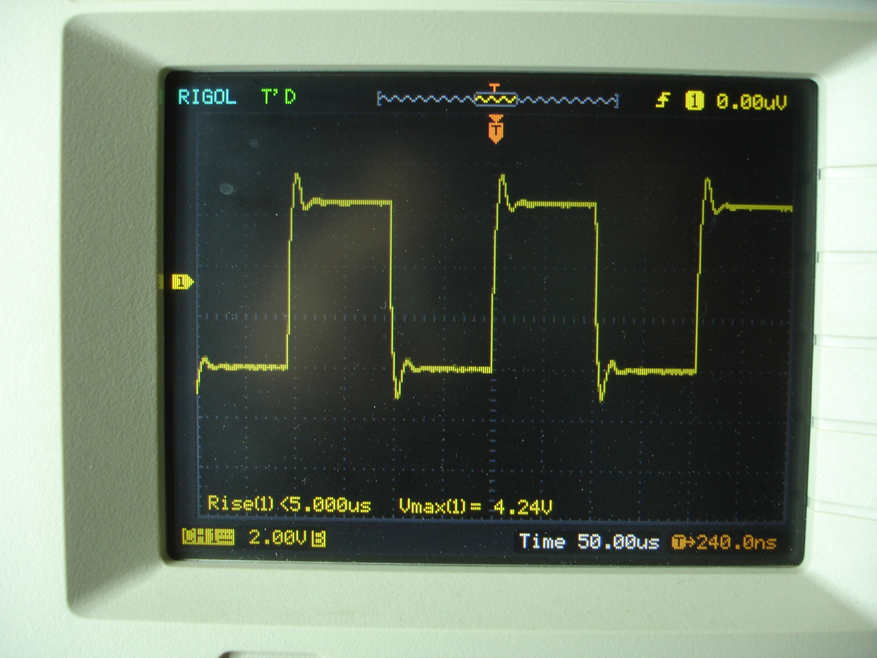

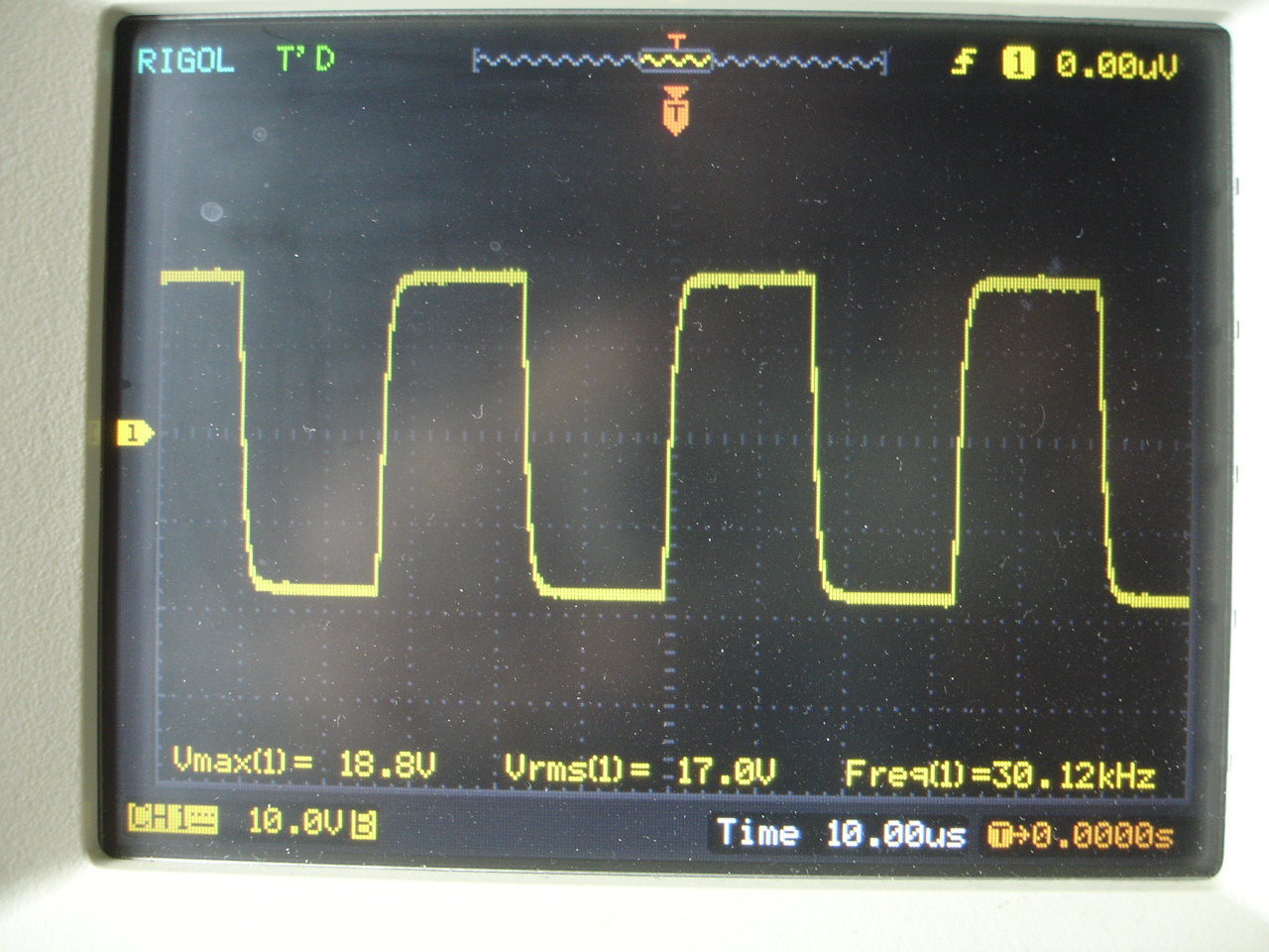

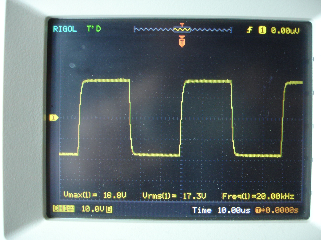

vertical CFA+Slewmaster out
A first test done putting 47pf in position of c18,19 .This test wasn't successful. Then the compensation increased to 68pf. That's it!The problem solved.
A full test later this afternoon.
Thimios
Thimios
Thimios
OK - VAS does not like that additional pole from the OPS 🙂
BTW, this cap value increase will practically not slow down the overall front-end's step response. Looking forward to seeing your test results 😎

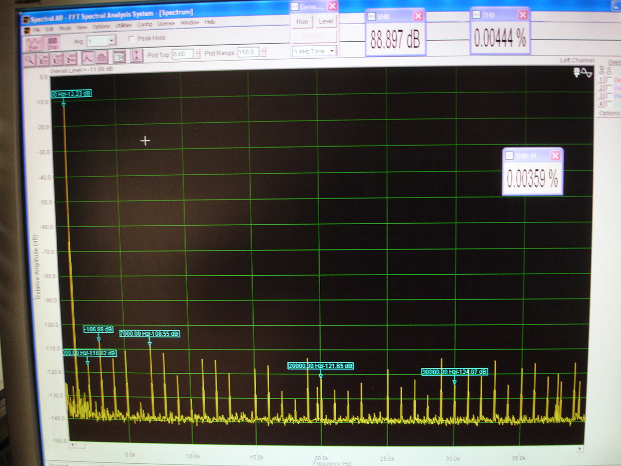

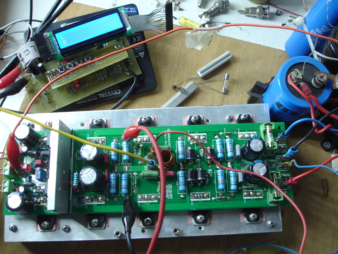

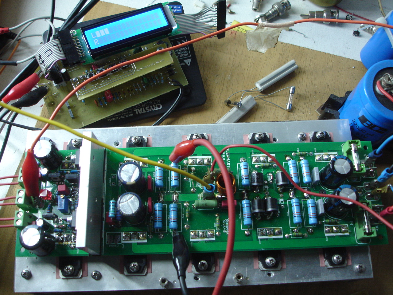

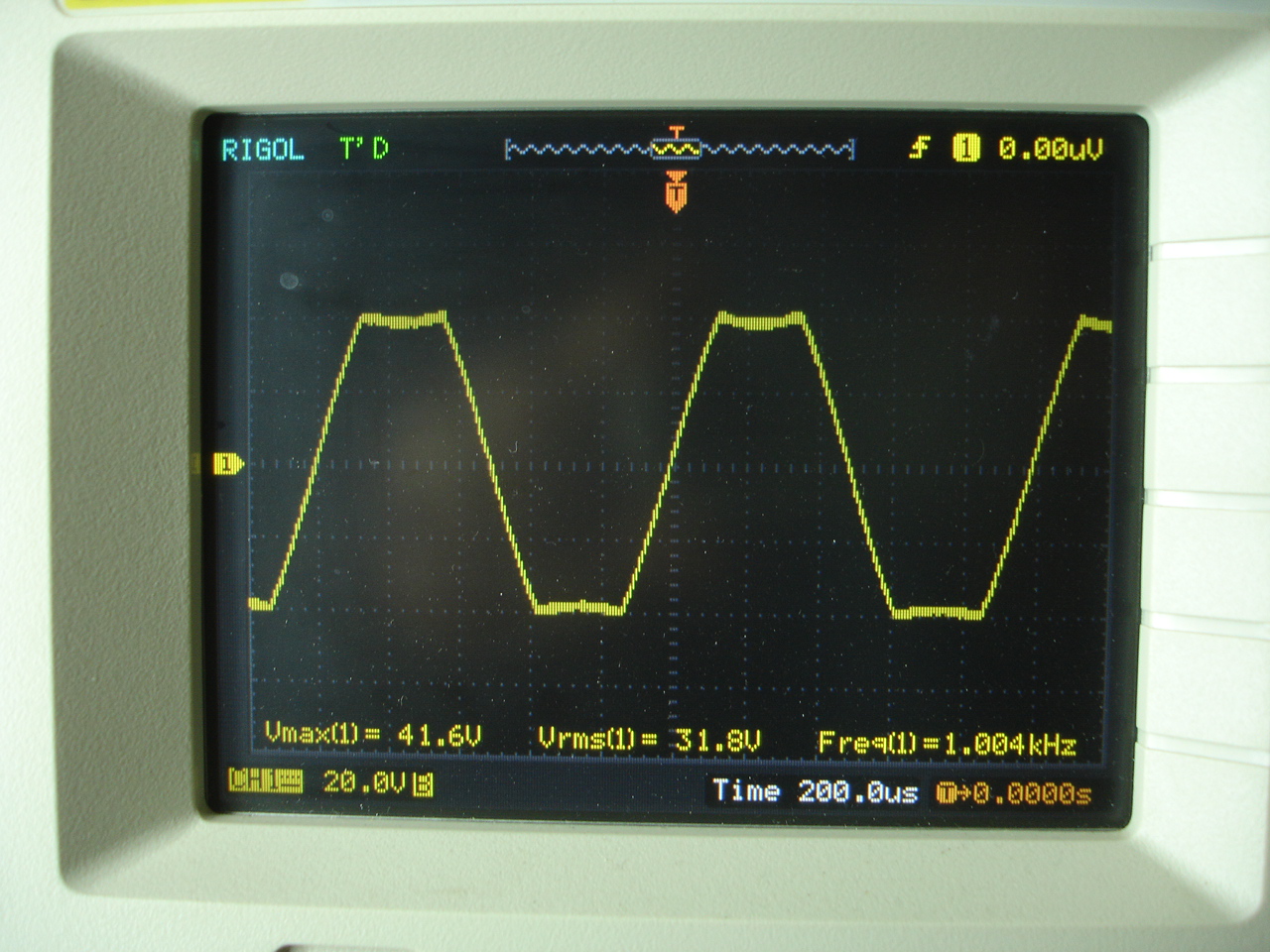

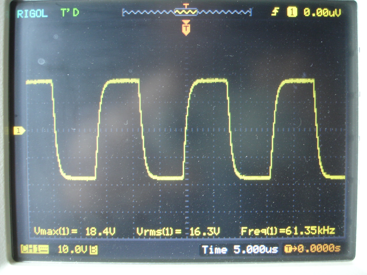

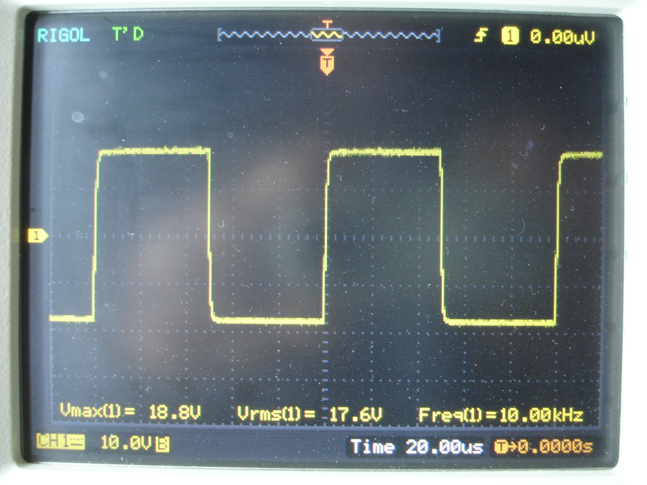

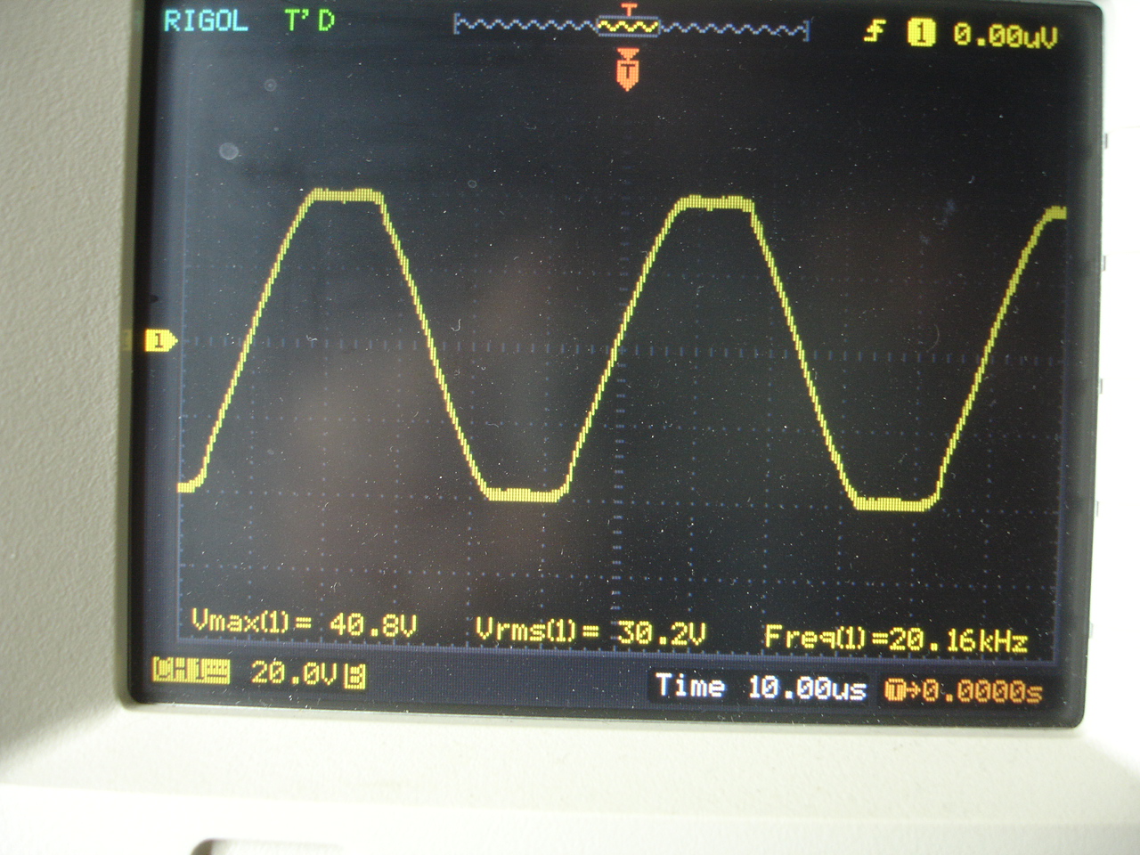

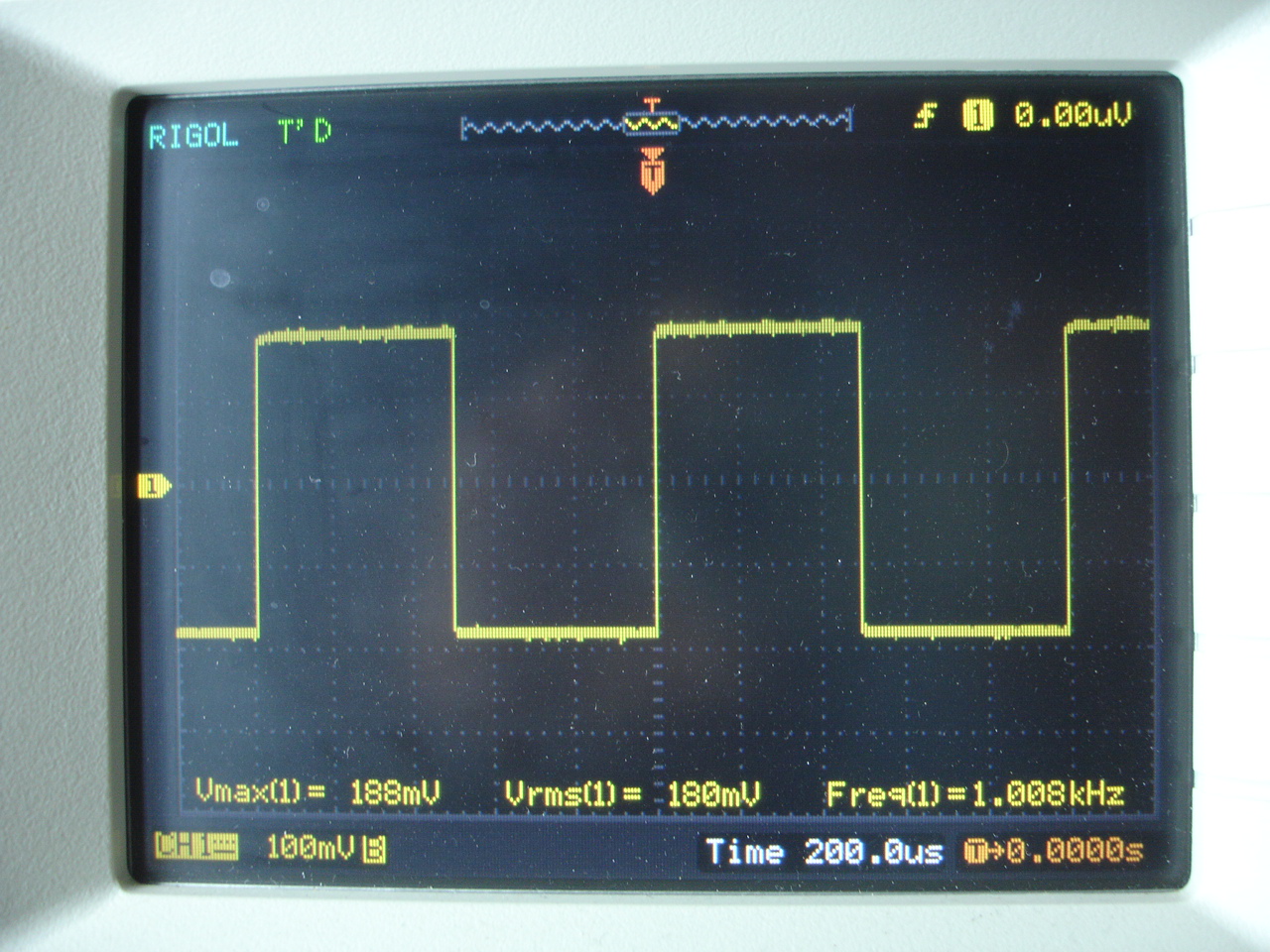

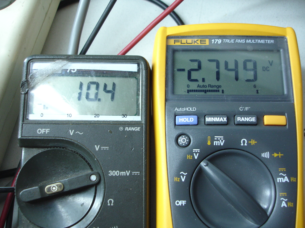

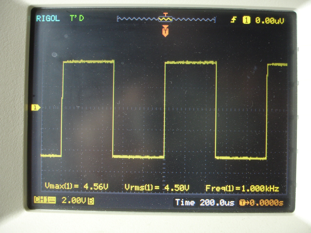

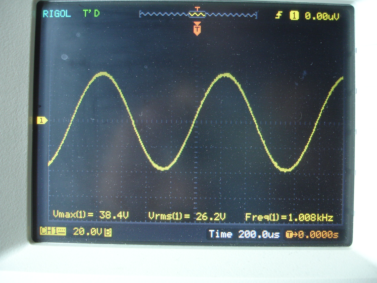

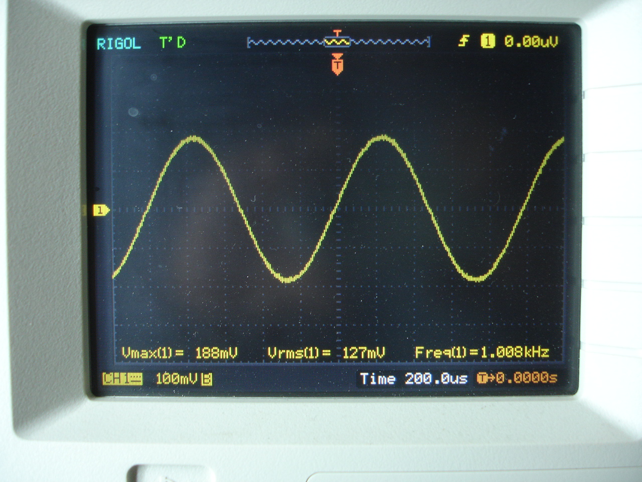

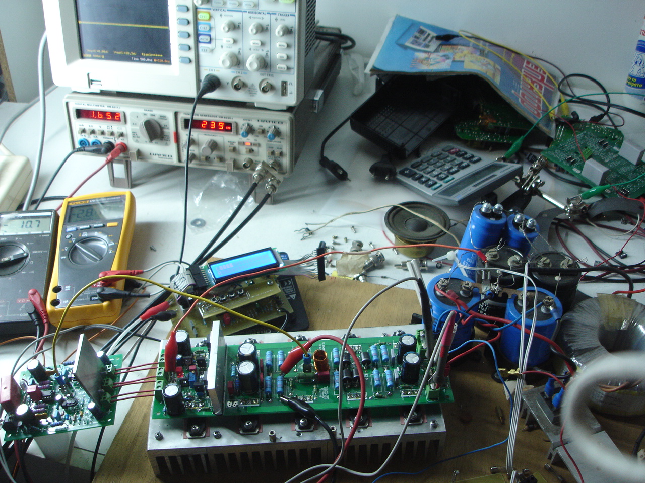

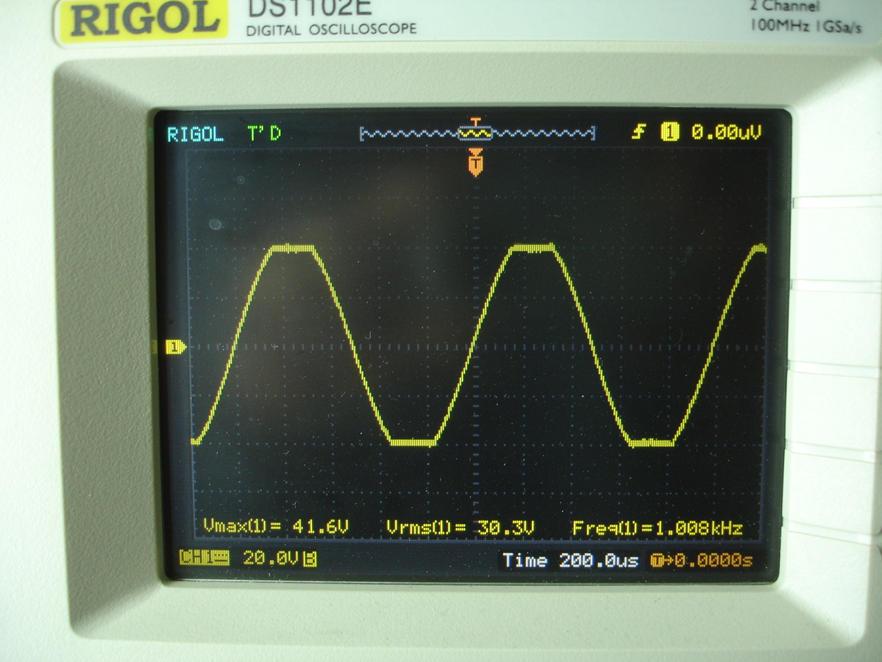

Testing vertical CFA+Slewmaster
Power supply +/-50v
54000uf/rail
Idle current 54mA/Pair
Offset 0mV
1V RMS INP 27 V RMS OUT/6R=120W RMS.Before a visible clip.
Power supply +/-50v
54000uf/rail
Offset 0mV

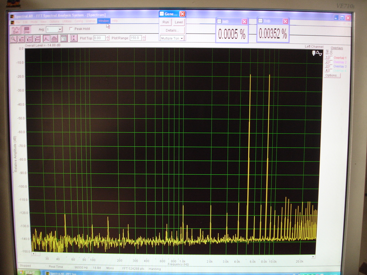

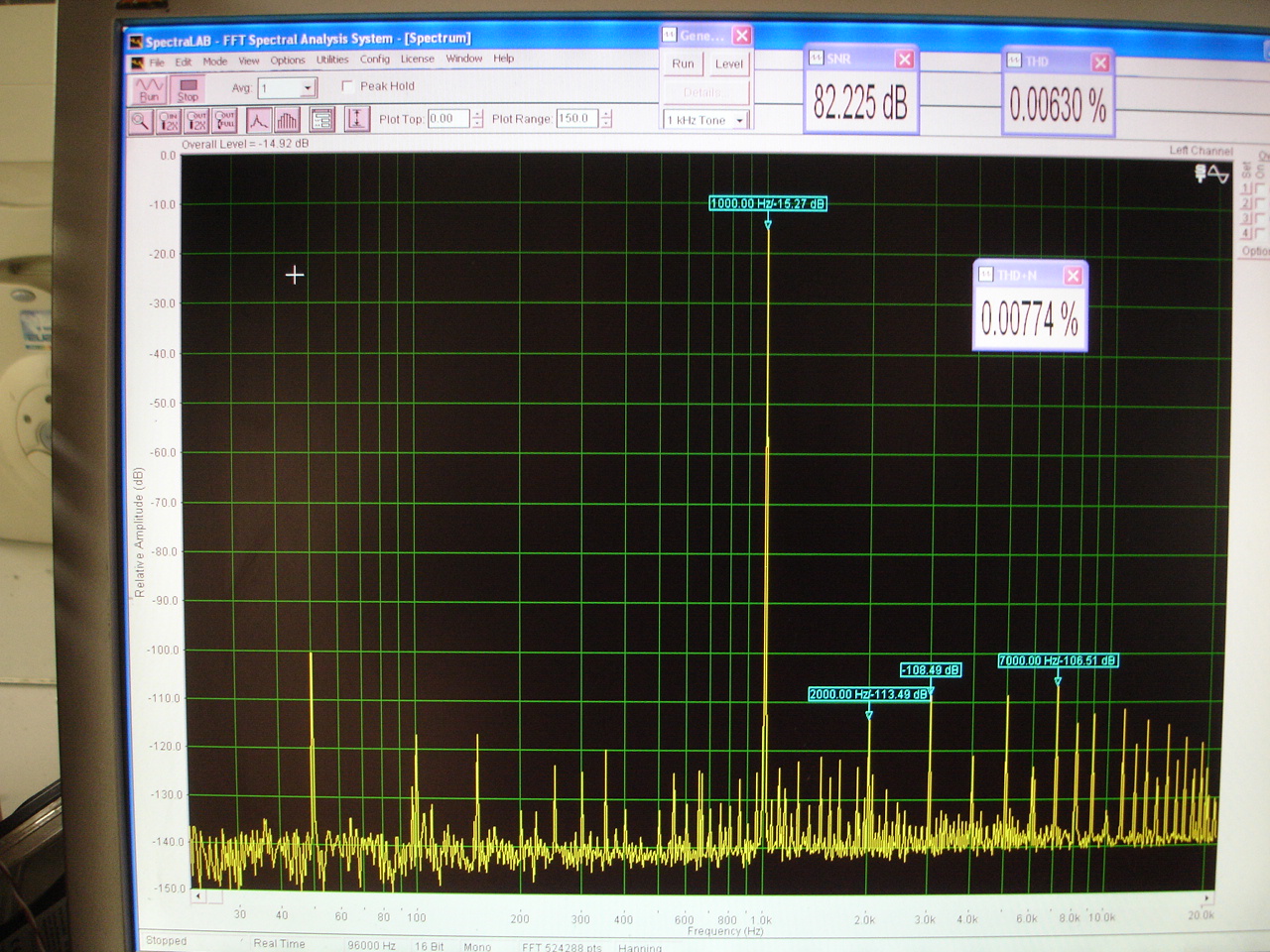

Doing this test i see that,connecting speaker GND on power amplifier board is a bad practice.
Star GND is better.Even better a second clean GND position.
Too late for edit.
See this photo with speaker GND connected on power amplifier pcb,look at 50Hz and all other harmonic up to 1KHz
I think there is some loop in your grounding scheme in this case - mine is dead silent with the input connected to the pre-amp.
Am I right - at the previous measurements the speaker ground is connected to PSU ground?
Yes in all the previous measurements the speaker gnd is connected to psu gnd and the devider gnd on psu gnd.Hot cable of devider is connected to speaher out on pcb, behide R.LI think there is some loop in your grounding scheme in this case - mine is dead silent with the input connected to the pre-amp.
How you avoid the gnd loop?
