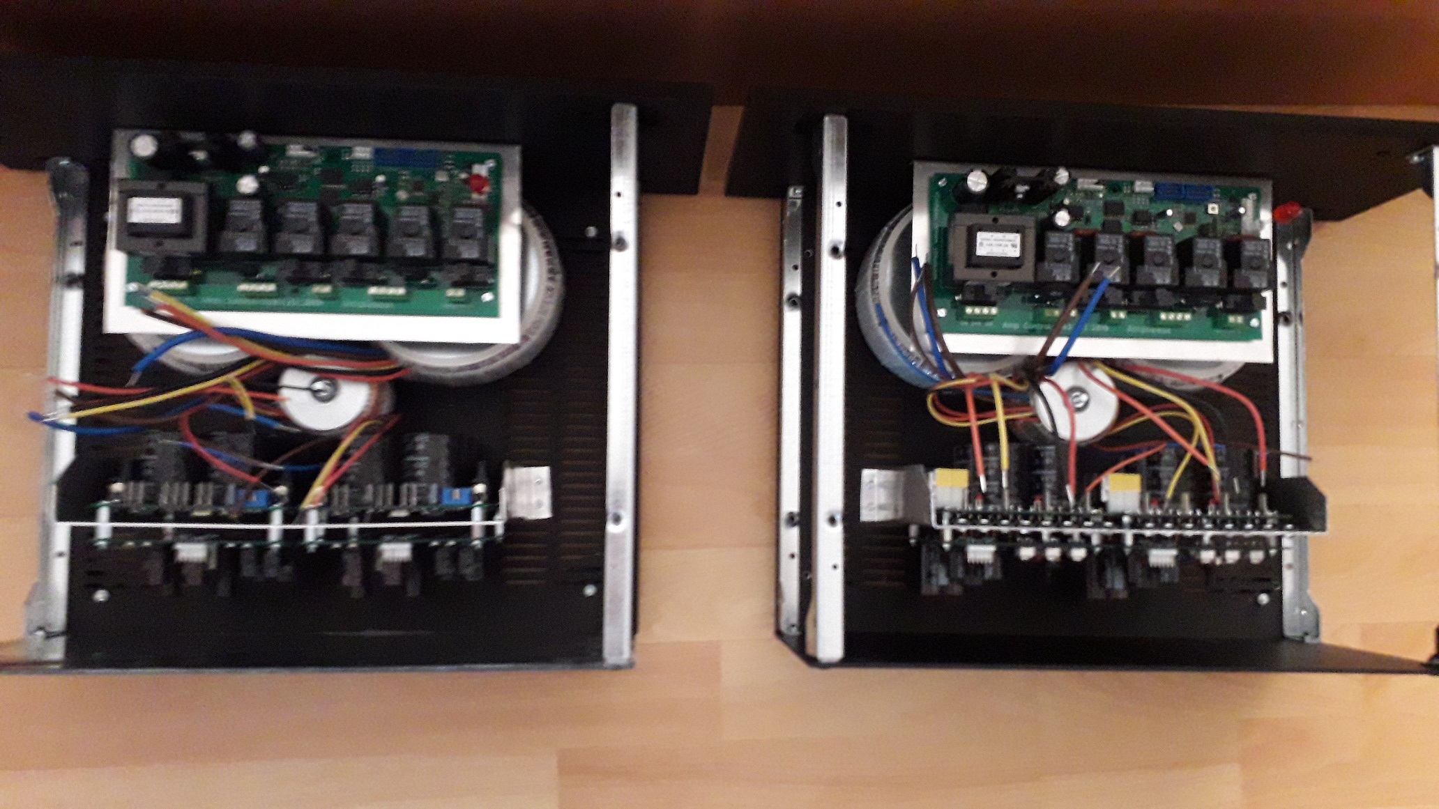

For some hours now, I'm auditioning the NS modular amp with Vertical CFA IPS driving my 1.6 Magnepans.
The sound: exactly as Jeff and Vallery described it. It's holographic with very well balanced spectrum. It leans on the neutral side of things: as clean as Ncores I had for some time but much more engaging. Not as colored as my previous EAR 509 tube amp or as warm sounding as the Perreuax Radiance intergrated which had rounded highs, not the case with NS.
My Avondale monoblock probably has a bit better PRAT but it's not something you go missing. I would like a meatier sound in the upper mids and highs, cymbals are still compressed, but I think needs more hours to really break in, so I hope that will change

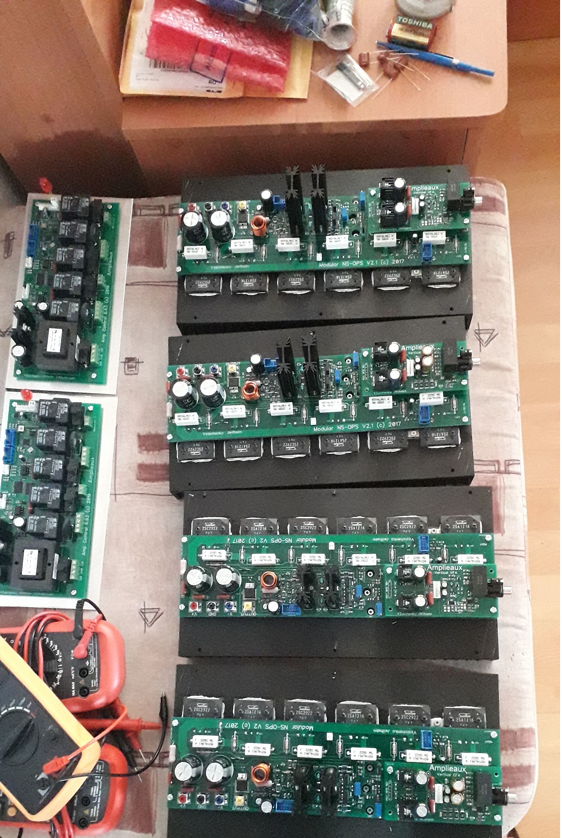

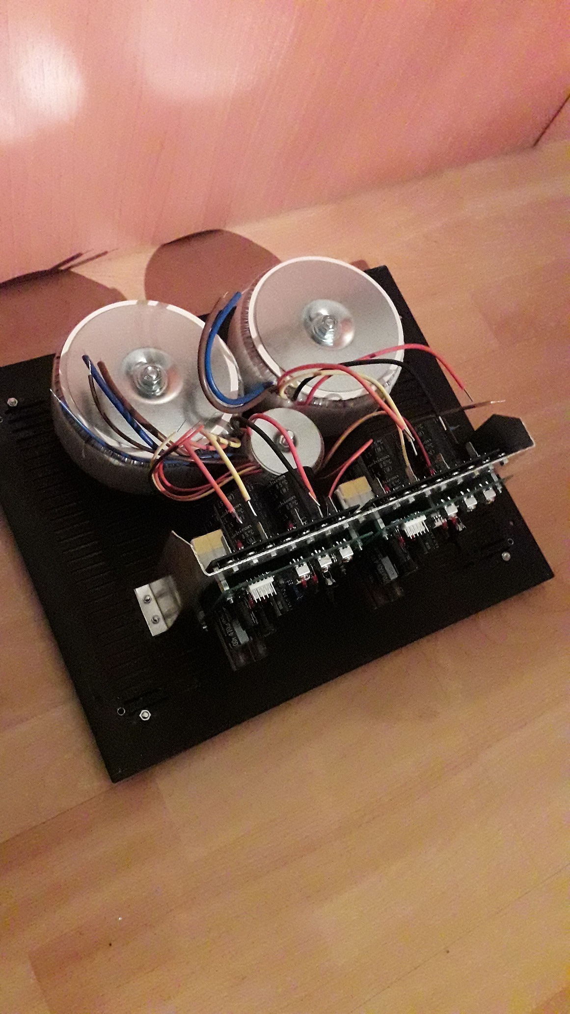

I want to thank members: filenet, for all the useful info he share with me, evanc for generously providing me with missing transistors, and of course Jeff and Vallery who were constantly confirming me in each stage of the build, their assistance is something you can count on.

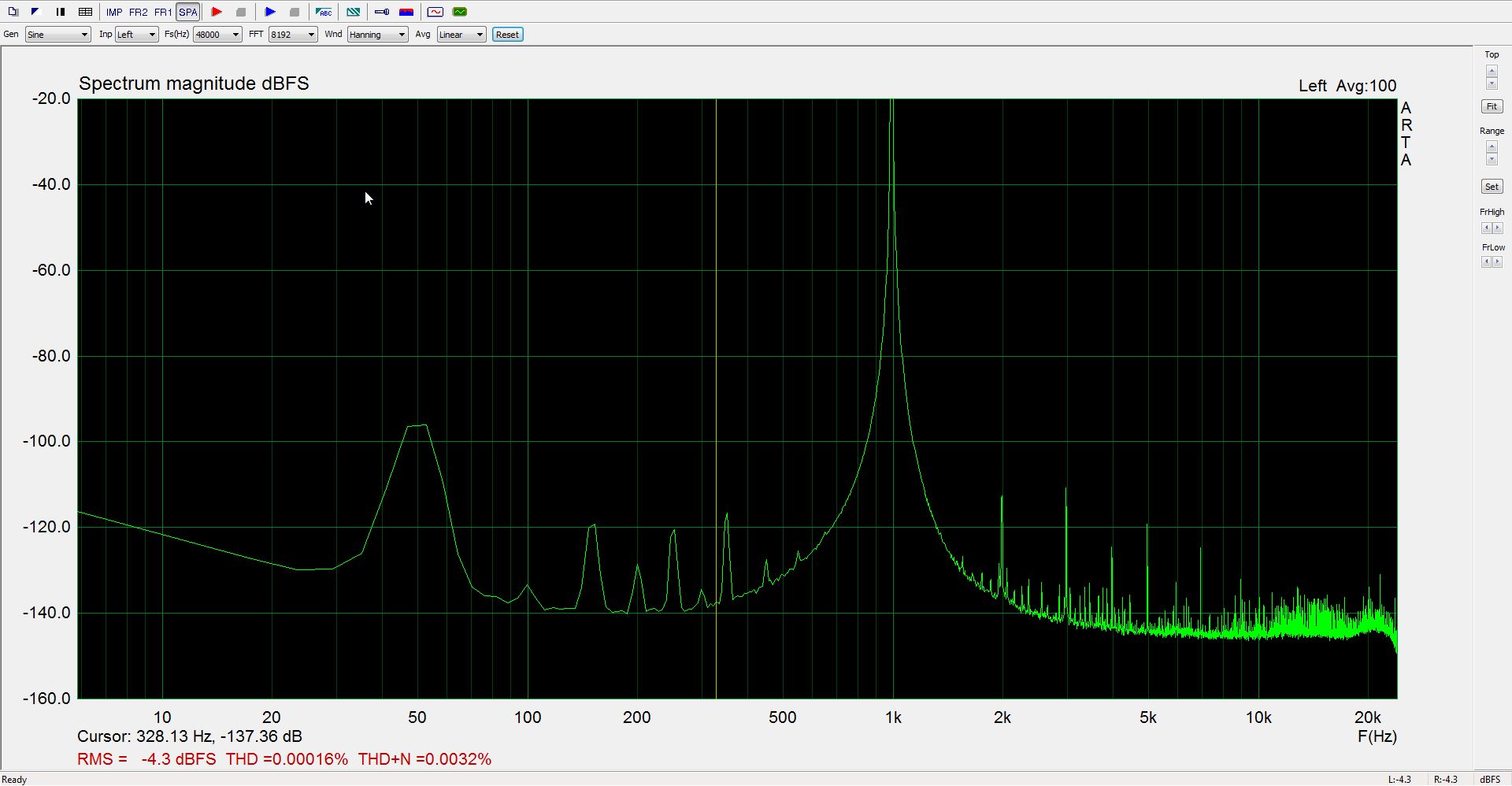

Picture: load 8,2 Ohm, output: 10 Vrms

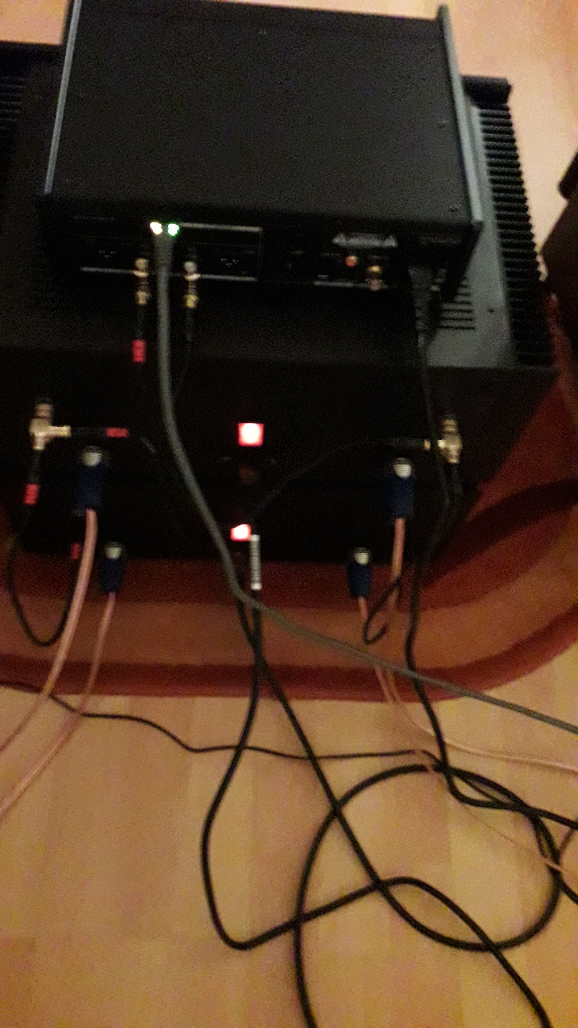

VFA for bass, and CFA for mid/treble. I was afraid for noise, but there is none even with simple input regulator. Thanks Vallery and Jeff!
