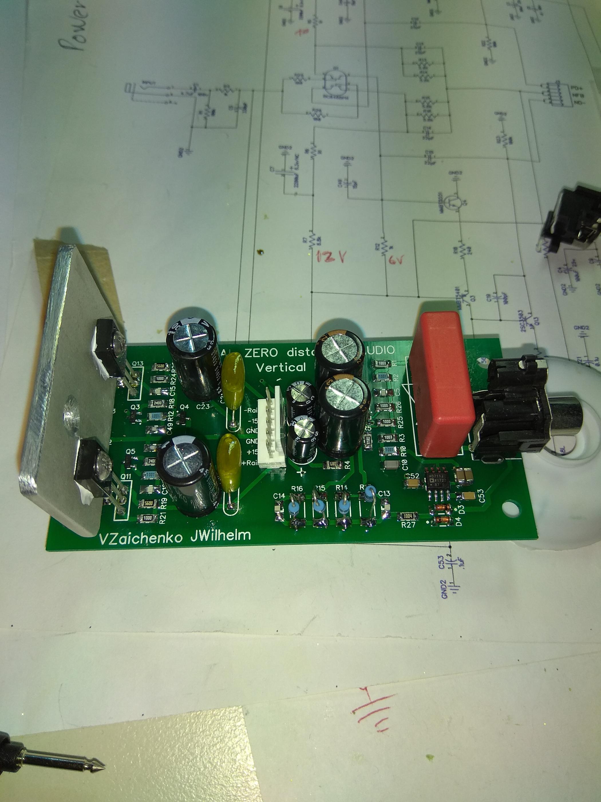

Same thing here, all difficult parts are done

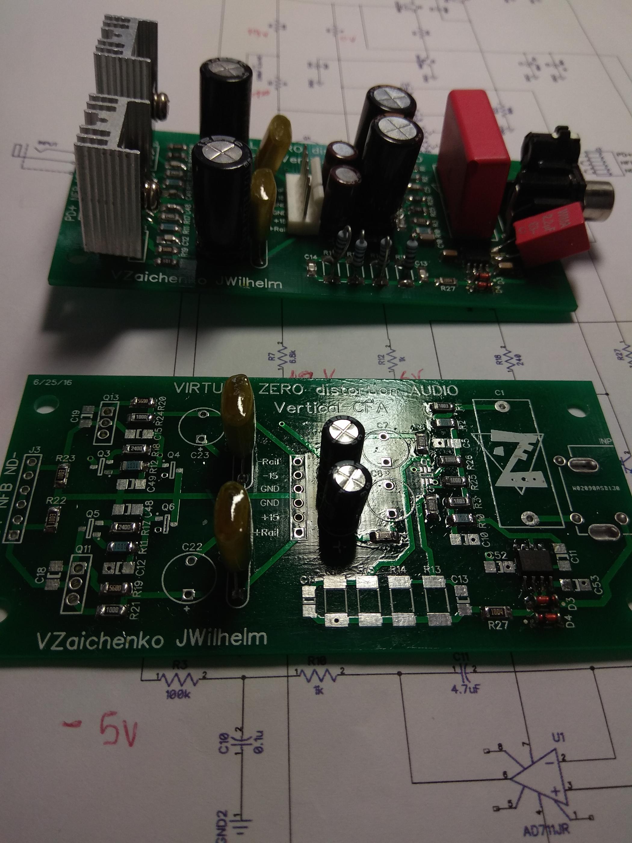

Dammit, forgot the 78M15 regulators and couple of smd caps. "Waiting is the hardest part"

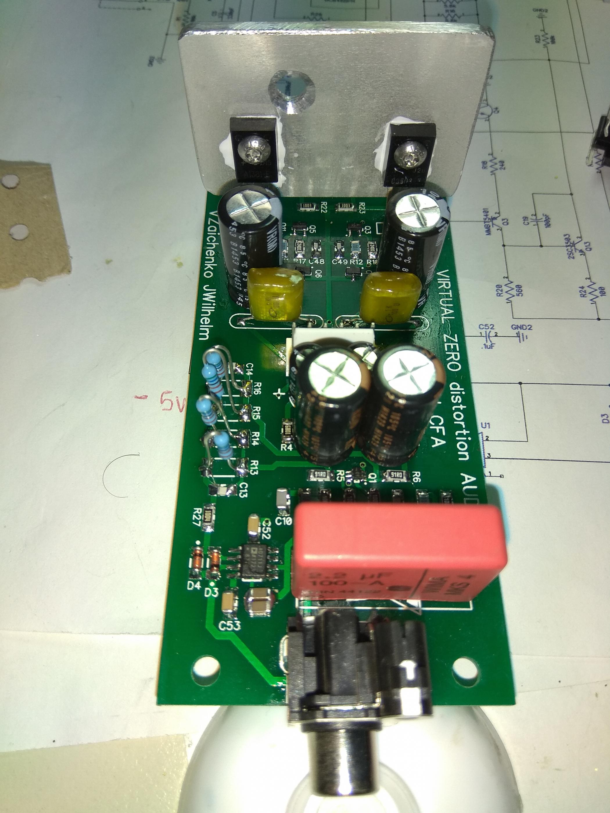

Is a heatsink needed in the IPS ? (I have the CFA version)

That looks real nice. I have the CFA inputs built too but not tested yet because of no OPS . Hope to remedy that soon.

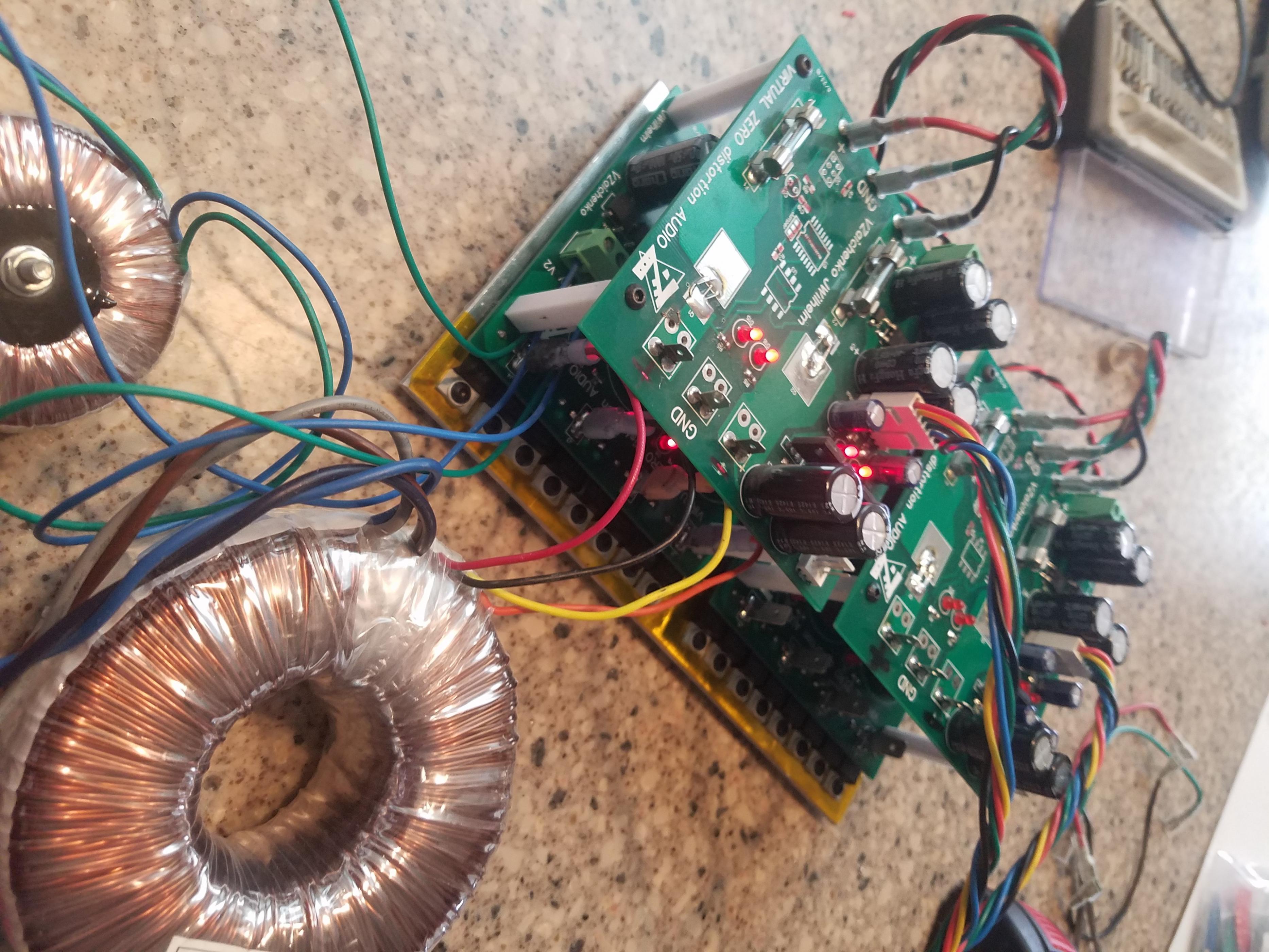

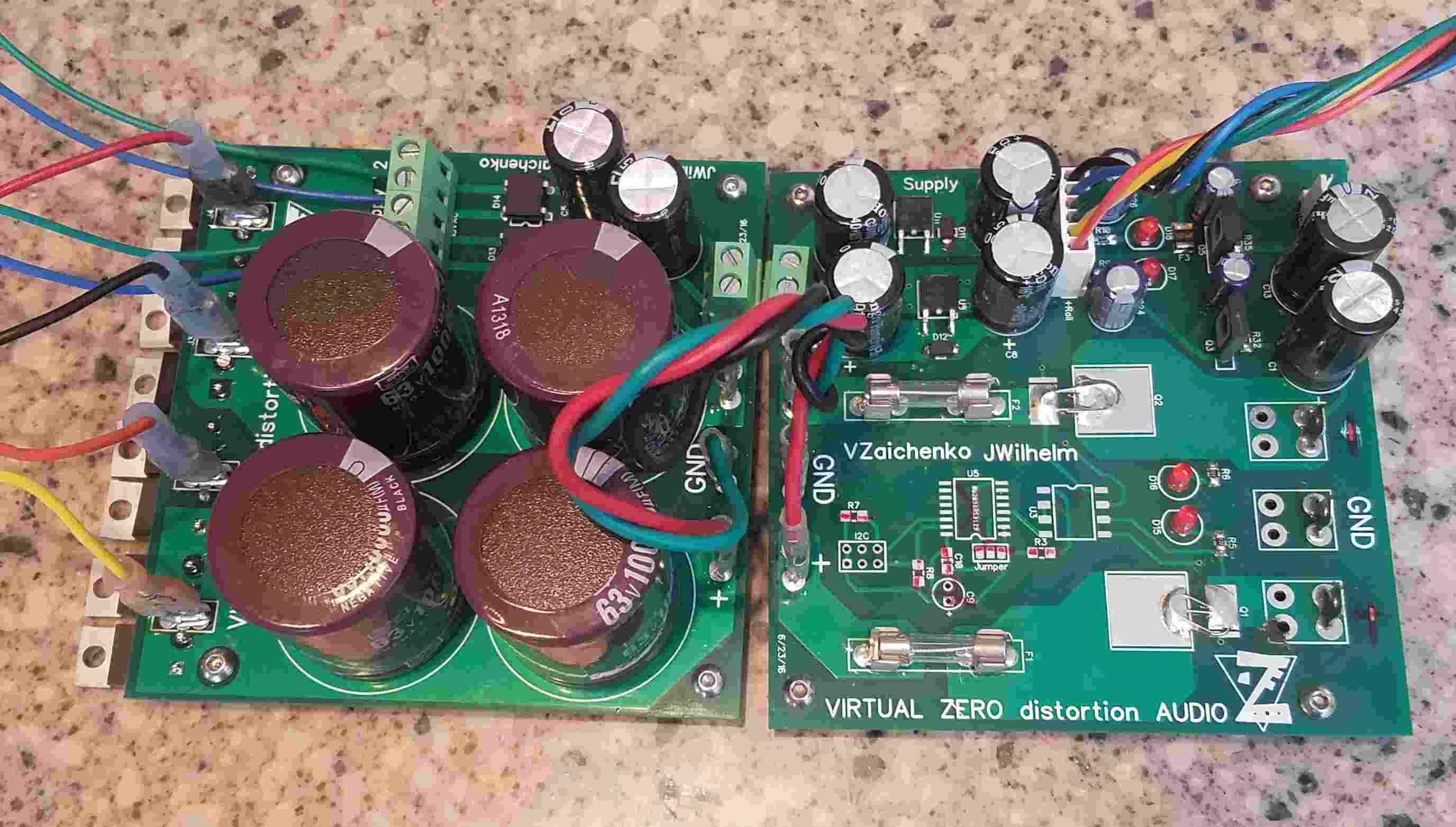

I made some standoffs and stacked them. I mounted them on a plate to serve as heatsink and a way to mount the whole thing in a case. It takes up a lot of real estate. Testing it with the 12.6vac transformer and 34vac transformer. Getting 15v on the low side and +/-52V on the high side. I'll probably go to a 39-0-39vac transformer once I have everything set up.

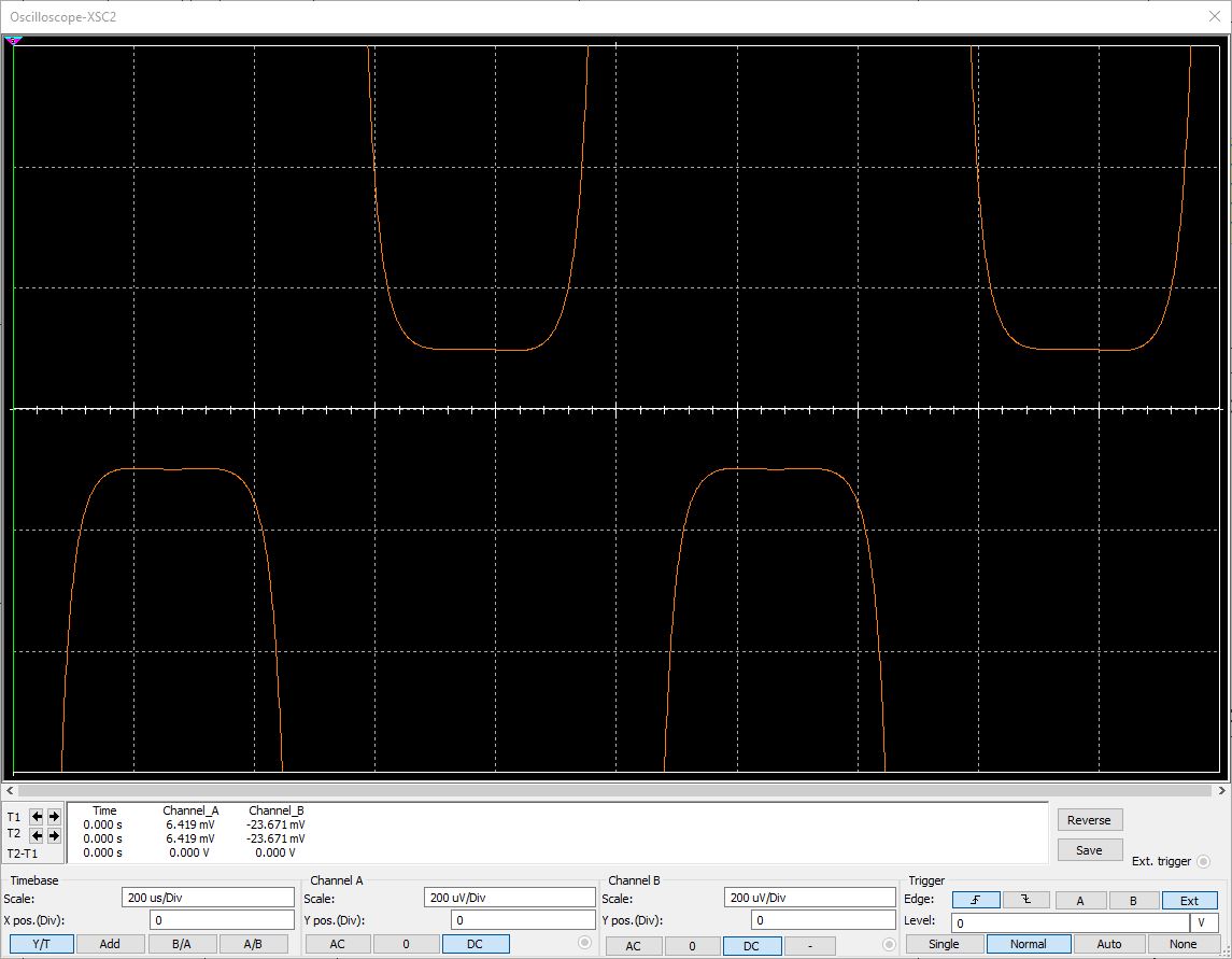

In addition to that, the clamping spreader has to be tuned-up for the lowest distortion, preventing the output transistors from closing. The attached picture shows the crossover region of the current through the output transistors - emitter current comes close to zero but never reaches it.
However, even if the idle current clamping system is not tuned up the best way, it doesn't influence the bass performance. The OPS works correctly even with DC signals - there's no cut-off frequency at the low end of the bandwidth.
