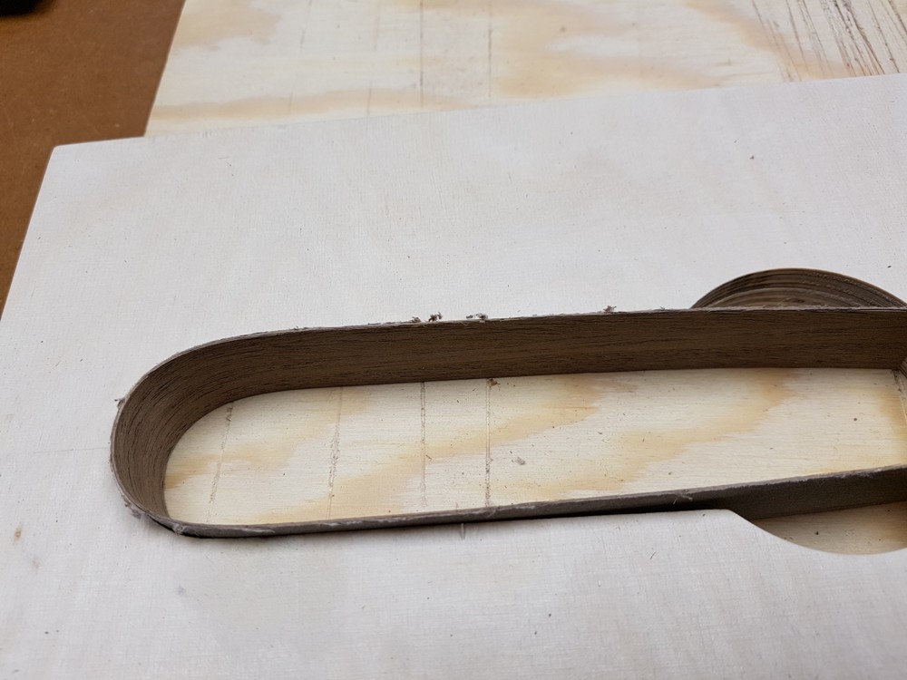

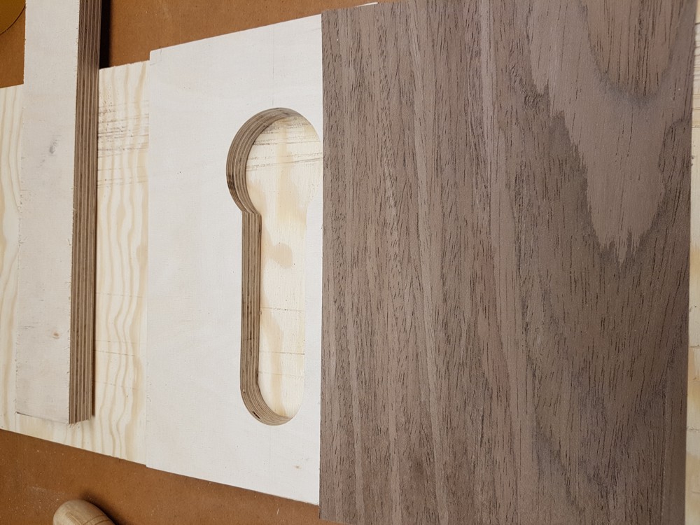

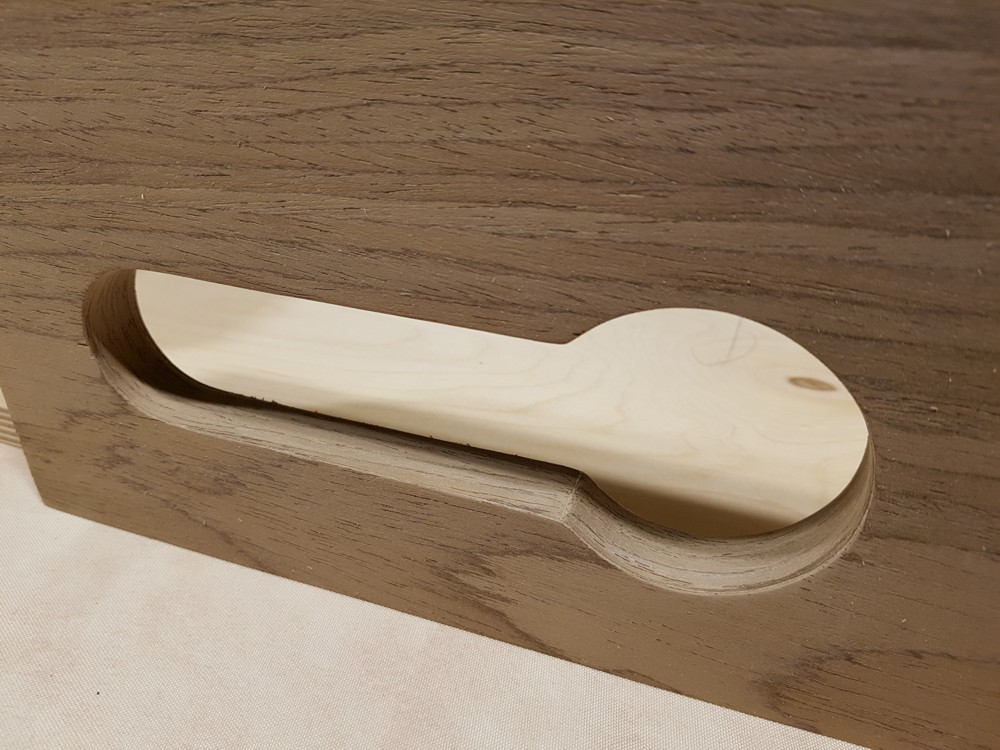

Hi Evan,
Plywood is easy to work....and i am more confortable with wood work than metal work. Tha,ks for advice about heatsink grounding. All metal pieces on case will be grounded (safty practice...). In amp case trafos will be located in down part of case V/S amp board and smoothing bank in the uper part of case separated from down part by a metal sheet also groundred. I join you latest progress on 6j6 preamp face veenering.

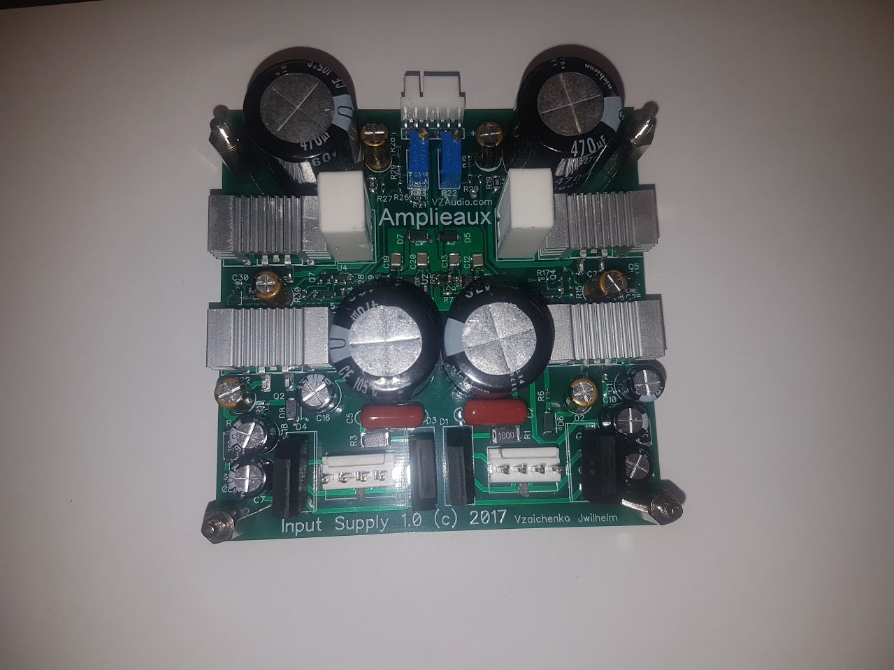

I have a new input power supply for the NS series amps ready for testing. It's powered from two 10AV transformers so the input stage supplies are completely separate from the output supplies, so they won't see the droop or ripple. The +/-15V rails are regulated with low noise TPS7A4901/3001 regulator ICs and the high voltage rails are a discrete adjustable design Valery put together that can supply anything from 40v - 75V by adjusting a trim pot.

Nice!
I guess all IPS will be happy with this quiet power supply!
Will be interesting to see if this affect measurements or if it is audible.😉

Jeff, I like the way the front-end PSU came out - versatile set of regulators.

The new input board uses the same footprint as the old one.
