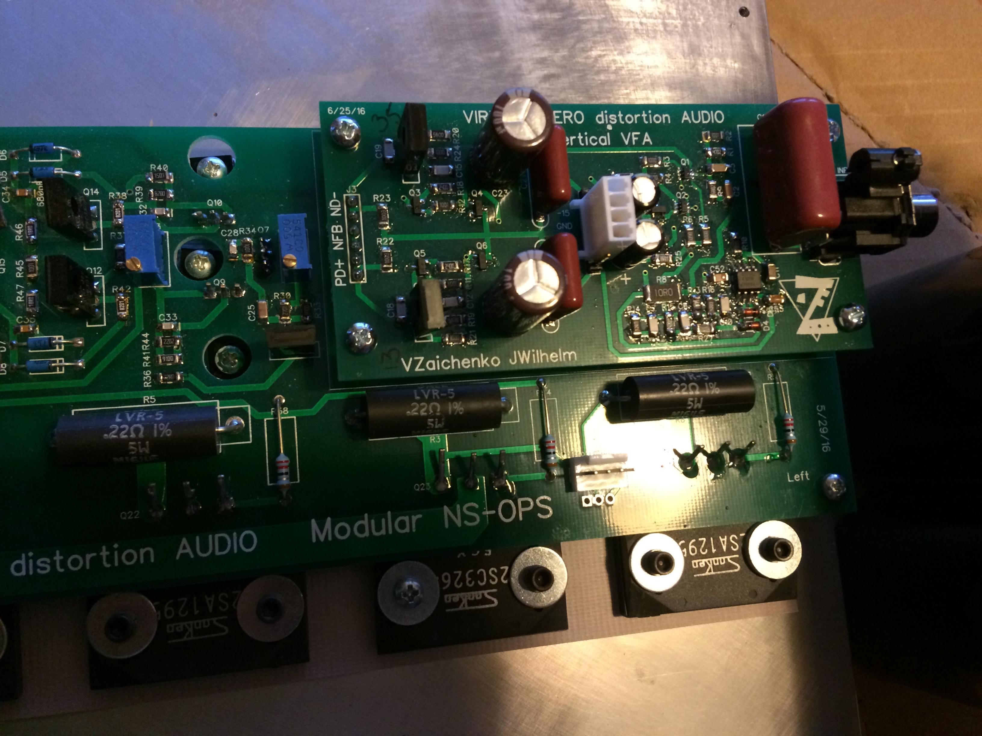

Has anyone built the Tribute-3000? Ever since I saw it I've wondered about putting it in a Sansui chassis. I have a BA-2000 sitting here and Valery's driver board is nearly identical in size to the original . I'd just have to figure out the ops so I could use the original heatsinks. etc. Anyway I was curious if anyone had built The Tribute as drawn.

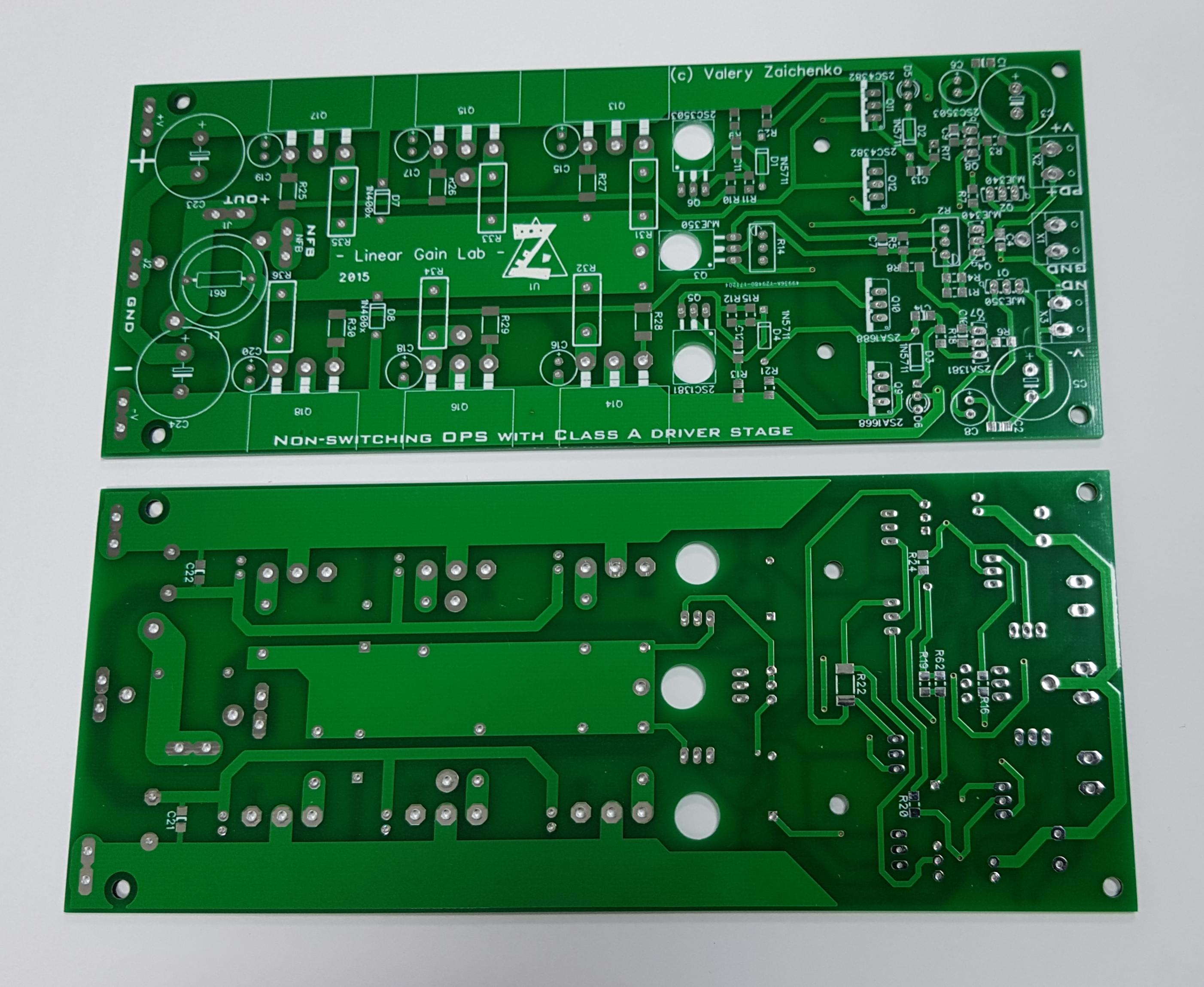

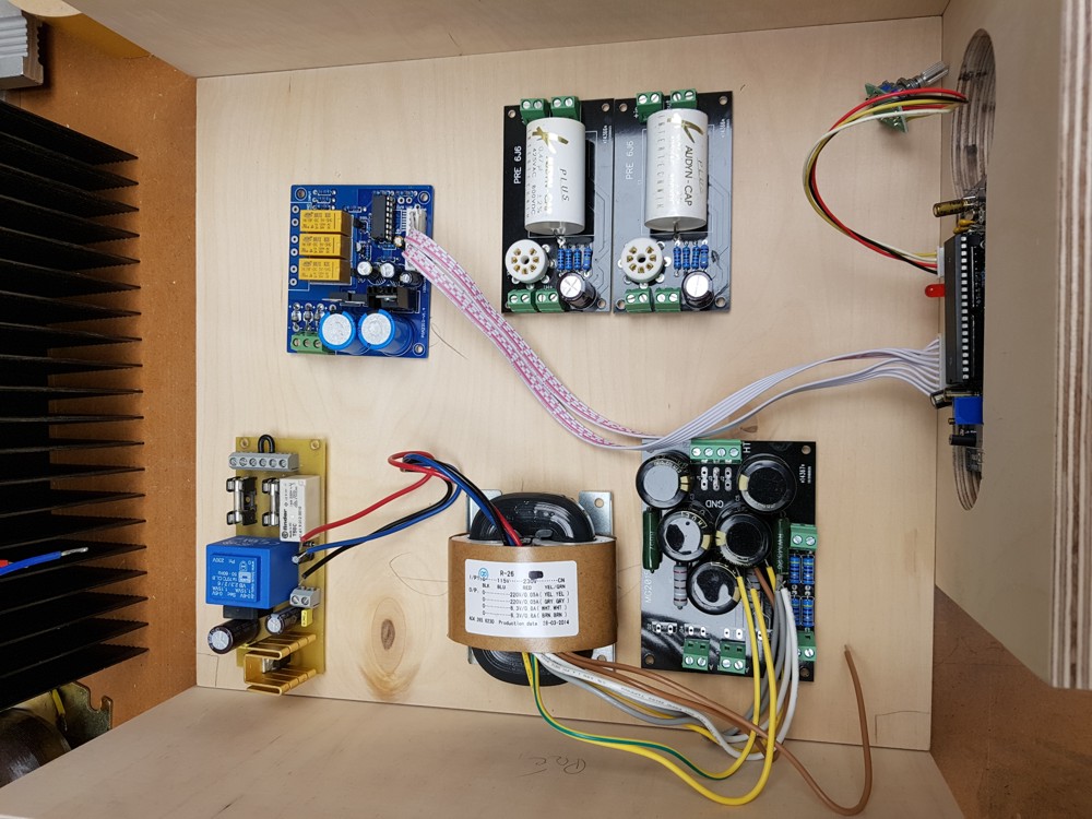

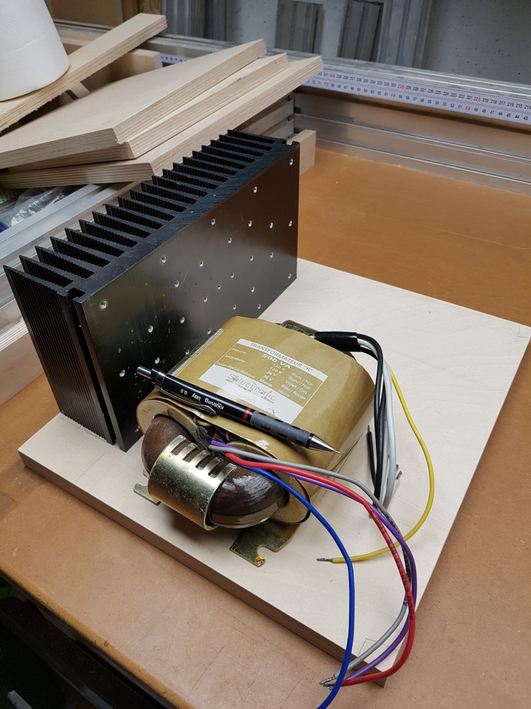

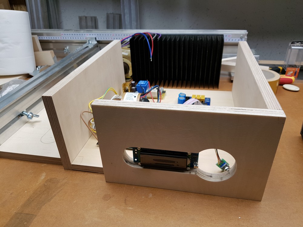

I see it's been a year that I have had these boards. Both channels worked as expected on start up. The regulator for the front end is a nice little unit I got from member OlegSh. I'll spend the next bit of time boxing the amps up. I look forward to spending some time on inside hobbies now that the cold weather has really settled in.
Evan
Evan

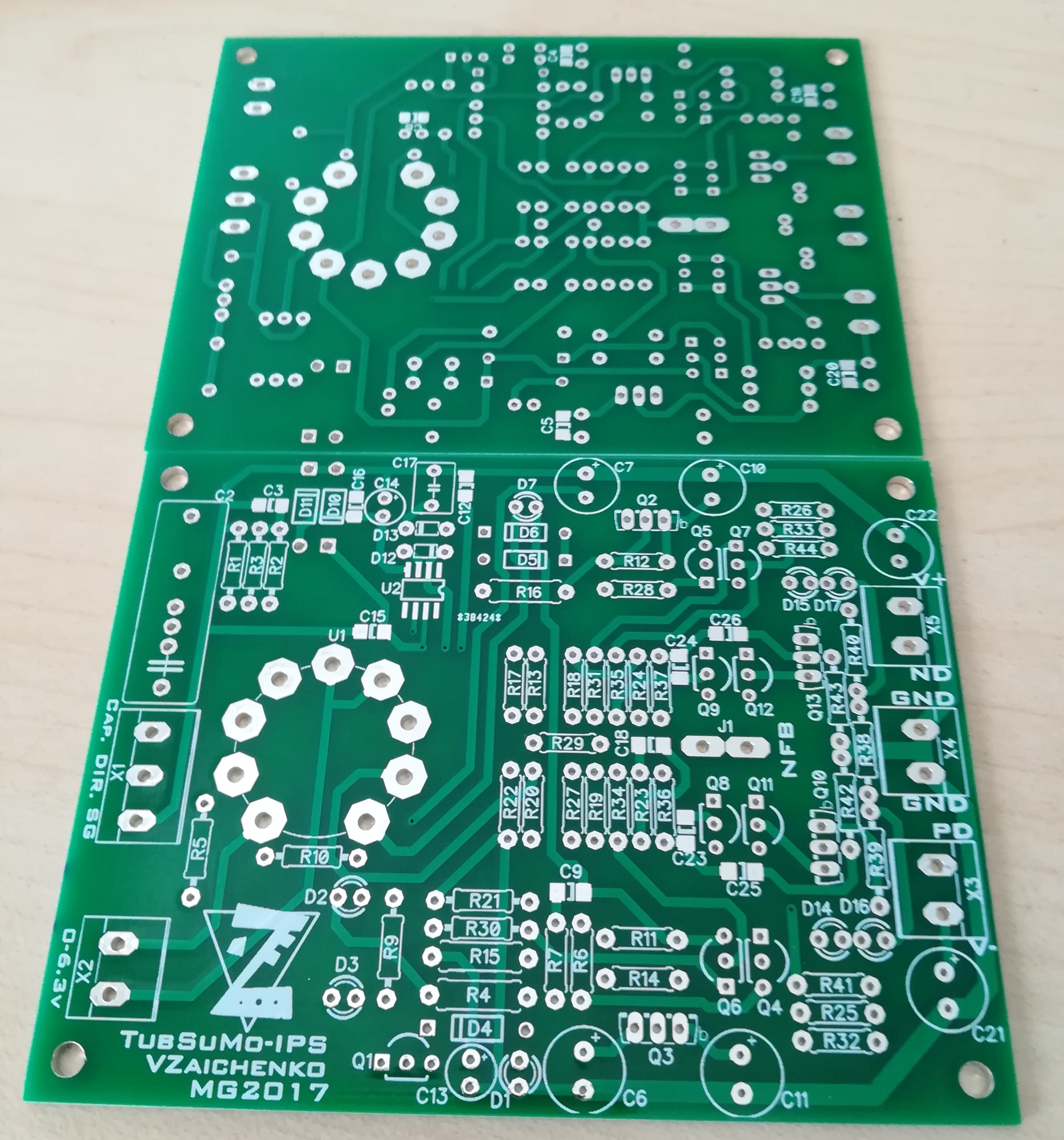

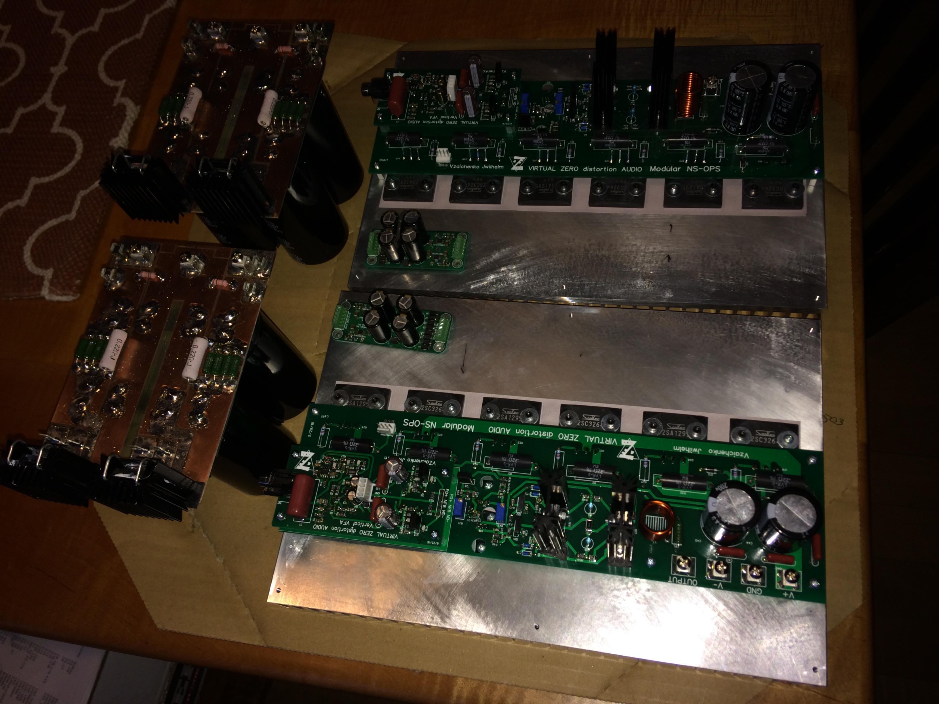

Thanks Terry. I populated the amp boards almost a year ago. Just got to try them today and was super pleased I hadn’t messed up any of the surface mount soldering. The caps and resistors are easy but the little transistors and such are hard for me.
Agreed, those tiny transistors are really hard to do by hand. I still haven't finished the big OPS boards. I really need to set aside some time and get them done.

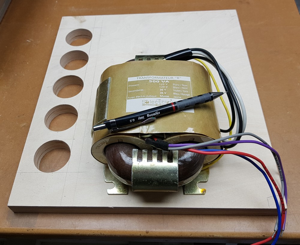

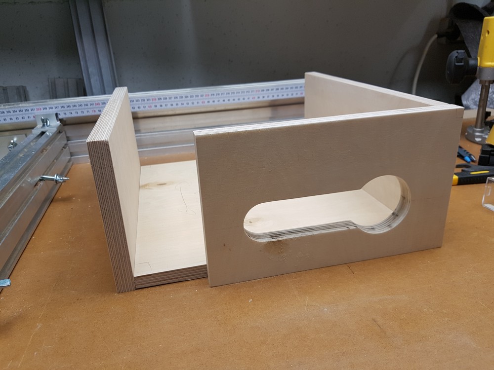

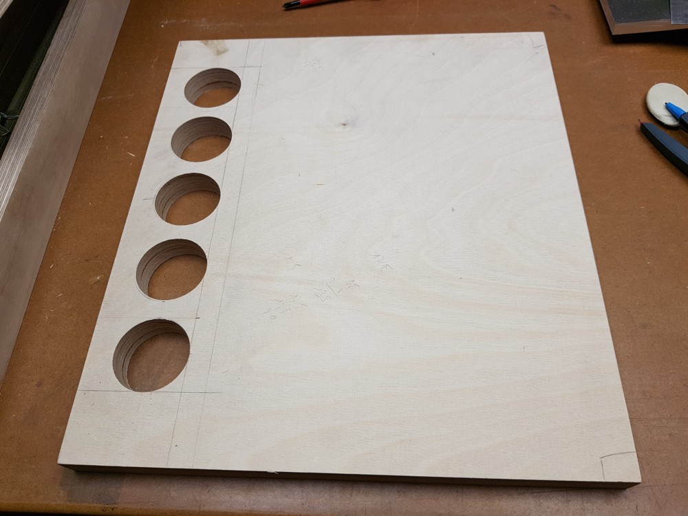

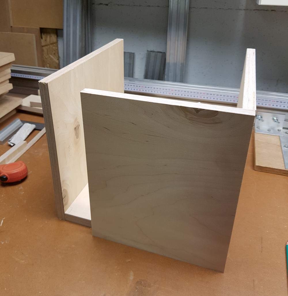

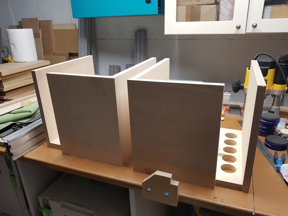

Amp construction : based on NS-OPS and TubSuMo-IPS
All Multi plywood will be veenered with walnuts veener and and non close portion will be closed with aluminium
The trick to soldering smt is tools, experience and technique. you need good magnification, lighting (esp for us older farts) and a steady hand. I have one of those head bans, a big eye with lamp, and a 10x jewelers loupe. Sure a nice Leica stereo microscope is the best but I can get it done without one.
The biggest issue is positioning the part.
Paste and hot air is one method.
for hand soldering i do this
rest you wrist on a solid surface, it will steady's your hand and tweezer. open the part from the carrier on the pcb. sometimes it is pita to remove plastic strip, esp from the old school paper backed carrier, but that was mostly for passivies. using small gauge solder is important. I use glow core no clean eutectic, having the lead helps. pre tin, very little solder to one pad, for sot23, do the one that is on its own, pin 3, then position the part with tweezers by sliding it over, on the pcb, to the position, reheat the pad with the pre-tinned pad to bond, then do the other pins, finally add a touch more solder to pin3, inspect with the 10x loupe to be sure = done
