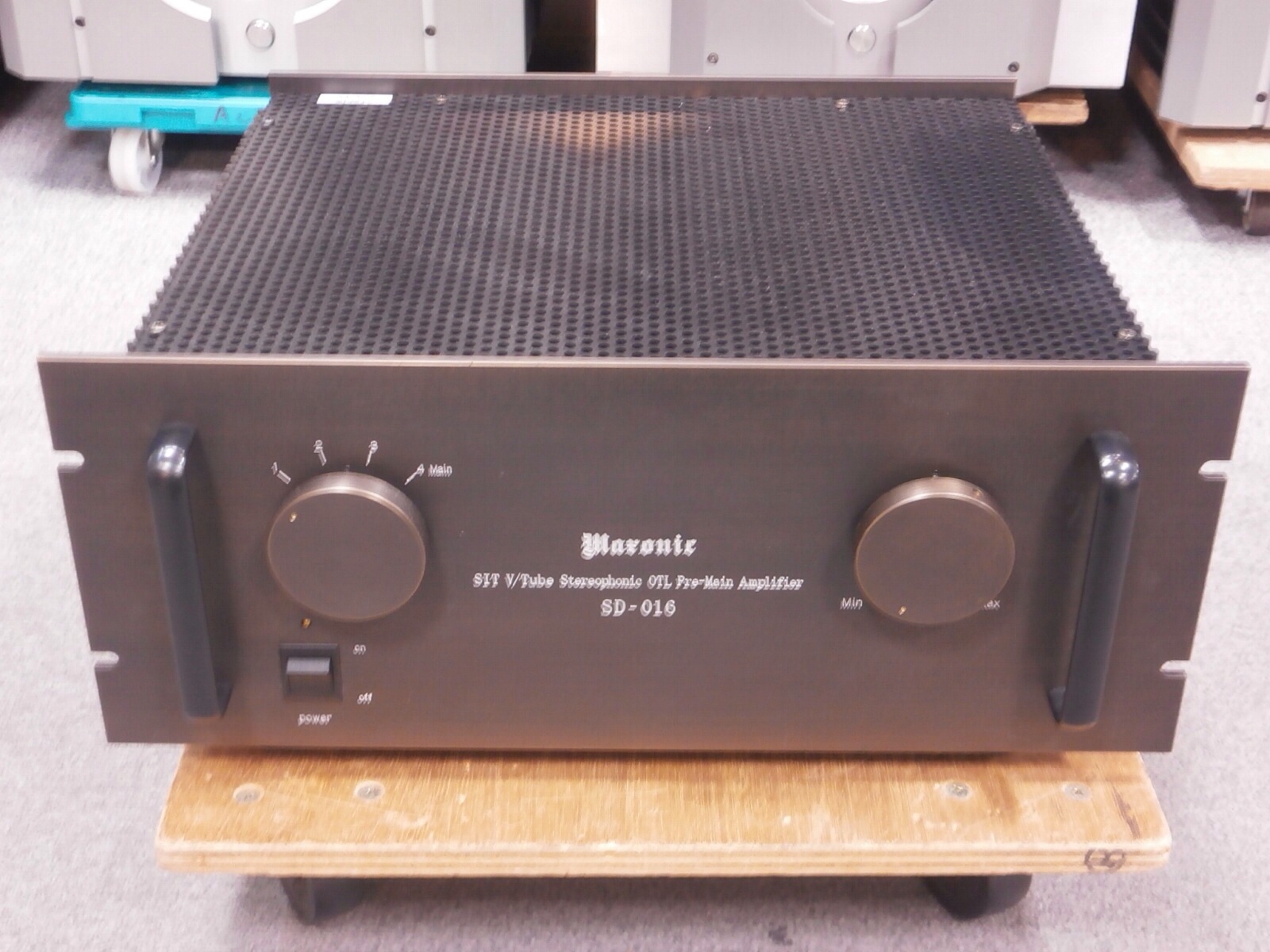

I know audio amplifiers examples with all models of Tokin Sit's.
Japanese audio industry Maxonic brand creates commercial products with them so logicaly they are good..

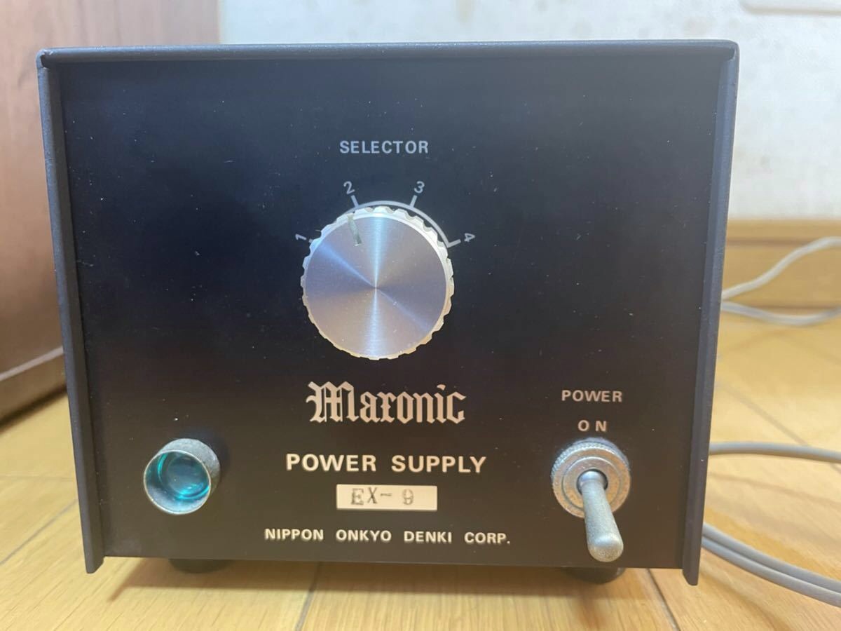

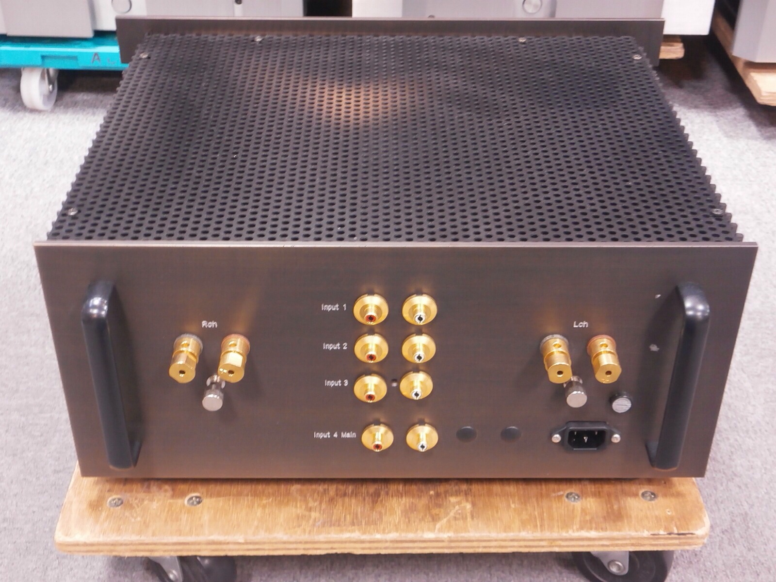

What an unfortunate name and font choice. Took some squinting to see they weren’t called Moronic.

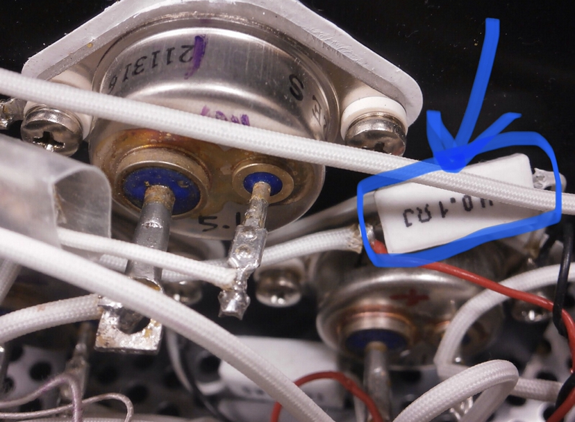

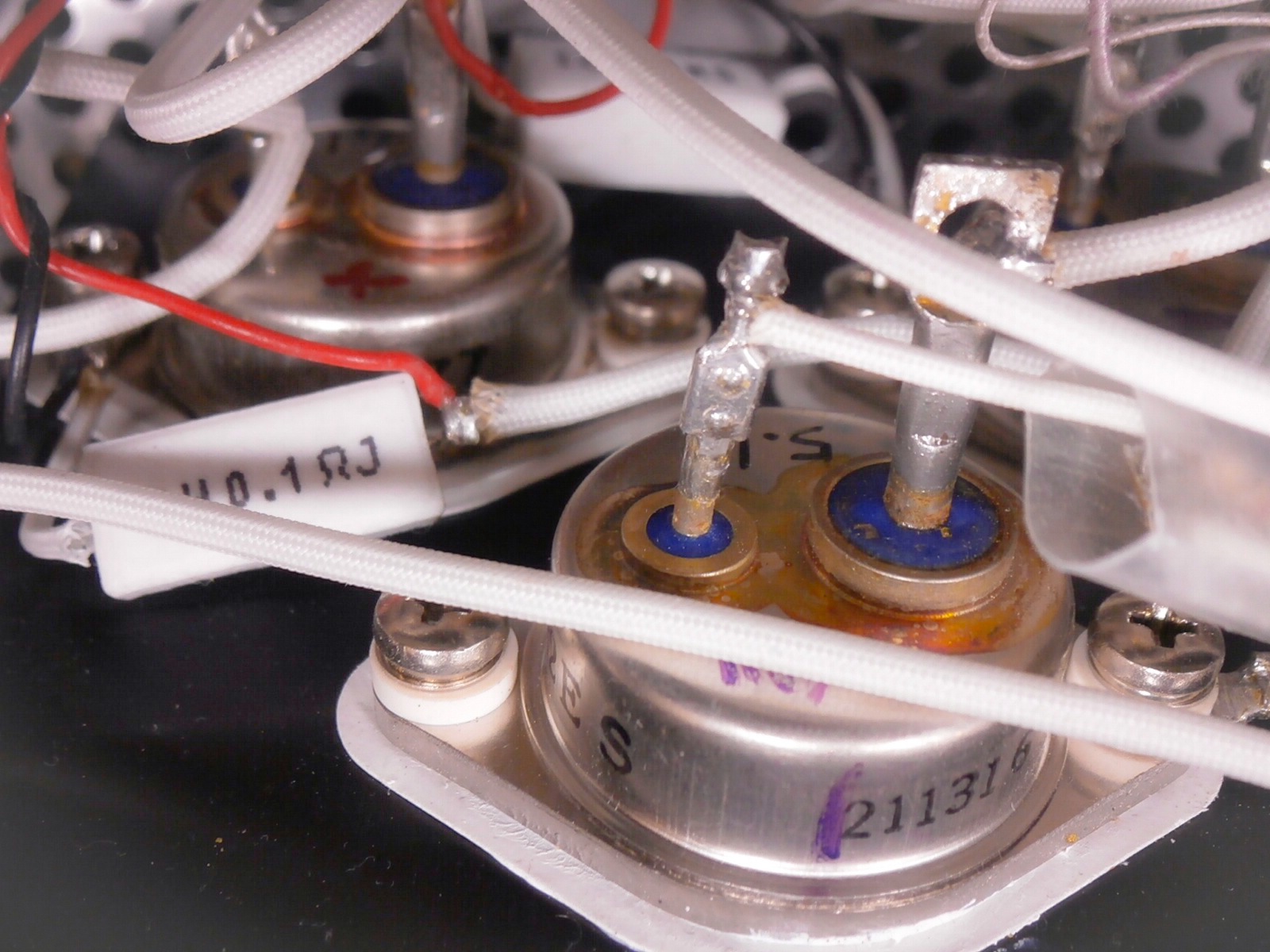

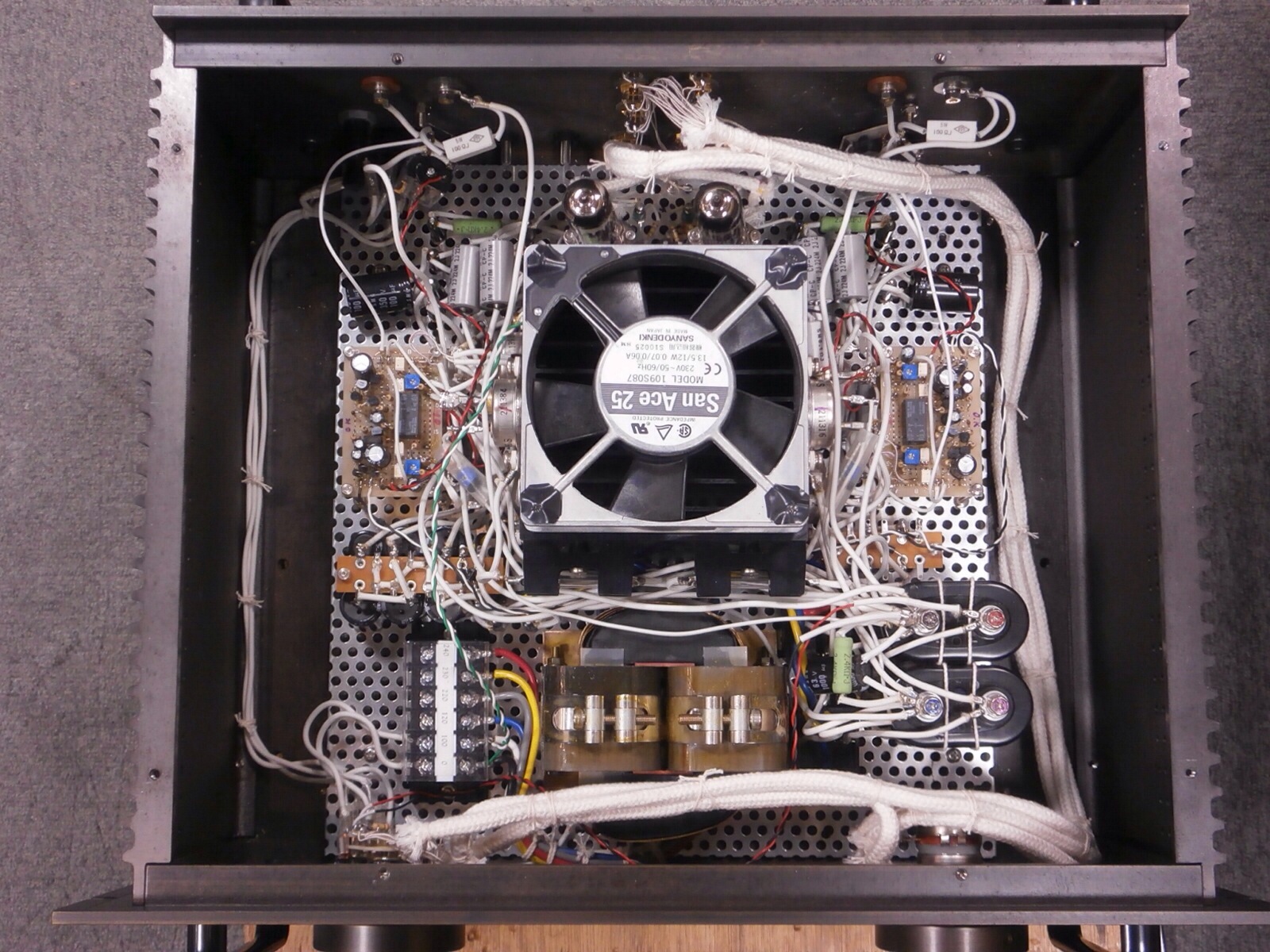

😀 four 2SK182 ES inside for stereo
Cable Spaghetti. 😀
I'm not so sure of their cooling strategy though... 😱
That Maxonic (funky font makes it look like it is spelled Moronic indeed) uses those white cement filled wire wound resistors - these are not the best choice for a high end amp as they can add third order harmonic distortion when used next to power output devices (source or emitter degeneration) with lots of current flow. I discovered that switching to bulk metal non-inductive resistors dropped the THD by ~15dB and converted it to second order dominant harmonic distortion on my amp (KOA BPR’s 5W works very well here).
Those Tokin parts aren't really suitable for audio, they're high power switching devices. The 8000 pF input capacitance would make them useless.
That's lower than the IHF standard input figure at 10 nF. Not much of a problem.
I agree with you , not optimal cooling solution ( use heatsinks is better )
even for an AB class amplifier.
I am scratch my head slowly and ask:
" What work does this two 2SK182 ES in the one mono channel ? "
Haiqu Victor amp is classic N P devices push-pull 😀
@ Baeijsman
Haha yes 3 pcs. for mono..mysterious amp topology..
You have excellent eyes congratulations !
Was not easy to see with all this mess of the " spaghetti " wires and not rotate image.

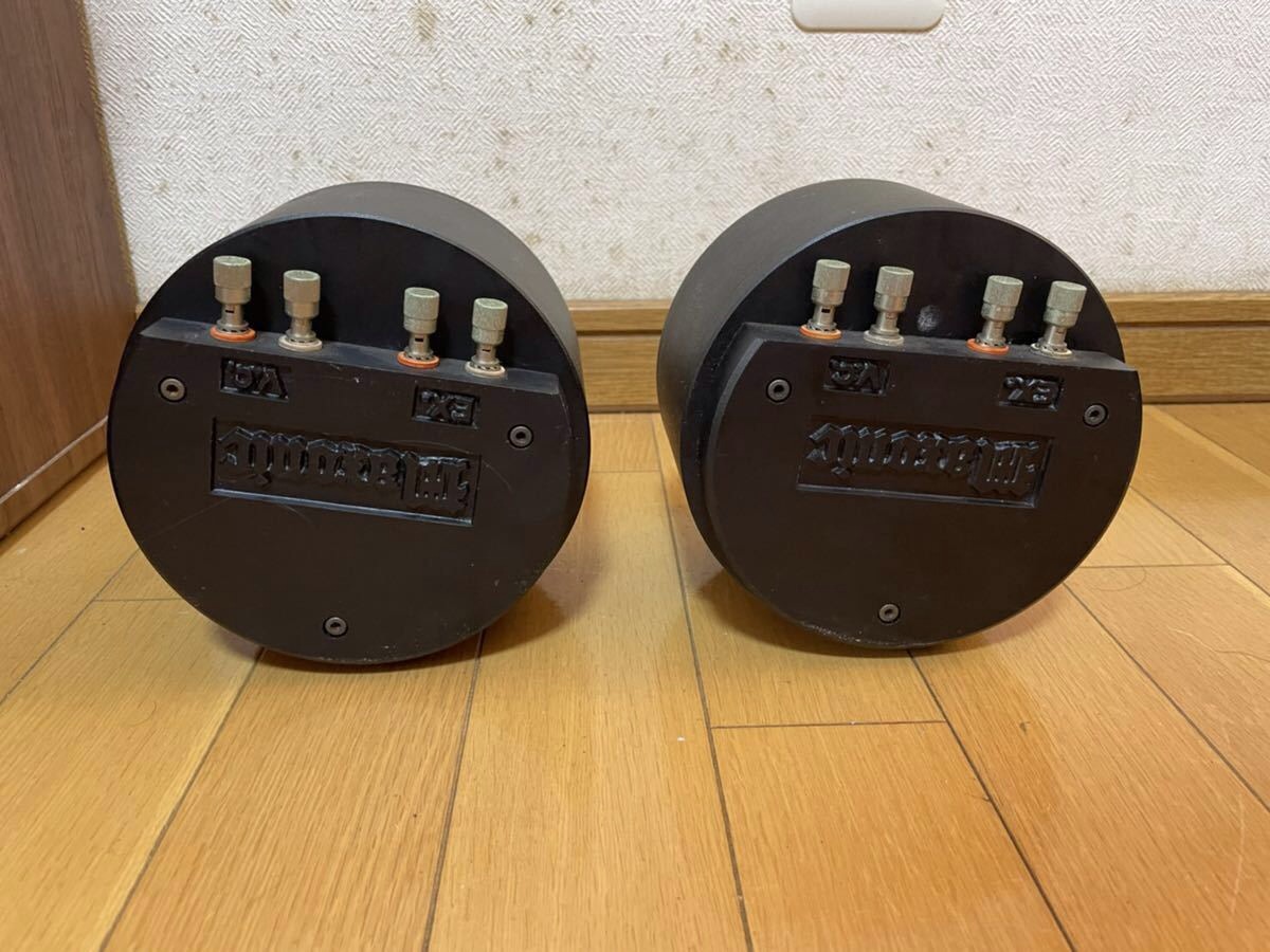

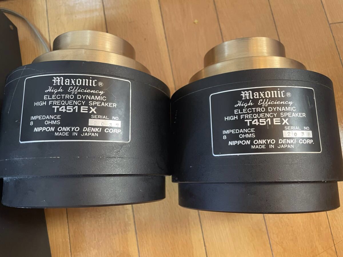

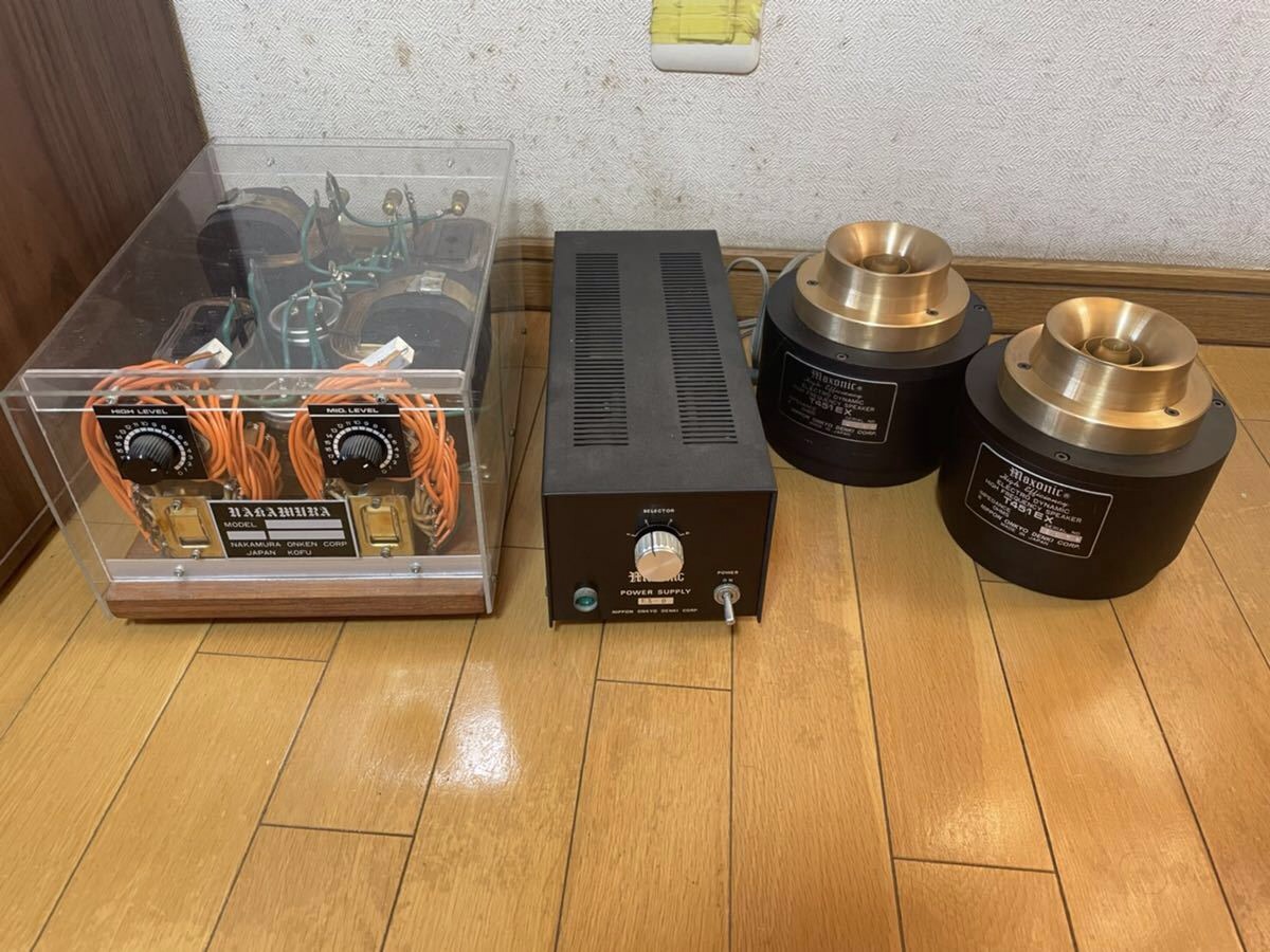

BTW Maxonic produce field coils drivers and more..

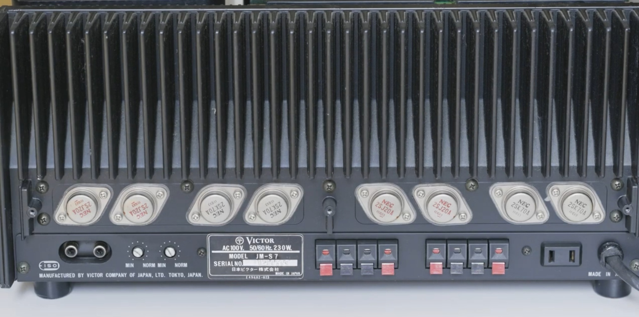

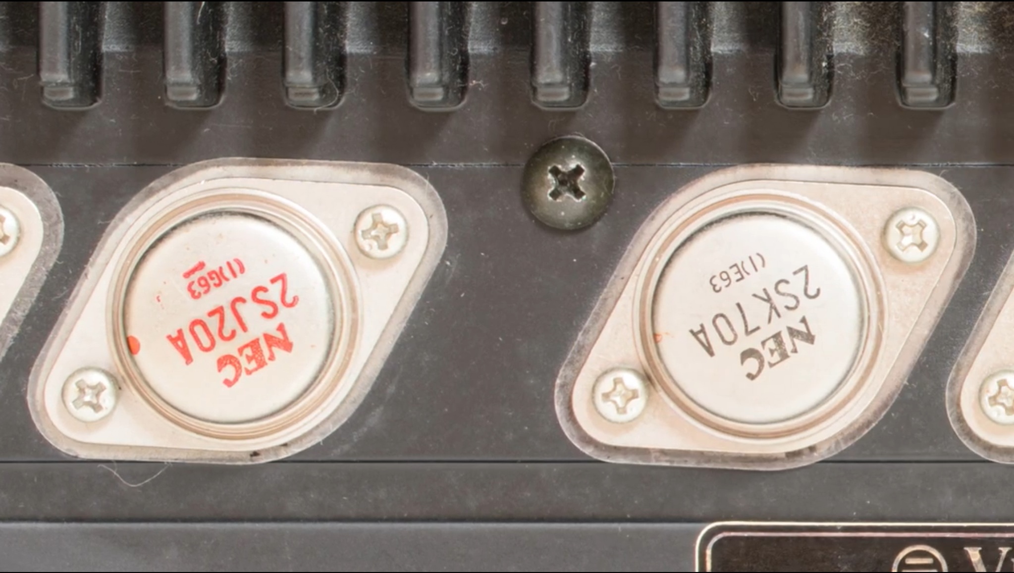

Vfet in the Victor amp are special A versions made by NEC
Victor (JVC) JM-S7 Review - V-FET at its best - YouTube
