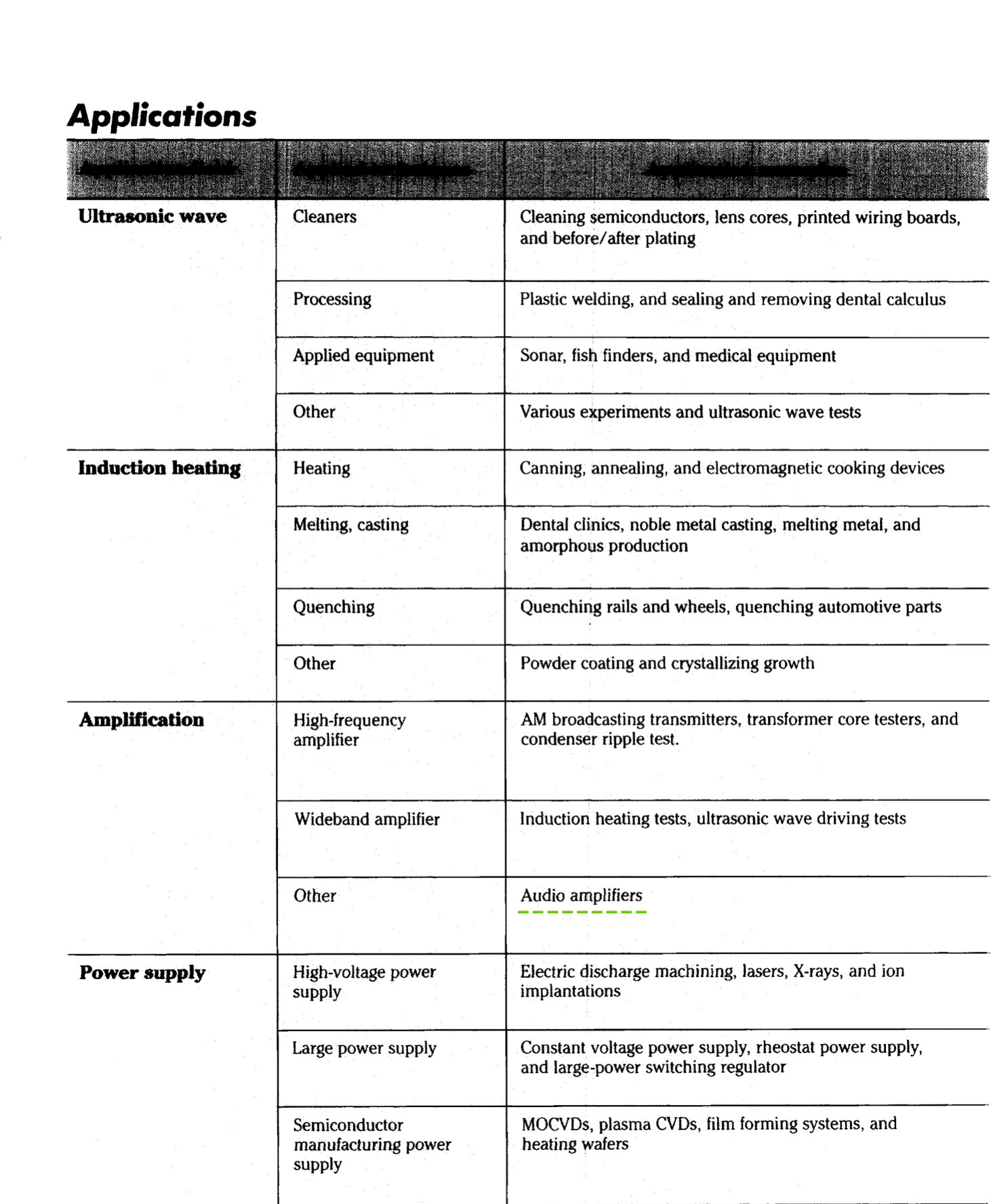

In Tokin catalogue you can see application list with : audio amplifiers 😀
Capacitance are not big deal if Diyers use simple Papa jfets buffer at the input of the power stage,
audio frequency response bandwith are generous..
Have fun with vintage Victor..be curious and in the next step try class A audio 😉
Capacitance are not big deal if Diyers use simple Papa jfets buffer at the input of the power stage, audio frequency response bandwith are generous..
Sure, but which device are they referring to there? It's a bit hand-wavey and vague, and in any case manufacturers have a duty to tell you their parts are suitable for almost anything, just so they can sell them. The 2SK280 with a Ciss of 2500 might be usable, but it would still be an almighty compromise. Let's face it, the Tokin parts are very industrial.
Well that was a bit condescending, not that there's anything wrong with that. The Victor amp does operate in push-pull Class A in part of it's range, from 10 to about 50 watts output. But I gather you meant "single-ended power-wasting constant-heat-producing Class A" which I personally see as a bit of a misuse of good parts that could be employed more effectively.
I gave up single-ended Class A when I stopped making 807 amplifiers out of old WWII transmitters in 1969. Some people just take longer to learn I guess, or maybe people from the colder parts of the northern hemisphere simply don't see the extra room warmth generated (and corresponding power bills) as a downside.
