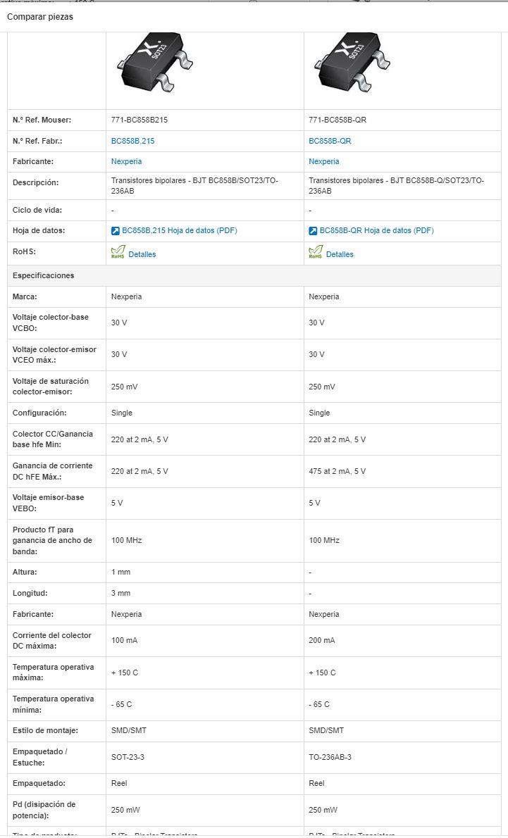

Transistor BC858B,215 is out of stock at Mouser. It seems his closer one is BC858QR, does is allowed as substitute?
Yes, no problem. BC858B-QR is the automotive qualified version of the same transistor.
(I thought for a moment that the package was different, but it isn't; SOT23 and TO-236AB are two different codes for the exact same package.)

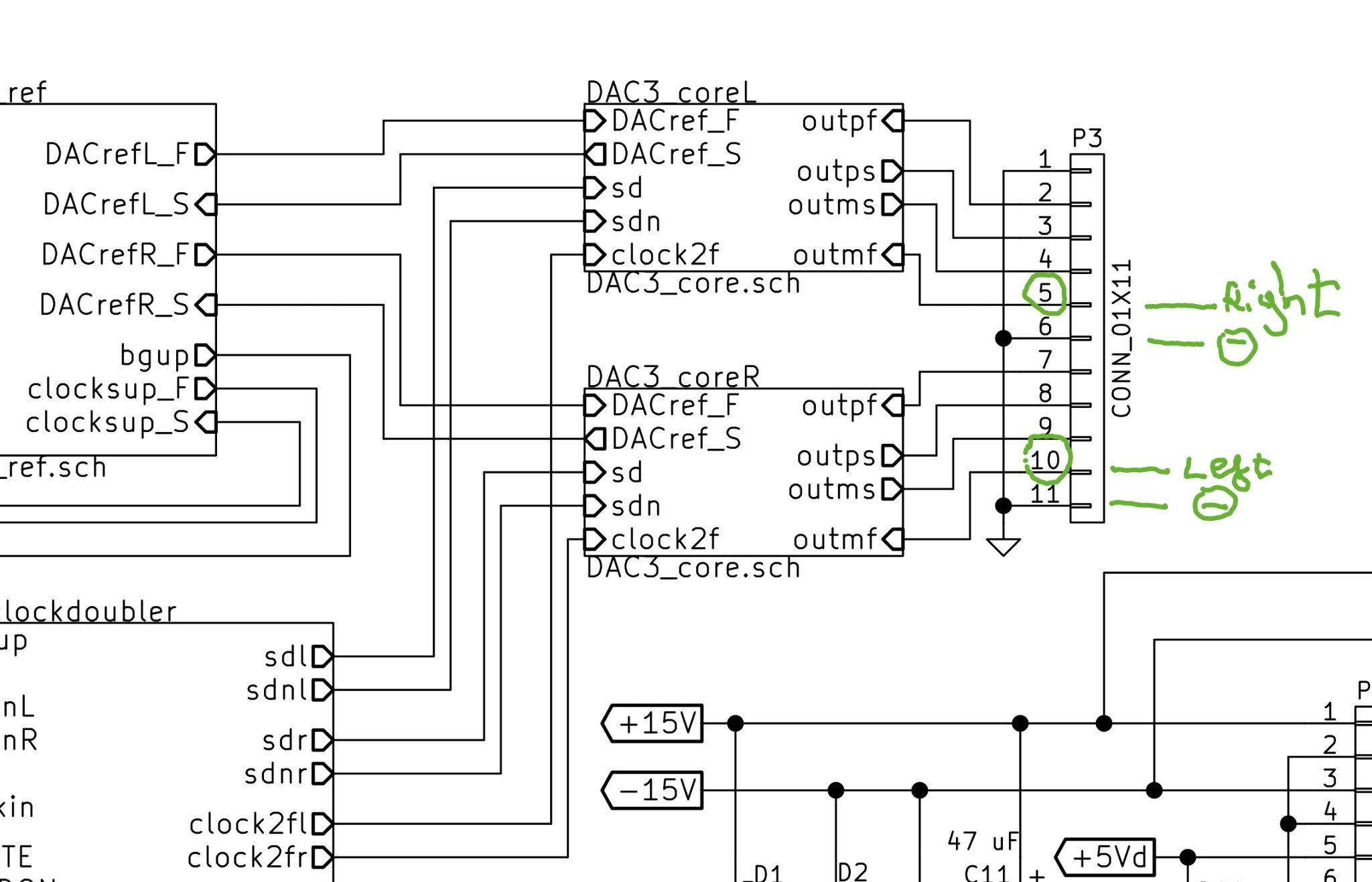

Please see atch. screenshot, do is correct my wiring for single ended putput?

Also, I believe OUTPF is probably the in-phase output signal, not OUTMF. Also, maybe better to look at sheets 3 and 4 at this point. The left and right signals can be seen to be interleaved between shift registers. So the problem may be the digital signal for one channel is not coming into the shift registers. In that case you might need to look at sheet 5.
You are using the inverted sides and left and right appear to be swapped (unless your USB interface has them swapped compared to an Amanero), but yes, you should get sound left and right.
What happens when you use the positive pins, so 2 or 3 and 7 or 8?

I confirmed now OUTPF (pin 7 in P3 connector_01x11) is much better sounding than OUTMF (pin 10)Also, I believe OUTPF is probably the in-phase output signal, not OUTMF. Also, maybe better to look at sheets 3 and 4 at this point. The left and right signals can be seen to be interleaved between shift registers. So the problem may be the digital signal for one channel is not coming into the shift registers. In that case you might need to look at sheet 5.

Thats right Marcel, I noticed just after upload I typed R and L wrong.You are using the inverted sides and left and right appear to be swapped (unless your USB interface has them swapped compared to an Amanero), but yes, you should get sound left and right.
Pin 2 is dead.
Using pin 7 improves the sound Vs. pin 10, but still something faulty on this channel. Sound can be harsh before components burn in, but not weak.

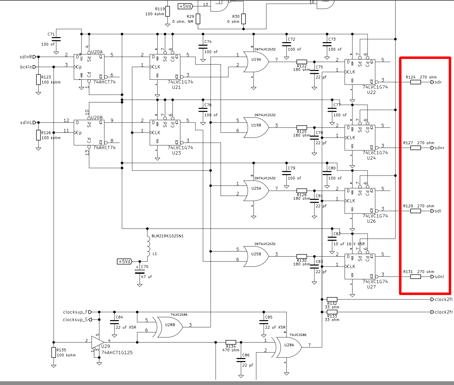

On sheets 3 and 4 of the latest schematic that Marcel posted, the digital non-inverting and inverting signals are outlined in red below (signals to check with a scope):
sdn for the negative or inverting signals for each channel (negative serial data). sd is for the non-inverting or positive outputs (serial data).
Those signals come from sheet 5 of the schematic:
You should make sure those resistor values in the red box are actually 270R.
There are many fault finding measurements you could even do with just a multimeter, a makeshift low-pass filter and some audio equipment, but as you have a good digital oscilloscope, it makes sense to use it.
U7 and U9 require a reference/supply voltage, a clock signal and two data signals to do their job, so you can check if they get all of that. To reduce the risk of shorting things while probing the circuit, I would measure at nearby resistor and capacitor pins rather than directly at the IC pins.
While playing a DSD signal, using your scope and a 1:10 probe, you could check the following voltages, all with respect to ground:
Is there about 5 V on one pin of C19 and C21?
Is there a clock signal of about 5 V peak-peak at twice the bit clock frequency on both pins of R132? It should consist of pulses of about 8 ns long. It's normal when you see a slightly short period, slightly long period, short period, long period and so on.
What do the data signals on both pins of R129 and R131 look like? If you see a signal, could you do a single-shot measurement?
What do you see on R126?
