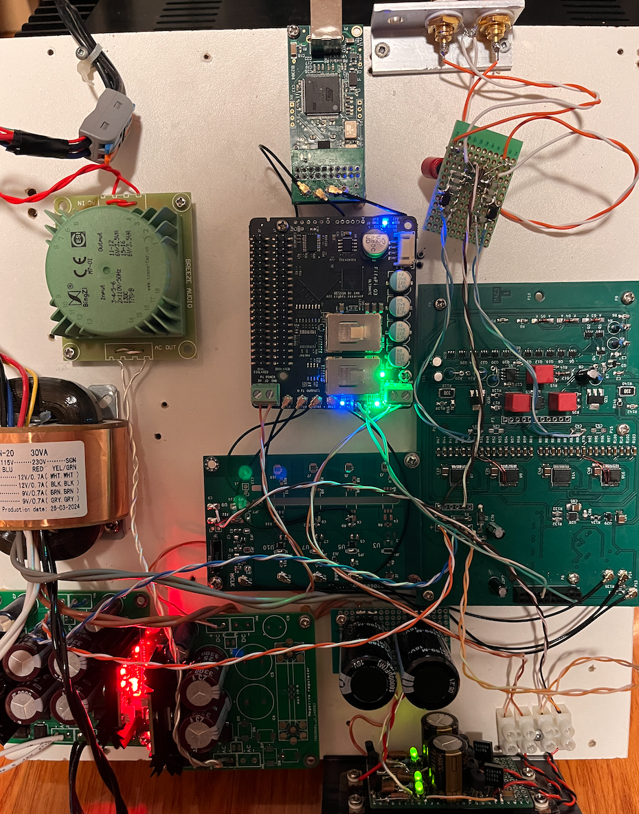

Added Markw4's reclock board, further improved clarity.
With hqplayer at -6db, output is very low probably 100mv.
Combo384 - IanCanadaFiFoPi - Reclocker - FIRDAC - 45K Butterworth filter - DC blocking capacitor (with mute relay)
Super regulator - FIRDAC +/-15V
Salas Reflector-D - FIRDAC 5V - reclock board (3.3V)
Salas Reflector-D - FifoPi 3.3V
Super regulator - FifoPi 5V

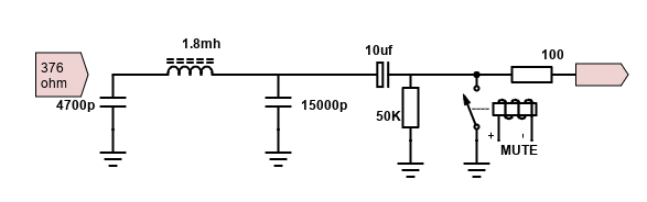

Just for experiment,
1.8mh RF inductor, LQH43NH182J03L from mouser, has high resistance though.
4700pf, 12063A472JAT2A from mouser,
For 15000pf, just 3x4700pf//1000pf
I used black gate N for DC blocking, tiny with very relax sound.
Output is very low, probably 100mv with hqplayer @-6db, I put a 6J51P stage (50-70x) after.
Rewired, shunt regulator to the FifoPi 5V and 5V super regulator to FIRDAC & reclocker. That brought back the bass.
I guess shunt regulator helps FifoPi a lot, while 5V feed to FIRDAC and reclocker board shouldn't have that much impact.

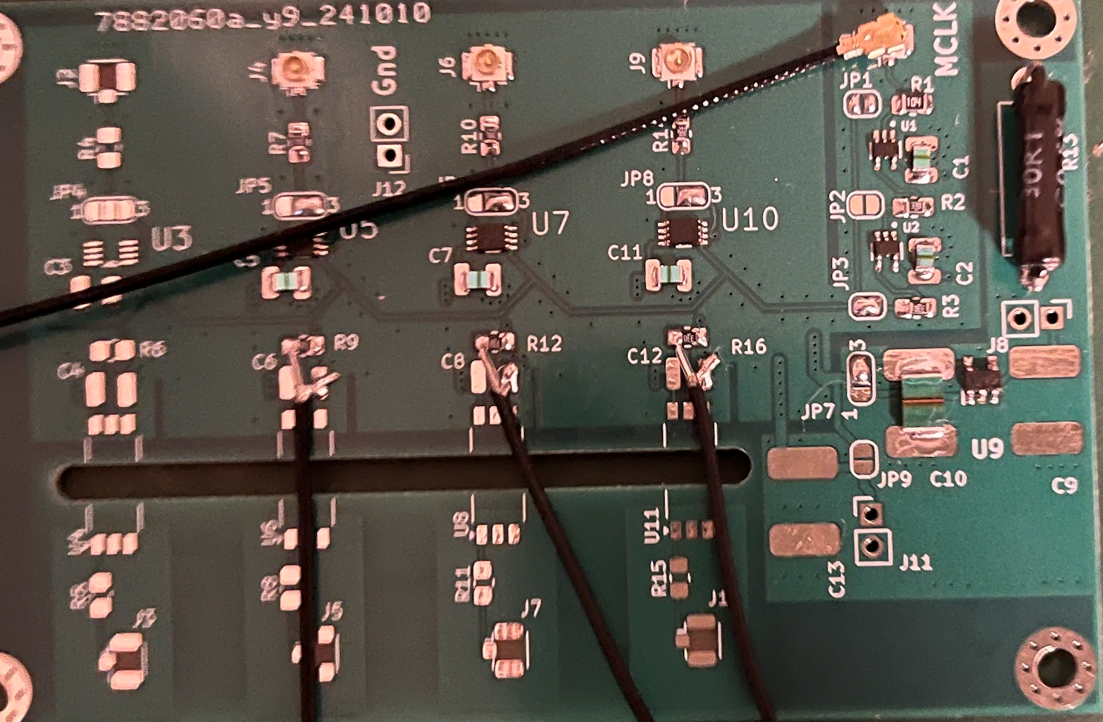

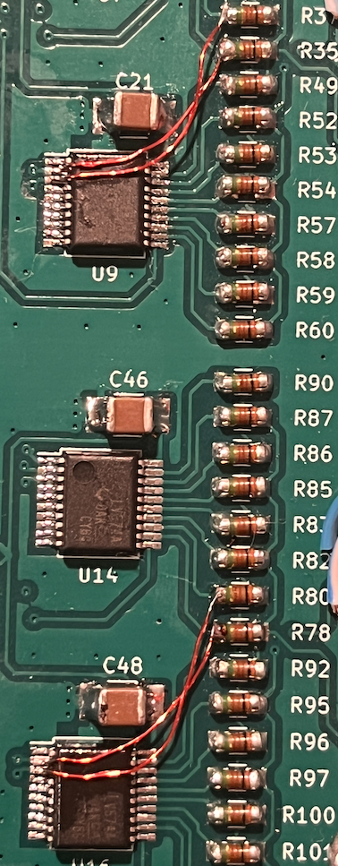

Would like to add to what 2A3SET has recently posted. Heard a recording he made of his dac with its passive output filter and with Iancanada clocks. The recording sounded very good on my system. Therefore I would definitely recommend giving his approach a try.
Also, he used my reclocker board while bypassing the isolators. Looks to me like he did a good job of hacking it a little. Looks like this:
