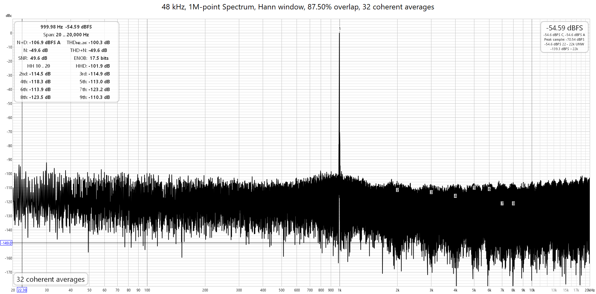

It refers to one of the products made by @IVX. IIUC its an amplifier and notch filter box that works at 1kHz and 10kHz. It can be used with the Cosmos ADC or some other ADC for FFT measurements. IVX is good at making low cost measurement devices. IMHO they can't sound that great, but for taking standard FFTs they actually fit the bill pretty well. And they are popular. https://e1dashz.wixsite.com/index/cosmos-apu
So it's part of the audio measuring equipment. It's strange that the out-of-band signals at the audio output were still large enough to make a connector produce measurable intermodulation products, although those products were extremely small. Some crosstalk due to a poor connection maybe, causing more than the usual amount of stuff around fs/2 to reach the APU?
Unless you really have a rotten contact, you normally need fairly large signals to get measurable passive intermodulation distortion. The peaks around fs/2 and its odd multiples (5.6448 MHz and its odd multiples for DSD256) that cause second-order intermodulation products in the audio band get suppressed by the FIRDAC and the analogue reconstruction filter. I'm surprised there is enough left of them to cause measurable passive intermodulation distortion, but then again, the levels were extremely small.
Anyway, good reason to use gold-plated headers between the DAC and the filter board of the DAC of this thread (like we already did). The peaks around fs/2 are only suppressed by a short FIRDAC and one capacitor there.
