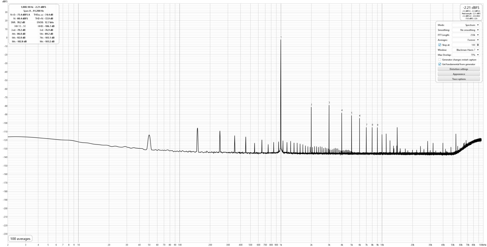

hi,Cestrian:I have attempted a few measurements of one of my RTZ DACs to compare balanced and "SE" modes quickly. Disclaimer: I am new to the software and the equipment to do the tests so please don't shoot the messenger! 🤓
The only ADC I have is a Behringer UMC202HD so that had to do. I'm not using any fancy setup to try to isolate the PC from the measurements so as far as absolute readings go I have no idea if we're seeing the test device or the ADC/PC or external influences..
However, since this is a comparative test then I hope the figures will mean something to someone more than they do to me.
First up is the opa1632 filter configured as balanced but with the 100uF output coupling capacitors still fitted since it would've taken me longer to remove and re-apply them.

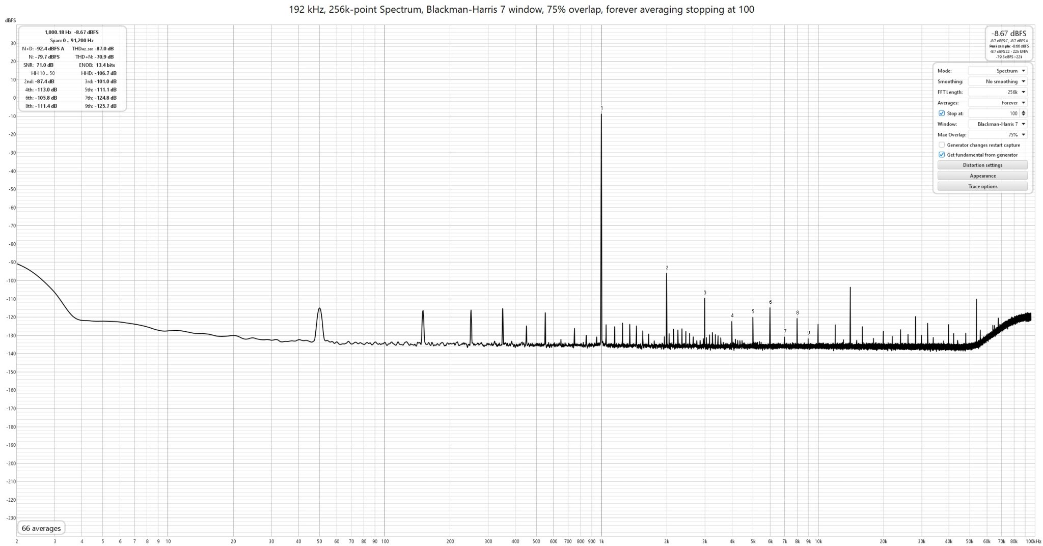

Next up is the "SE" mode where the -ve input to the filter op-amps are disconnected from the DAC and connected to ground through a resistor.

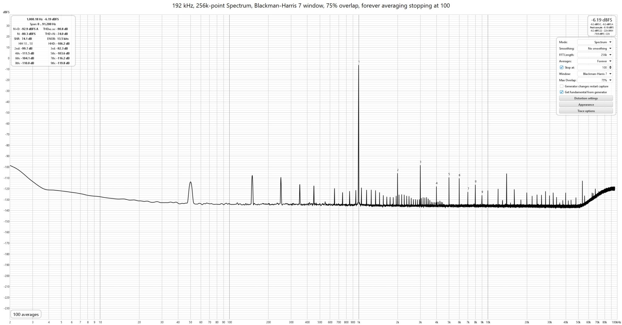

And finally, I added 2 x 200R resistors on the un-used DAC outputs to ground to approximately match the loading on the used ones.
Interestingly 3rd harmonic seems to increased while 2nd harmonic reduces. I am listening now with the loading resistors but I haven't had enough time to really hear whether it has affected the sound in any way.
These are not really the results I was expecting. I can't help think my testing process is not capturing the reality.

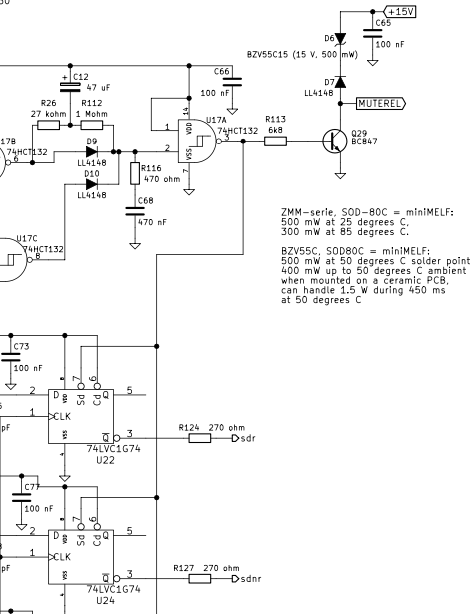

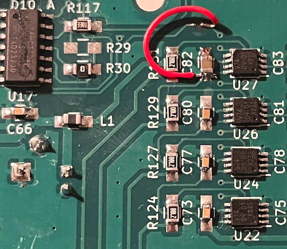

Experimented single end passive output with 3rd order Butterworth filter,
Leveraged same MUTEREL pin as the filter board to shunt the output after dc blocking capacitor,
Sorted out a quick solution for the mute function otherwise the pop during tracks esp sample rate change is pretty loud,
Cut the trace for mute-Pin7 of 1G74, and tied to Vcc.
Pop noise is still hearable while much weaker
Will try analog switch like TS5A3167DBVR for quicker response.

The relay is after the DC blocking capacitor.
When mute is engaged, it resets the 1G74 so output data are all 0, this introduces the pop for single end output, while has no impact for balance since +/- sides are same.
The silly thing is that in a very early version, you could simply change some 0 ohm resistors to have the mute function disable the outputs of the 74LV574A's instead (drive their "output enable not" inputs high, pin 1). As the present mute worked fine in differential mode and I hadn't anticipated that people would want to experiment with single-ended versions, I removed those 0 ohm resistors from the layout.
I remembered it incorrectly. On the prototype that I made, you could remove some 0 ohm resistors to get access to pin 1 of each 74LV574A, but then you still needed to add an inverter and wires to actually drive them from the muting circuitry.
In any case, you could still use pin 1 for muting if you manage to lift it and add an inverter and some wires. I know @Hans Polak lifts pins sometimes, but not how.

That's very easy.In any case, you could still use pin 1 for muting if you manage to lift it and add an inverter and some wires. I know @Hans Polak lifts pins sometimes, but not how.
First remove all solder from above with solder wick.
Heat the pin again and carefully slide a scalpel or lancet slightly between the pin and the PCB, just far enough to get a momentum to push the pin upwards.
Once the pin is separated from the PCB , you can carefully bend it further upwards.
Now a small diameter wire can be soldered to the pin to connect it to elsewhere.
