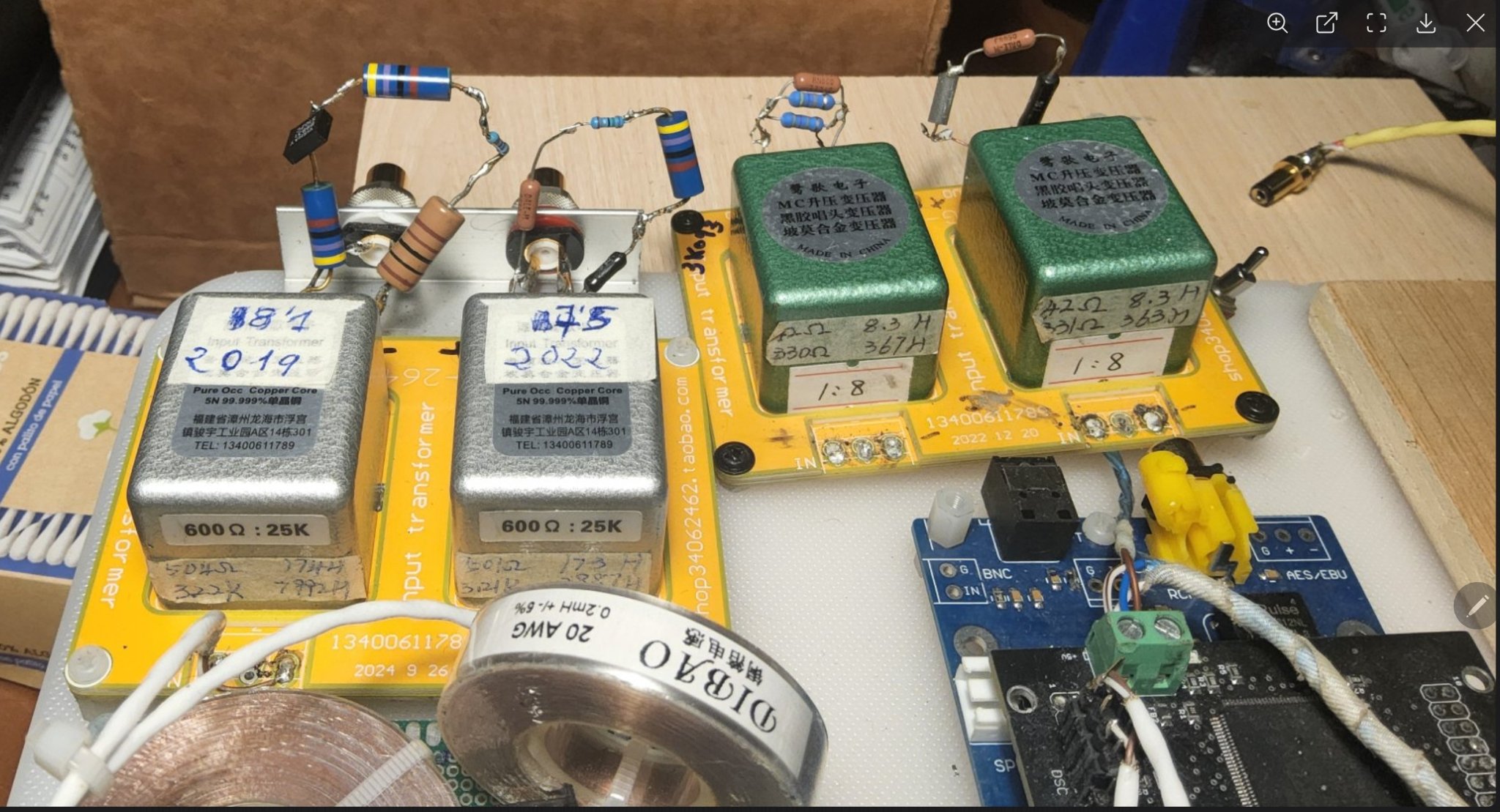

Concerning for Dac impedance, I had also adjusted the Rload for another step up transformer the green pair one on pic. right side. A 8X gain in this case.
I spent time tuning and finetuning (it pay dividents juicing the precision at extreme), end up with 3093 Ohm for best sound. Allright, the 8X stepup has Rload. Math: Rin (source impedance) = Load resistor (Rout)÷ X (amplification ratio)^2 = 3093 ÷ 64 = 48,3 Ohm. All in all before add Firdac, but as said yesterday, not seen much difference thereafter. I tought back at the time, the Firdac performs good at maintaining the integrity of the weak digital signal. As it does my passive filter, I got it specified to maintain the impedance.
Source impedance is 378x2, primary impedance of the transformer is 48ohm, gain 8x,
Total gain after transformer is around 1/2 of direct balance output from shift register.
This level is same as single end passive output.
Also you need buffer after transformer output, as 3K is too high to drive the IC and next stage.

48 ohm sounds like a good virtual ground, compared to the 757.5 ohm (differential) source. When the DAC is loaded with a (differential) virtual ground, that helps to keep data-dependent currents out of the reference supply small.
Just my experience for another dac project with transformer output.
Recently used BEHRINGER UCA202 with REW to test the frequency response of Bisesik D60 transformer (1:16), the curve is almost flat (actually -0.5db down from 9k to 16k) when source load resistor is dropped to 20ohm. Ivan suggested loading at the source is better than at secondary.

@2A3SET sure is worth to mention here as a caveat, agree it is a high impedance output at 2K (using a 6,5X stepup.)
Buy not appliable in my case, after the Dac I have LDR volume control, which has buffer isolation hability. Let me set a wide range of values in long calibration cicles both for nominal impedance and load impedance. I use it splitted from preamp and placed close to DAC.

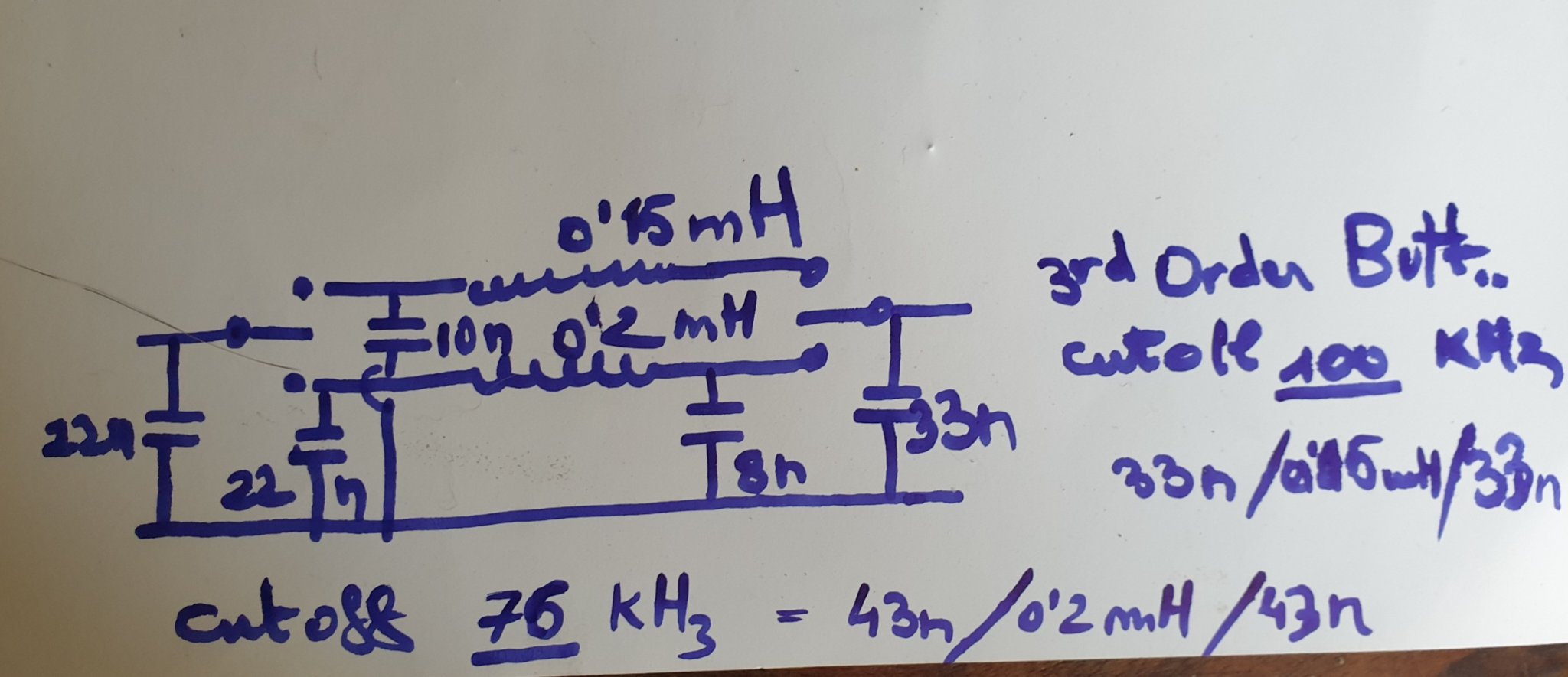

Don't have an exact answer. You might try 60kHz or so and see what you think. Its just that there is never perfect filtering, and filter components can go through self-resonance effects and impedance variations when higher frequency RF is present.Pease lets me know how much higher can I pick the cutoff frequency.
I filtered today 100kHz (DSD128) and still did'nt notice any issue. To the contrary, due to reduced inductance an capacitance (vs. filter at 75kHz cutout) , I listened an important upgrade to sound. Better slam/weigh bass together with much warmer and creamy timbre for high freq.

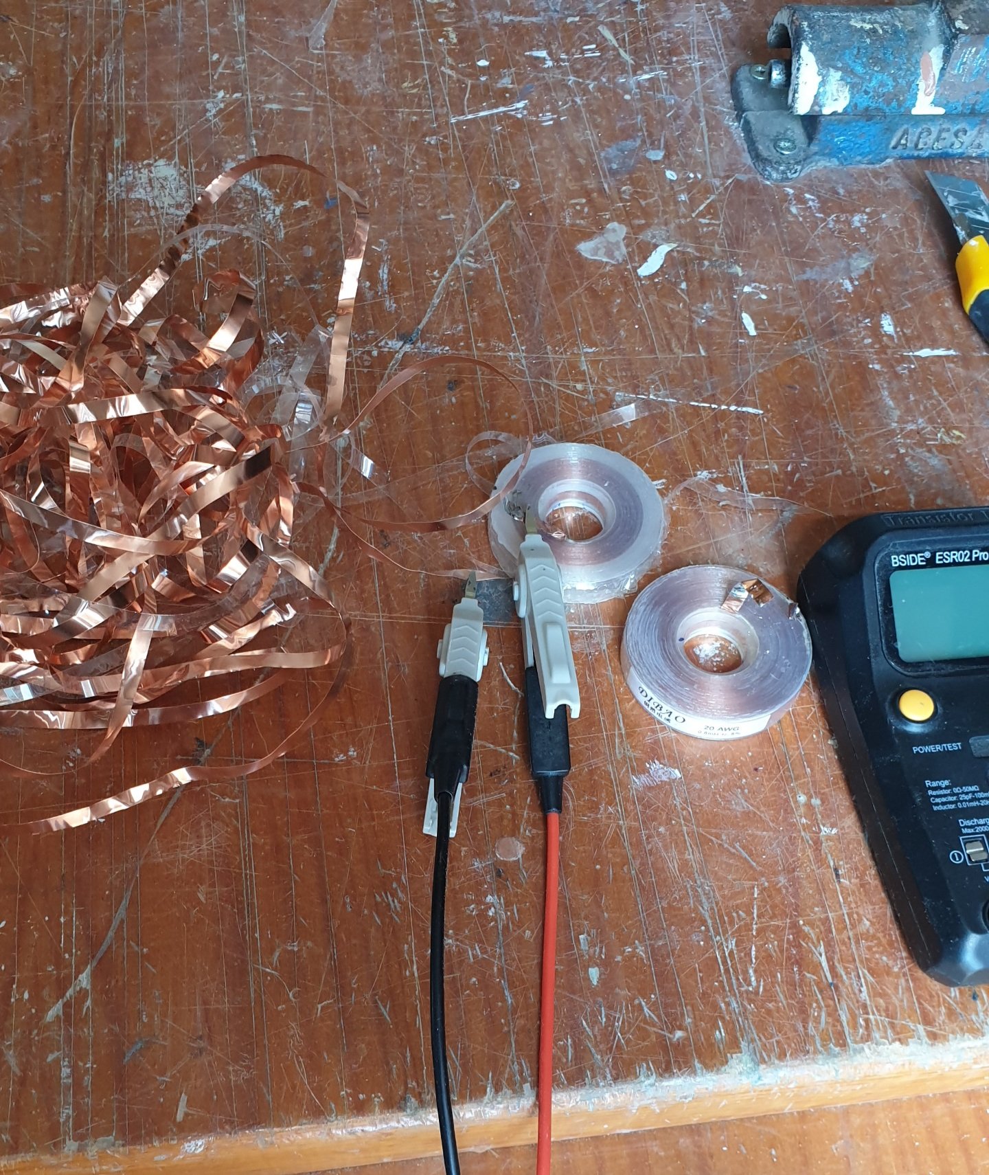

Here is foto peeling off copper turns to reduce inductance from a 0,5mH coil (now spare) to needed 0,15mH.

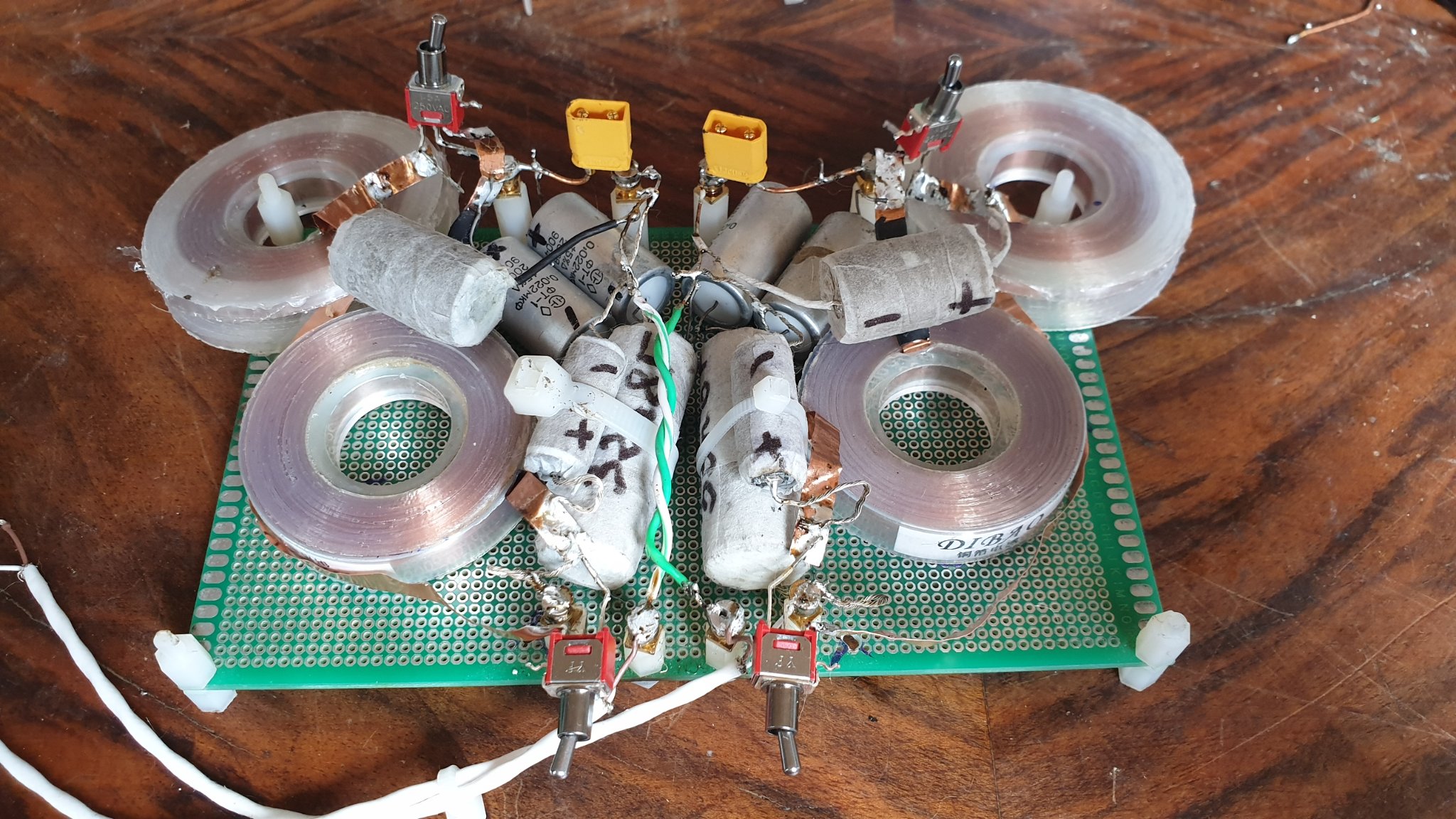

One channel schematic with two diferent filters with 2 switches to allow listening comparison without variables and "on the fly".
Stereo with 4 switches, easy to swap cutout 76/ 100 kHz
By the way, I simulated values for a 47 ohm Firdac impedance Out.
I do not further increase the cutout before upgrade to DSD256. Hope to receive the Xilinx soon.
