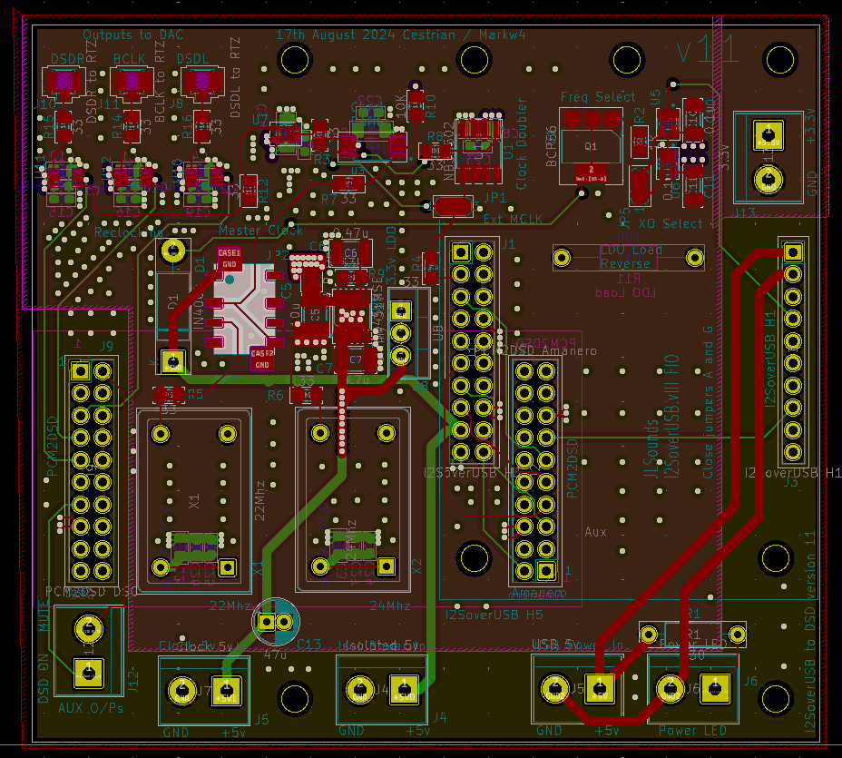

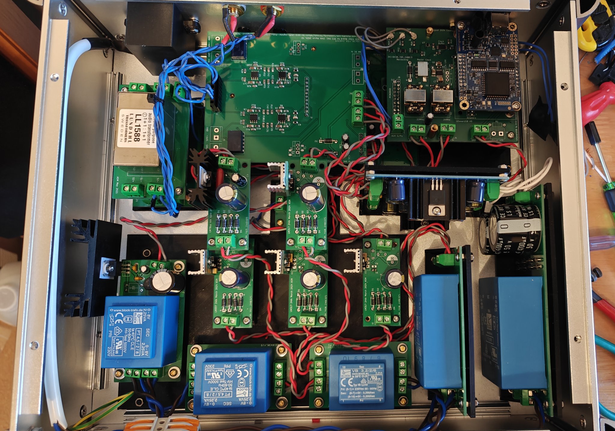

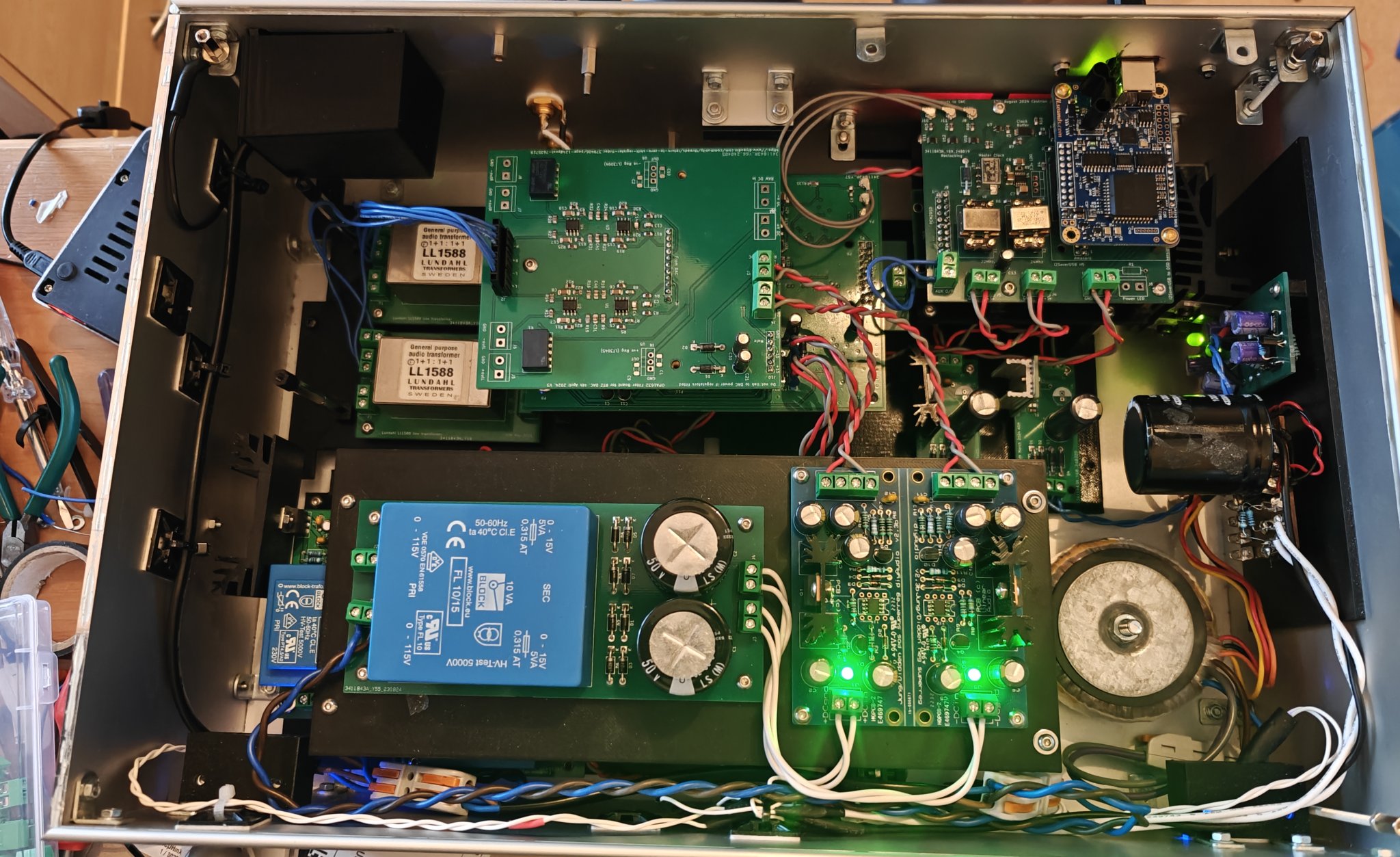

Latest iterations of my 2 RTZ DAC units:
DAC1:
DAC2:
I have gone away from Logitech SB Receiver and Transporter as streamers now and concentrated on piCorePlayers and JLSounds I2SoverUSB as that route is clearly superior. (Plus I get the option to use a PC to drive the JLSounds with HiRes and/or direct DSD)
With the help of Mark's reclocker and my own derivation of a customized subset specifically designed to fit into my available space in the enclosures I now also have external XOs and reclocking of the DSD signals. There are compromises made but it was time to get these projects completed to the point I can put the lids on and move to the next thing before my interest wanes. I was up to version 11 of the reclocking pcb so it was time to admit I'd reached the point of diminishing returns!
For anyone who wants to try out my interpretation of @Markw4's XO and re-clocking design I have attached the Schematic, Gerbers and BOM files,
My intention here was to try out external XOs and reclocking for the I2SoverUSB / PCM2DSD but also fit within the size constraints of my already constructed two RTZ DACs. After experimenting with Mark's design and also with his advice and comments I (eventually) arrived at version 11 of the pcb! I am not saying this is as good as Mark's design since I made compromises and went my own way on some component choices to an extent, generally to make the board fit the space I had.
I am positive that more can be done and perhaps I made schoolboy errors so please go easy on me! 🤓
I did have some issues with the switchover between the two XOs and this ultimately seemed to be the result of the clock doubler PLL throwing a fit when changing over due to the fact that initially I was also disabling the unused XO. The XOs are now on constantly. Anyway, the latest version has a few selectable solder pins to accommodate using either 22/24Mhz XOs or 45/49. (or indeed only using one of choice) Plus a site for a 3rd party 317 pin-out reg to experiment with different LDOs.
I should probably just make clear. What I just posted is a carrier board for both I2SoverUSB FIO and PCM2DSD. I2SoverUSB is on top and PCM2DSD is slung underneath. Connections to Marcel's DAC are via u.fl leads and the two aux signals DSDon and Mute are via hardwires,

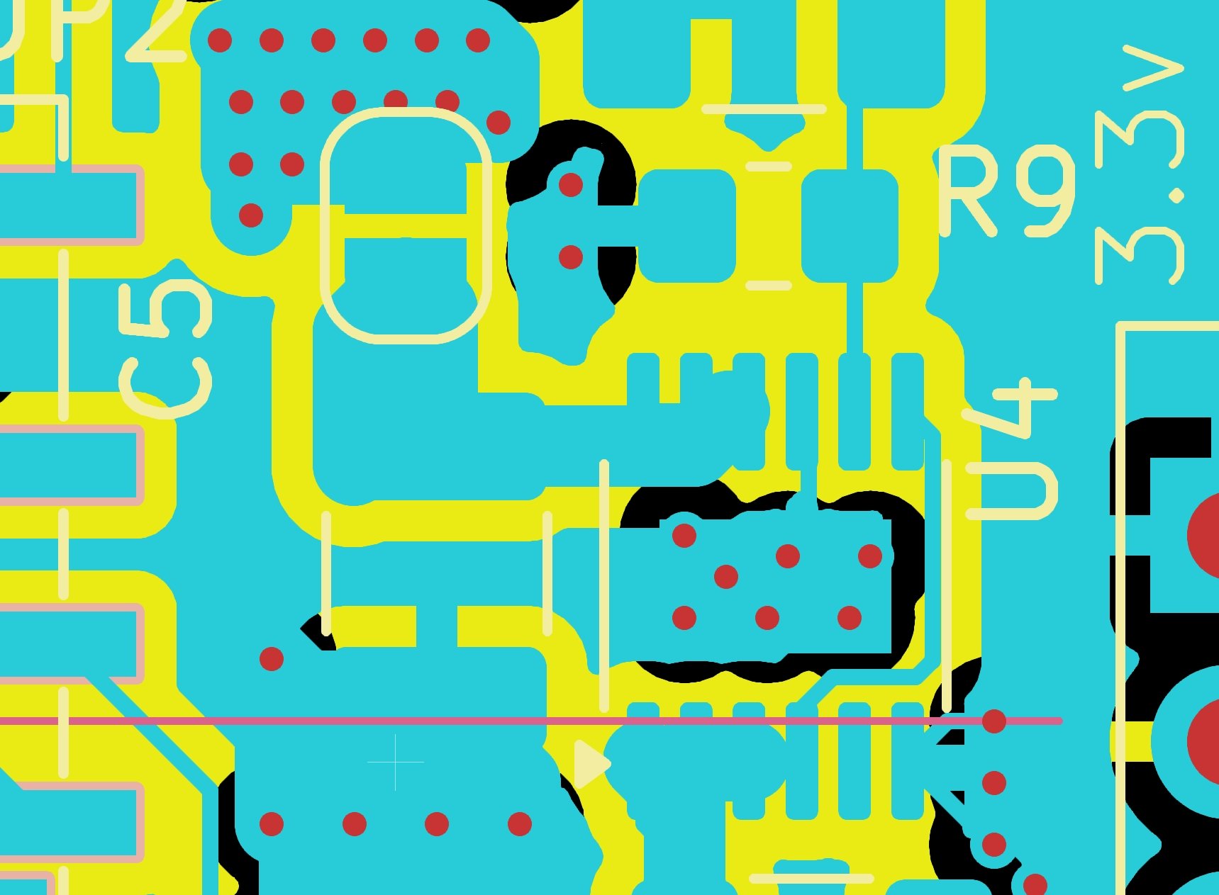

Hi Tony,
I see some issues with the gerbers you might want to check into. There are some areas of floating copper, which is not good. For instance the top copper layer looks the attached in Kicad Gerber Viewer. Areas marked in red appear to be floating. They should probably be connected by vias to ground (or some other net), or else made into rule areas where fill is not applied.
EDIT: From looking at the pic you posted, it appears there are lot of ground vias. Don't know why they don't appear in the top copper layer of the gerbers. Maybe the gerbers are from an earlier version?

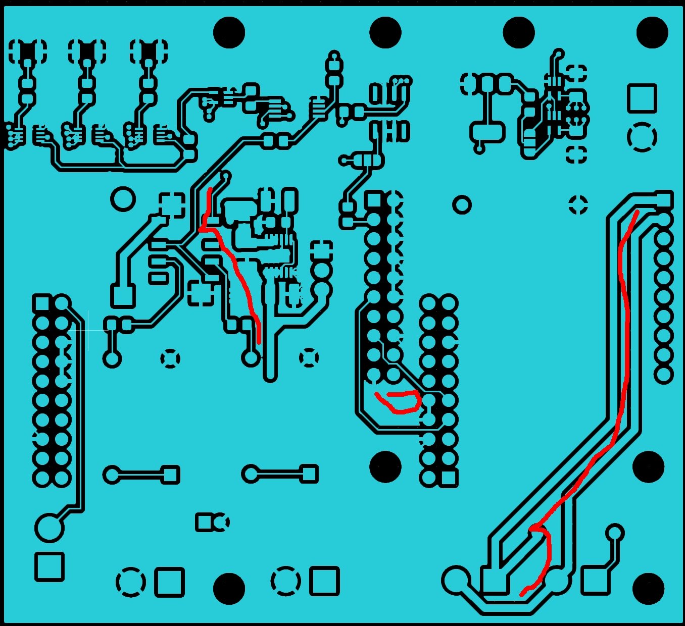

Hi Tony,
Looks like some of those vias only show up in the drill file. IOW, the top copper is drilled out after etching to produce vias.
Still, in some areas its pretty hard to check the layout. For instance, in the attacked pic it pretty hard to figure out exactly what is going on with some of the gerber views.
Maybe you could send me the kicad files so I can take a better look?
Best,
Mark
I'll be looking at updating to version 12 this weekend to take onboard Mark's review and to split to separate relays for the two XOs. It will necessitate an increase in board size but hopefully I can fit it in within the constraints of the pcb manufacturer's limits to get the best price.
I will grab some more space in the vertical direction (as in the image shown previously) and so will also have the advantage of moving the XOs further away from the PCM2DSD underneath and the other sensitive components, including the LDO.
I should also note that although I did put Mark's name on the pcb that was to acknowledge the advice he's been providing to me as I learn, plus the whole concept was closely derived from his general purpose clock board design. So any blame regarding imperfections in the pcb layout lay squarely with me! 🤣
