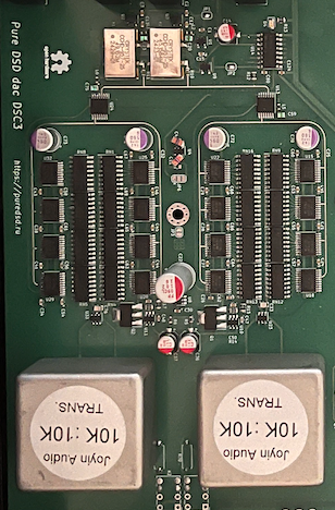

Wondering if anyone is using this output stage?
Thinking about combining the +/- with the output transformer used by DSC3.
Can you please recommend a commercial available transformer?
Those were preferred over LL1684 by both Pavel and Andrea Ciuffoli.
You would need custom transformers from a top manufacturer or you will just make the dac sound more distorted than it should.

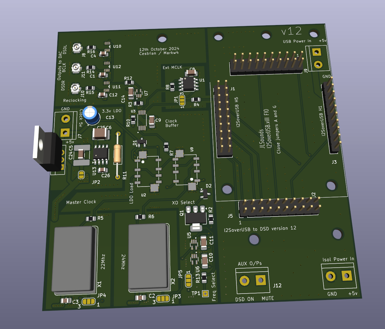

Complete layout change (and more) for v12!
Thankyou Mark for all your advice and for checking the design over in depth and making recommendations! I have enjoyed the experience and have learnt a lot I hope! I'm not saying it is the ultimate but there is a limit to the amount of time that can be spent. 🙄
Almost ready for upload to JLC I think!
Watch this space!
Watch this space!

D46 from Ivan?You would need custom transformers from a top manufacturer or you will just make the dac sound more distorted than it should.

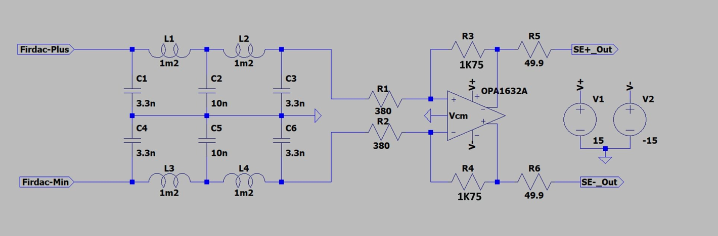

The dac output impedance is around 450R. Its output swing is roughly around 2v Peak to Peak most of the time, but maximum output is from 0 to +5v. Driven that that source impedance and signal level, the transformer should .1dB from 10Hz to ~80khz, with extended bandwidth to ~150kHz or so. Distortion .001% or less over the specified bandwidth. It can be done, but its not easy nor cheap. Problem is that the dac is well capable of such performance. If the transformer is going to let the dac quality shine through, then the transformer needs to be as transparent as possible.
With opa1632 stage, the source impedance is much lower, while 0.001% distortion can be very hard I guess, measurement from Ivan's D46, THD 0.0032%/THD+N 00049%
If you are using an OPA1632 output stage in differential mode, then all bets are off. No point in using a transformer after that, IME the sound is already half-ruined.
I have said it before, but we all know there is this theory about common mode noise/distortion being a big deal and we can fix it using differential output. Except if you try SE properly it sounds way better. What it means is that our model of what is going on in the dac and or our model of human perception is too oversimplified. Since at this time we don't have a more sophisticated model, the standard approach is to ignore people who question the model and just go with the model we have. Well, if we are competing for best sound, that's fine with me. I will win. However, I am not here to beat my friends in a competition. I want them to try things for themselves and form their own opinions.
Wondering what's extra benefit to add 1:1 transformer after DC blocking capacitor for SE output?
By the way is the direct output from the DAC board very low like 500mv?
The direct output is from switched 5v. If it were an NRZ dac the peak to peak output might be around 2.5v. Since its RTZ it will be less, maybe half that.
For my dac the DC blocking cap and transformer are the output stage. After that there is no more measurable RF, just audio. IOW, the transformer makes a pretty good passive RF filter.
That would be adding some sugar... aka. distortion 🙂what's extra benefit to add 1:1 transformer after DC blocking capacitor f

Hi Marcel,
The existing PCM2DSD requires a 22/24MHz MCLK input signal. Does your version require 45/49MHz on the same pin?
Mark
Mark
Practical accessing of the added control pins may require a new layout of the PCM2DSD board. So far no schematic has been published for it, although a schematic can probably be inferred from inspection of the gerbers and the BOM.
