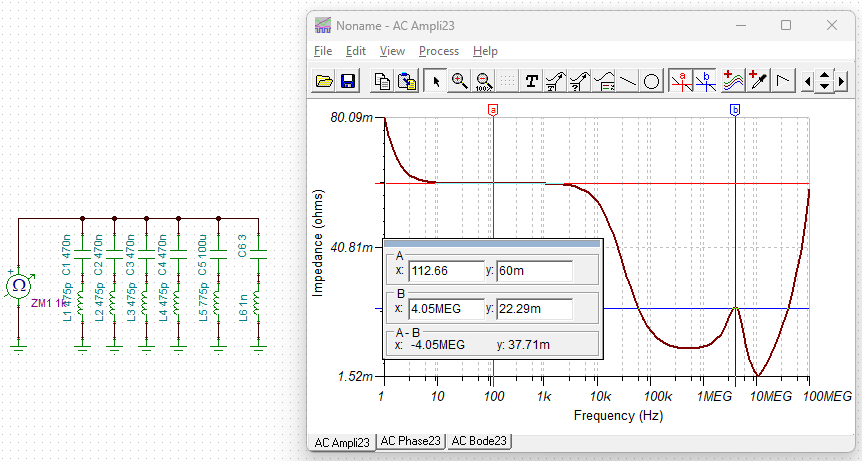

Here a quick sim of my recommendation
4 X 1206 470n C0G
1 X 2220 100uF Pos-Cap (can use more)
4 X (series parallel) 8mm X 11mm 3F/2.7V Elna Dynacap DU
How do you model the losses? There must be damping resistances hidden somewhere, otherwise the impedance would alternately go to infinity and to zero at the various resonant frequencies and certainly not have a flat part of more than two decades. 60 mΩ ESR in C6, about 12 mΩ in C5, about 7 mΩ each in C1...C4?
Why do you draw the inductances explicitly and the resistances not? Is it a peculiarity of the simulator, that you can just fill in the ESR of a capacitor but not the ESL?
Resistive part of the inductor model (not displayed).
Actually, I can fill in ESR for inductors and RP for capacitors.
But yes, peculiarity of sim and me being lazy. I'm NOT trying to teach electronics or pass a test.
Mind you, this is still just first order simulation. I could fire up other stuff and download the S-Parameter models, but I found for my own use classic lumped LRC is adequate.

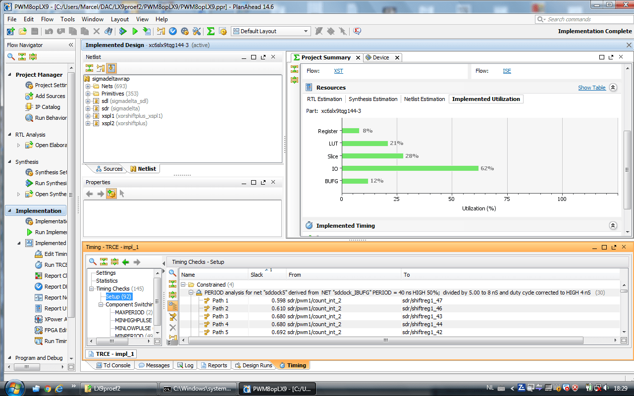

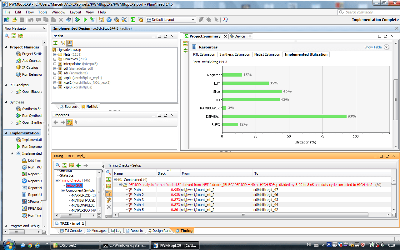

... try to see if an optimized version of my PWM8 modulator could be squeezed in a Spartan 6 LX9 FPGA.
I made some progress with this. It is still far from finished, but so far, it looks like two PWM8 modulators and a two-channel FIR filter can fit in an XC6SLX9-3TQG144C (or XC6SLX9-3TQG144I, if you want it to keep working when it freezes).
When I designed the digital sigma-delta modulator of my valve DAC, I knew some things about the theory of sigma-delta modulators and I had experience with the analogue parts of sigma-delta ADCs and DACs, but I had no experience whatsoever with FPGAs or with writing Verilog code. I therefore concentrated on getting it to work, rather than on optimizing things for small area.
Having another look, you can optimize it by kicking out the PWM4 and chaotic modes and doing the calculations for the five integrators - or more accurately, accumulators - serially rather than in parallel. The clock frequency then has to be multiplied by five, but that is no big deal, there are clock multipliers on the FPGA and the logic is fast enough. Instead of each having a dedicated register, the accumulator states are then kept in a kind of shift-register-like construction, which can also be used to pipeline some things.
The resonator feedback coefficients can be rounded to powers of two, the notches of the noise transfer function then actually get closer to the frequencies I originally intended. State variable limiting can also be rounded to powers of two.
Instantiating two of these sigma-delta modulators and two XORSHIFT128+ pseudo-random number generators on a XC6SLX9-3TQG144C, I get this utilization and no timing problems:
The interpolation filter of the valve DAC versions 1 up to and including 2.1 had to have a very good stopband rejection because of poor frequency planning: the quantizer could cause aliases if the images were not suppressed. I fixed that in version 3. In this case, the PWM8 modulator cannot cause aliases as long as the sigma-delta sample rate is an integer multiple of 8 times the input sample rate, which will normally always be the case.
When I then generate the coefficients for a 1024-tap interpolation filter using the Parks-McClellan program, use the Xilinx FIR compiler 5.0 to turn them into a two-channel, 8 times interpolating FIR filter (a chain of filters may be more efficient, haven't tried that) and add some stuff to round the output with dither, I get this:
Everything still fits in the XC6SLX9. There are set-up timing violations now, but as they are all related to the same register, I hope I can solve them with some pipelining.
Still missing:
-Input I2S interface
-Apodizing filter coefficient set, if space allows
-Clean timing
-Most importantly: proof that it actually works. I haven't tried or simulated it yet, I have only run an implementation in Pascal
See the attached zip file for the source code of the sigma-delta modulator.

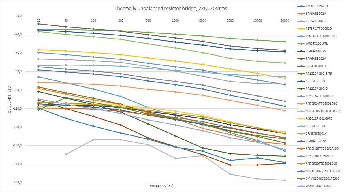

Here's an interesting test about distortions in resistors: Resistor Thermal Distortion Measurement
The melf MMU0102 MMA0240 and thin film ERA6A RR1220P are among the best

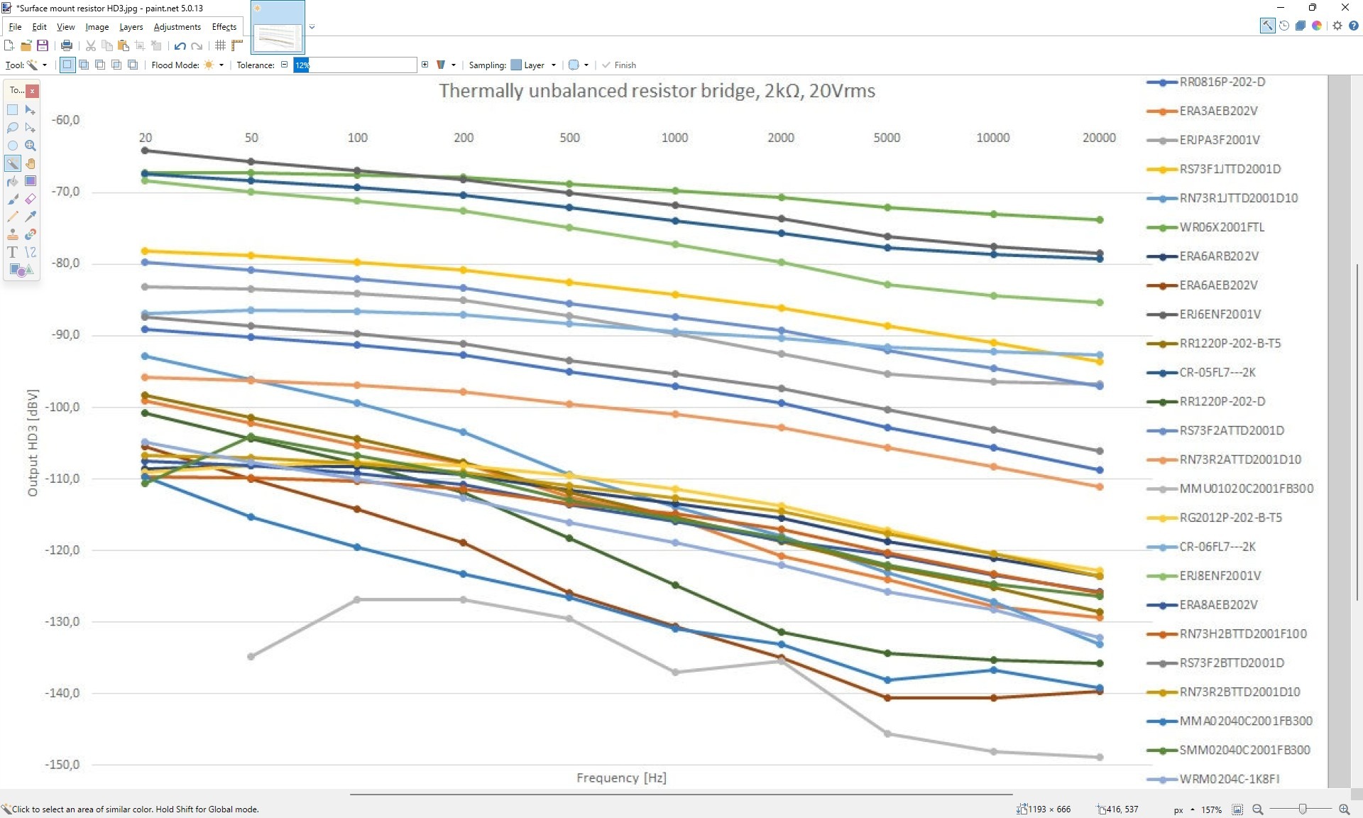

To make this image more readable/interactive you can use in Paint.Net the "Magic Wand" tool, set "Flood Mode" to global, Tolerance to 12%
Click on a line in the graph and the same color in the legend will also be selected.

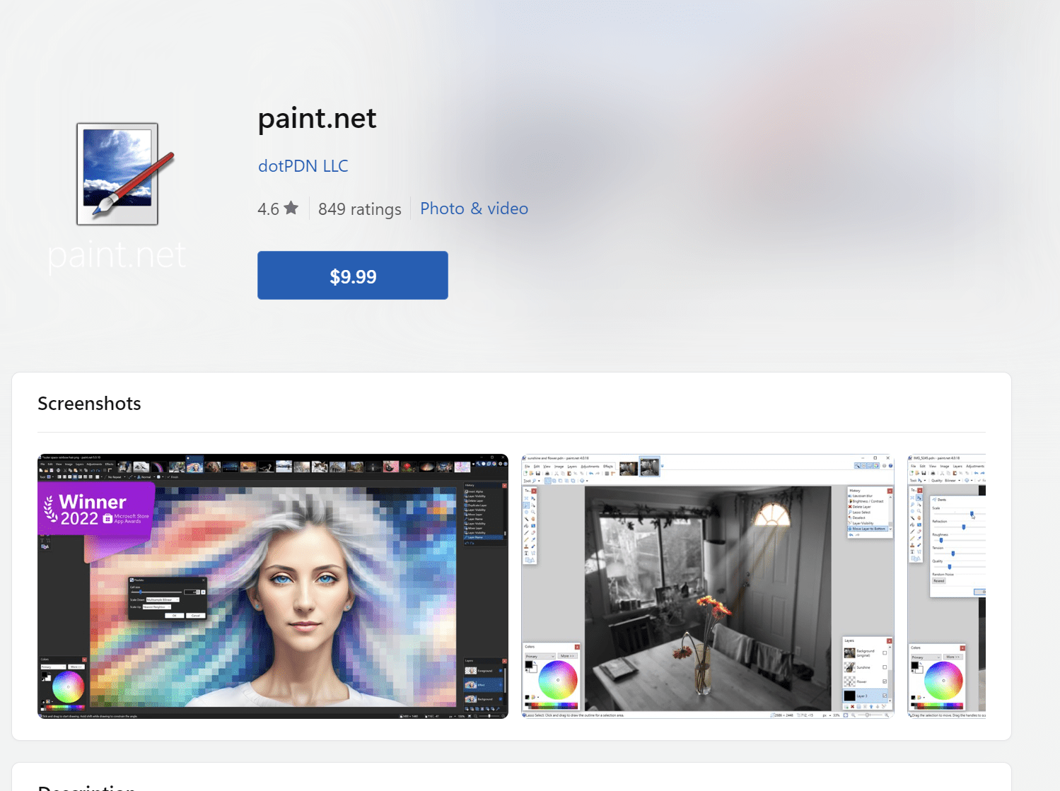

Are you the seller of paint.net?
Paint.net is a free download. Free as in free beer. And free speech (which is not some far right conspiracy but the foundation stone of our democracies).
Paint.NET - Article From Wikipedia, the free encyclopedia
It is personally my go to tool for dealing with quick image editing, in preference to Photoshop. Photoshop get's used when paint.net is out of it's depth.
