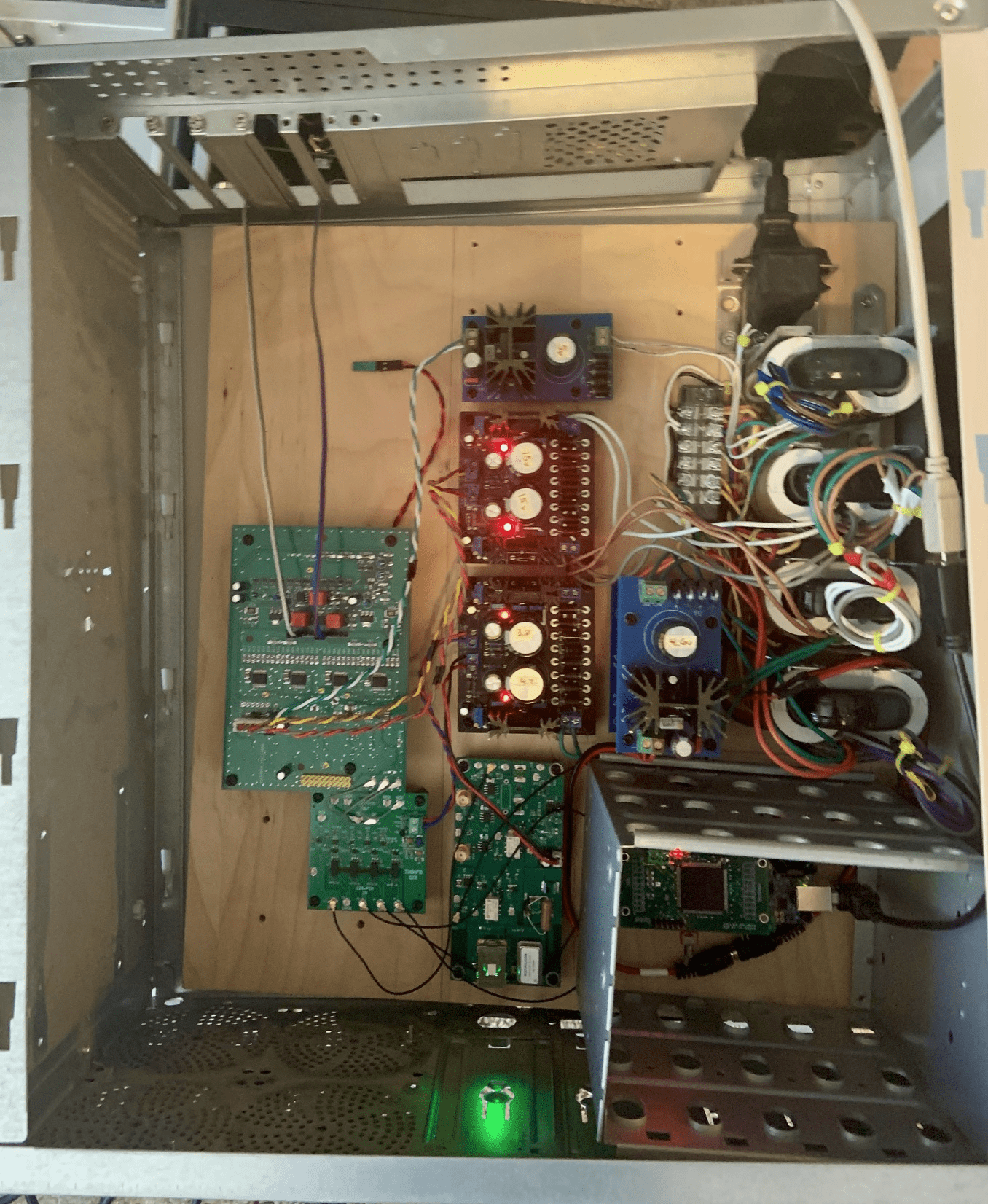

Getting back to Marcel's dac, here is the current state:
Basically it the same as last time, but with some quickie shielding added (which helps the sound, at least it does in the EMI/RFI environment here). Also, SE analog outputs are routed through an Andrea Mori SE DSD dac discrete output stage. The output stage is powered by another Andrea board, a quad shunt regulator (powered by two split-bobbin transformers not shown in the pic).
Its sounding quite good actually. Probably I will change plans at this juncture and see if I can clock the dac from some reference 22/24MHz clocks. Will see if I can put together a frequency multiplier to drive the I2SoverUSB board.
- Digital Line Level
- Return-to-zero shift register FIRDAC
