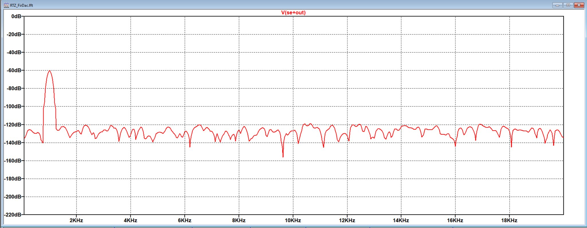

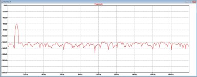

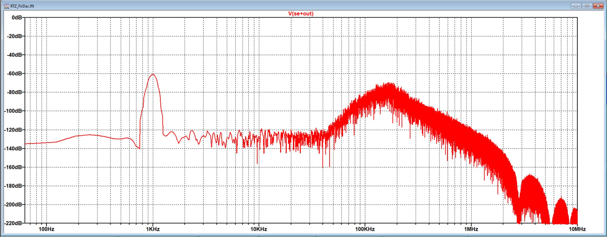

I tried again with Bohrok's -60dB file, but looked now to one SE output only and used your latest filter design starting with 39nF.@Hans Polak
The audio-frequency intermodulation products appear to be second-order products, at least the ones I looked at in detail in the report of post #2696. A perfectly balanced circuit cannot create second-order intermodulation products, and everything is perfectly balanced in simulation as long as you don't deliberately add imbalance or do Monte Carlo simulations with mismatch.
One way to cause imbalance is to look at a single-ended rather than differential output signal. Did you ever see anything that looked realistic when looking at a single-ended output signal?
Unfortunately the result is as before.
See both attachments, one spectrum up to 10Mhz and the second up to 20Khz,
Hans

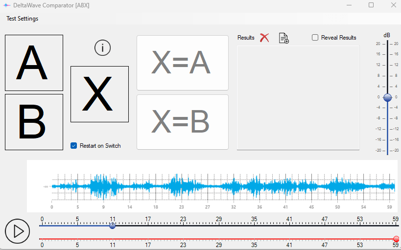

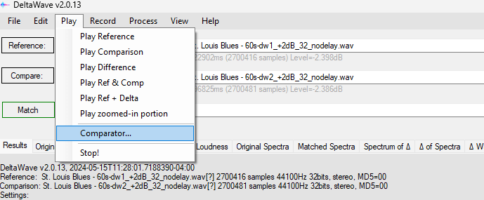

@Markw4 Can you please give the DeltaWave comparator a try? It is super easy to use, just load the files you want to compare and hit Match. Then go to Play -> Comparator.
You can start the comparison from any point in the track. You can also choose whether to restart from that point while switching or to have track keep playing. You can do as many comparisons as you like. It doesn't have hotkey switching but I bet we could get Paul to add it.
I gave it a try. Really thought I might have heard a difference on some of the percussive hits. The results are initially hidden so you don't know how you are doing until you hit reveal results. Turns out I did great in the beginning and then it all fell apart.
Code:
Trial 1, user: A actual: A 1/1
Trial 2, user: B actual: B 2/2
Trial 3, user: A actual: A 3/3
Trial 4, user: B actual: B 4/4
Trial 5, user: B actual: B 5/5
