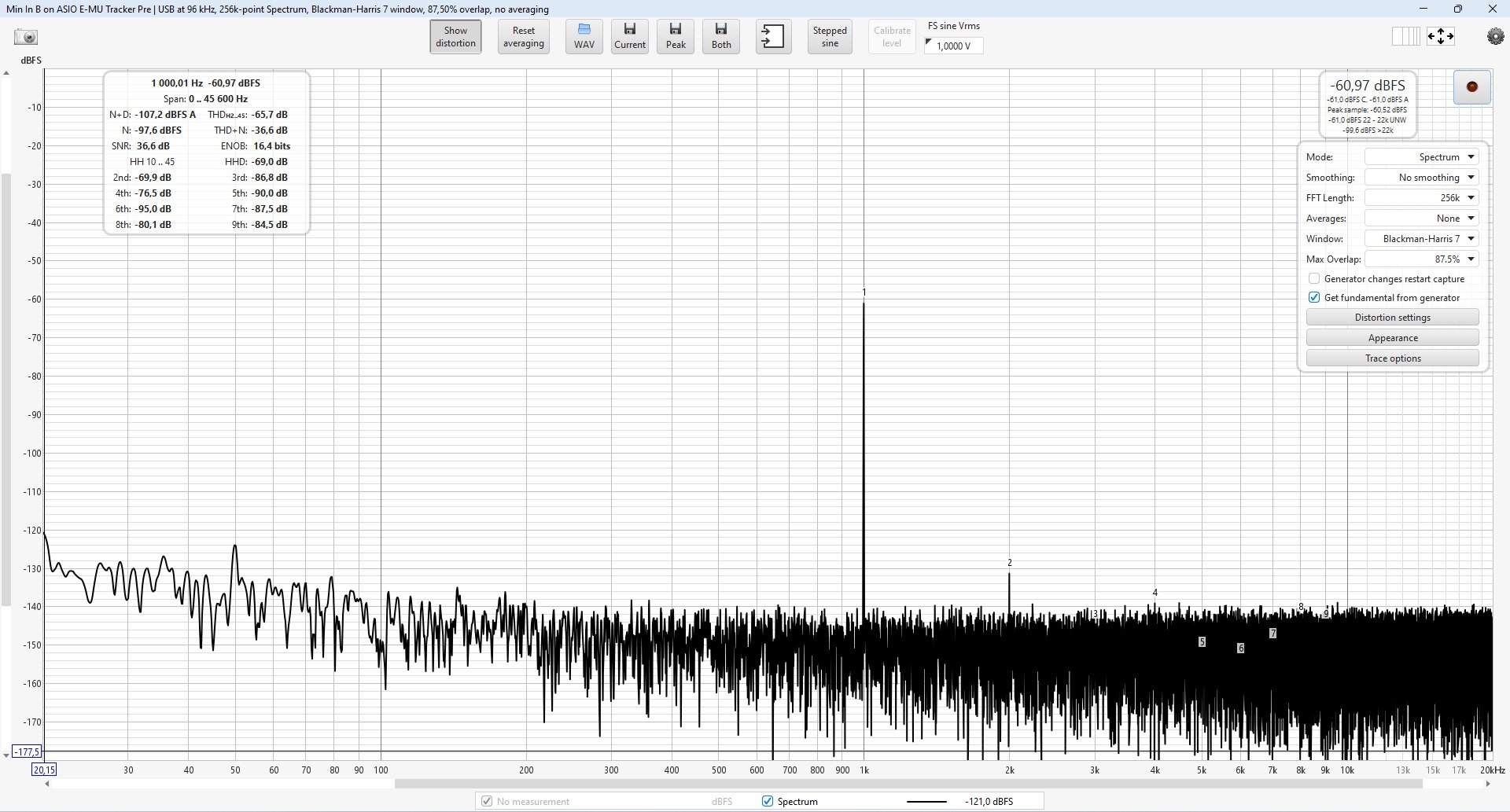

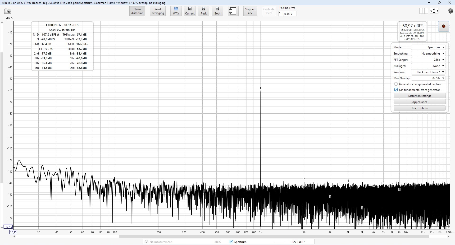

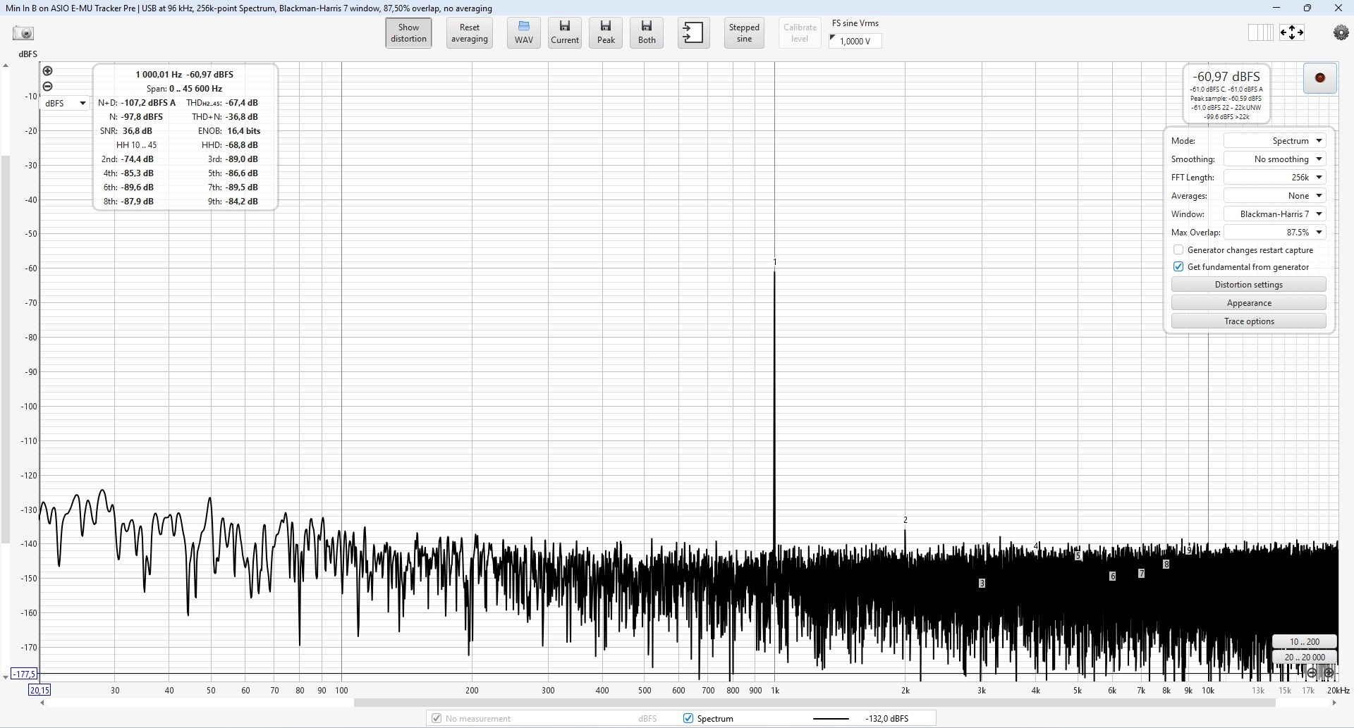

One day I measured Marcel's PWM8 modulator with RTZ and there is also pumping there.
Of course, it is not as visible as in pcm2dsd because Marcel's has less distortion.
Look at some PWM8 measurements:
My experience with "pumping" of levels of HD on FFT's has been that it relates to DC instability.
As we involve BOTH ADC and DAC it will be hard to pin down if there is a power supply or reference variation.
It could also be down to the modulator of course. At the orders we need for DSD unconditional stability is unlikely, even in the digital domain.
