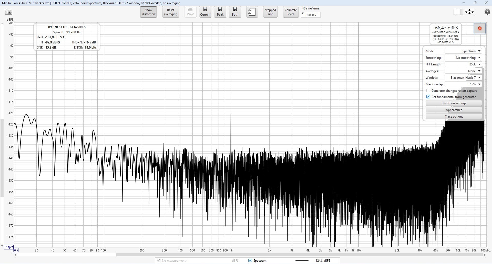

We are talking about harmonic pumping, but it's not just about harmonics...
I did a test for low levels of the carrier frequency
When we set the carrier low to around -100dBfs and below we can see carrier frequency pumping.
The lower the level, the more visible it is.
But I think that's we see it only. This is not real pumping.
It rather results from the way of the measurements.
These are simple measurements on simple equipment for signals at noise level.
When I look at the specifications of my measurement card I have: THD+N is about -100dB. This agrees with my measurements.
From this level I have pumping.
To see below -100dBfs we do various tricks.
We do averaging and select various parameters
Each sweep gives a different levels.

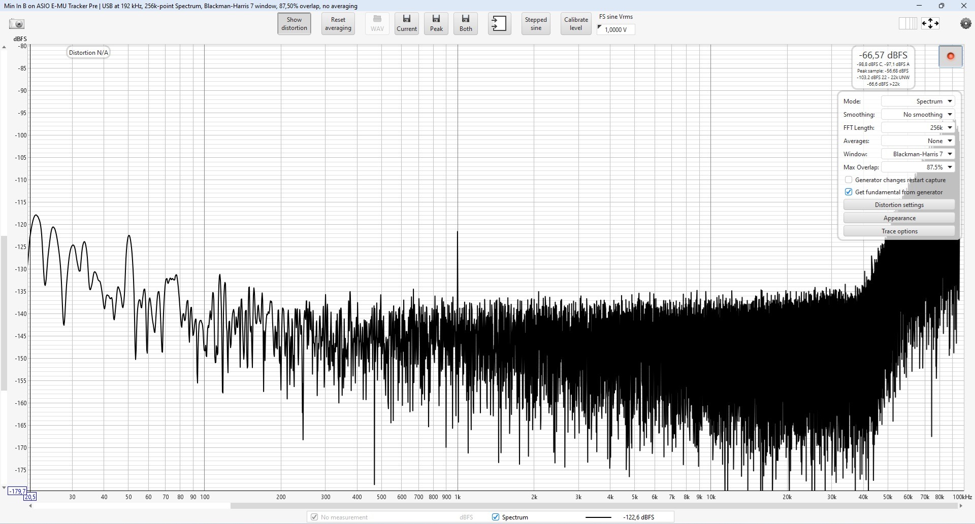

PWM8 -120dBfs:

Good point, you always see some random level variations when the signal under test is too close to the noise floor. Sometimes the noise in the DFT bin or spectrum analyser resolution bandwidth is in phase with the signal, sometimes in antiphase, sometimes something in between.
Some kind of aliasing effect, like wagon wheels moving backwards in movies? And, or maybe a signal riding up and down on noise? Was wondering if it was real or not.
Not to be nitpicky but just to clarify, fs in lower case letters commonly refers to the sampling frequency (or sometimes f(s) is used instead). Whereas in the case of something like "-100dBFS," the FS in caps refers to "Full Scale," such as in the full scale output of a dac before it clips....around -100dBfs..

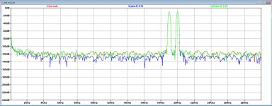

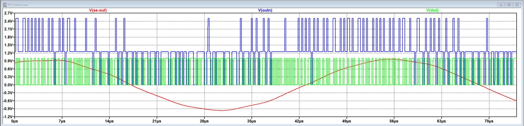

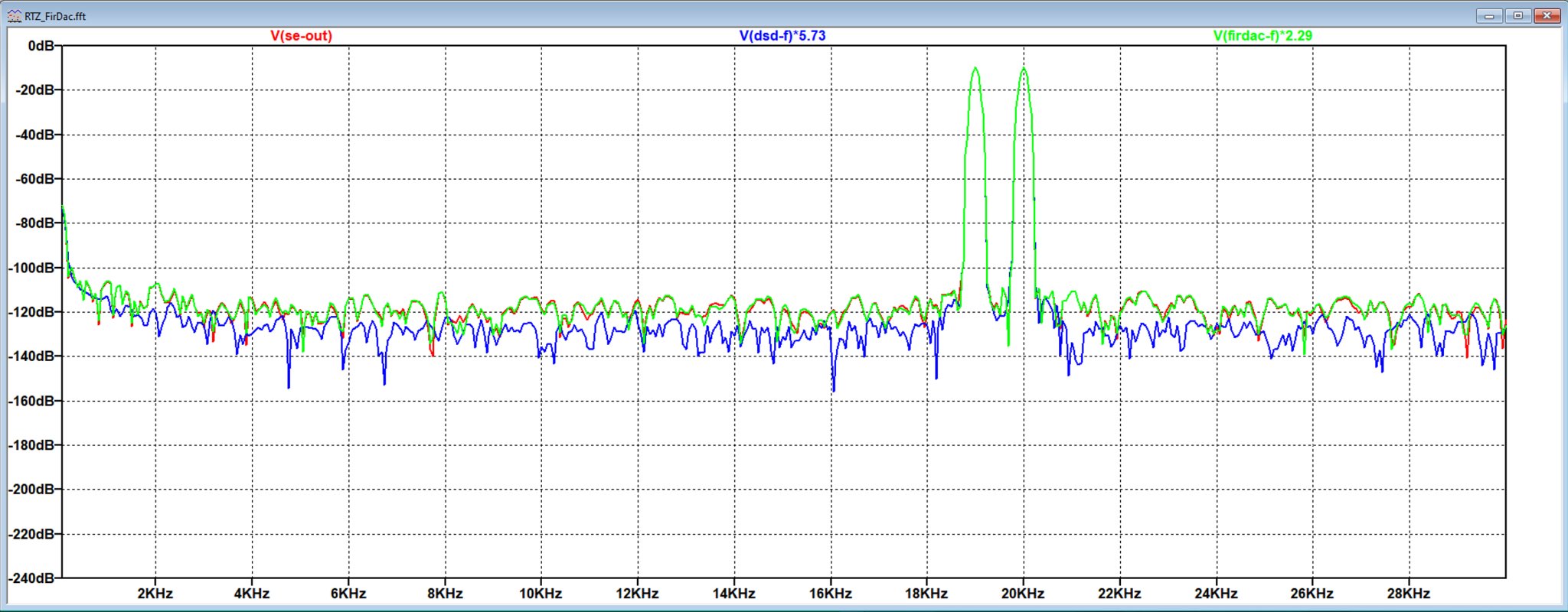

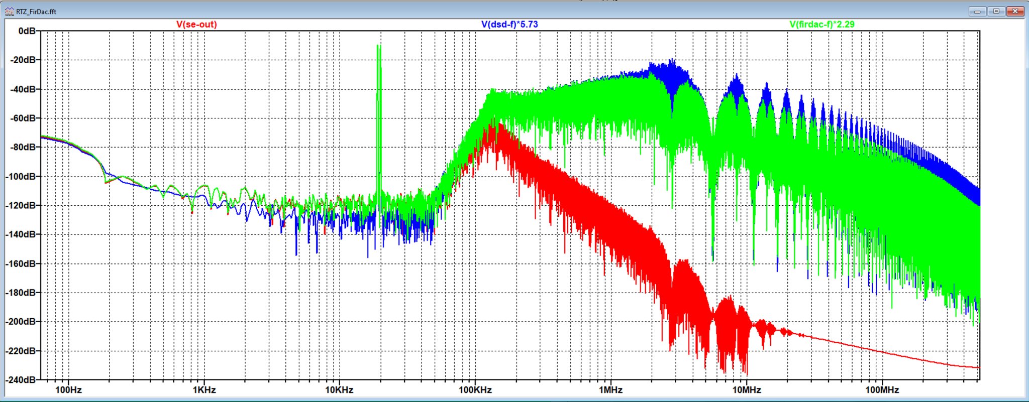

To show that the FFT of the DSD is no problem in LTSpice, here are 3 attachments taken while playing a 19+20Khz .dsf at -3dB peak.
The input DSD signal in the simulation switches between exactly 0 and 1Volt.
1) First attachment with a 75usec window of the DSD signal in Green, the Firdac's output without load in Blue and finally the filter output in Red are showing how much filtering takes place at each step.
2) Second attachment from a 16msec window shows a 500Mhz FFT with the DSD signal in Blue, the unloaded Firdac's output in Green and the SE filter output in Red.
To prevent folding into the audio spectrum, a simple 1K+10pF RC filter has been added after the DSD signal and also after the unloaded Firdac signal.
Signals are level adjusted in the FFT.
3) From this spectrum, a linear part has been zoomed in from 0 to 30Khz.
Obvious in this case is that the Firdac's signal and the SE Filter output are identical and exactly on top of each other.
However the DSD signal is ca. 10dB lower, so these 10dB must be lost somewhere in the digital processing part.

A bit surprised that I lost 10dB along the line from DSD input to Filter output, I found out that this was caused by the unloaded additional tap on the Firdac.To show that the FFT of the DSD is no problem in LTSpice, here are 3 attachments taken while playing a 19+20Khz .dsf at -3dB peak.
Hans
Without this extra tap there is no loss and noise before and after stays at the same -130dB.

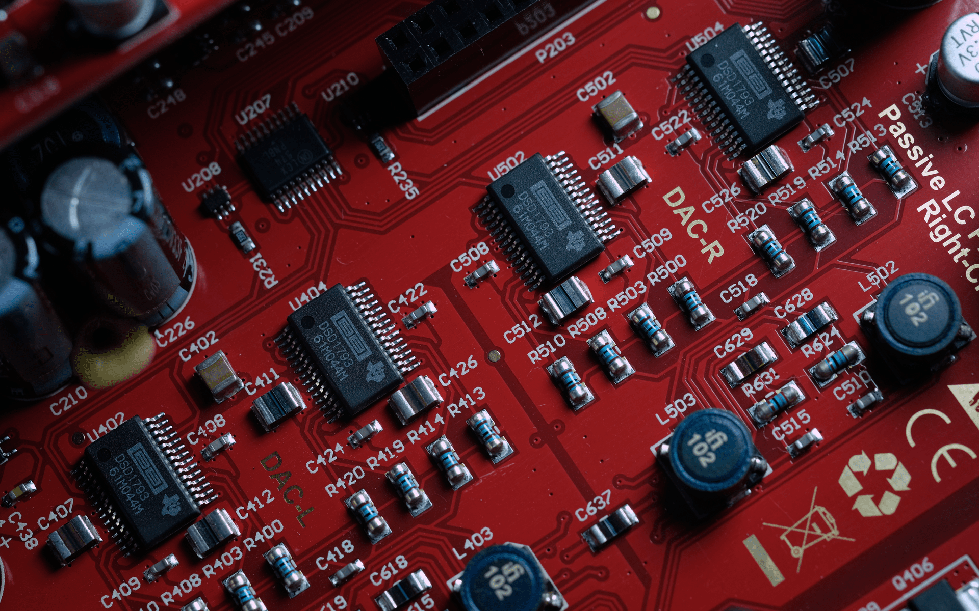

I think the pink things near the top are inductors.
If so, you may find this type to materially raise HD.
May I suggest you use the kind I used in the iDSD Pro for iFi AND that you pass a few mA DC current to "bias" the core?
Thor
