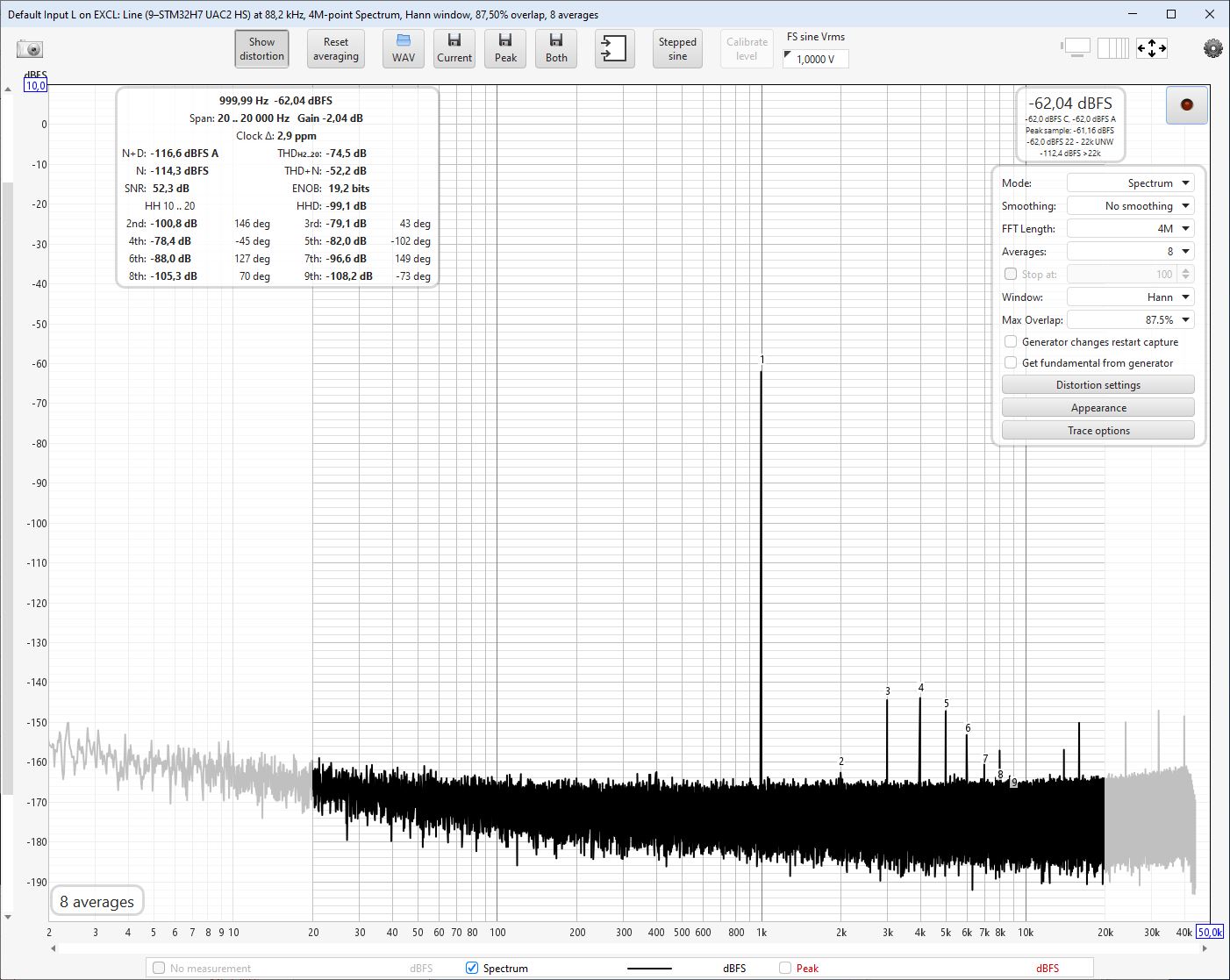

I actually tested this with my setup. So USB-I2S+PCM2DSD using 22M/24M NZ2520SDA's. This is quite easy to setup on my RTZ board as I have onboard bit clock reclocking from the same MCK. I just used the same MCK for doubled bit clock.
Even with my quick&dirty mod this resulted in measured improvement in the -60dBFS issue (see below).The tallest peaks were about 5-10dB lower than earlier. At higher levels measured improvement was less. Also I noticed the improvement with only 44k1/88k2 fs but not with 48k/96k fs.
That's quite interesting. You previously saw a clear dependence of the low-level distortion on the output filter, now on the way you generate the shift register clock, even though you have the correct frequency in both cases you compare.
That could mean that there is a filter-related part and a data-to-clock crosstalk related part.
It could also mean that the suppression around fs/2 of the FIRDAC is somehow affected by the clock generation method. With less suppression, the output filter has to handle larger spurs and produces more intermodulation.
If you have the equipment to measure it, do you see any difference in the levels of the FM-like tones between 5.6348 MHz and 5.6548 MHz at the 8.2 nF between the two clocking methods?

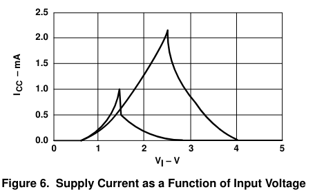

Yes. Then I read it right. The P-Channel source connects to Vcc (say 5V). The switching voltage of the pair is at ~1.5V, where it draws maximum current.
That means the TH voltage (e.g. Id > 100uA) of the N-Channel is a little higher, say 1.7V from Vss and the TH Voltage of the P-Channel is a little lower, referenced to Vss perhaps 1.3V.
But the P-Channel transistor must reference Vcc, so it's TH voltage would need to be 3.7V.
I don't know what you see in the graph:
but looking at the upper (SN74AHC) graph, I see that current flows from about 0.7 V to 4 V. Assuming a 5 V supply, that is consistent with a 0.7 V NMOS threshold voltage and a -1 V PMOS threshold voltage. The lower (SN74AHCT) graph stops conducting current around 3 V, consistent with a stack of two PMOS transistors with -1 V threshold voltage. I also see that the graphs don't look very quadratic and that the moderate and weak inversion regions aren't visible.
Anyway, the overlap current for SN74AHCT at 3.3 V is smaller than I expected, so that's nice.
I only have a 200MHz scope but that does not help.
One thing worth mentioning is that I used MCK only for shift registers. Using MCK also for last serial data flipflops increased noise floor by about 20dB. I assume this is due to setup/hold time issue with flipflops. So probably no sense in testing crystal clocking with current RTZ circuit.

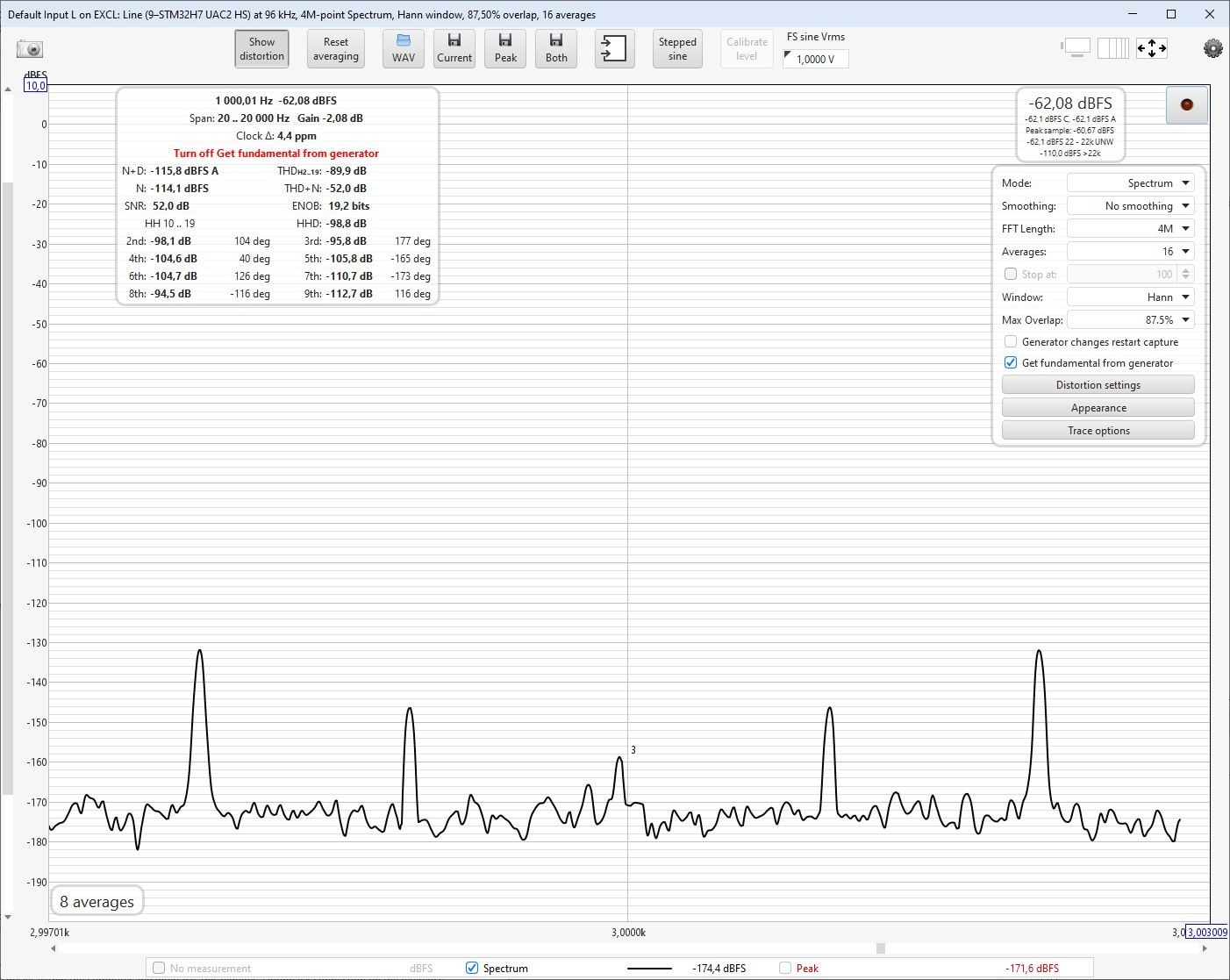

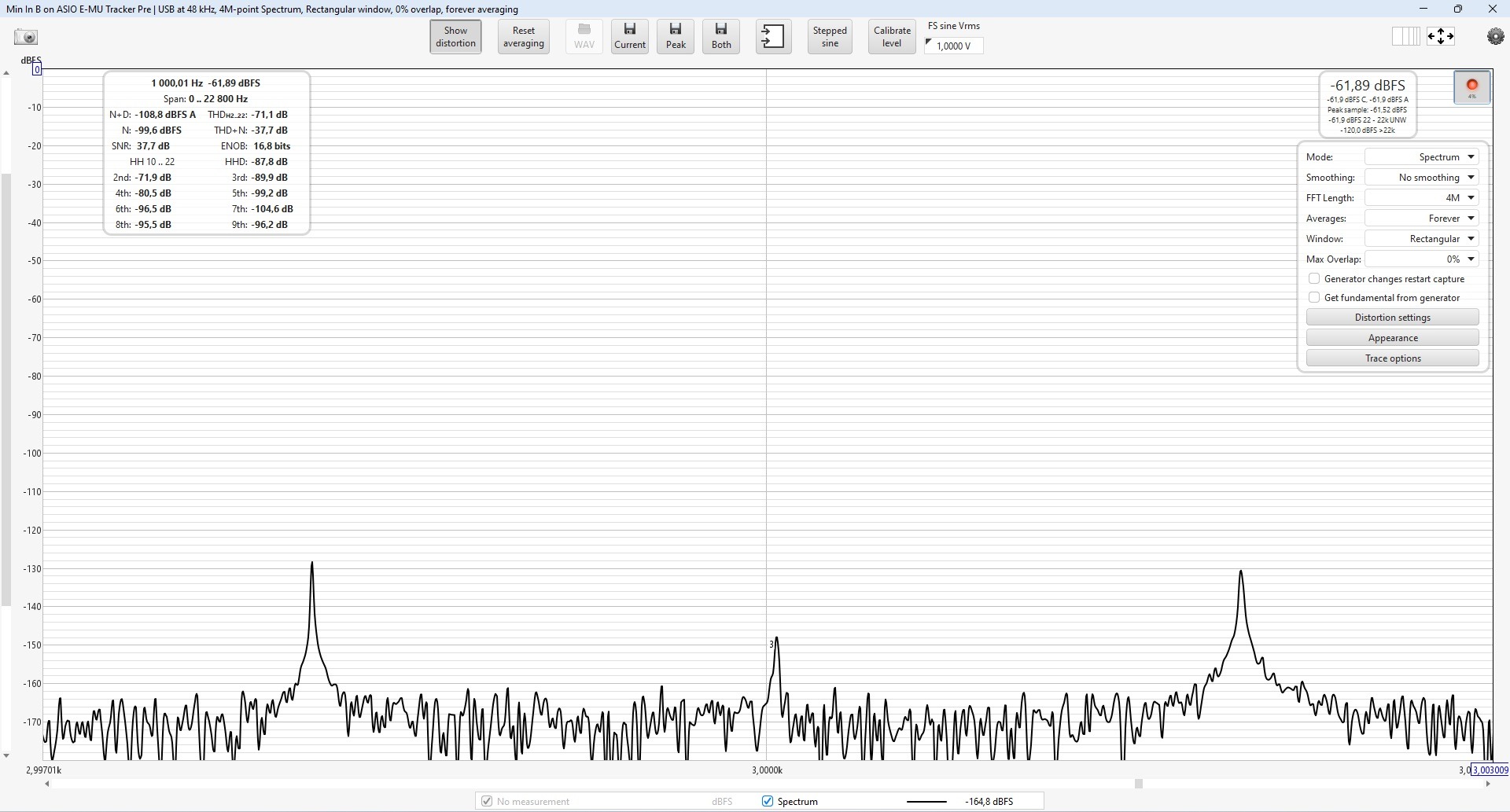

@PJotr25 measured this with the original DAC layout. There doesn't seem to be much difference.
To be more precise, the "big" peaks that behave according to the FM modulator theory are similar (though not exactly the same), but the small peaks that shift far less with offset than they should according to the FM modulator theory are nowhere to be found.
bohrok2610's measurement, -60 dB, 1 kHz, old PCM2DSD configuration, 96 kHz PCM sample rate, bohrok2610's DAC PCB, zoom around 3 kHz:
PJotr25's measurement, -60 dB, 1 kHz, old PCM2DSD configuration, 48 kHz PCM sample rate, original DAC PCBs, zoom around 3 kHz:

No idea what to conclude from this.
The reason for difference in peaks is probably due to difference in FW. I'm using FW that does not use ODDR2 primitives as that had worse performance with my board (maybe due to bit clock reclocking). PJotr25 is probably using original FW that uses ODDR2 primitives. I tried original FW with ODDR2 and peaks were similar to what you see on PJotr25's measurement.

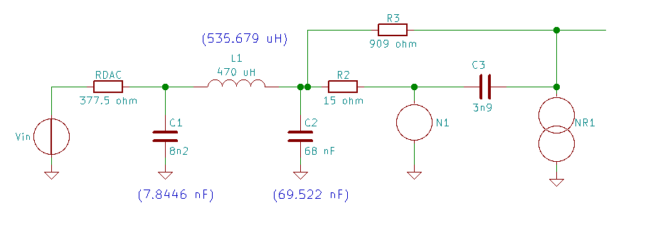

Regarding filters, what I would like to try is a differential version of something like this:
where N1 is a nullator (ideal op-amp input port) and NR1 a norator (ideal op-amp output port) that have to be replaced with some discrete amplifier circuit I haven't designed yet. It needs to have a low equivalent input noise voltage because of the effect of C2 on its noise gain.
It is roughly a fourth-order Butterworth filter at 80 kHz. Up to 20 kHz, its input impedance is not much worse than that of the original filter.
Reactions: 2 users
