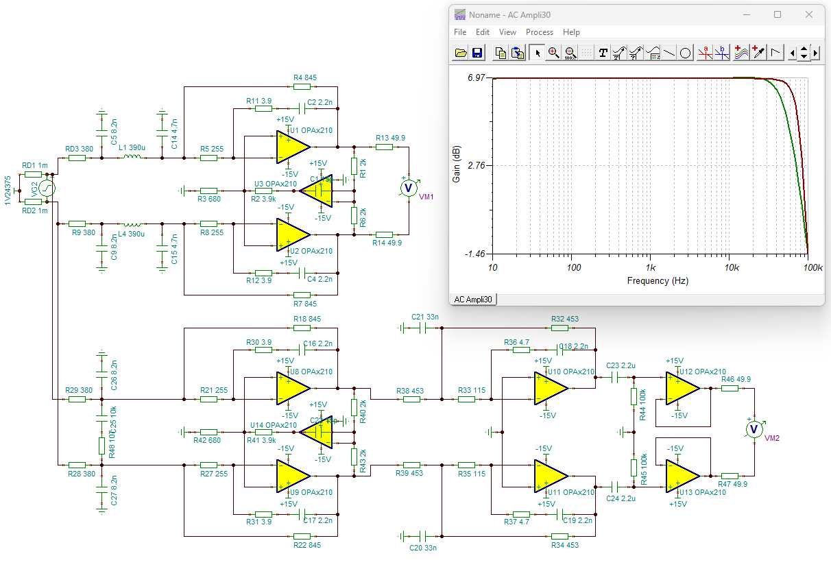

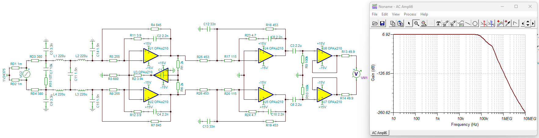

Here you go:I don't know what the "original filter design" was, though (can seem to find it right now).

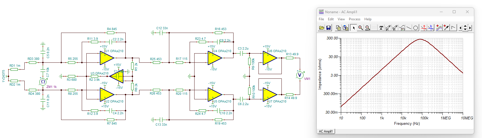

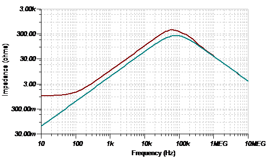

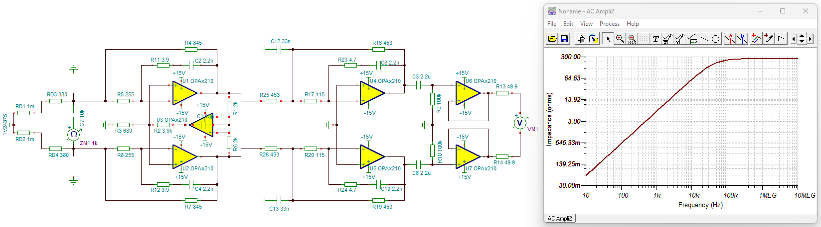

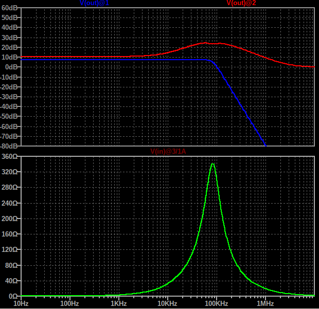

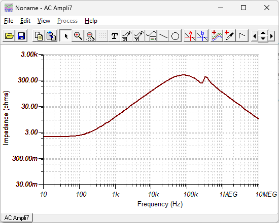

It is easily observed that the input impedance depends on the open loop gain and is effectively as a result inductive.
The 8.2nF Capacitors forms a parallel resonant circuit with this "virtual inductance".
If we remove them....
So for HF out input impedance is around 300 Ohm differential, I expect these are the 760 Ohm DAC source impedance and the 510 resistance inside the feedbackloop (760R//510R = 305 Ohm).
Also, gentlemen, I feel you are not just overegging the pudding but you are going full on Billy Joel by trying to move all passive filtering to the front.
I'm fine with extremes, but do we have a middle ground?

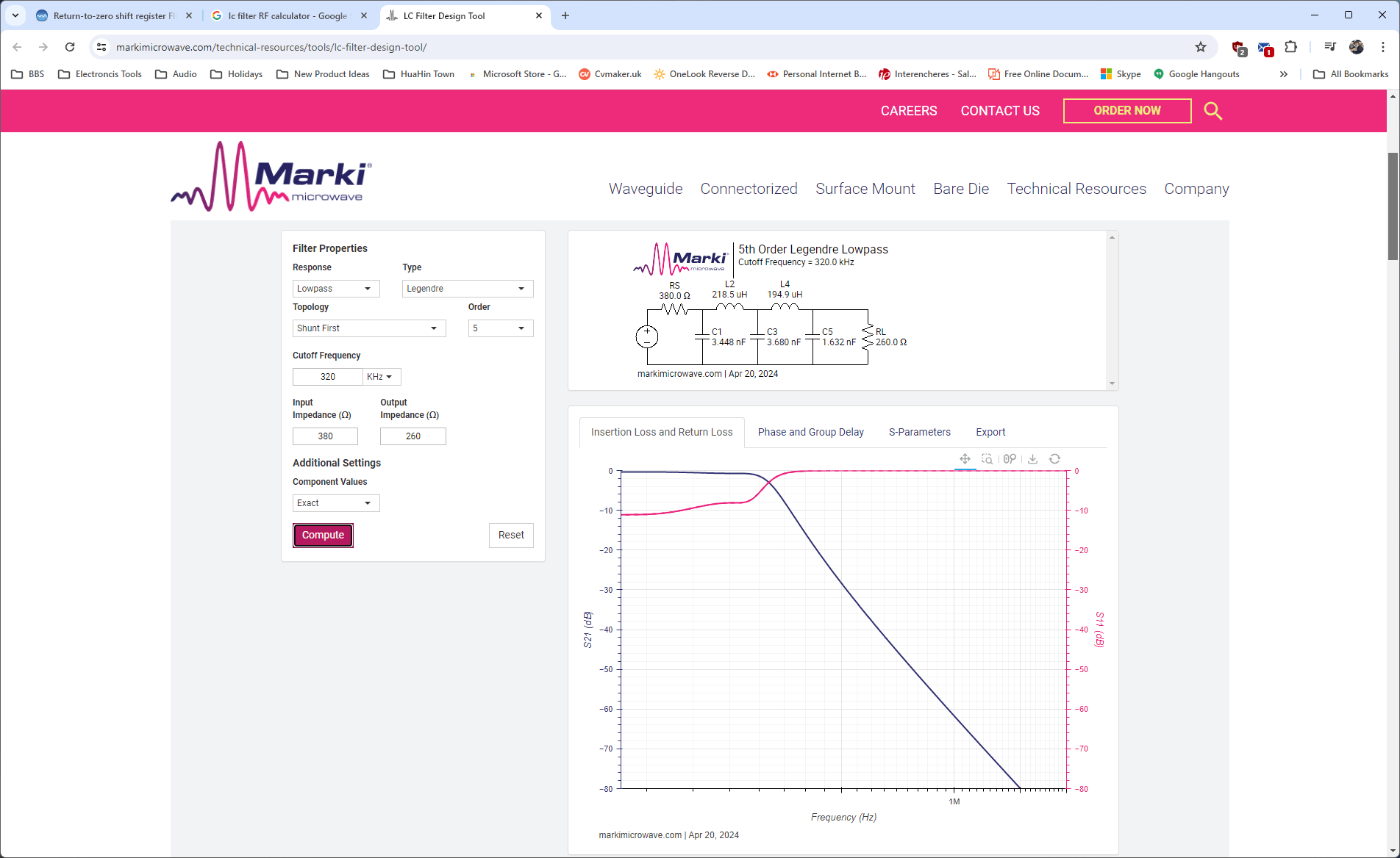

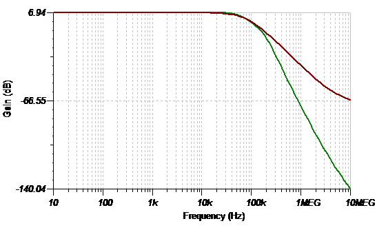

Let's take Zsrc = 380R and Z load = 260R and a total capaictance of 8.2n and see what filter we can get?
A 320k cutoff with a 5th order response should allow significant rejection of HF stuff, with inductor and capacitor values that are rather managable.
Looks to me a material improvement in filtering high frequency stuff, while noise gains and audio band behaviour are largely unchanged.
Blue original, red the filter I showed. If we go simple CLC (3rd order) like I have used in commercial products the difference is further reduced:
Much simpler, is the filter response sufficiently similar? Answers on a postcard.

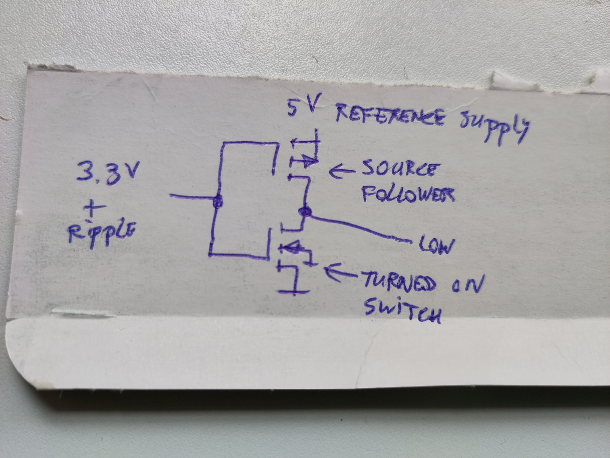

That also contributes, but I meant through the source follower action of the PMOS.
The simplest way to make a TTL compatible input on a 5 V CMOS chip is just to scale the width-length ratios of the input inverter a bit, but with a PMOS threshold voltage of about -0.7 V, you then essentially have a PMOS source follower from the input to the 5 V reference supply for any input voltage from the switching point to 4.3 V.
I think we can agree, that the 74AHCT16374 does not suffer this problem.

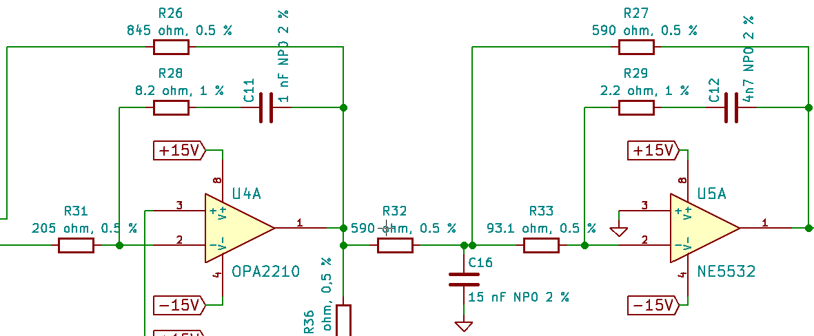

Actually, the least invasive filter change I can come up with is just to put the section with the highest quality factor first: op-amps stay the same, PCB stays the same, resistor and capacitor values change. It comes with a small noise penalty because the noise gain at 20 kHz for the first stage increases slightly. The input impedance actually goes down. Changes:
Change the capacitors on the DAC board from 8.2 nF NP0/C0G 2 % to 22 nF NP0/C0G 2 %.
Change most resistors and capacitors on the filter board, like this:
See also the attachment. The third stage is still as optional as it always was.
It should reduce the spurs around fs/2 that reach the first op-amp by about 7 dB. As the audio products are second-order intermodulation products, those should theoretically drop by about 14 dB if this is the only cause of the intermodulation.
The weird low-level distortion should get better, but the plain harmonic distortion at 10 kHz, 0 dB DSD may get worse.

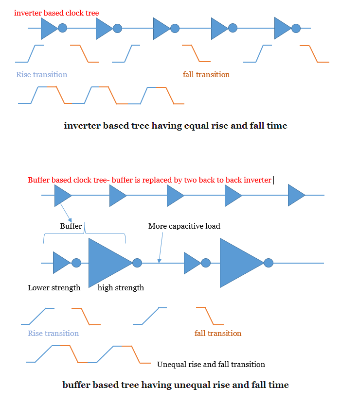

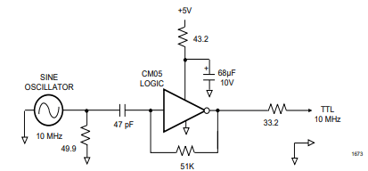

Inverters are used in clock trees as with correct (or decent "by the seats of pants" engineering) we can be reasonably sure that unequal rise and fall times do not accumulate, unlike it would be the case with non-inverting buffers:
In principle, LVC Buffers should be good. Most other logic has issues.
What I am proposing with unbuffered inverters (strictly unbuffered) is to make a discrete fanout that is non-inverting.
I remember from a Wenzel publication that a single 74AC inverter (buffered) as squarer ends up not compromising -130dBc @ 10Hz phase noise from a 10MHz reference oscillator (meaning it's own noise is much lower) and even at 1Hz was only 1dB worse (which may be other parts of the circuit).
The NC7WZU04 dual inverter is functionally similar to the PL133, minus the OE option. It has the advantage of having multiple parallel parts from a range of sources, I learned the hard way to avoid single vendor parts as possible.
My personal "seat of pants" clock tree engineering assumes a 50R stripline is around 1.5pF/cm.
Typically we drive at least two inputs per inverter, which we call 10pF plus 10cm stripline is 25pF. Less we can always maeander the line or add a trim cap at the beginning.
So each inverter is loaded by appx. 25pF, if we now load the first inverter with 5 inputs of 5pF each, all inverters have approximately identical rise and fall times and the net result should preserve out 50% duty cycle clock.
As noted, one or two inverters are unlikely to materially impact the phase noise from most readily available clocks. An Accusilicon AS318 with -90dBc @ 10Hz is unlikely to challenge one or two inverters with < -130dBc @ 10Hz, even if our gates have 20dB more noise and only give us -110dBc - I think no point to loose sleep. The PL133 seems to have worse phase noise performance, but in the graph in the datasheet the source has likely more phase noise than PL133 below ~500Hz.
So, my logic for recommending a 1:5 fanout using 3pcs NC7WZU04 is:
Adequate phase noise performance
Preserves Duty Cycle in our application
Inexpensive and readily available parallel parts from multiple suppliers
It is not specified for the job, but it should do fine.

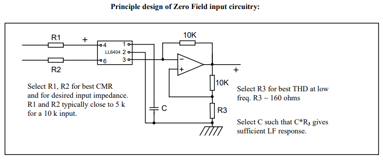

Just a thought - WRT transformers, a zero field transformer may be a worthwhile option to try right in front of the 1632. These are essentially a current in / current out device with very low distortion.
Nope, they are not. They are just very conventional transformers, which are operated with a mix of positive and negative feedback. It is the positive feedback (or negative resistance) that actually makes it zero field (from Lundahl):
As the "Zero Field" feedback extends bandwidth it will "broadband" the transformer and in effect counteract it's filtering effect.
Transformers that will only be used in Zero Field can be smaller and less expensive than those for normal use, however traditional Transformers work fine in zero field as well.
Ideally with Zero Field we would trim out all the DCR of the transformer windings, but copper is not constantan and thus we need account for a variations in temperature and actual winding resistance tolerance. So we never get the equivalent of "0 Ohm" input impedance at the transformer and the field is never zero.
With the OPA1632 (or a Birt based design) it is not really easy to apply the required positive feedback. So at best we run the transformer into a virtual ground.
If we take an OEP 1:10 step-up A187A15C we have 20 Ohm primary DCR and 1.59k secondary DCR. This means without compensating the DCR by positive feedback, we add 36 Ohm to the circuits input impedance. If we take a 600R:600R 1:1 transformer (A187A12C) we add almost 100 Ohm DCR so this is worse.
I'm not really sure this is a good place for a transformer. I think the Analogue stage would need to be completely redesigned with the correct zero field circuit and ideally R3 would be thermally coupled with the transformer case and be made from pure copper, so the circuit is inherently temperature compensated.

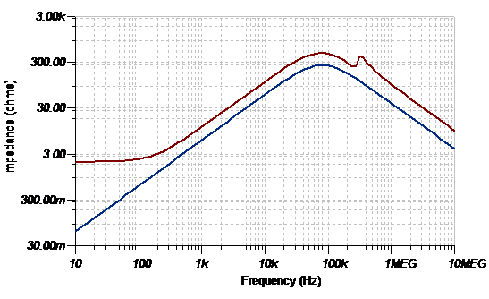

They can also be implemented successfully without NR using a low DCWR traffo (Studer / Neve did).
That depends on a lot of factors. Studer did it as microphone input. And technically, the still fairly high DCR doesn't make that one "zero field", just low field.

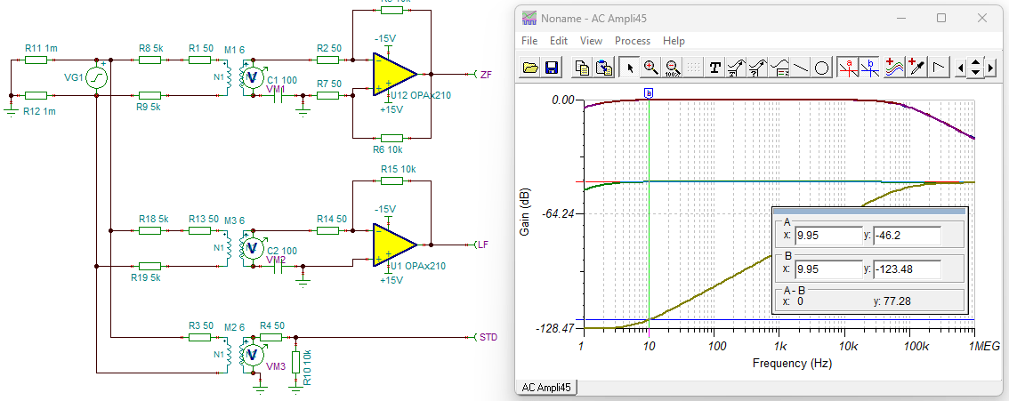

PS I was thinking more low DCR, 1:1 ratio and an appropriately large core to achieve desired LF linearity.

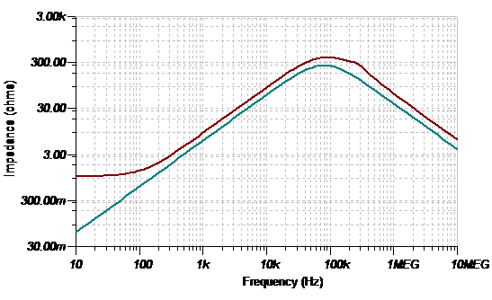

The point of ZF is to use a small core. LF linearity is achieved by cancelling the LF magnetic field.
Here an example of the same 1:1 600R transformer (50 Ohm resistors model the DCR) in Zero Field, inverting "low field" and normal operation.
Curves are at the Voltage meters. Low field at 10Hz is down by 46dB on standard connection, but true zero field is -123dB.
