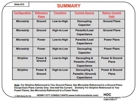

Some additional benefit I found is that having this many planes, your impedance's properly preset in the EDA, drawing the PCB becomes pretty simple. Do the right stack-up etc. do the presets, mark up impedance controlled lines and after physical placement of critical parts you might be able to run the auto place and router and get somewhere where you dont have to make a lot of changes.
Again, placing a high speed signal line on top is an understandable tendency.
However running it buried between GND & VCC for wherever the power domains are the same, ensures direct returns for all currents. See here:

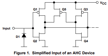

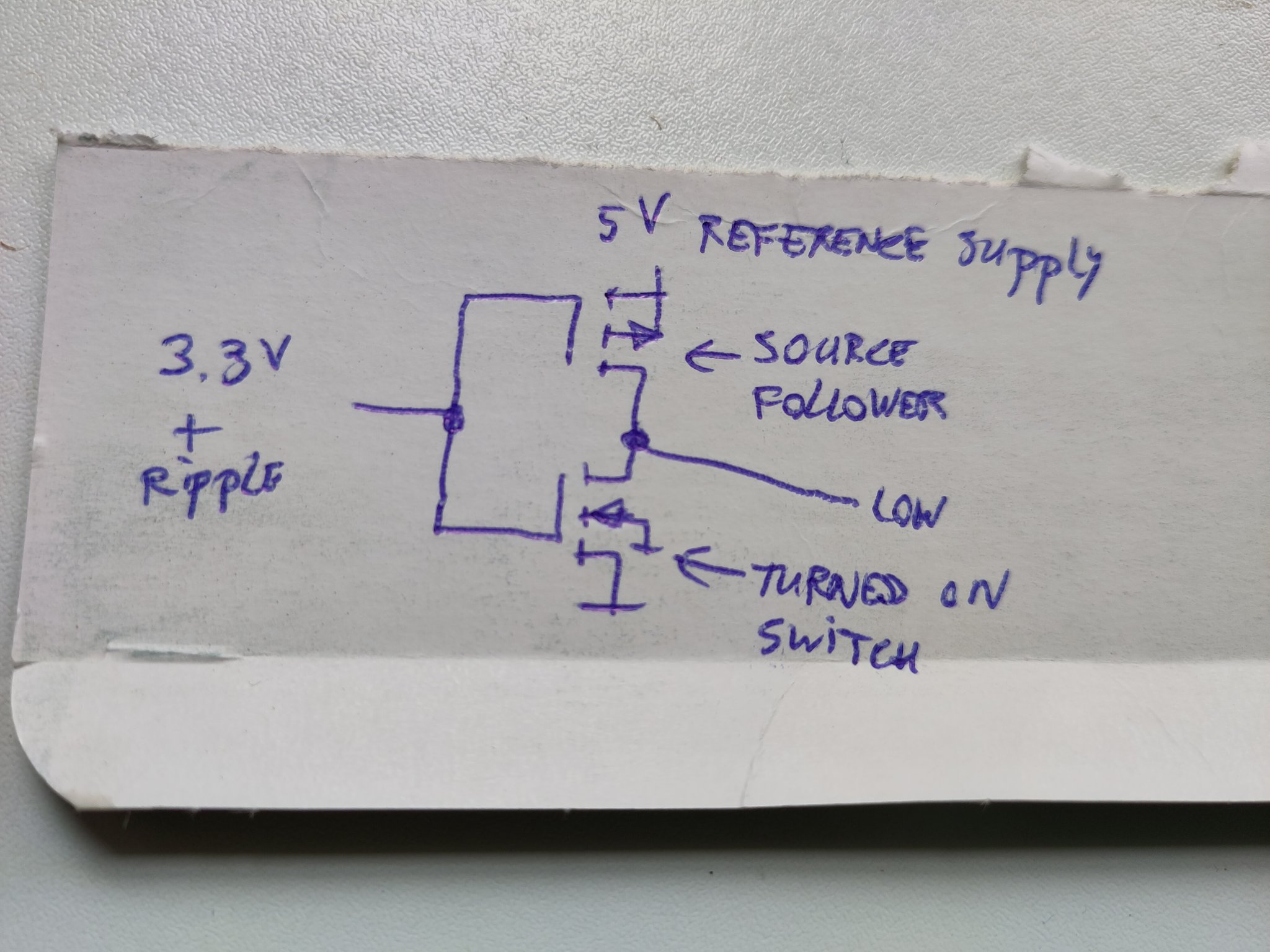

When you drive SN74ACT16374A inputs from a dirty 3.3 V domain, the high inputs will draw an overlap current from the 5 V reference that depends on the momentary voltage at the dirty 3.3 V.

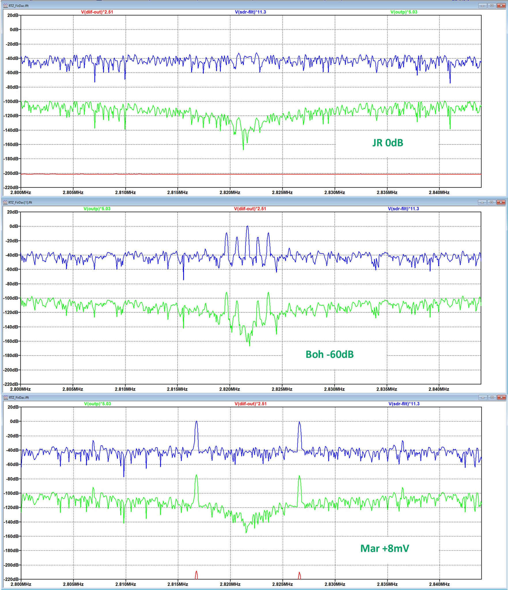

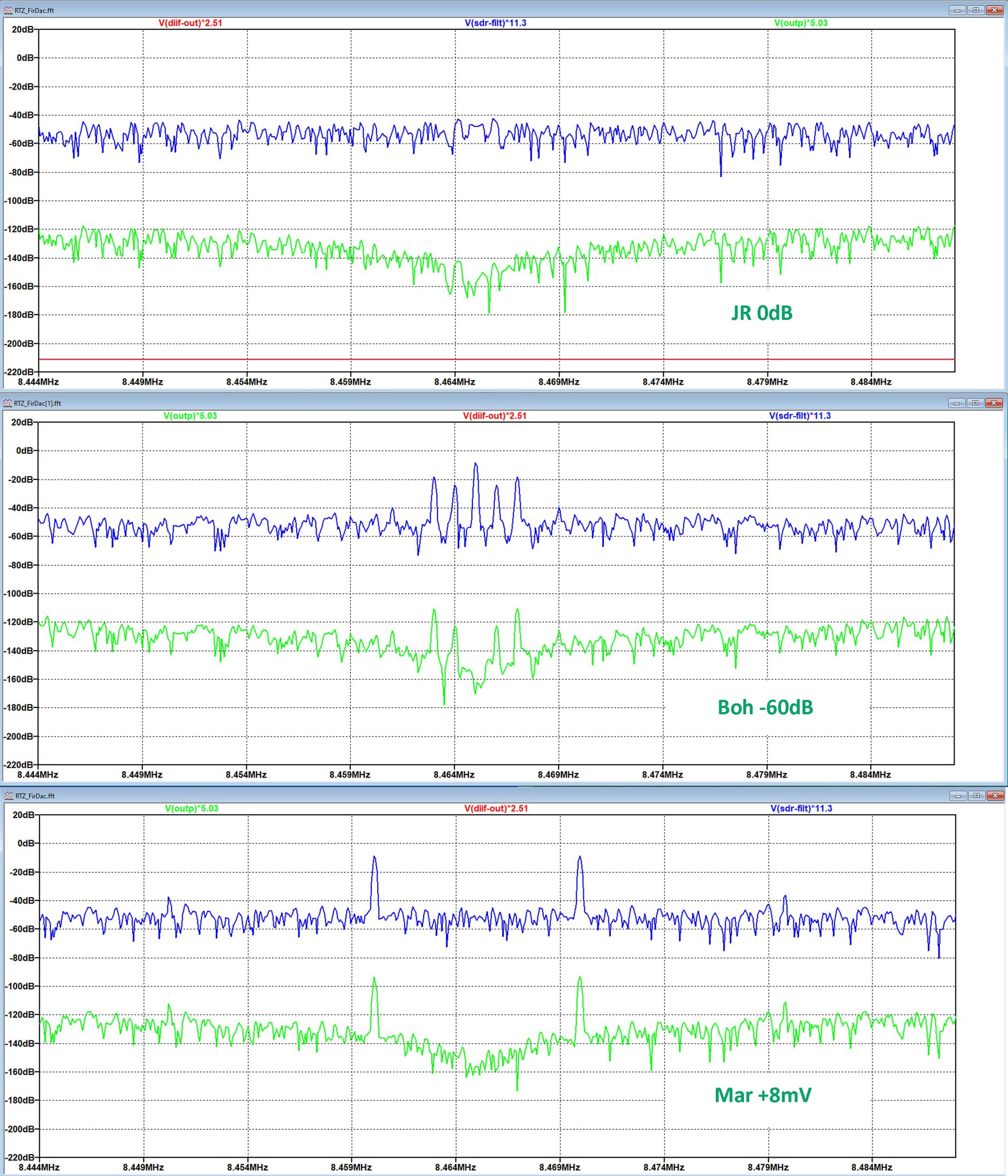

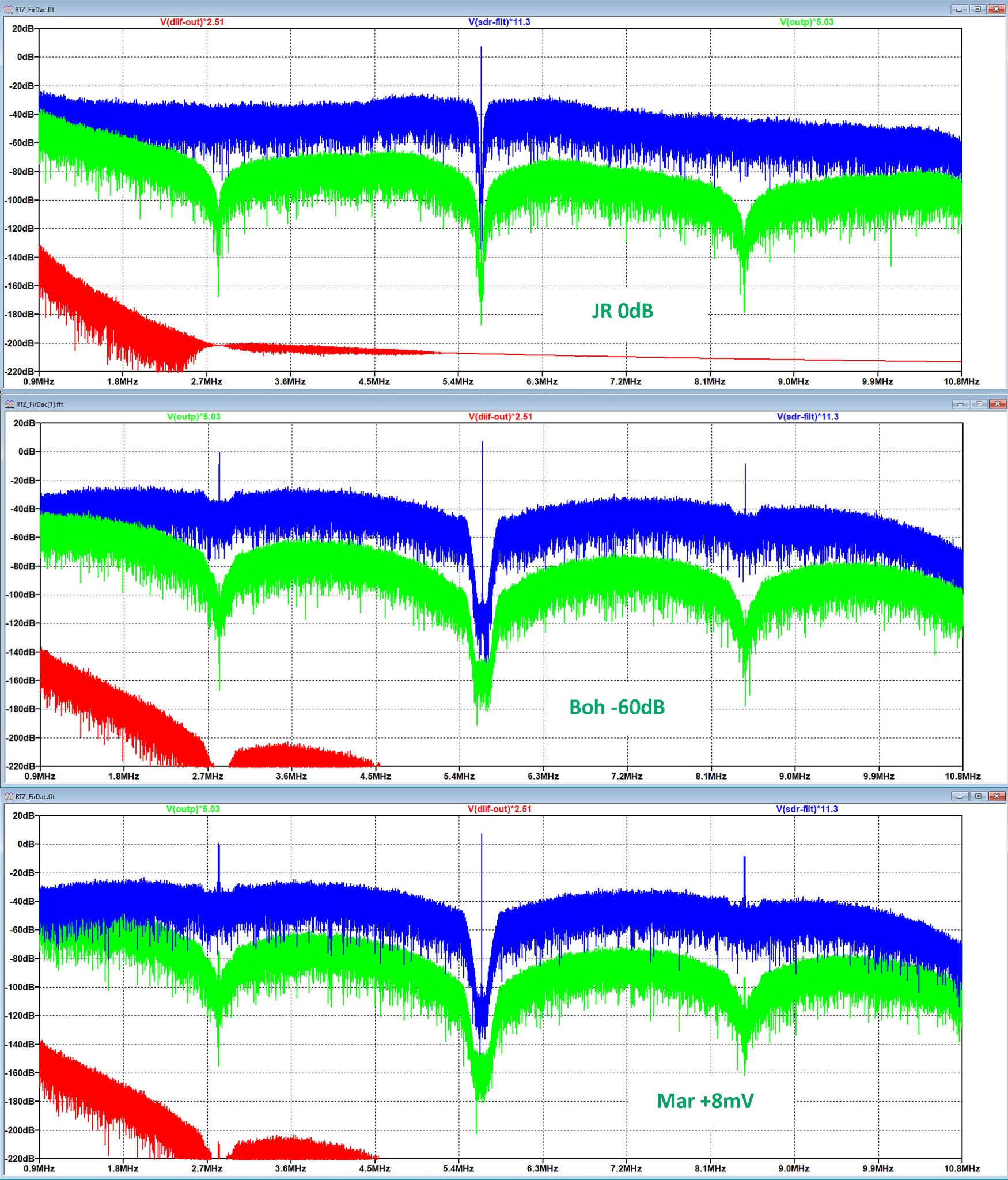

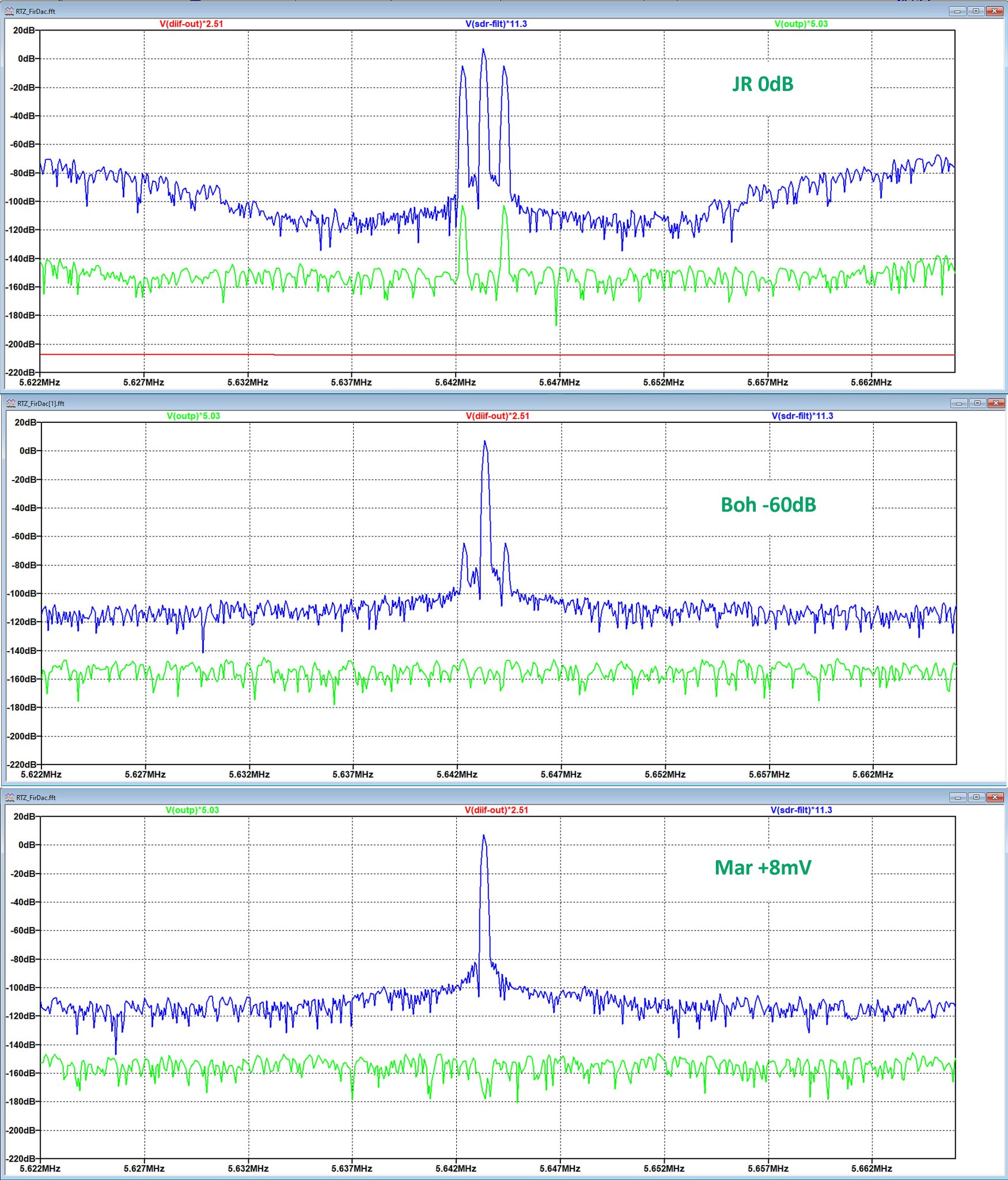

The plot in post #2696 shows that a +/- 1 ppm change of the bit weight depending on the previous bit is enough to produce about the same intermodulation products in the audio band as the present DAC and filter do. Now suppose a three-state output with a capacitance of 5 pF were connected to an ideal virtual ground via a 3 kohm resistor. In the high-impedance state, the discharge time constant would then be 15 ns. If there were 45 ns available for discharging, about half a DSD256 bit clock period, that would only be three time constants. That is, there would be almost 5 % of the previous bit voltage left at the start of the new bit, and that should disturb the weight of the new bit by less than 1 ppm.
With a nonideal virtual ground or no virtual ground at all, the voltage the output would settle to in its high-impedance phase would depend on more previous bits, presumably making things worse.

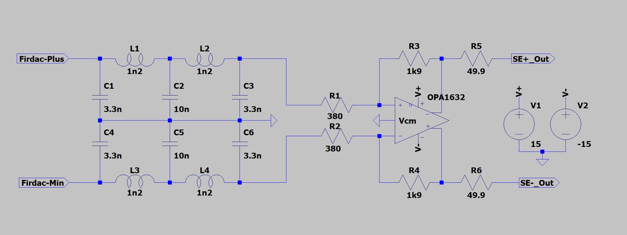

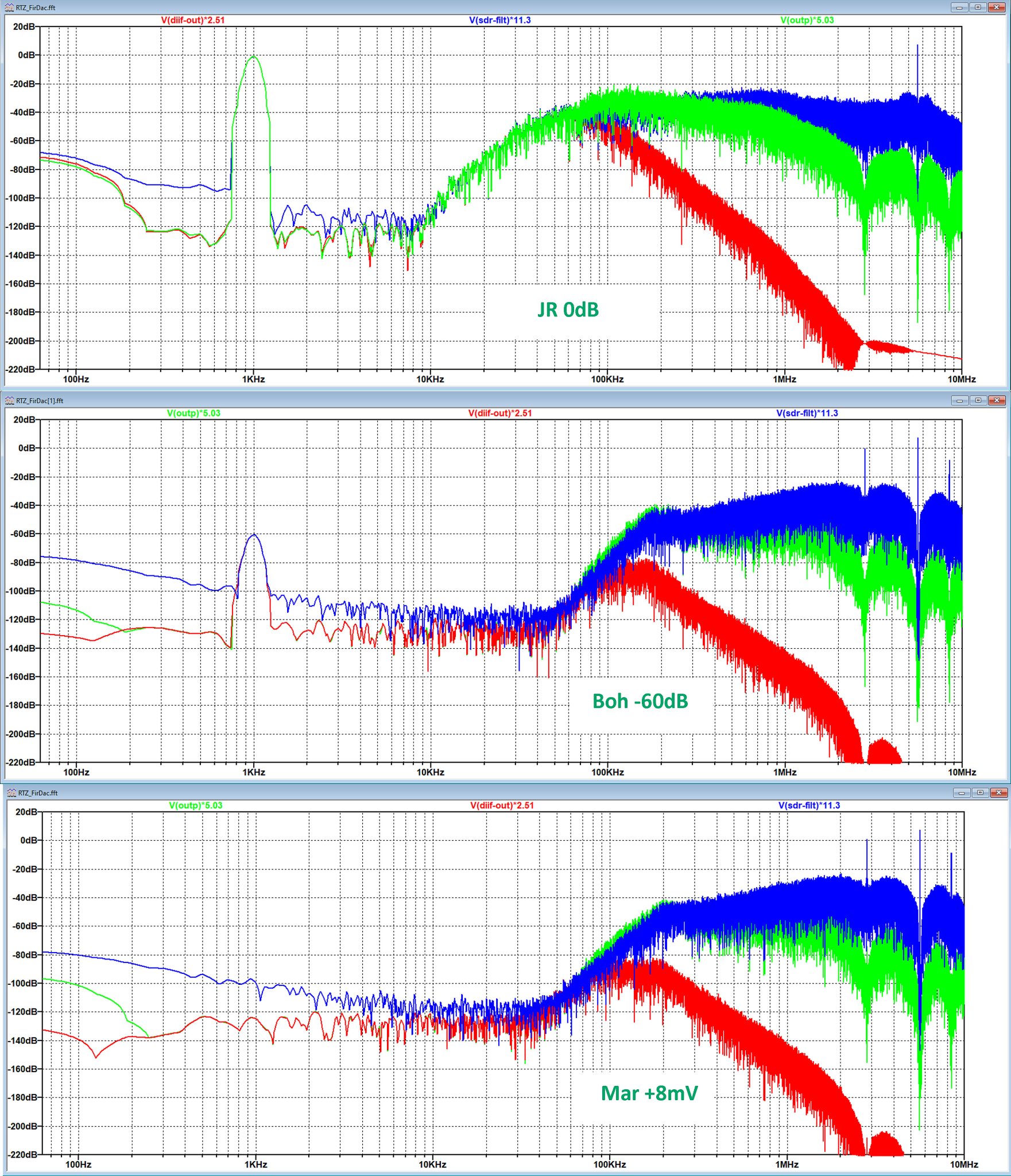

So far bohrok2610's measurements seem to indicate that the filter is the performance bottleneck, at least for low-level distortion due to intermodulation between out-of-band signals, but assuming that that will be fixed
My concern is that at least in theory we should not have this. FIR lowpass and inherent RC filtering with 3uS turnover (~53kHz) should keep supersonic problems at arms length.
If additional LC filtering helps, we need to consider that we have a fidelity impairment risk upfront in our DAC structure, which is unexpected actualised with certain types of analogue stages.
You mean through the P-Channel device's Ciss? It is probably worth slowing the edges here to minimise this feedthrough.

Correct. Signal is not really affected as such.
HOWEVER, the current in the 5V DAC Supply will differ.
If we slow edges of the data lines to guard against feedthrough and have a complementary layout and signals we can expect substantially less "spikey" current on the reference.
There is just less swicherigerdiroo going on on that chip. As said, a chip with dual supply domains for input and output we can improve the situation a little more.

In systems with full ground and power planes usually the determining factor for bypassing are the pins, PCB Pads and via's, the planes have enough capacitance to swamp out any sensible bypass Cap's inductance.

If we look at an Inverter, the reference point for the N-Channel is Vss (aka "GND") and when it pulls an input and a strip-line low the current return path is via the Vss power plane (aka Ground Plane). The reference point for the P-Channel is Vcc (aka "PWR") and when it pulls an input and a strip-line high the current return path is via the Vcc pin.
So depending on the PCB structure this current either returns via a bypass capacitor and the ground plane and another bypass capacitor (as we do not have a contiguous Power plane surrounding the signal line) or via our Vcc power plane.
It is all about current loops.
That also contributes, but I meant through the source follower action of the PMOS.
The simplest way to make a TTL compatible input on a 5 V CMOS chip is just to scale the width-length ratios of the input inverter a bit, but with a PMOS threshold voltage of about -0.7 V, you then essentially have a PMOS source follower from the input to the 5 V reference supply for any input voltage from the switching point to 4.3 V.
  • Thank You
Reactions: 1 user
Joined 2007
Hi all,
& thanks for your feedbacks!
@bohrok2610 : Hmmm ... well, thanks for clarifying although it leaves me puzzled as to what is causing this higher THD in these three layouts. I do not think it is the output stage as the very same stage (Marcel's, without CM circuitry, on a good day clock-wise goes to - 127 dB THD in another DSD DAC). And I actually think the layout(s) are good each in its own respect ... Yet, given that the THD is higher in almost the same way, I reckon some kind of systematic phenomenon is going on ... Anyway, thanks for your helpful feedback!
@KSTR & ThorstenL : Thank you also for your feedbacks ... I suppose there are many ways of doing things depending on one's purposes and preferences ... I think I will let your comments simmer and see how they may inspire my thinking about this ...
Incidentally, I actually do not place that much emphasis on THD figures ... I just find that for an otherwise sensible/"identical" circuitry it may tell something about the "correctness" of the circuitry and changes I make to this circuitry (not intending to elaborate on this - I know there are many fine views on this subject).
Cheers, Jesper
Hmmmm....
AHC/AHCT Designer’s Guide September 1998
If I read this right, the PMOS appears to have a threshold of 4.5V - 1.4V .... 5.5V - 1.6V not 0.7V.
If we have the P-Channel turned on while the N-Channel is also on, we see significant cross-conduction. So I have my doubts that the P-Channel really has 0.7V Threshold and is conducting full on at the the same time as the N-Channel is conducting.
Instead of having this "always on" P-Channel (as it never turns off until you exceed 4.3V) which seems counter productive and would means in "H" there is always current conduction, instead there is a separate hysteresis circuit with a very weak P-MOS pull-up that is enabled if the output is High.
Now, perhaps TI saved the 3 helper fet's and instead make the upper transistor conduct slight, but that would give a very weak pull-up.
So I find the "source follower to +5V" questionable.
I will instead presume instead a P-Channel with ~ 3V Gate threshold, meaning the inpout voltage has to be below 1.5V for the P-Channel to turn on.
Do you have any reference for this that illustrates this to the contrary of my Presumption?

An alternative Passive Filter.
I first simulated the Firdac connected to a 4th order passive Butterworth filter @80Khz matching the 376,25 output impedance, but was not happy with the suppression in the Mhz region from shift-register's from input to its output , most likely because the filter started with an inductor.
That's why I then prefiltered the Firdac's output with a cap, followed by a buffer. This already gave a solid improvement.
But Marcel pointed me in the right direction to either reverse the 4th order filter having a cap at it's input or use a 5th order passive filter, starting with a cap and making at the same the buffer obsolete, so that's what I did.
Bohrok did a suggestion for this passive 5th order filter with 1.8mH inductors having a low series resistance that are readily available from Mouser.
The input cap for this filter would have been 2.2nF, but I used a slightly larger 3.3nF input cap with 1.2mH inductors.
Inductors and caps values can easily be changed into other values by multiplying the inductors by X and the caps by 1/X.
In the simulation three signals were compared, 1) the shift-register's input signal, 2) It's he output at the eight resistor summing point and 3) the signal at the filters output.
To be able to compare suppression in absolute sense, these signals had to be corrected with a factor,
The maximum versus minimum output from an unloaded Firdac's summing point is 3/8*4.5Volt versus 1/8*4.5Volt, a difference of 1.125Volt or 0.398Vrms for a sine wave.
Since the used passive Filter with 376.25R termination divides that output on the summing point by two, the level at this point has to be multiplied by 2/0.398 = 5.03 to get a 0dB input signal at 0dB level in the simulation.
With the same calculation can be found that the shiftregister's input signal with 1Volt logic has to be multiplied by 11.3 and the DM signal at the filters output by 2.51.
That's what the first attachment is showing for the three different .dsf files that were used, resp:
a 0dB@1Khz converted by Jriver, a -60db@1Khz provided by Bohrok and a file from Marcel with a DC offset of ca. 8mV.
In the attached images I referred to then as JR 0dB, Boh -60dB and Mar +8mV.
With JR 0dB and Boh -60dB, the levels of the 1Khz signals line up perfectly, proving that the multiplication factors are correct.
In al images, also the next ones, Blue refers to the Firdac's shiftregister's input signal, Green to its summing point and Red to the 5th order filter output, in the simulation still terminated with 376.25R and without output amp.
Sampling was done with 1Ghz to prevent as much as possible aliases polluting the FFT spectrum, but nevertheless the Blue input signal in the audio band is still visibly somewhat polluted.
The second attachement is showing an image from the same spectrum but now magnified from 0.5 fs to 1.5 fs.
Quite obvious is that the JRiver converted file has no spectral peaks around 0.5 fs and 1.5 fs
Third to fifth attachment show the further magnified spectrum around resp. 0.5 fs, fs and 1,5 fs, all with a 5Khz/div on the horizontal axis.
Here it is becoming clearly visible what signals on the Firdac's summing point are causing trouble with the Op-Amp filters.
A complete filter including output amp, bringing the 0dB digital recorded level to 2Vrms out, is in the sixth attachment.
This time slightly corrected for the ca. 4R output impedance of the combined eight shiftregisters, bringing the impedance to 380R.
Finally to recapitulate, the noise produced by the equivalent Firdac as a voltage source with a 376,25R output resistance is 15nV/rtHz.
The OPA 2210 filter solution produces an equivalent input noise including the 376,25R resistor 13.6nV/rtHz RTI.
For the complete filter in the last attachment, but also including the 376.25R input, this is 7.2nV/rtHz RTI.
This passive filter followed by a level shifting and DC correcting op-amp solution has the potential to lower the overall S/N ratio by almost 1.7dB and because no feedback mechanism is involved directly after the summing point in the passive filter, no spectral lines in the audio spectrum above -200dB will appear such as suggested by the simulations.
Hans
