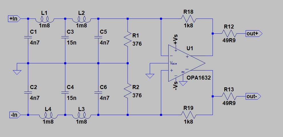

What is the purpose of the diamond buffer? Using reciprocity, you can swap the filter so that it starts with a capacitor and drive it straight from the DAC.

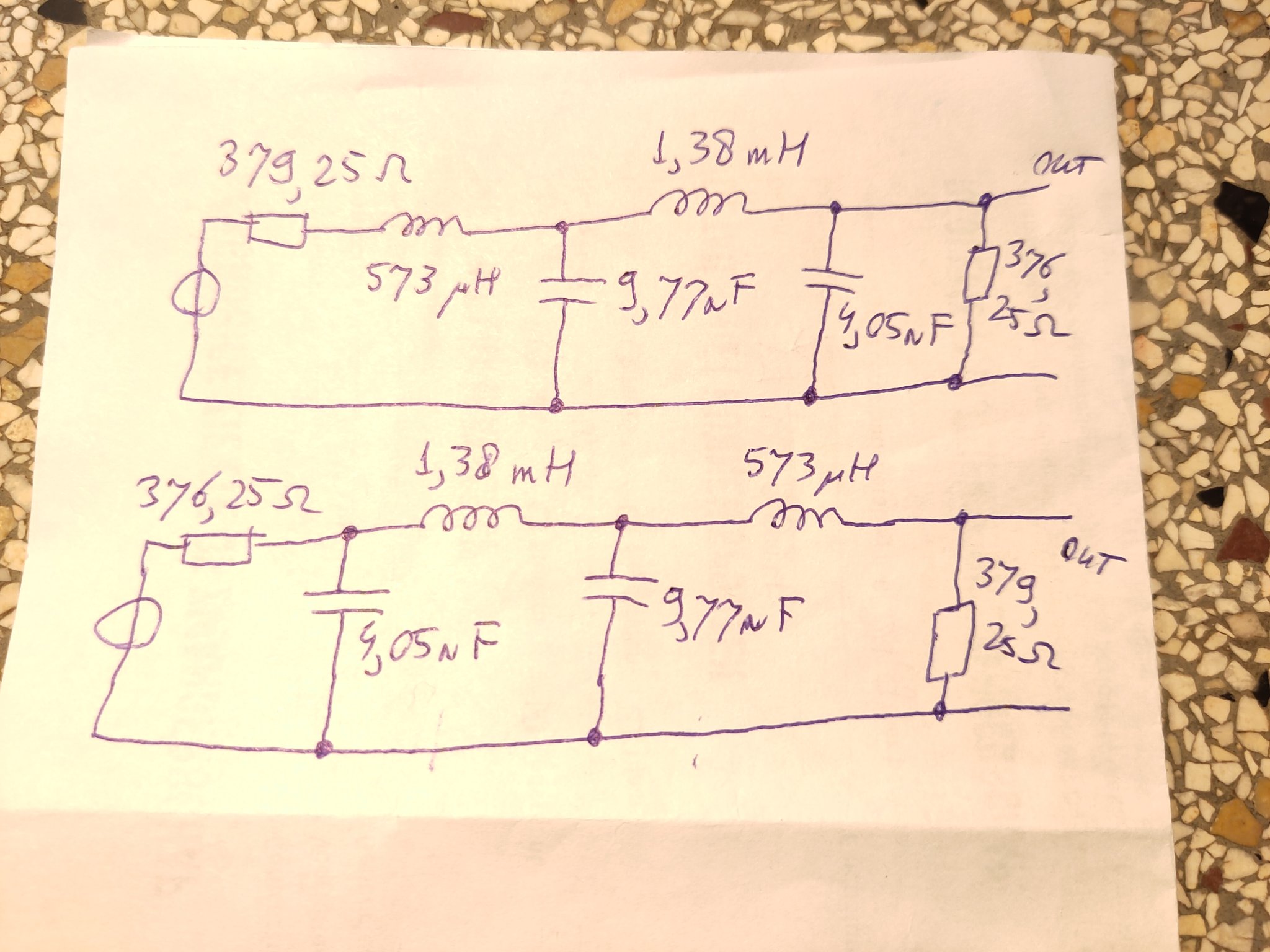

That was the filter on the 4th place with 376,25 impedance.
I tried that one where the summing resistors performed as the input resistor.
But when adding the 1nF cap additional to this summing point, resulted in a worse result in the simulation, that why I isolated the summing point with a buffer.

When you swap it, you have the 4.05 nF at the summing point. You could also go for fifth-order Butterworth.
Marcel, what exactly do you mean with swapping, starting with a cap instead of with an inductor for the Butt. filter ?
The 1nF I used didn’t turn the filter into a 5th order filter, but yes of course, 5th order is another option when starting with a cap and ending with a cap.
Good idea, I’ll give it a try, it could make the buffer unnecessary.
Hans
Yes. With swapping I mean making use of reciprocity and changing the source into a load and the load into a source. The impedances also have to be swapped: the impedance of the new source is the impedance of the old load and the other way around (which obviously makes no difference if the source and load impedances are equal anyway).

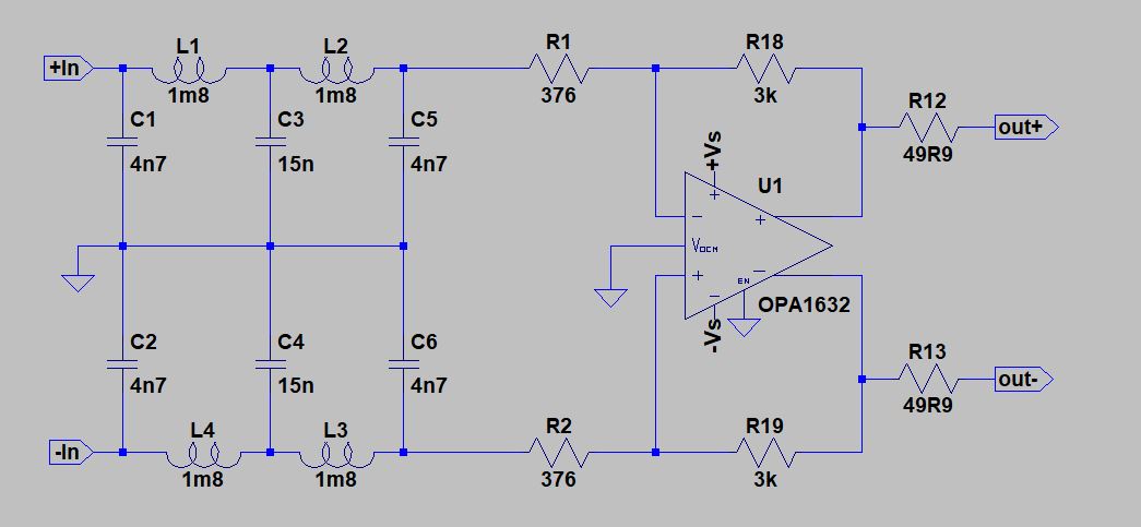

Here is a 5th order Butterworth adjusted to use available values for inductors and caps.
Inductors could be e.g. these:
https://www.mouser.fi/ProductDetail/Murata-Electronics/LQH43NH182J03L?qs=17u8i/zlE8%2BEHJV4Kc0uaQ==
This would be connected straight to summing resistors.
That’s interesting, but shouldn’t the 376R termination resistors not be connected to both OPA1632 inputs instead of to ground?
But yes, that was what came out of the discussion with Marcel.
Hans
