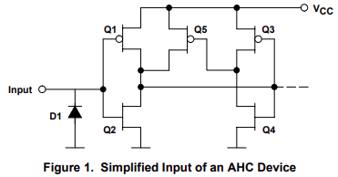

If I read this right, the PMOS appears to have a threshold of 4.5V - 1.4V .... 5.5V - 1.6V not 0.7V.
You don't. That's the switching threshold, where the NMOS and PMOS conduct equal current.
According to the document you linked to: "The threshold voltages Vt of the transistors are, in this case, about 1 V."
Still, the typical overlap current at 3.3 V in and 5 V supply is not as bad as I thought, at least not for Schmitt trigger inputs of TI SN74AHCT chips, according to figure 6 of the same document. I guess they put a diode-connected PMOS in series with the PMOS side to reduce overlap current.

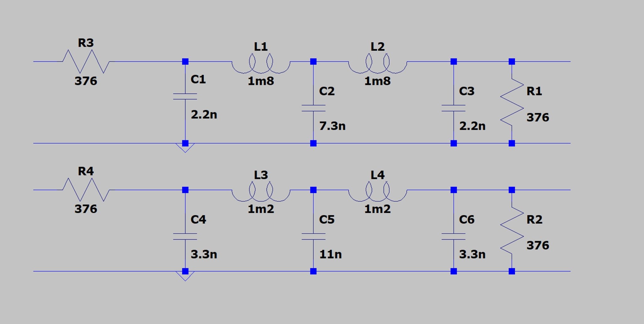

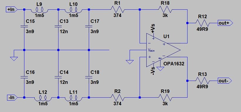

In the filter picture inductors are 1.2nH, not 1.2mH.I used a slightly larger 3.3nF input cap with 1.2mH inductors.
Here is what it ought to beIn the filter picture inductors are 1.2nH, not 1.2mH.
Hans

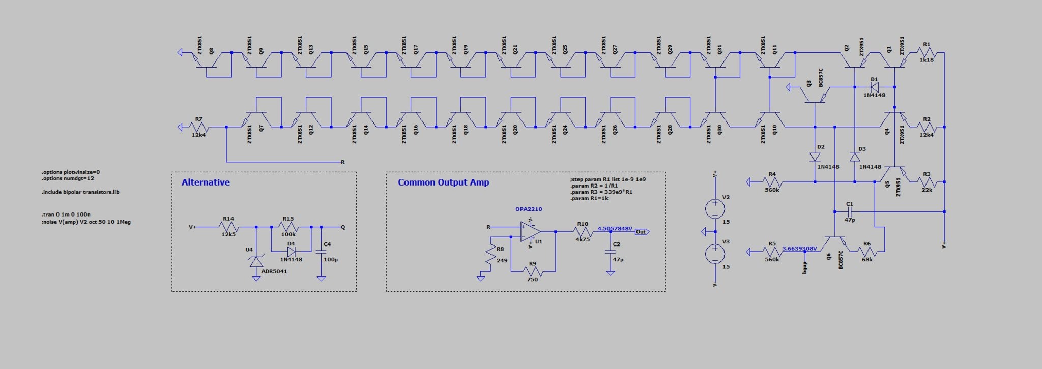

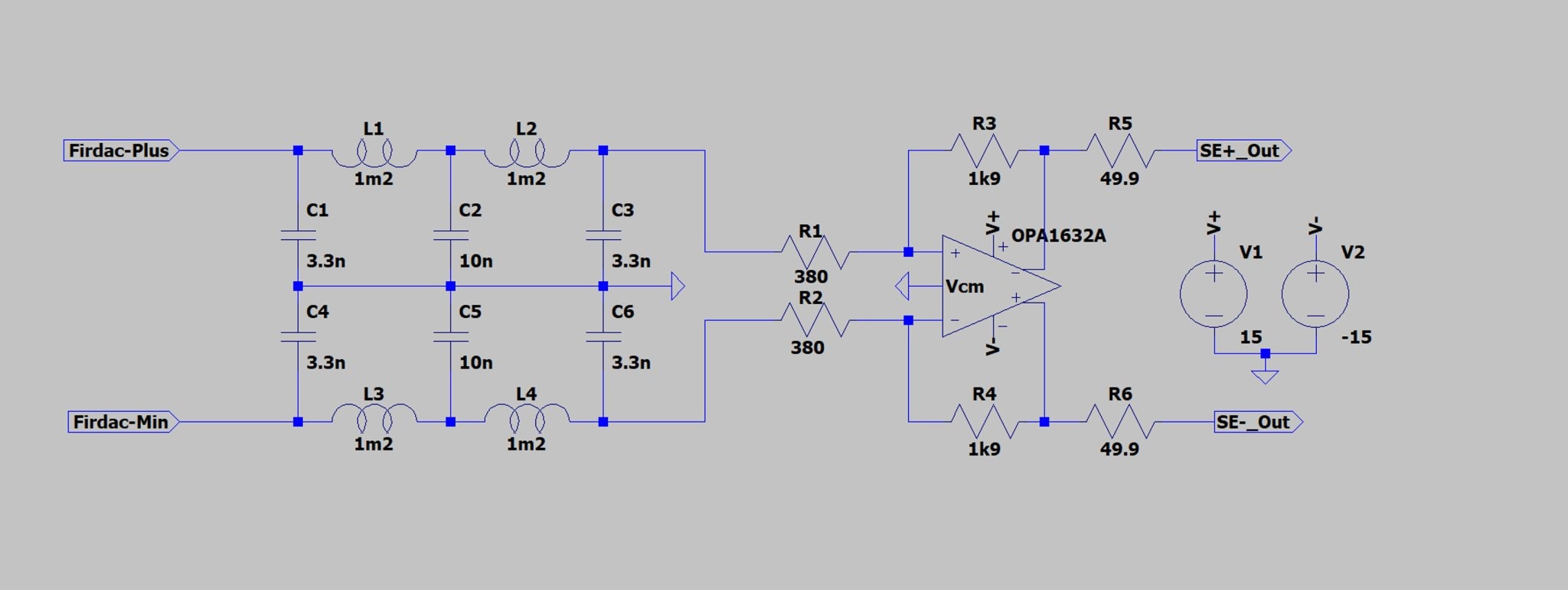

In my sim it was 4.5057 ??Minor detail: the DAC reference supply is typically 4.96 V rather than 4.5 V.
Hans
In my reality it's about 4.96 V.
I see that you are using different transistors. If their base-emitter voltage is 113.575 mV lower, that would explain the difference.
That 1.18 kohm was the value I calculated for the double transistors that were unavailable, for the BCM56DS it has to be 1 kohm.
I believe you without restriction, there must be some error in my model, but it explains why I used 4.5 Volt 😊
Hans
Yes. Then I read it right. The P-Channel source connects to Vcc (say 5V). The switching voltage of the pair is at ~1.5V, where it draws maximum current.
That means the TH voltage (e.g. Id > 100uA) of the N-Channel is a little higher, say 1.7V from Vss and the TH Voltage of the P-Channel is a little lower, referenced to Vss perhaps 1.3V.
But the P-Channel transistor must reference Vcc, so it's TH voltage would need to be 3.7V.
Presumably, while 3-4V TH are common in switching Fet's, they are uncommon in logic, so perhaps a zener (connected FET) or Vgs mutiplier is implemented in the source line to shift the threshold vs a near 1V threshold.
Well, that statement is at odds with the observed supply current vs input voltage.
Well, they do something. And it works.
Incidentally, the document has also data on simultaneous switching, ground bounce and many other interesting topics, that were mentioned and queried here.

R4 has to be 798R for the ZTX851 that where used in my model, that single resistor compensates for the difference.In my reality it's about 4.96 V.
Hans

As 1.2mH inductors are not commonly available, I would suggest this version which has slightly higher fc than my previous suggestion. Inductor can be of the same series as previously.Here is what it ought to be

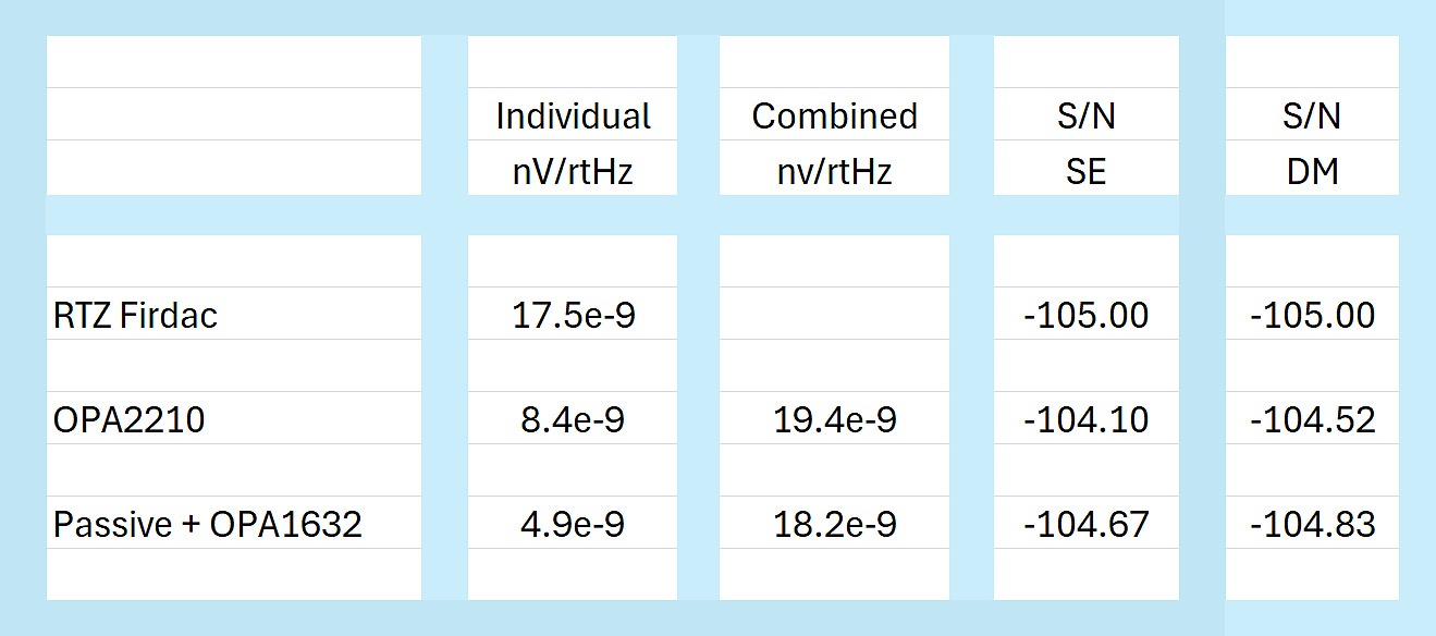

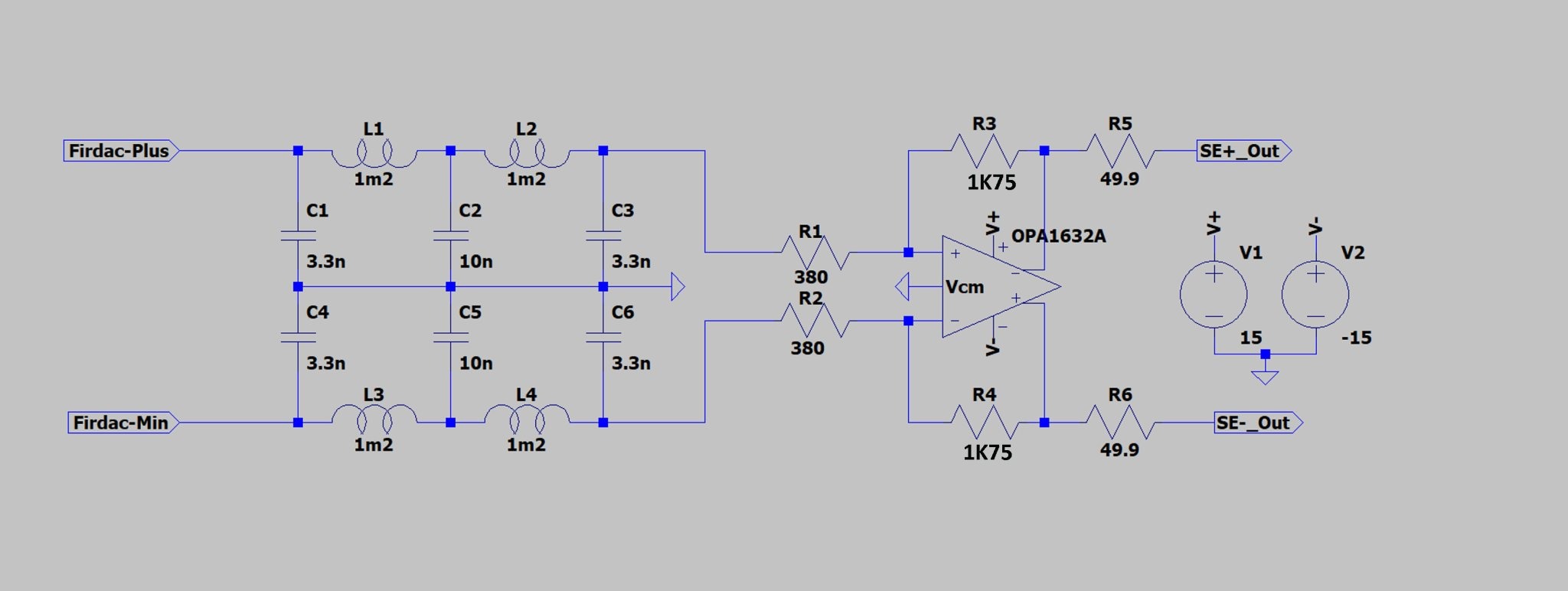

Because I used a wrong Vref on the Shift-registers, 4.5 Volt instead of 4.96 Volt, I had to redo the noise calculations and correct the gain resistor on the OPA16032 from 1K9 to 1k75 for getting 2.0V out at 0dB digital in.
Noise contribution from the OPA2210 filter is now lower because of the higher Firdac noise.
In the table S/N is shown for SE and for DM.
Hans

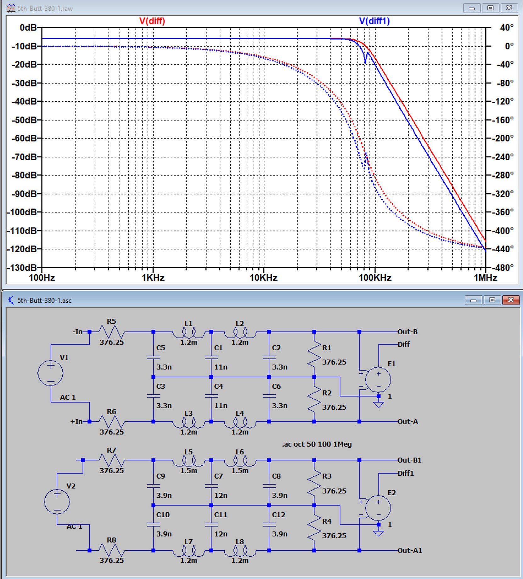

Yes you are right, that's why I mentioned that the 1.8mH you suggested are readily available. But because the caps in your proposal were not right for a 80Khz Butterworth, I simply took different values for the sim without looking at availability and fc.As 1.2mH inductors are not commonly available, I would suggest this version which has slightly higher fc than my previous suggestion. Inductor can be of the same series as previously.
But the inductor you proposed seems very appropriate for the job, but others may also be suited.
Hans

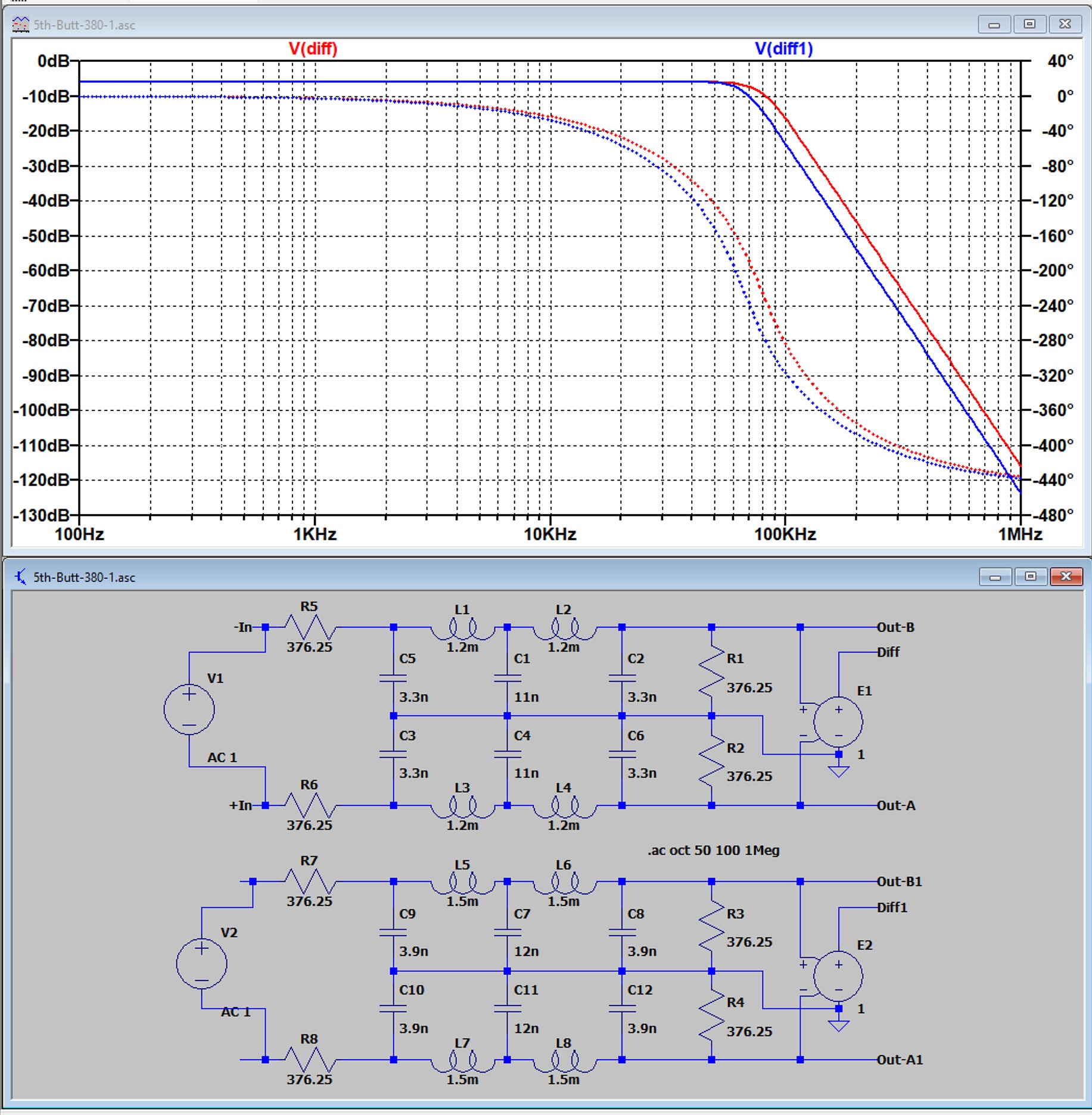

I was not aiming for 80kHz fc. My first filter had fc at about 53kHz. The second one at 65kHz.
Not meant in any way to criticize you, but something seems wrong with your filter calculation program.As 1.2mH inductors are not commonly available, I would suggest this version which has slightly higher fc than my previous suggestion. Inductor can be of the same series as previously.
See the strange hickup at 80Khz versus the values that I used in Red.
Hans
You have wrong inductor values in the lower leg.See the strange hickup at 80Khz versus the values that I used in Red.
Sorry, I failed to correct those two inductors.
Filter Is now at 65Khz and working perfectly.
Hans
