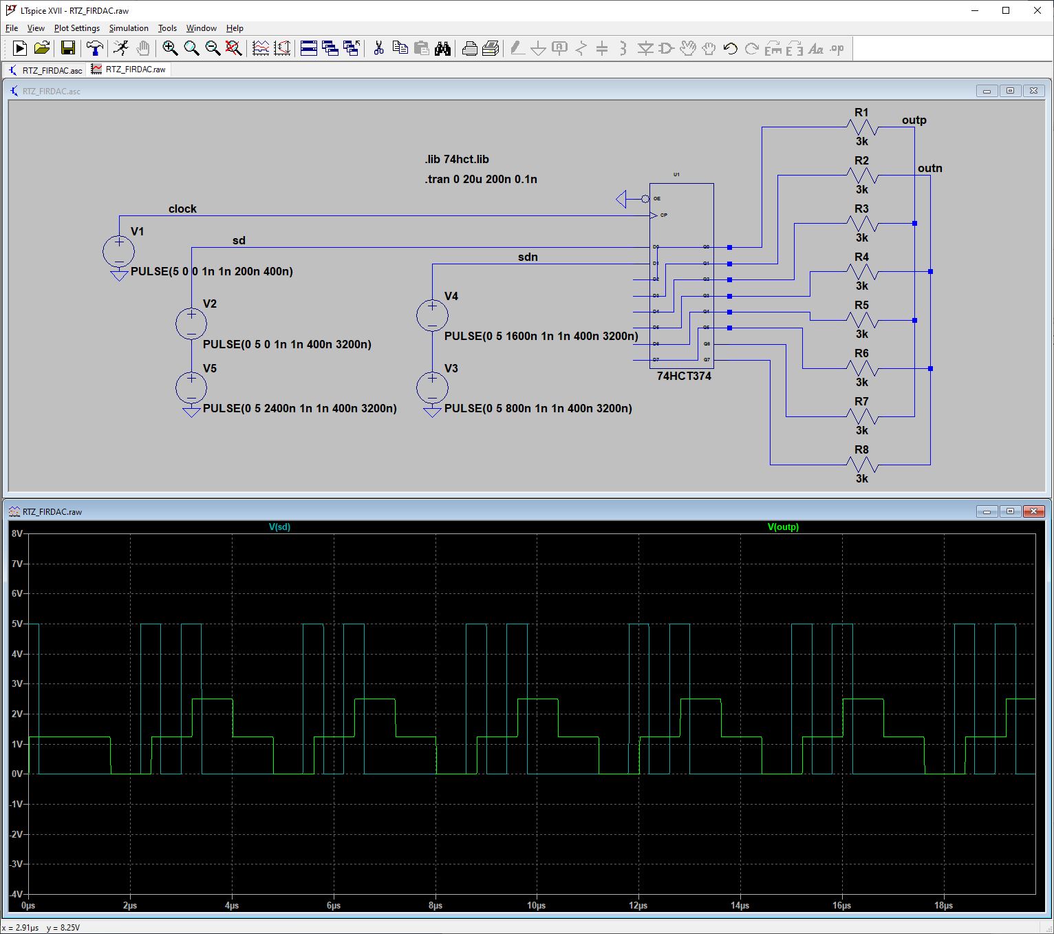

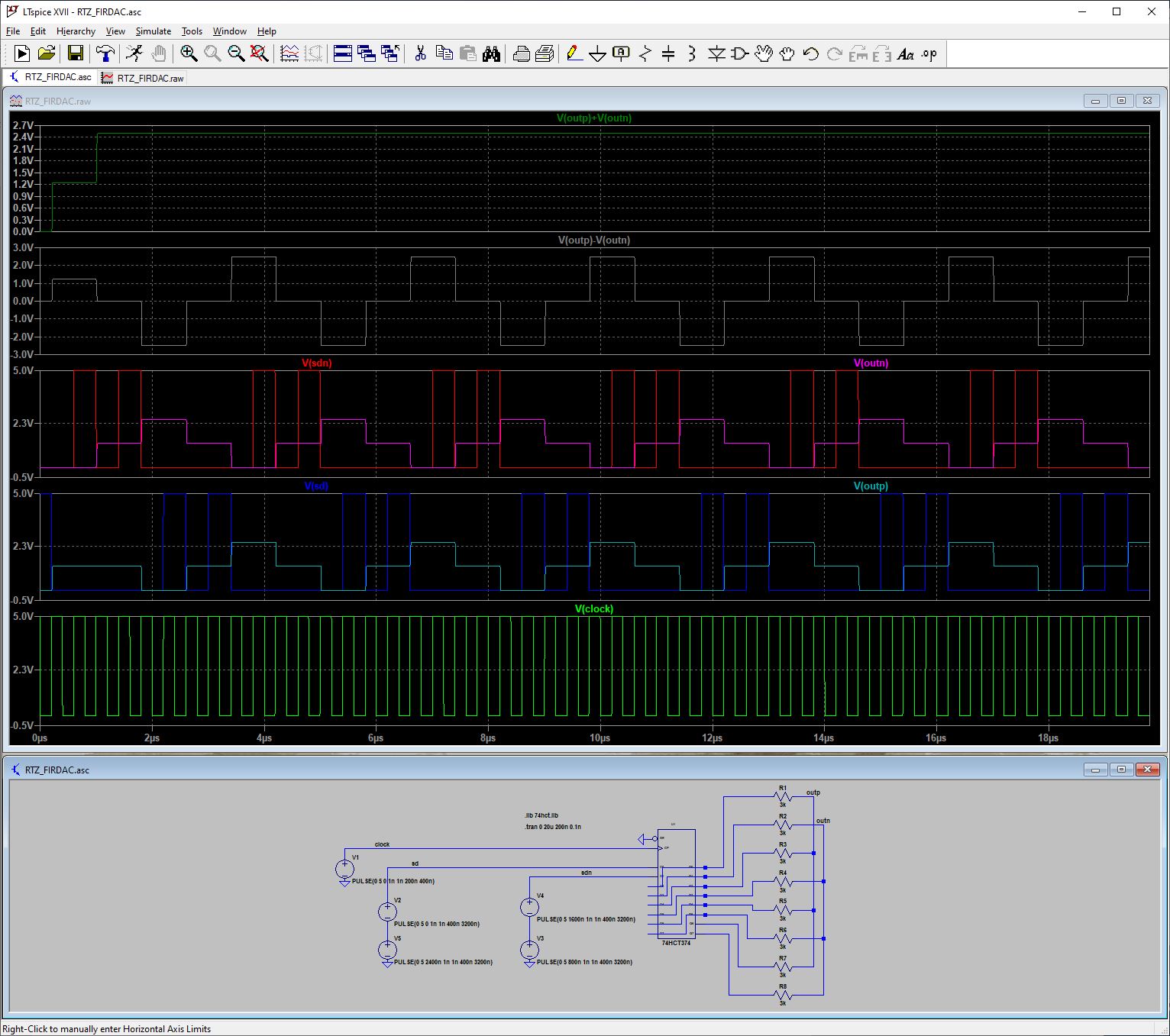

Here is an attempt to simulate shift registers with 10011001... pattern.
Cyan is sd and green is outp.

As I said the simulation is on shift register only. So clock=clock2f, sd=rtz_p, sdn=rtz_n.
This risks having incorrect relationships between signals, clocks etc.
It is better to account for the whole system. Otherwise we get assumptions about how things work baked into the sim.

Shift registers latch on the rising edge, timing between clock and data seems wonky?
Like this looks not quite right.
As said, when time allows I will input the whole DAC into TINA again and run everything again.

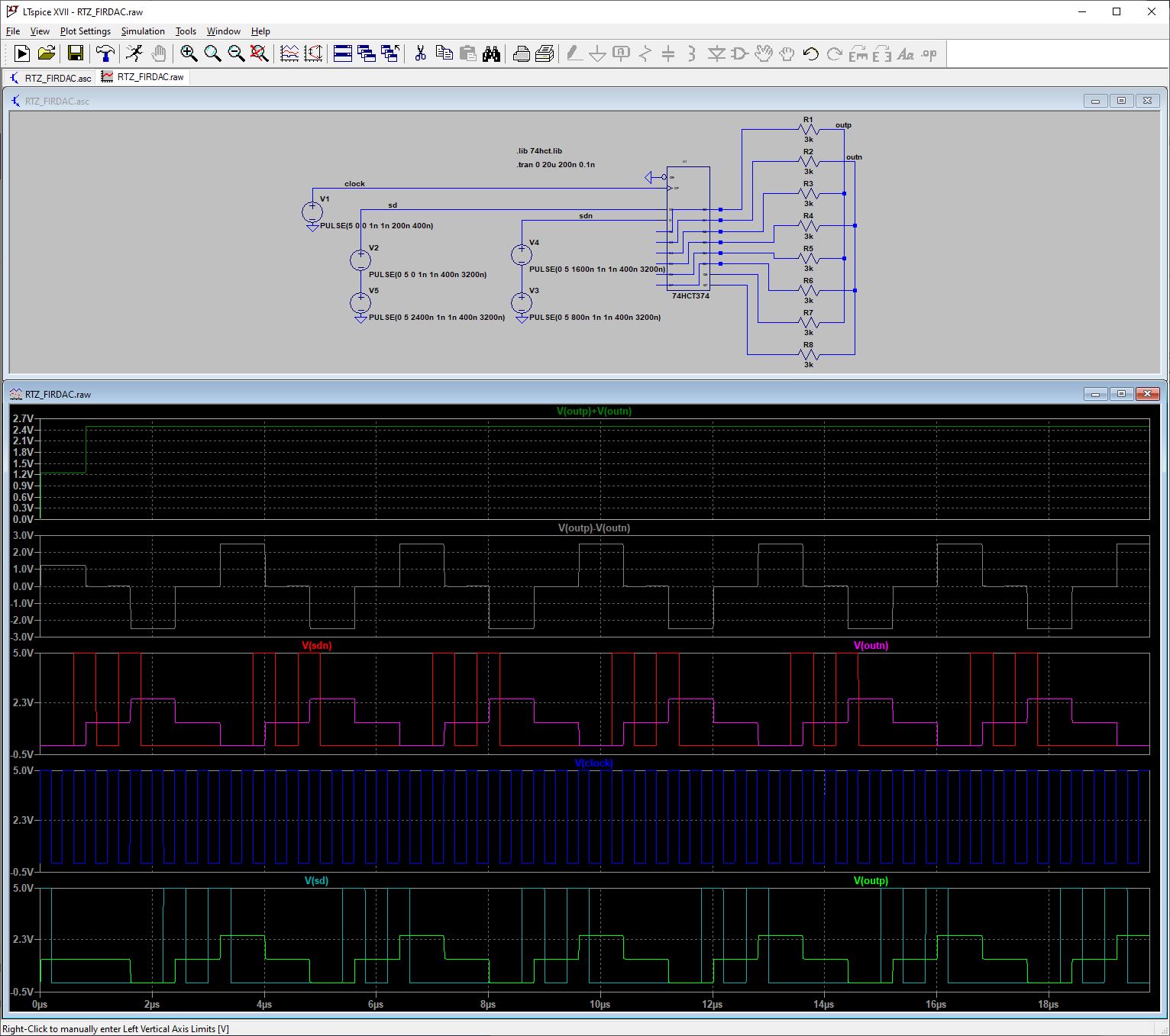

I added rest of the DAC digital circuit to the simulation. As expected results are the same.
I also included the LTSpice simulation file.
Looks interesting. I remember getting different results. Let me see. I find the display kills my eyes.

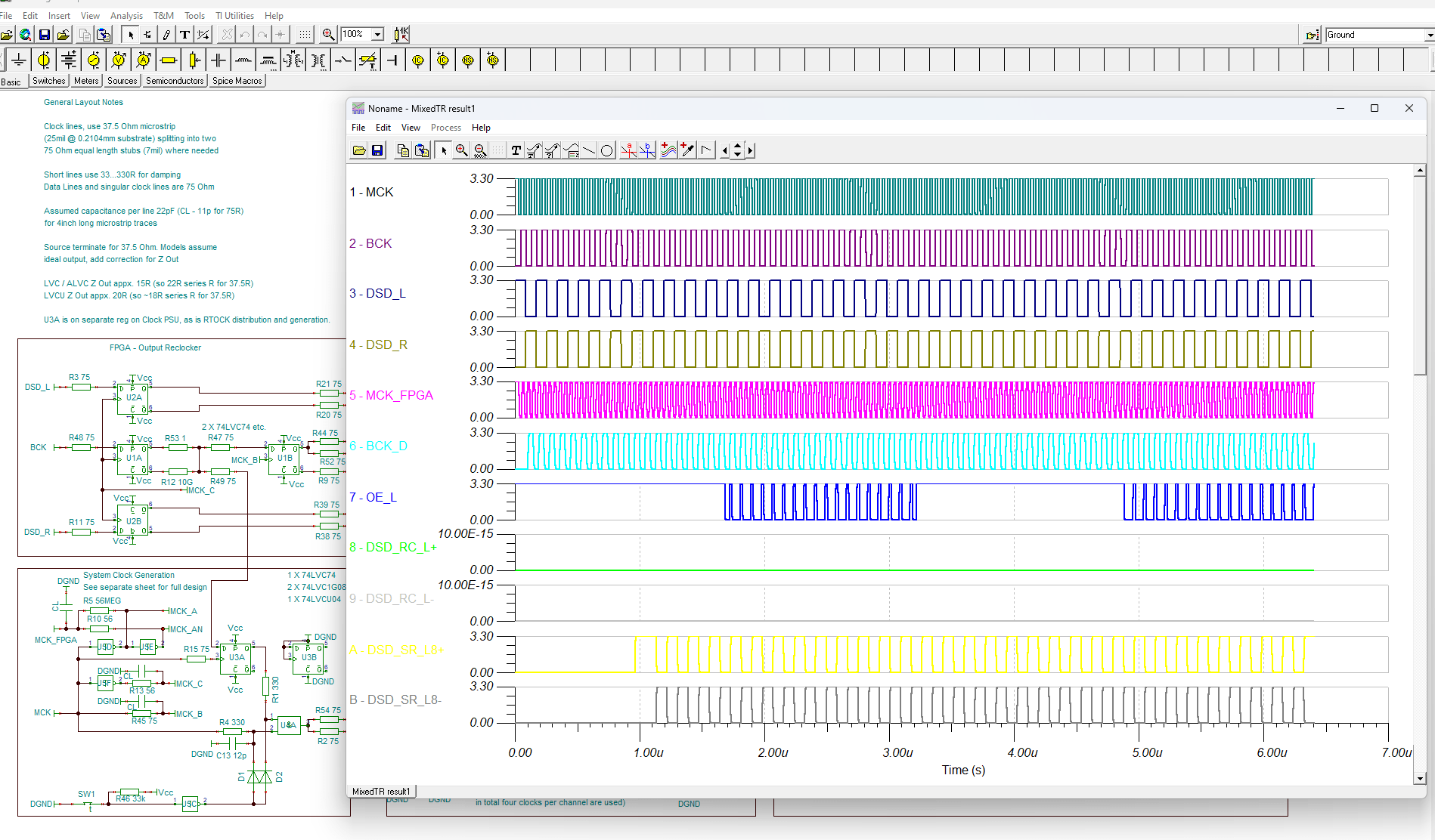

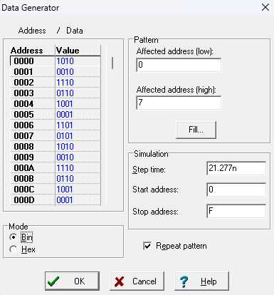

Something I'm working on.
The Digital Generator in TINA is totally horrorshow. You can literally set up any clock and bit pattern across many outputs:
Here you see MCK (2 X BCK), BCK and DSD Data L/R.
Thor likes to see 0110100101101001...
Not "like". 0x69h is the official idle pattern for DSD. It's like that for a number of reasons.
Other bitpatterns to try are 0x77h, repeated for (say) 100uS alternating with 0x44h for 100uS (near full scale 10kHz square).
The dearth of useful DSD test files means you need to create them on binary level.
Thor

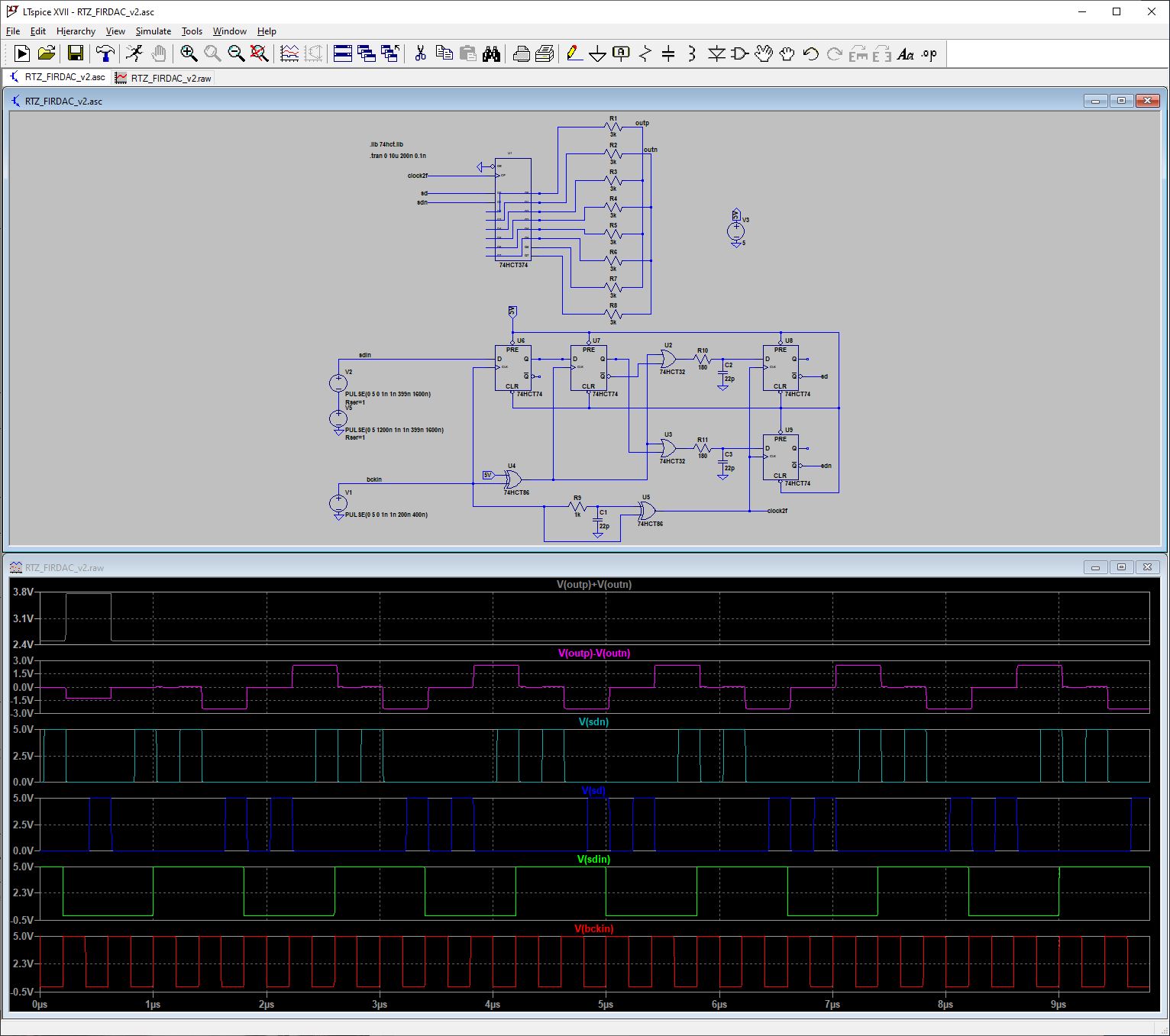

As you can see from post #2313, despite claims to the opposite, there is nothing wrong with Marcel's interleaving so simulations of other models would not necessarily reveal any improvements.
BTW do you know if there is a better way to generate pulse patterns in LTSpice than what I used in post #2313?
