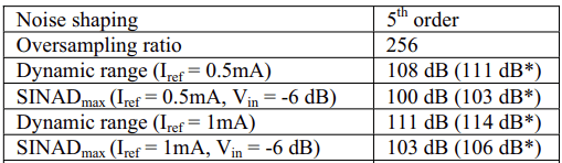

I don't know what paper you mean, but the picture in post #2310 is clearly about a digital hardware IP. If it were software, they wouldn't specify the equivalent number of gates.
FPGA? To me the program loaded into an FPGA is Software.
Hardware IP would be something that requires Litho etc. But I am, telling this to the IC designer.
Ok, found the full bit of advertising:
https://docplayer.net/58384198-Axiom_pwmmod256fs1b-256fs-1bit-pwm-sigma-delta-modulator.html
"The IP deliverable consists of a RTL description in VHDL of the PWM sigma delta modulator."
"Synthesizable as ASIC logic or on FPGA"
Anyway, the point is that with a sigma-delta with embedded pulse width modulator, you don't need an RTZ DAC, if you implement the modulator such that there is always one and only one gap between adjacent PWM pulses.
DSD full scale is 0x77h / 0x44h. How do you place this "gap" of one BCK between each pulse?
Reading this:
the PWM ΣΔ modulator implemented on an FPGA and a DAC build from common off the shelf (COTS) components (a 74HCT574, 8 resistors, an Op-amp and an RC feedback network), an audio performance of 110dB dynamic range and 97dB SNDR MAX was measured.
This does not seem to compare particularly well with your DAC, which has the same basic structure.
And reading this:
"PWM frequency of 16*fS"
It would seem we are de facto dealing with a PWM output at 16fS (768kHz) embedded in a 256fS BCK domain?

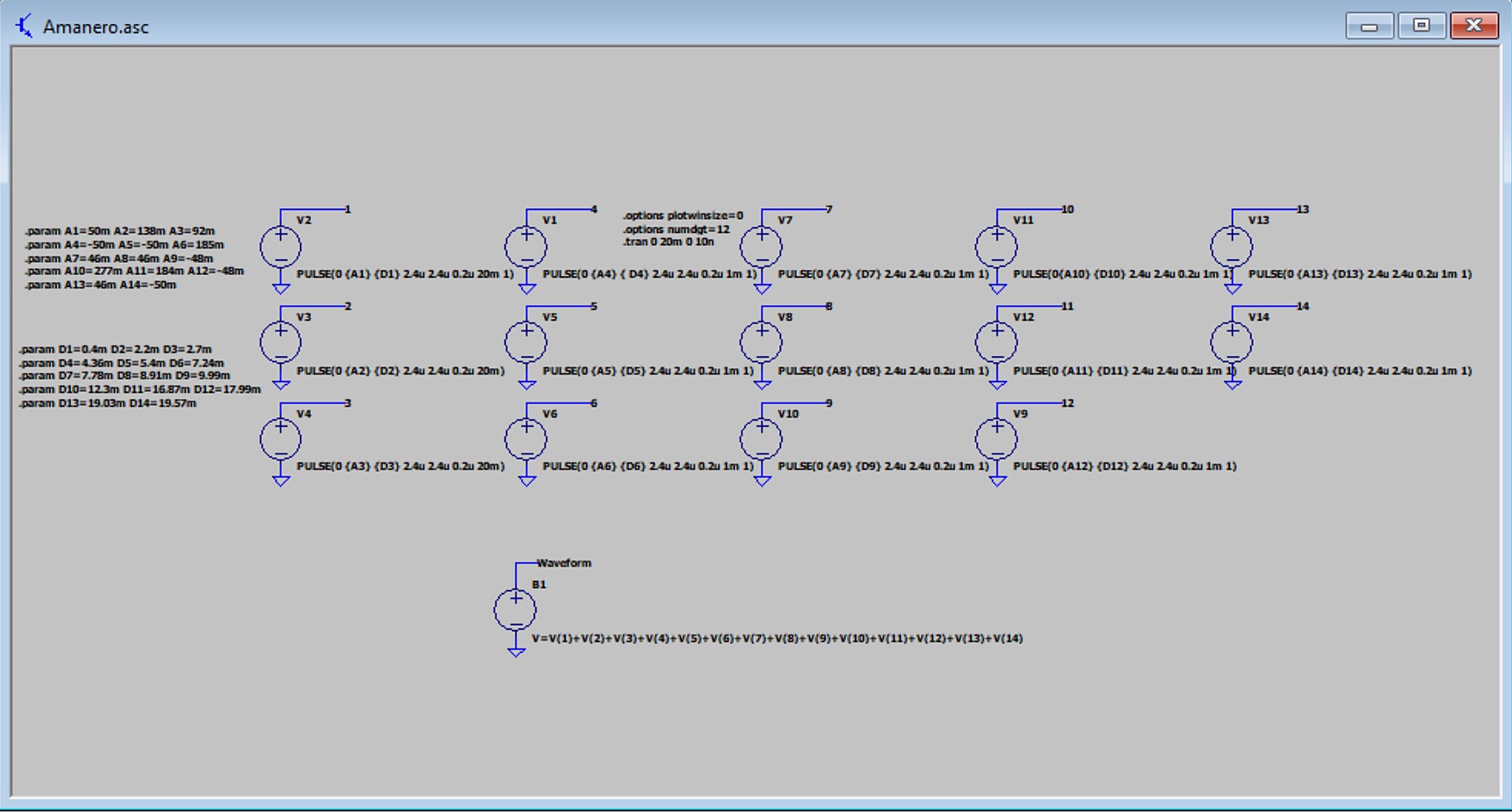

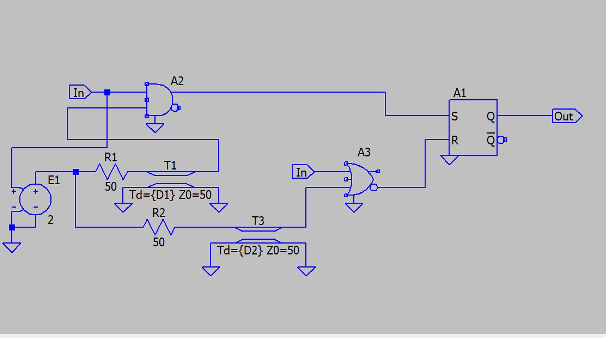

I make a subcircuit with various pulse generators that are added together in one sequence.As you can see from post #2313, despite claims to the opposite, there is nothing wrong with Marcel's interleaving so simulations of other models would not necessarily reveal any improvements.
BTW do you know if there is a better way to generate pulse patterns in LTSpice than what I used in post #2313?
Here is just an example where only amplitude and delay are put in parameters.
Behind logic circuits such as Gates and Flip-Flops I add another subcircuit with randomized Tr and Tf.
And to get a much better view on things in LTSpice, I use a BCLK that is at least 1/100 of the real clock.
See attachments.
Hans

Could you be more specific. What part of the RTZ circuit is missing in post #2313?I would not simulate the way you do, fractional circuits.
Output loading? For example. Most of the complete system.
Why not take a multichannel 'scope to the real circuit? Faster and you have the advantage over me of having actual circuit boards at hand.
