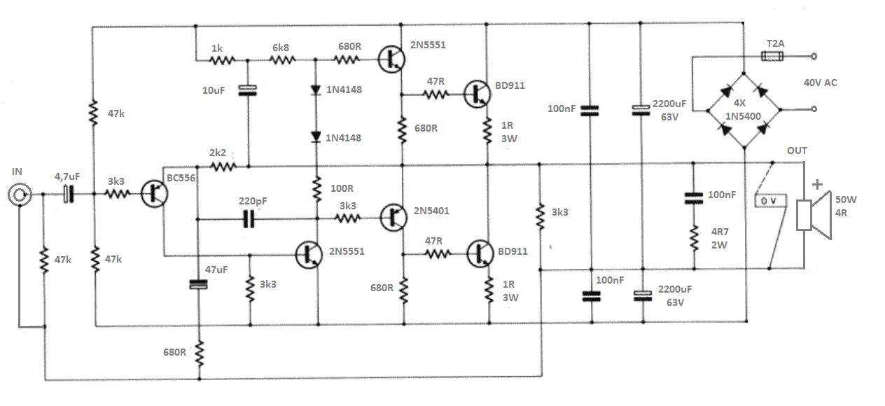

So, Terry, what would you say to folk afraid of a single supply amp because of an output cap ?
I think that is a non issue. This amp sounds lovely and the cap acts as a speaker protect at the same time.

But, if you were building your best amp, wouldn’t you default to no-cap?
I'm pushing you on this because you’ve built and heard more amps than most, so your opinion carries some weight. Say I’m going to build myself a nice Class A amp, do I go single or dual rail ? Simplicity says single rail, but audiophile says the most expensive and inconvenient approach is always preferred.

Is it ok to use a regular Non regulated DC power supply with the single ended 50w retro ?
I believe that regulated power supply is a must is this case.

You can put zener diode regulator parallel the 100 uf cap if you wish. I used 30 v, see schematic on page 22 Retro Amp 50W Single Supply - Page 22 - diyAudioTerry , you must have your own lab to make the boards so fast, assemble and listen to this amp while I was still debating if I should buy the nichicon kg Ist or IInd type. Congrats !

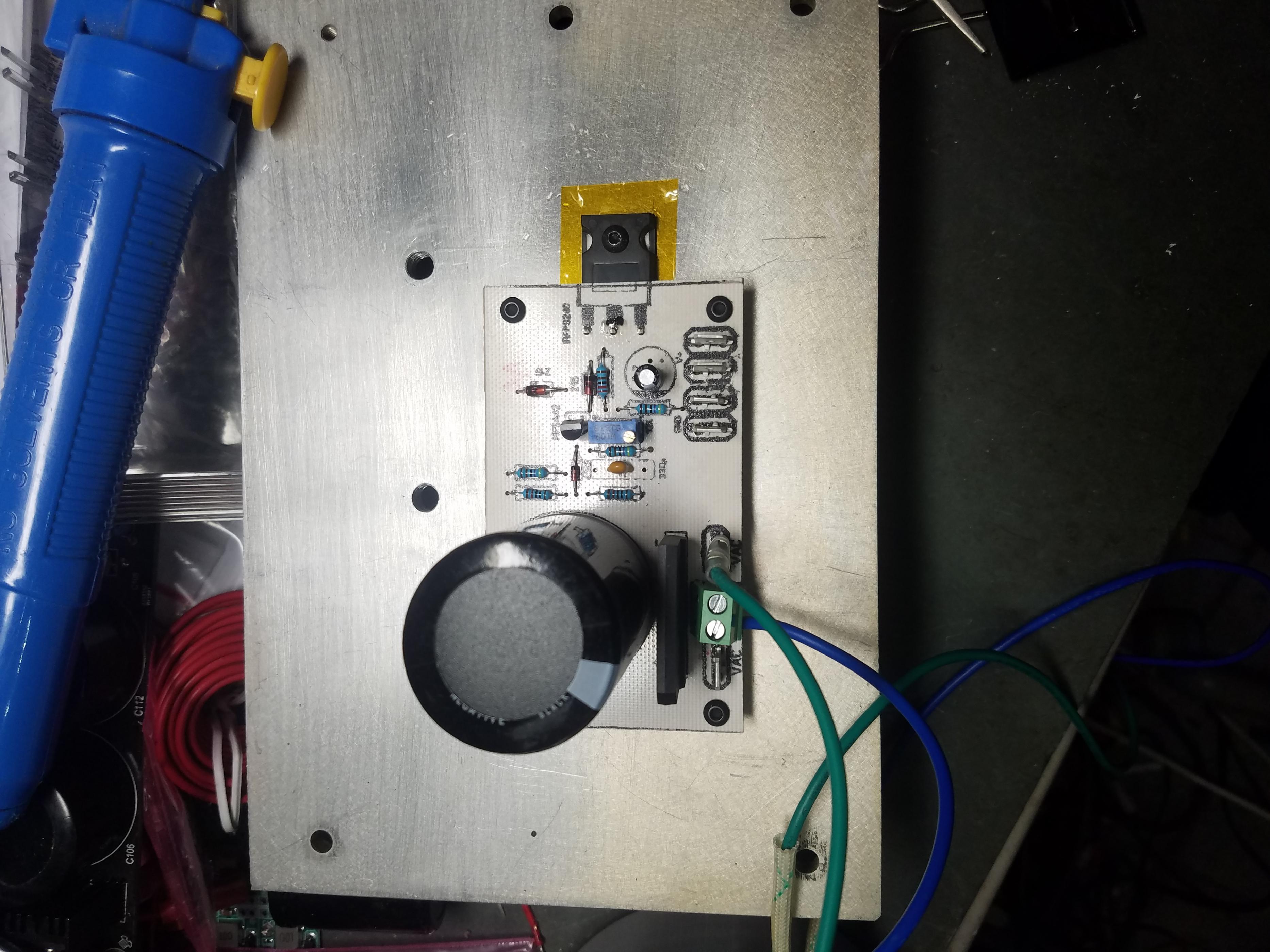

In an attempt to leave no stone unturned I built the PSU15R. Again I started with Prasi's design and added a bridge and a larger filter cap.
Also, I though I'd mention that a 10k pot is way more than needed. A 5k or even a 3k is plenty. You don't really see any drop in voltage until you hit about 2.5K
Blessings, Terry
Blessings, Terry
Blessings, Terry
With 10k pot output voltage can be set from 45v to 110v, with 2.5k pot only from 45v to 60v.
I only tested with 77VDC. I have a 5K in it. My cap is only 100V so 110v is out of the question.

I want to use a 50 Vdc rail for this amp, can I use BD139/140 iso 2SC4793/2SA1837. I will use 2n3773/ 2n3055 or BD xx output transistors ?

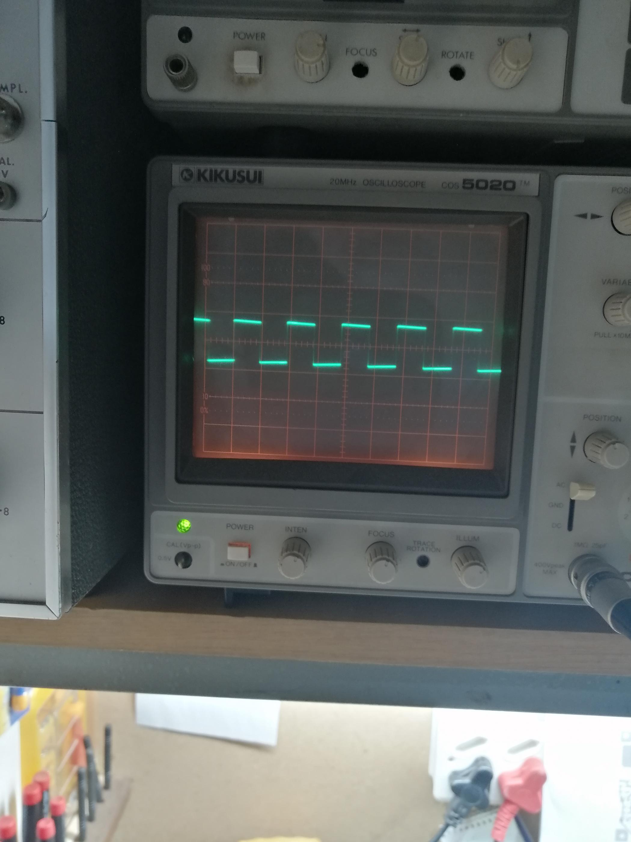

Good evening all,
I have build this amp, just a question or two if anybody can help.
1. I want to use this amp with a cellphone as a source, and cannot get a decent output , the sound seems lacking a bit. The feedback resistor is 6k8, must it be increased or decreased. It works great if I use a active preamp to boost the signal a bit.
2. This is a square wave output at 1kHz, the slope on the front side seems to be sloping up and down on the positive and negative wave. Is this acceptable ? Looks the same at 10kHz.Biased at about 15mV using BD243/244C as drivers and 2N3773 as outputs.
Help will be appreciated. Sorry , using 50Vdc as supply, have not yet connected a zobel to the output or an output inductor with a resistor. Negative rails clips a little before positive, will adjusting DC offset to midpoint make the square wave look better ? 🙂
