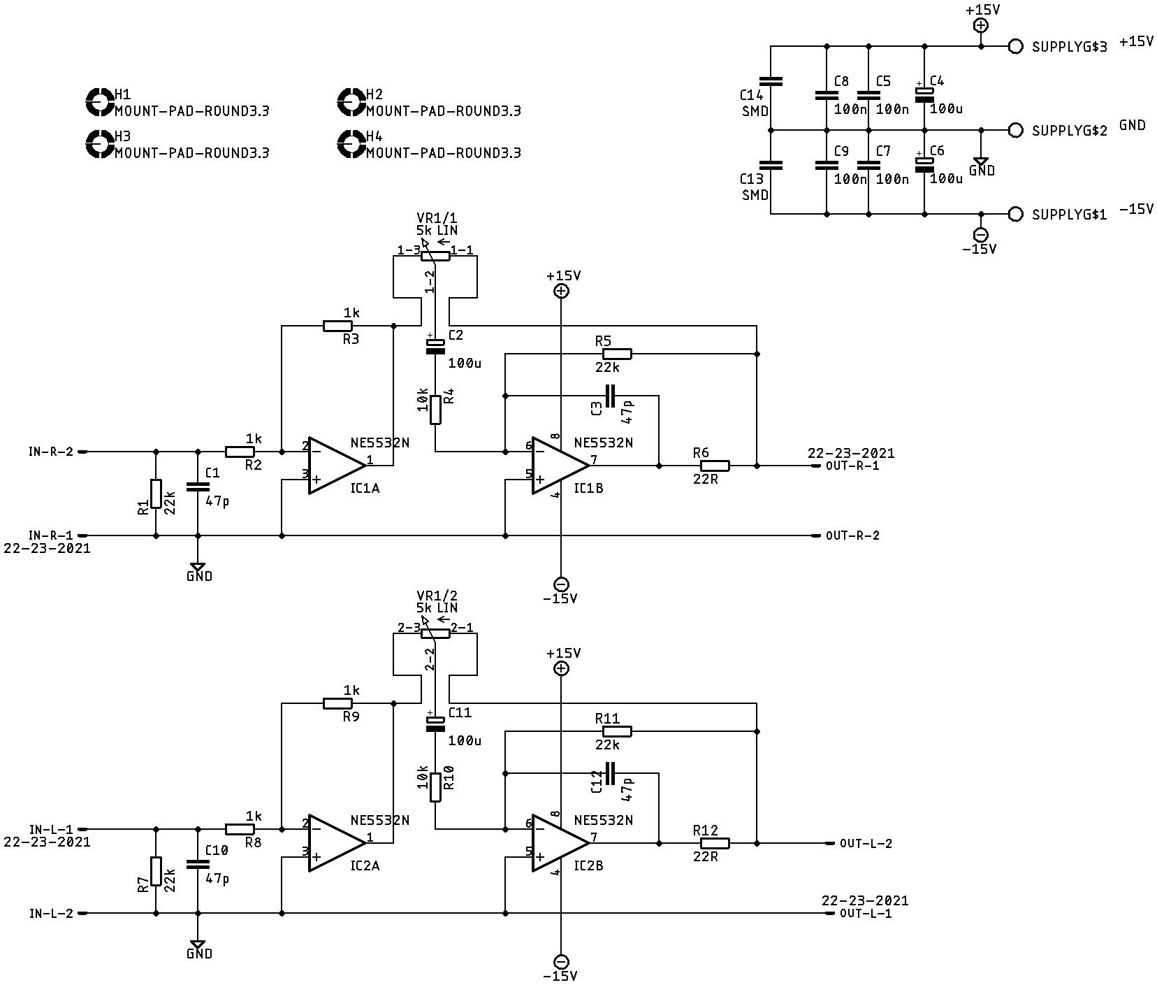

Please do not use such a circuit as you will be unpleasantly surprised when the potentiometer becomes scratchy! You can then also omit the 100 µF electrolytic cap and one of the opamps. Less is often more.
Such circuits are only there to be able to use linear instead of logarithmic potentiometers for volume control. Regardless of that (logarithmic potentiometers can be found everywhere) the drawbacks count too much. Suppose a scratchy potentiometer and try to imagine what will happen at the output.

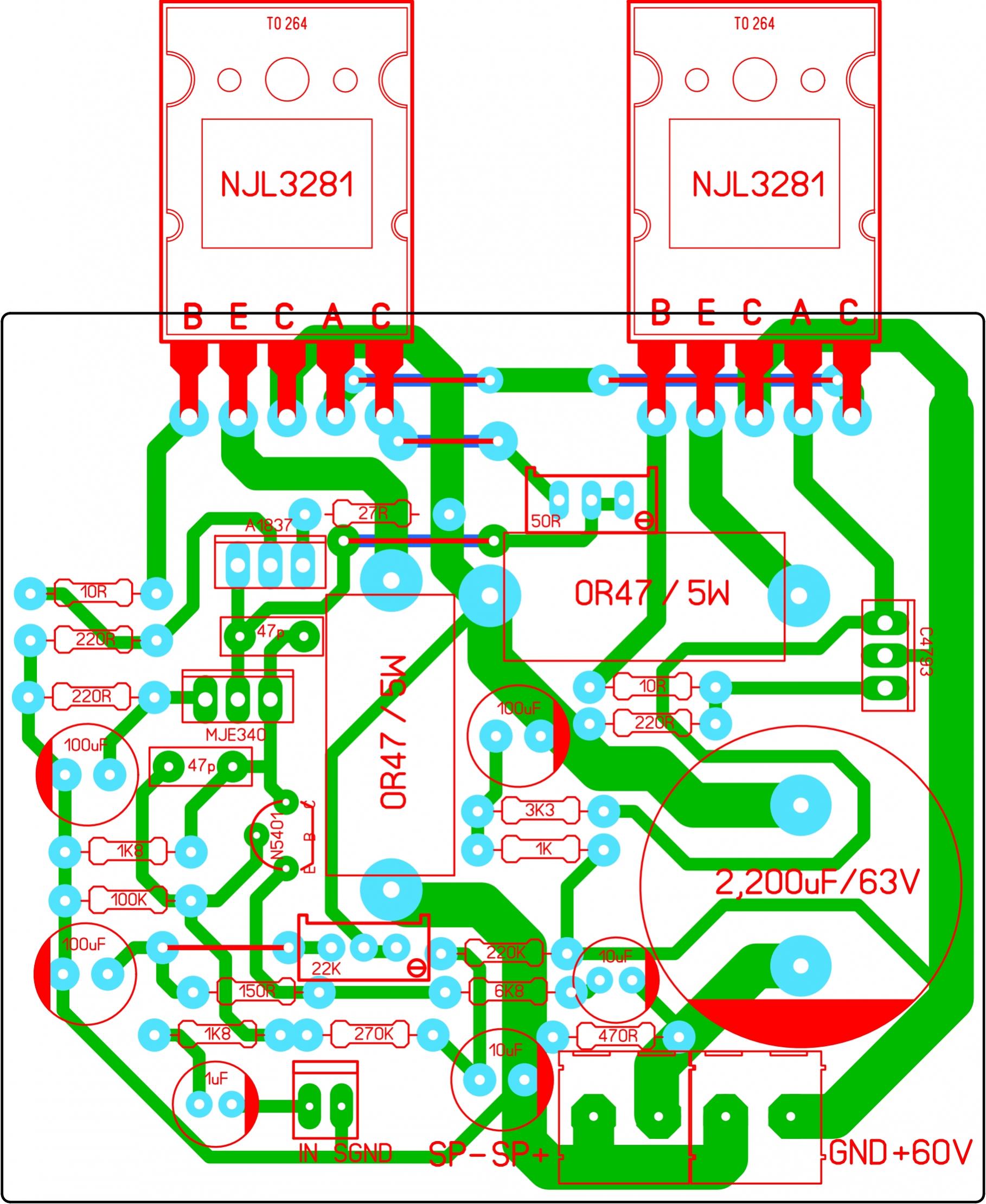

Beycoast asked for the layout for the Thermaltrak version so here it is.

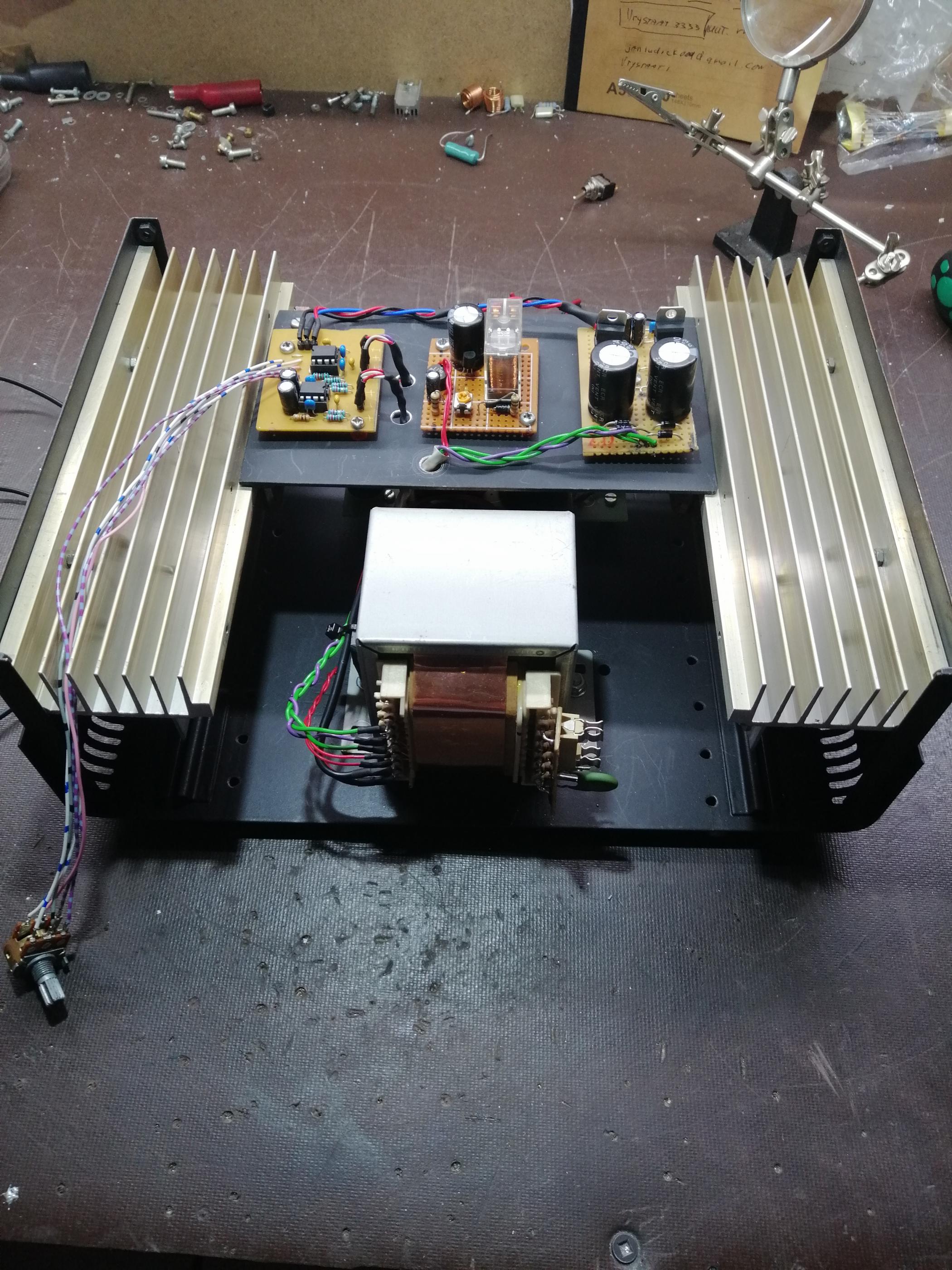

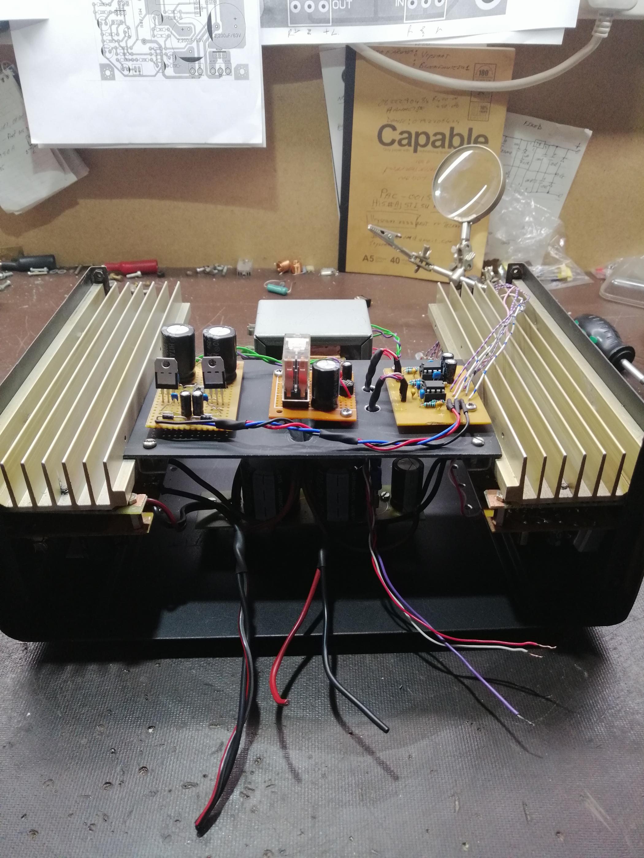

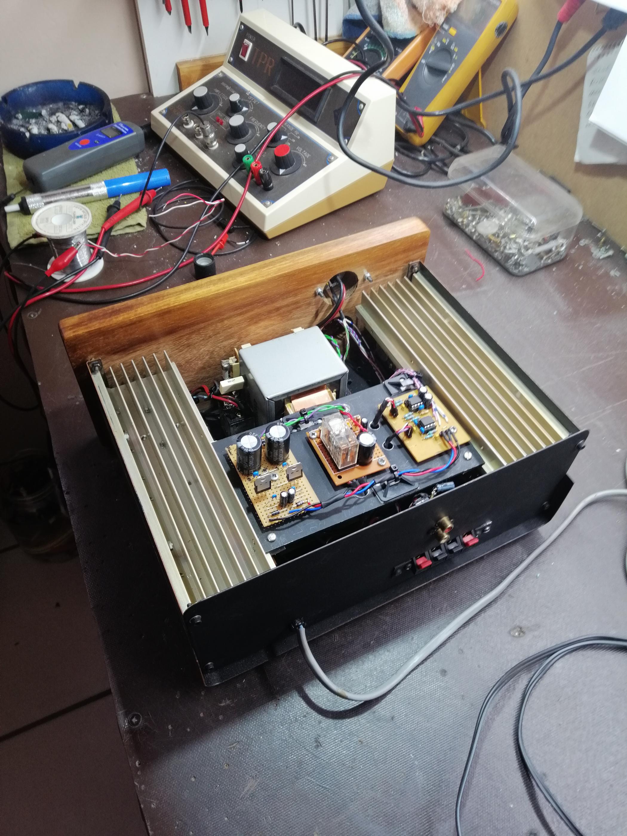

Jean-Paul, I have already build it and it is mounted already, the power amp that it is driving has a cap on the input, so no worries about DC trouble. If it does give hassles then I will make another plan !. Almost finished.:)

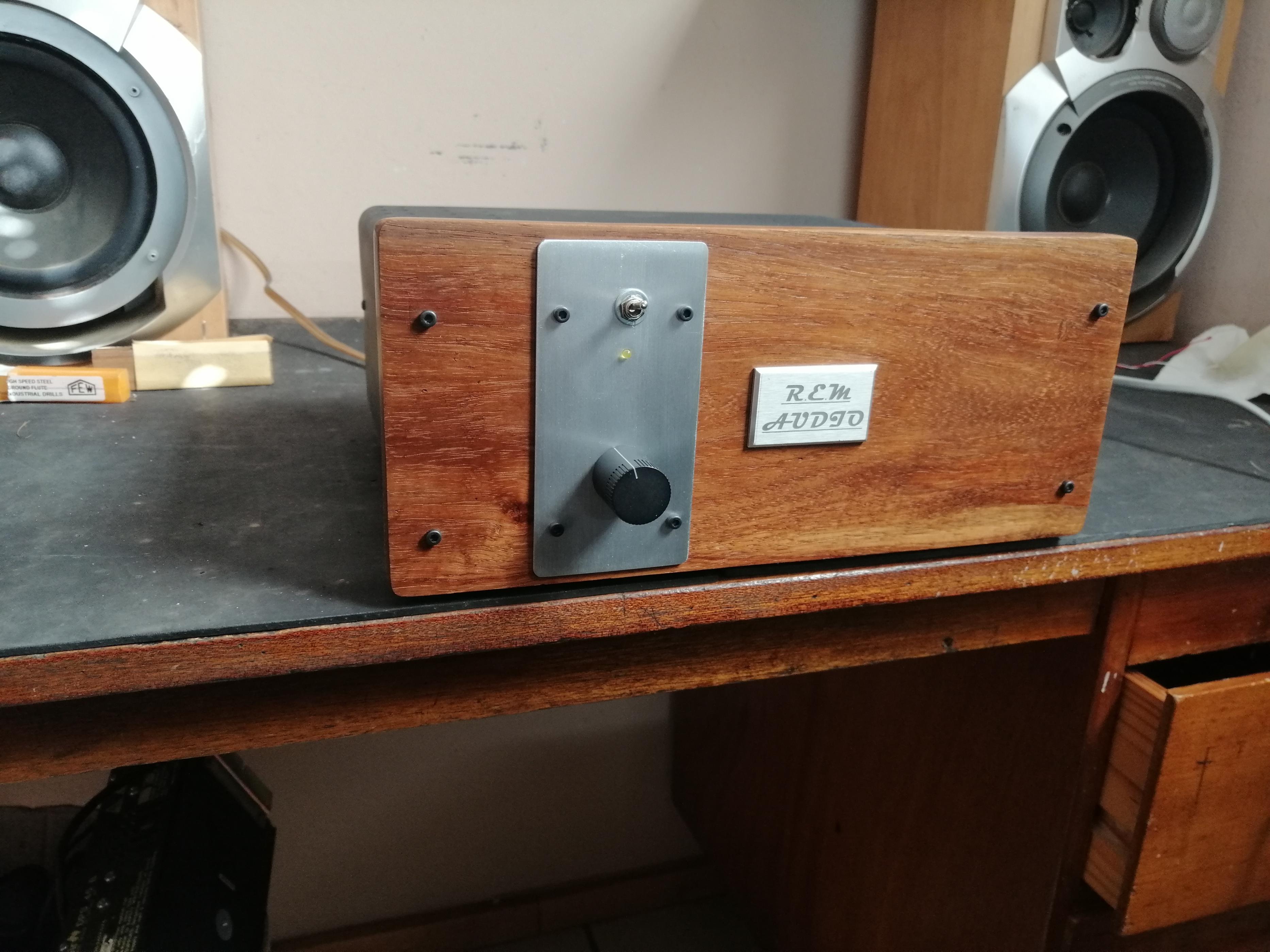

Thank you Sir, I had to use veroboard, my first time:eek:, the toner on my printer was finished and during lockdown a new cartridge was not available.I have build it for a friend for his braai place, you know what happens around a braai, people gets deaf and then the volume is increased.:DLets hope it smokes the pipe !:)
( braai- like barbecue, just much better )

Here are the gerbers for the apex ax-6 single supply amp. yes, i designed it for to-247/264 type output devices. I think i have spare pcbs but no shipping in sight...
the above quoted post gives the schema , pcb, stuffing and bom.

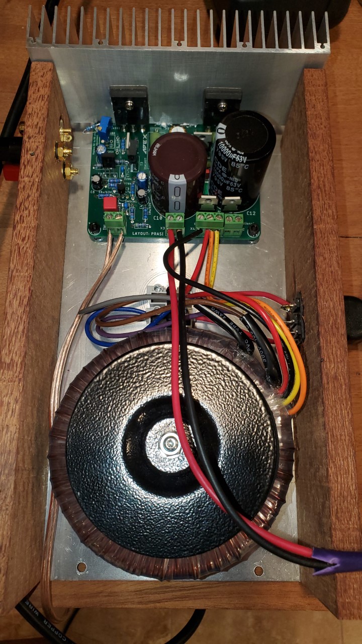

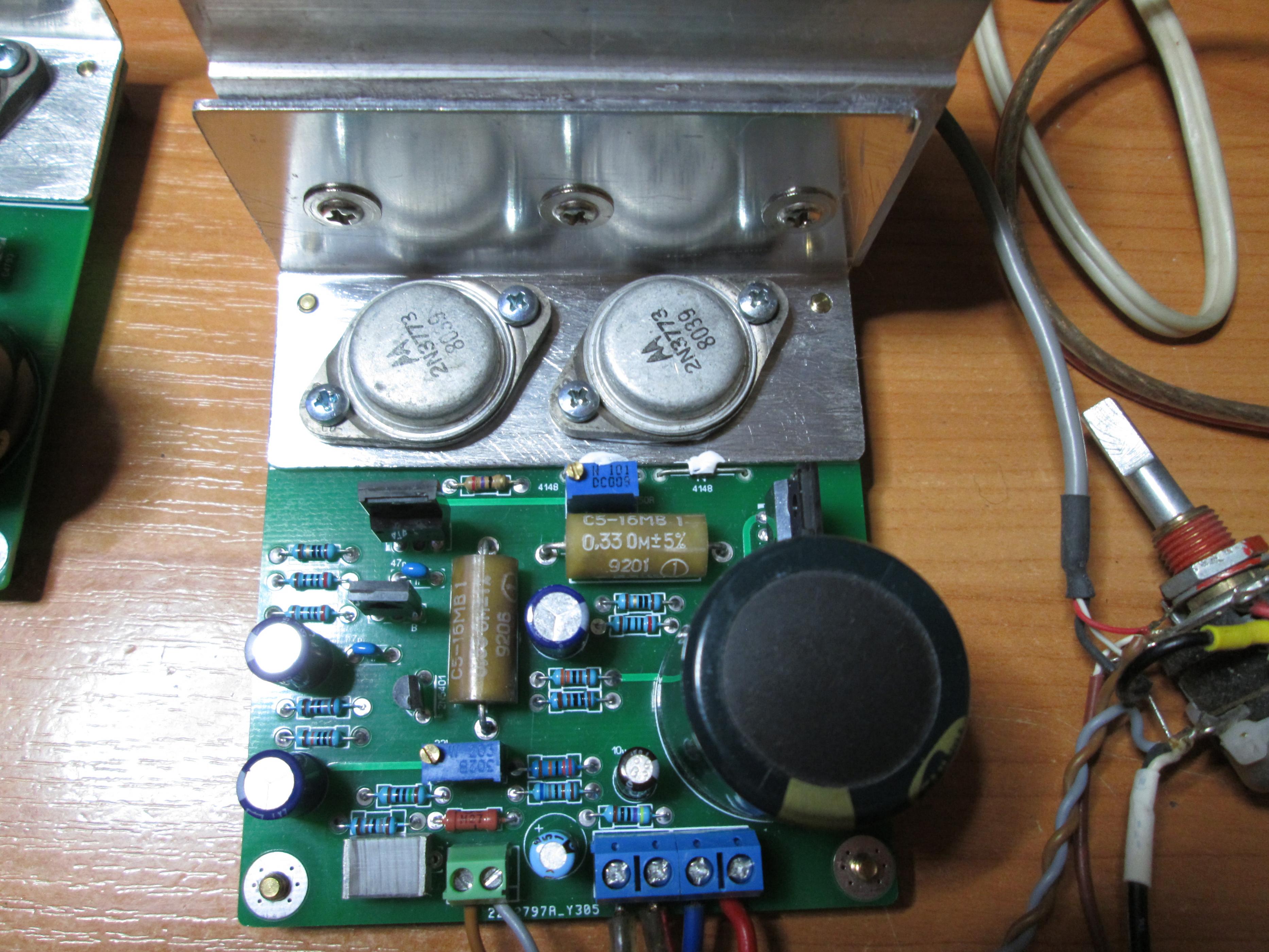

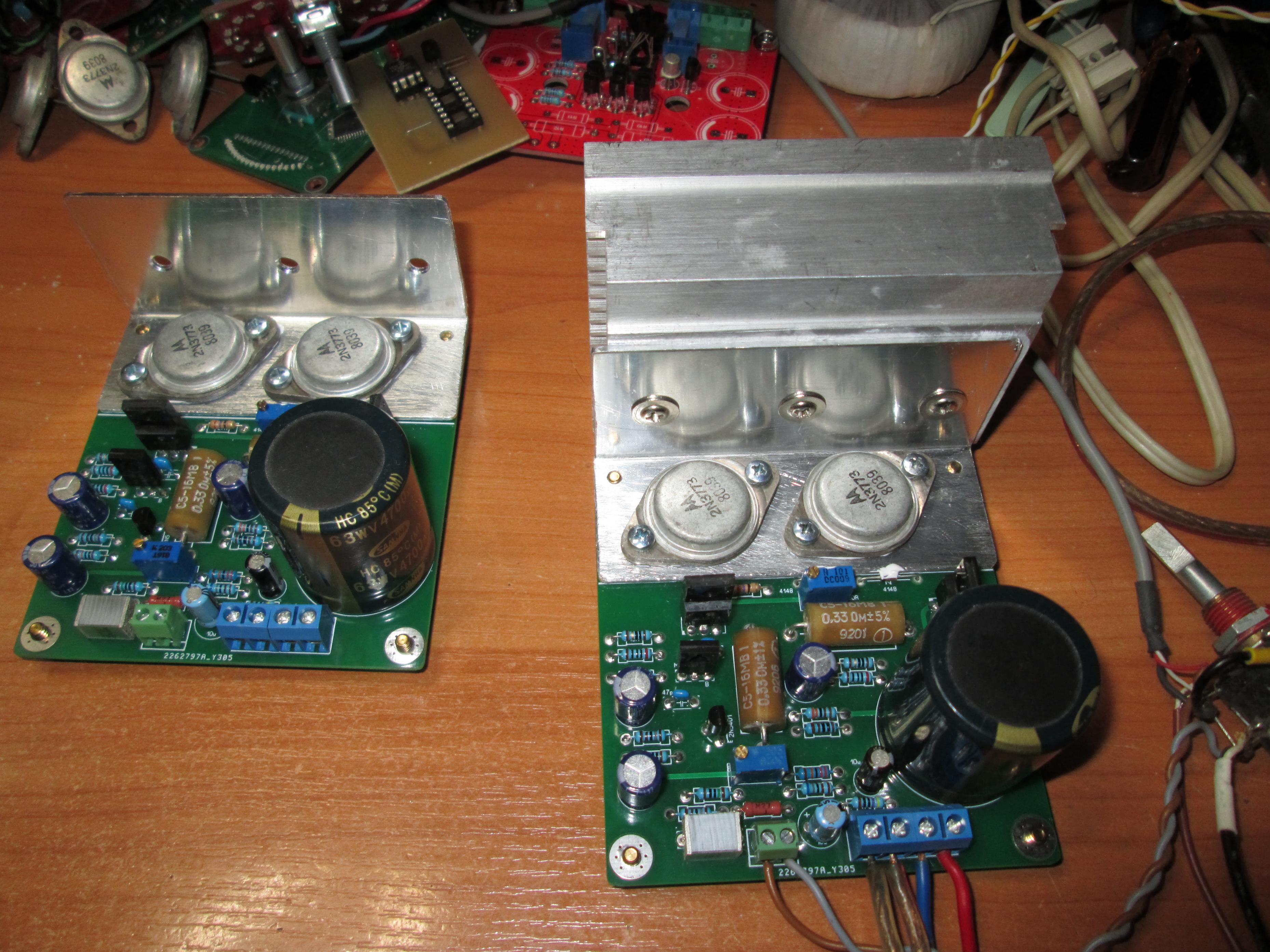

I have one Retro Amp running. Dead quiet and sounds really good in mono. Stereo next and more checks with the scope and play with bias.
Planning a Retro 50 integrated build with a case from the diy store. A 330x230 Dissipante 2u looks about right. Bigger heat sinks this time!

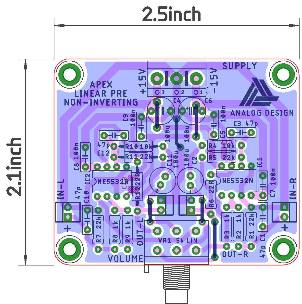

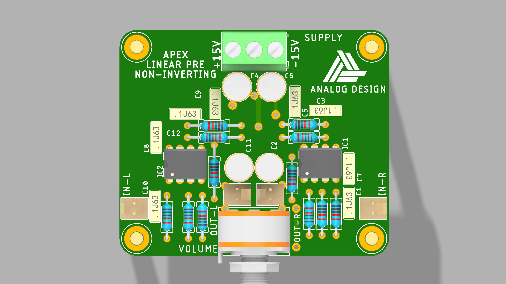

  • gerbers-APEX LINEAR PRE_2021-02-04.zip
