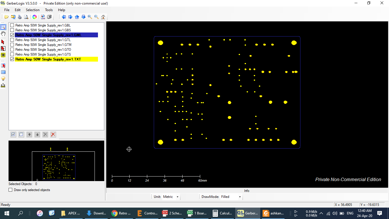

Dear friend prasi, please, Gerber Viewer say drill size null (there is no hole), can not identify the board outline...
Thanks your precious work!
Hello Ades,
there is drill file also (yellow) and outline file (blue) also. Please change your gerber viewer to something like gerberlogix (see screenshot, I use it always and never problem with any board house).

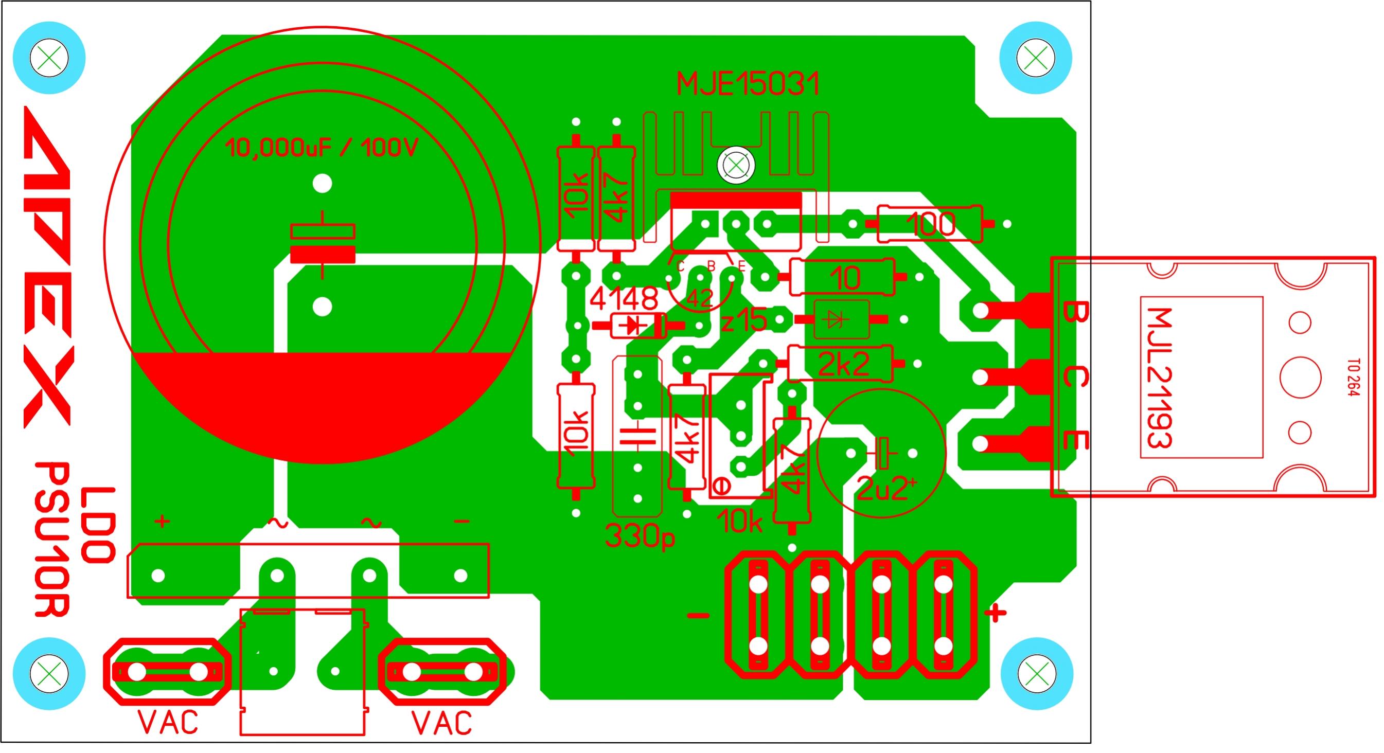

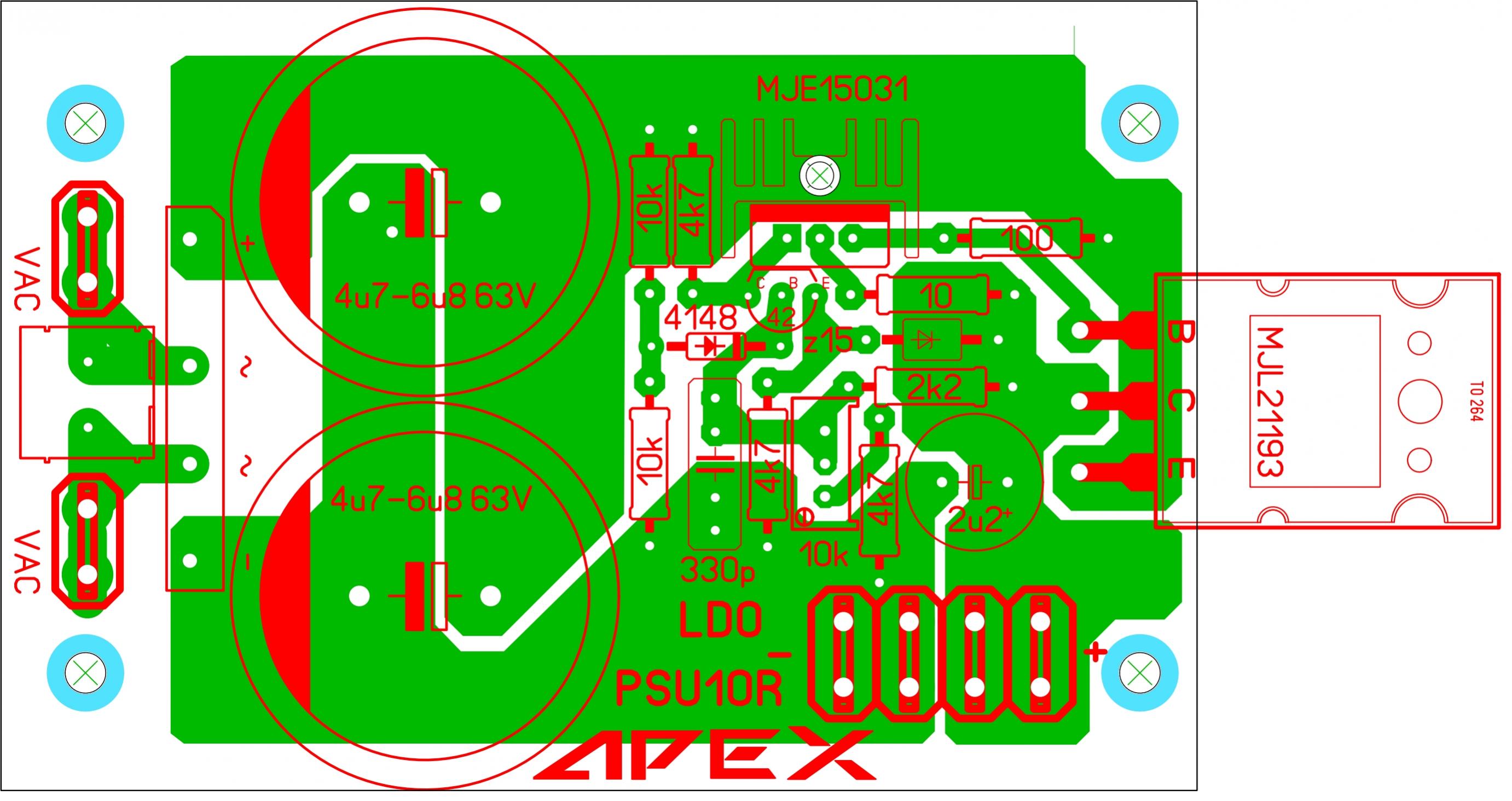

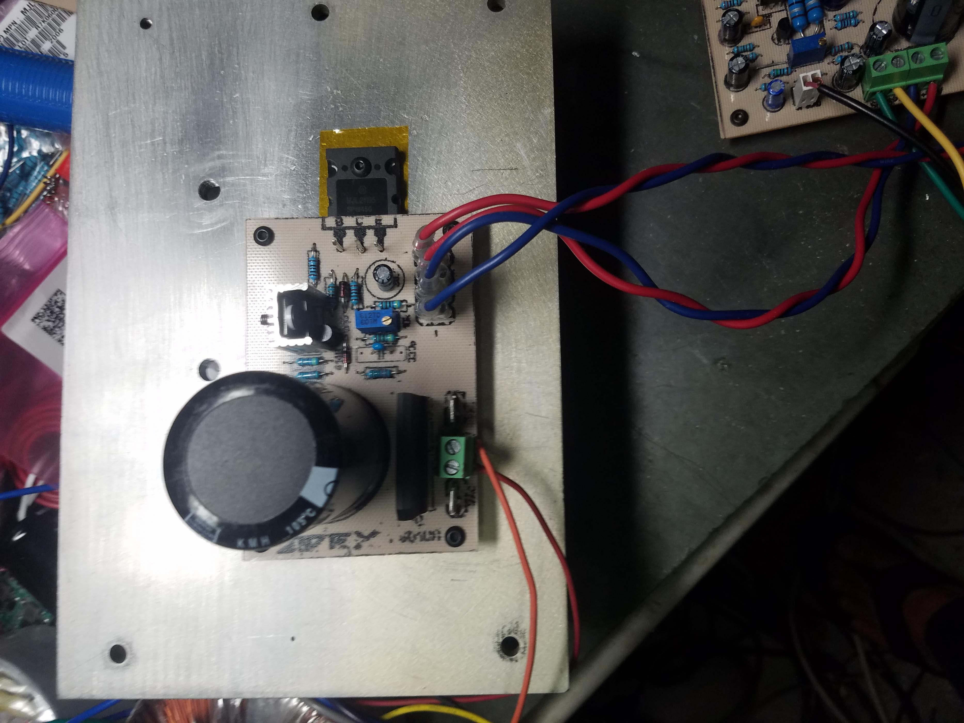

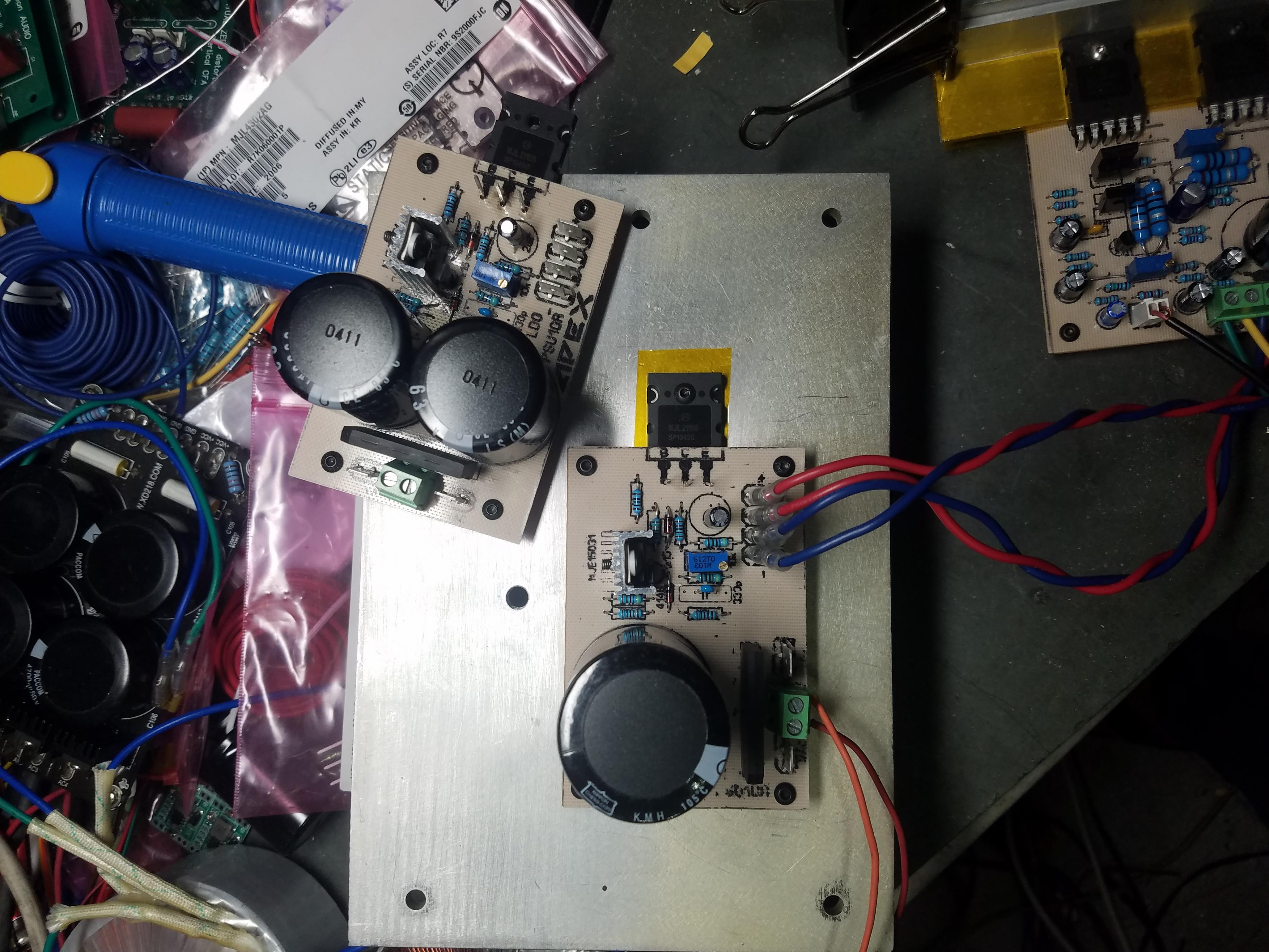

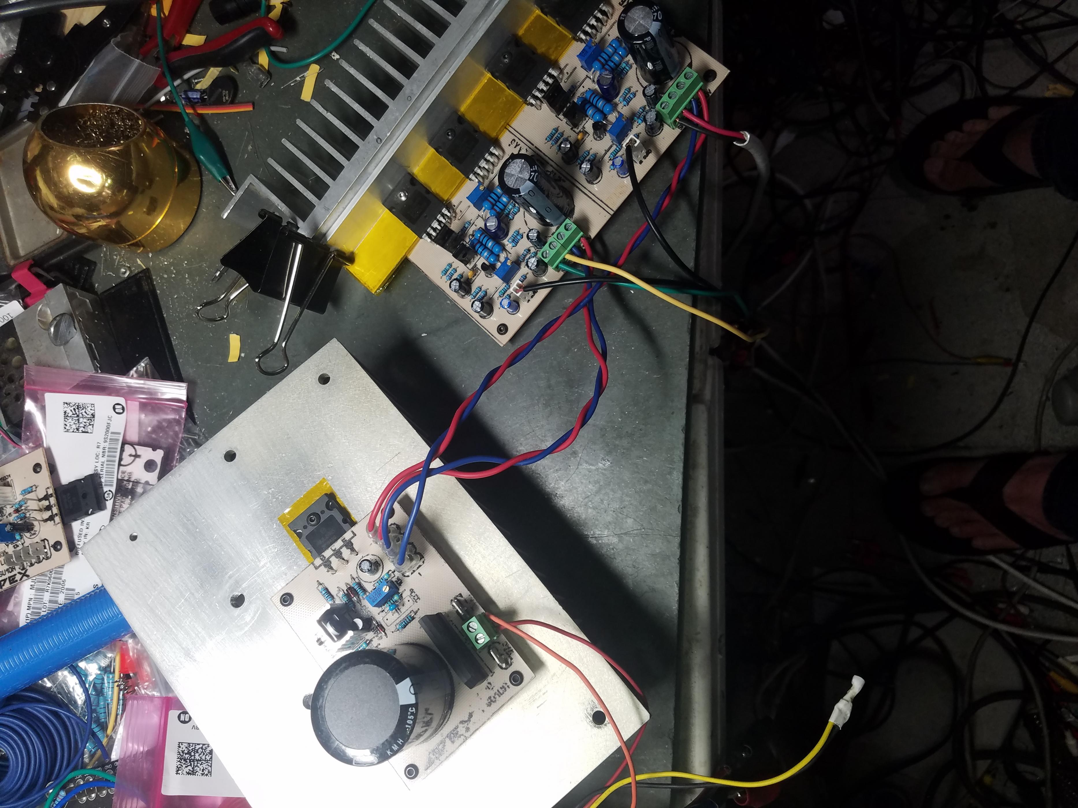

Hi Guys,
I etched and built a couple of PSU\10R supplies. First I built the one that Prasi designed on post 671 Retro Amp 50W Single Supply with a slight redraw to accommodate the caps I had on hand and include a bridge rectifier. I tried it out but the transformer I wanted to use is a 30-0-30ACV which rectifies to 83VDC which of course popped one of my filter caps. So I had to use my 21-0-21VAC transformer. With this transformer the PSU10 will only output +55VDC which plays the AX6 fine but I wanted more. 😉
So I redrew the layout to accommodate a 36mm Cap so I could use a 10,000uF / 100V cap I have. This one handles the higher voltage just fine and I am able to reduce the output of the PSU10R down to the +63V I wanted. I used a MJL21195 output transistor for both PSUs.
nice Terry, so any improvement in sound? please post when you have had a chance to listen.
if you happen to measure ripple before regulator -after, that would be a nice bench mark.
if this psu is indeed suitable for class AB amps, it will be popular i guess.
