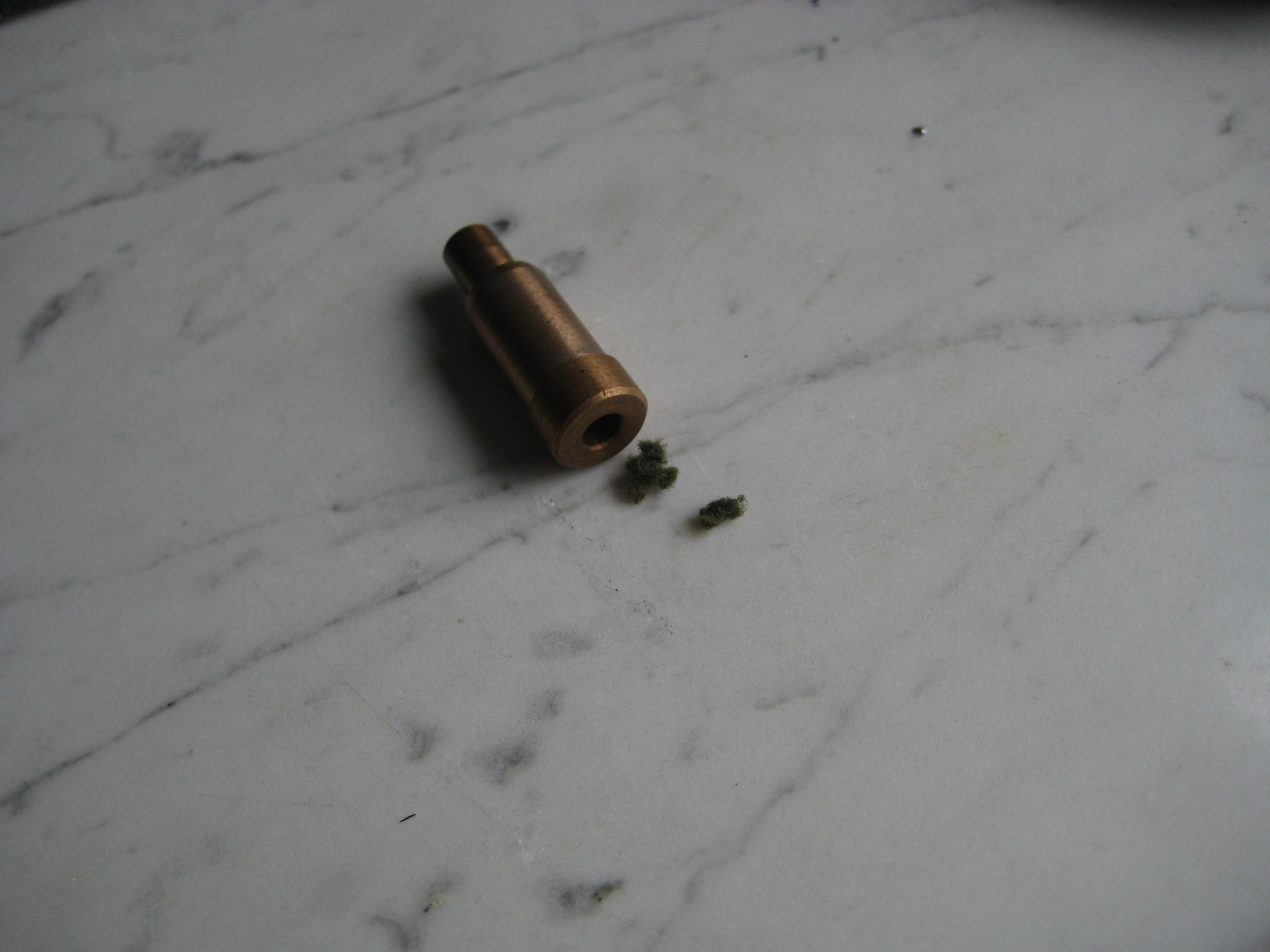

I just cleaned out my step pulley bushing, and noticed a lot of fibres stuck inside the bushing. Eventually I managed to pull out a small piece of green cloth! Someone at some stage tried to clean the bushing and this piece of cloth got stuck!

That explains the noise you've been experiencing. And I had expected something along those lines.
With the "healthy step pulleys I've experienced the noise I've observed from the step pulley is more of a soft whirring when I have the un-assisted ear next to the operating TD124.
If it were over here, the first thing I'd do with this particular step idler pulley is to do what you've been doing; clean it of all loose and all stuck-on debris. Perhaps a soak in some grease dissolving solvent. Like lacquer thinner.
2nd thing: and having made certain that there is no more contaminating materials within that bearing, I would make a close visual examination of the upright shaft that the step pulley spins on. and I'd mic it to determine that the diameter in the unworn areas are the same as those areas of the shaft that takes the sleeve bushing. the materials are high quality.
3rd thing: step pulley bushing. The thing to do before any polishing, or the use of any type of abrasives inside the bushing is to measure it for wear. As with the shaft, the worn areas should not show a significant increase in size compared to the areas of the bushing ID that do not run against the shaft. A bore gage is needed for the bushing ID.
Always realize that when you polish a bearing surface you are removing material from that surface you polish. If you do this without first measuring the surface to be polished, you do so blindly. Without adequate knowledge. There is no putting material back in
No polishing of the step pulley bushing ID. If no gages there is a way to check the operating clearance between shaft and bushing Id. For the mechanic who doesn't own the gages. A clean dry assembly followed by a check for play at the interface between bushing Id and the shaft it runs on. Once fully assembled complete with thrust ball at the top.
But minus the grease.
Then pushing downward on the rim of the large diameter that engages the drive belt. If you can feel no evidence of play, that is good. If you can, that's not so good.
Next step is to remove the step pulley from the shaft, add lube to the interior of the bushing and to the thrust ball. Then check it for free spin. Does it seem to spin freely or is there something creating friction? never mind that the eddy brake, even when adjusted for least effect, will prevent the step pulley from long spin-down times.
-Steve

There is felt inside as oil reservoir , if you clean the inside it is often broken !
Right.
I just took the step pulley off of sn 7388. It has a groove in the bushing ID. About midway up. And with just the right light I can see a felt ring within that groove. It looks intact. Best to let sleeping dogs sleep. To remove it would destroy it.
I had forgotten about this. But now I recall seeing this before. With #2729 I chose to leave the felt ring in the groove because I had no way install another. Nor was there a known source of replacement felt rings for this part.

Well, I got an original piece of felt for sale!
Attached photos of it. It looks to be in good shape, Although I am not sure I want to put it back, since I do not know how it was put there in the first Place.

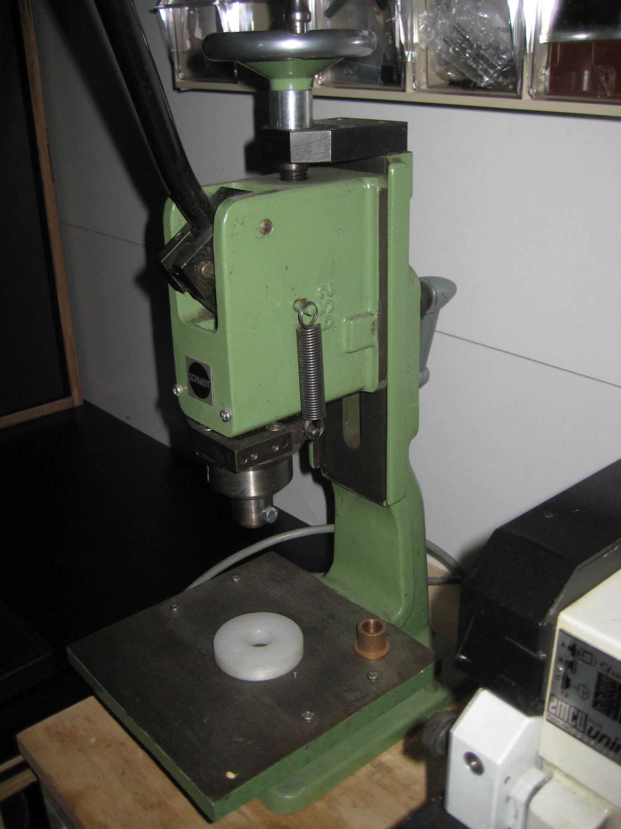

I have cleaned the pulley bushing and also tried to flush the bushing with hot oil, but I do not think it worked out too well. I did not want to sink the whole pulley in hot oil, because it seems to be some lacquer on the pulley surface, which I do not want to ruin.
I then dried the bushing with lint free cloth, and tested it in a dry run. I took the magnet away to make it spin freely. Very good spin in the dry run, but there was clearly some grinding /ticking noice when putting my ear next to the pulley.
I then lubricated and tested, and with oil the pulley is quiet.
I am curently not sure what to do. Should I try to put the felt pad back? or should I just leave it alone, making sure the bushing gets a regular zip of oil? or should I go for a replacement bushing?
