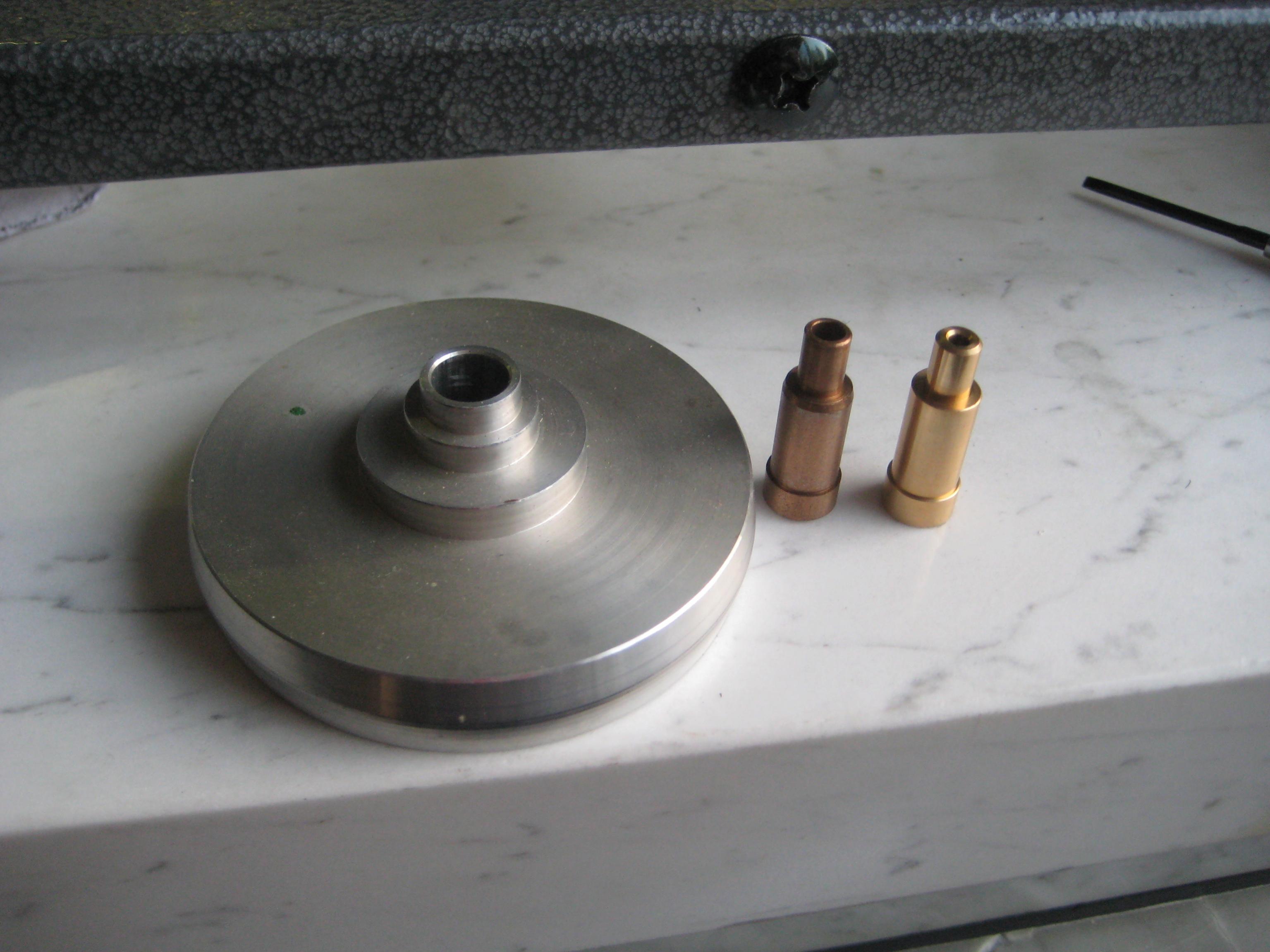

In the meantime I have checked my step pulley. I had a grinding noise comming from it. I discovered that I had some small metal flakes sitting on the magnet (probably from my screwdriver). Since I had the magnet so close to the step pulley the metal flakes touched the pulley. After cleaning the magnet, the grinding has gone away.
Also I have adjusted the magnet according to Steve's advice, I bought a new belt, but that was very tight, so I put back the old belt. The turbulence noise has clearly been reduced, altough it is still present.
I made a closer examination of my pulley shaft, and I discovered that the bearing ball has made a small dent on the top of the shaft. I will try and pollish that away.
Since the step pulley is fairly light, I was thinking perhaps the bearing ball is not the best sollution? Is it possible that the bearing ball adds chatter into the pulley? Would a thrust pad made out of delrin be a better solution?
What are your thoughts?

re: bearing ball and the "indention".
There should be a spherical shaped thrust point -- within and at the top of the stepped pulley bushing. It is there specifically to receive the bearing ball and provide a seat for the ball.
--When-- the indentation from the ball is showing at the top end of the hardened shaft. This would, I think, present evidence of abnormal wear. Perhaps lack of lube over an extended period of use. However, its presence should not, by itself, prevent the shaft from being used in the future. I'd be more concerned about indications of wear on both the bushing areas of the shaft and within the bushing itself.
-Steve
The indention is at the top end of the hardened shaft. I have no plans (yet) to pollish away the thrust point inside the bushing!
Nils
Right. And a more careful (this time) read indicated as much.
I'd think it is time to use an OD mic to measure the shaft for indications of wear. And nice small bore gage to do same with the bushing. Given the dimple at the top of the shaft, and noisy operation of the stepped pulley, Id definitely be suspicious of bushing wear on that item. That is until I had measured evidence to the contrary.
But the dimple at the top of the shaft is evidence of wear. And where there is some evidence of wear, it seems likely there will be more evidence to be found.
-Steve

The old steppulley bearing gave a lot off noise so Schopper made a new one for it . You need a another special tool to replace it no hammer this time !
