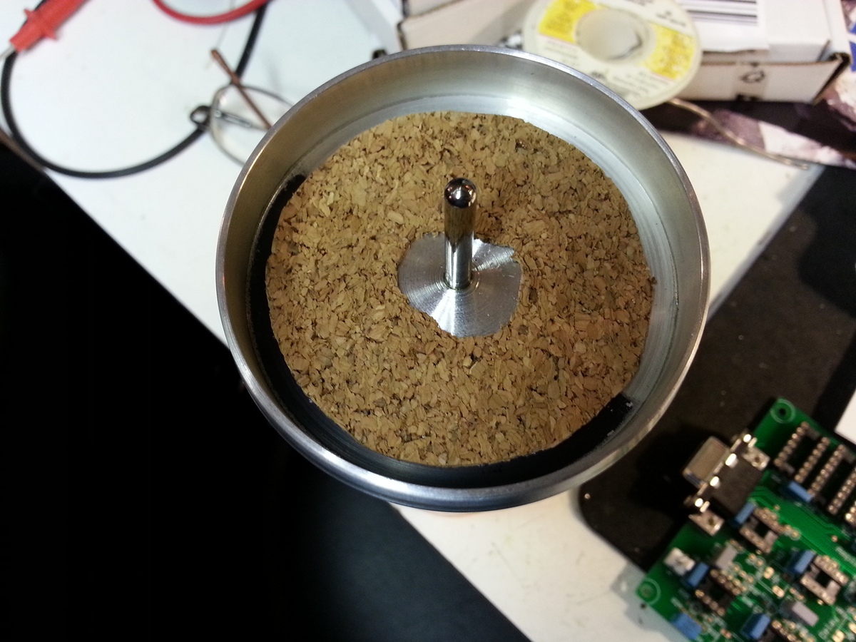

Is there anyone who has tried to dampen the stepped pulley? There could be several possiblities:
-Electrical tape on the inside of the pulley
-Damping sheet of rubber ashpalt
-Piece of mdf made to fit inside the pulley
Like to hear your thought on this!

Damping Stepped Pulley
The story is a bit complicated by the fact that I have three stepped pulleys that differ significantly in small details, but all are intended for later bearing in chassis configuration.
Like the motors I have a fairly early pulley (no holes) and mid 45K SN pulley which has holes but has the spun look on the inside - we'll call this the MKI late pulley, and finally the one in my MKII which is coated internally along one periphery and is significantly lighter than the others - we'll call this the MKII pulley.
I cut some self-adhesive cork for the MKII pulley and put it on the inside (see photo attached) and was astonished to hear that the ringing and other obnoxious noises are completely suppressed - this was sometimes the noisiest of my two tables by a small margin. (Depends on how clean things are) There is some remaining noise which is from the idler.. So this seems like a major step forward..
But remember I mentioned the MKI pulley, did the same treatment if very slightly smaller cork disk. I had trouble getting it to adhere to the spun finish on the inside of this pulley - it may yet fall off. Strangely enough this one did not quiet down with the addition of the cork, however the complex tones emanating from it now sound more like a slow running two pole motor without the masking high frequency content previously present.
Something to mention is I made the piece big enough on the first one to completely block the two holes, the second one is slightly smaller and only covers half the hole. I will revisit this Sunday hopefully.
No measurements unfortunately, perhaps Volken can replicate this.. Note that this does not seem necessarily universal in application.. I have not decided yet whether the MKI is actually quieter in operation or not - the character of the noise has changed. I also polished the pulleys on this table after the initial quick listen to the drive train noise.
The MKII is much quieter and is no longer audible from a few feet away. It also seems to take a bit longer to get up to speed initially, but achieves overall speed stability much more quickly. This also seems to be the case with the MKI, and it also locks on speed more quickly. It could just be that my room is slightly warmer now that spring is visiting the area sporadically.
I think I am going to try again on the second table, it now sounds a little bit like a tiny washing machine on spin cycle, oddly enough however this table in terms of listening is substantially better than it was.. The other one was already rather further up the food chain, but even there the highs seemed a bit more open. Ah, I hate subjective crap, but there might be something to damping these damned stepped pulleys.. Anyway something for all of us to experiment with.. 😀
I cut a slightly larger cork circle for the older pulley as it appears that the holes are further out towards the edge on the older one. No difference, it is still making an odd noise it doesn't without the cork, however what is coming out of the cartridge terminals still seems like an improvement.
No doubt about it actually on the MKI, the improvement is pretty clear mini washing machine or not, the MKII is much subtler as it has always been the rather better performing of the two tables.
