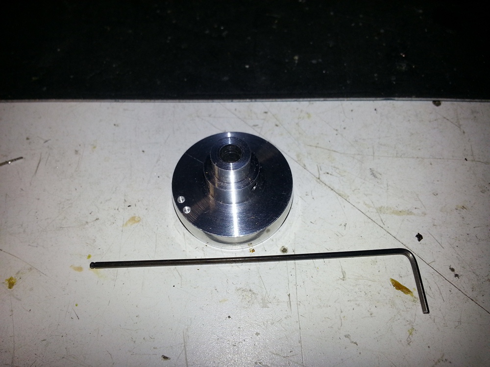

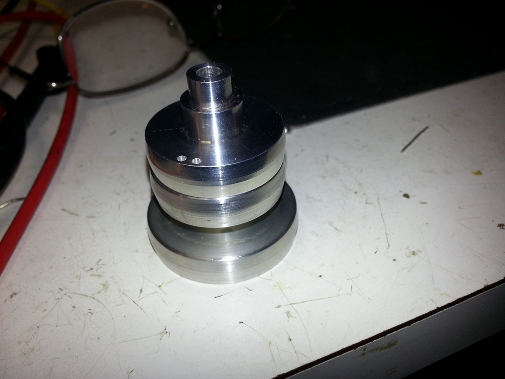

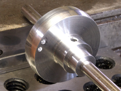

Turns out I did think of a way to balance the reduced speed pulley.

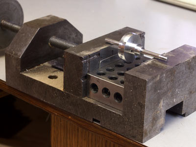

I polished the mandrel I used to turn the pulley a bit and rolled it on the edges of two razor blades. Since the setup still isn't what you would call precision I averaged many readings using different angles on the mandrel and places on the blades. I drilled holes in the pulley till the pulley rolls seemed random.
Note the mark scored through the set screw hole. The Thorens pulley has the unusual feature of having opposing set screws. Items such as this usually have only one set screw or the set at 90 degrees. I suspect they used opposing screws to maintain balance so I followed suit. However, this arrangement raises the possibility of the pulley settling on the motor differently depending on which screw is tightened first. I scored one set screw hole and throughout the build and testing tightened this one first. This practice should be followed when installing the pulley on the motor shaft.

Bare, I'm intrigued by your suggestion but having trouble understanding. I'm thinking one end of the mandrel would be stuck to the magnet and the other supported by the magnetic field. Wouldn't the ends of the mandrel have to be precision pointed? (and not be made out of stainless steel like this one.) Don't store bought mandrels have cupped ends for mounting between centers?

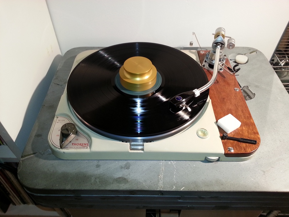

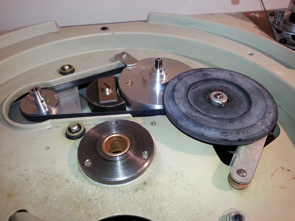

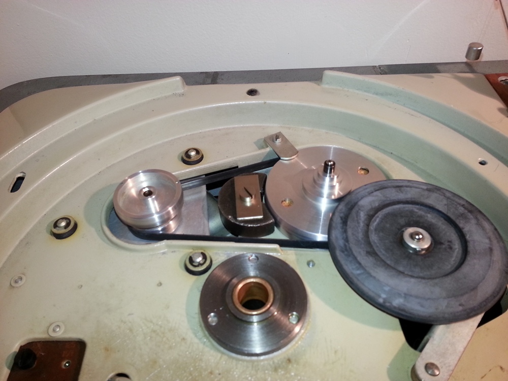

It arrived tonight, and of course being the very patient and deliberate soul I am; I only slightly rushed to install and try it. Why I even took pictures. :p
The verdict: It works, and shows no signs of imbalance or other problems. I was able to double the distance from the stepped pulley to brake magnet. Definitely a bit quieter. It might be subjectively better than the stock pulley too since the motor is not working so hard against the brake. I certainly hear nothing untoward, if anything perhaps an overall improvement in coherence. Speed stability is fine, and warm up performance on my MKI is similar or perhaps no different at all.
Very nice! I hope you will consider making more - I'd be up for another frankly.
I've just added a picture of my test mule playing one of my recent scores.. This 124 came to me in pieces (cannibalized to upgrade a TD-121 to a 124) and was purchased by a friend for the paltry sum of $10 at an MIT ham radio flea market, unfortunately that is where cheap ended - all of the pieces to fix it so far have added up to more than I paid for my mint 124/II.

Thanks for the compliments. I think the lack of the 50 Hz pulley is a plus. I saw the way Thorens had hollowed out both pulleys and figured they were trying to reduce mass. On one hand a massive pulley could provide a flywheel effect that would smooth out motor cogging irregularities but running at such a high RPM a slight imbalance could cause vibration.

I found the single pulley very easy to set up and I could not honestly tell any difference in noise and vibration between your custom pulley and the original. It runs just as quietly and is frankly much easier to set up so the belt runs properly on the crown.
Overall the table seemed a bit happier (yeah I know it is an inanimate object :p ) and in terms of all the attributes one associates with a TD-124 like drive, dynamics, etc were all at least the equal of the other pulley set up, and given this is a MKI with the stock motor suspension the reduced load on the motor may have slightly reduced vibration in the drive train - it seemed slightly smoother..
If you are making more I'd recommend sending one to Volken as he'd be able to measure any resulting change in noise floor due to the reduced eddy current brake load. I suspect based on what I heard last night that it may be significant.
