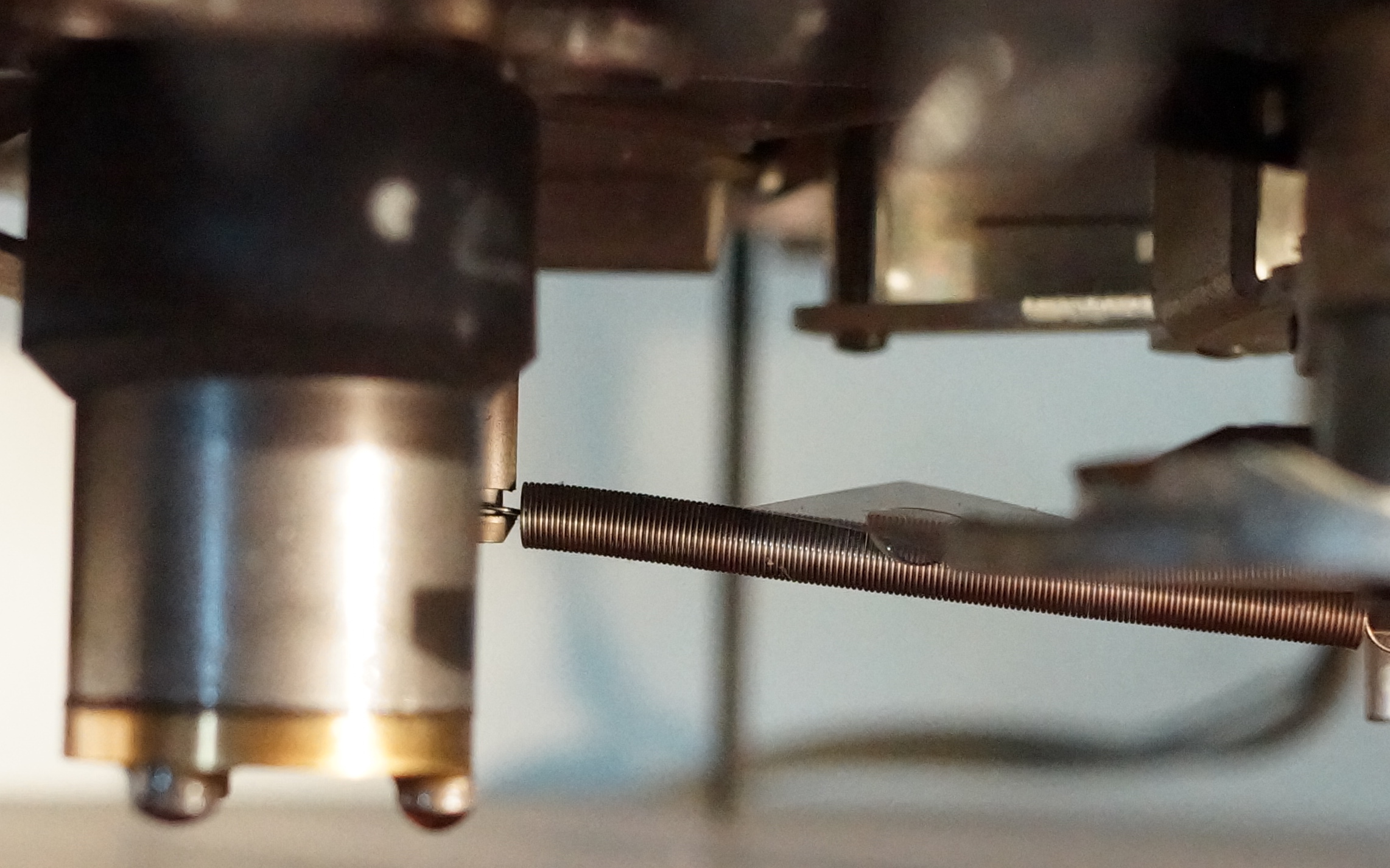

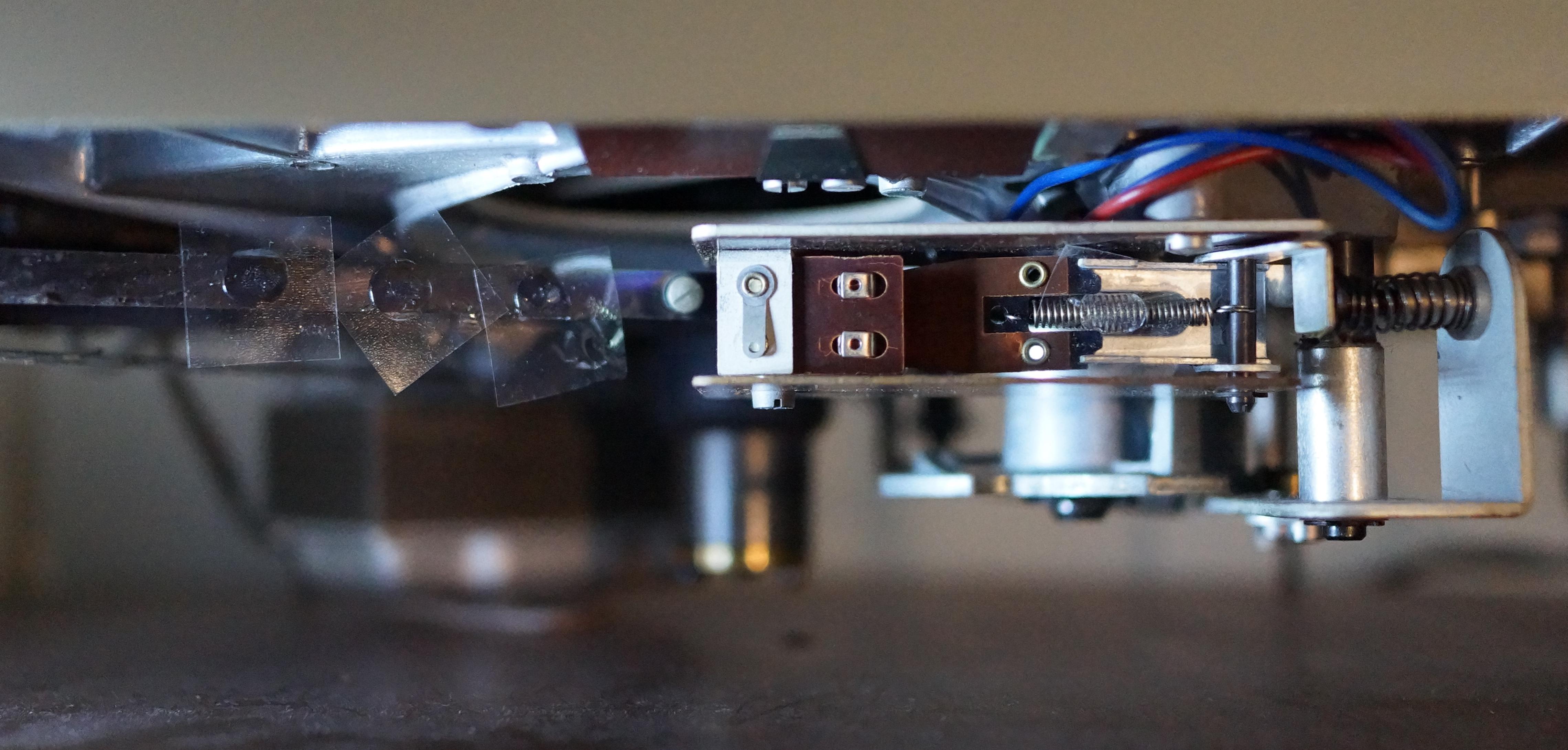

Hello,
It's been 8 months since my last TD124 tune up. I usually check the oil, clean the belt and rub in new talc, clean the step pulley, platter inner rim, and clean the idler wheel (idler wheel made by Simone L with red O ring).
Since I had the TT apart, I decided to try Kevin's idea for dampening the step pulley wheel I used a double layer of 1/8 inch neoprene foam sheets glued in using 3M mounting spray adhesive. The pully is now silent when struck.
I used a stethoscope to check out if any abnormal noises were present. The table sounded great, just a soft whirling sound of the motor. I lightly tapped the top plate and heard a chorus of noises. It sounded like vibrating springs and metal like the reverb sound made using an echoplex. I gently tapped the various springs and parts to locate the noise makers. I decided to dampen the long switch lever spring and the switch actuating spring. I also dampened the steel ribbon. I used some Scotch adhesive dots as you can see in the pictures. Now when I tap the top plate, there is a lot less noise.
Upon first auditioning of the reworked table, I was amazed. The bass was now much tighter and less bloated. The voices were clean and clear. I listened to Blue Train again and Chamber's bass came alive. Try it and let me know what you guys think.

Good thoughts - I will give it a go. I have a Garrard 401 and all of the springs came damped from the factory which started me to thinking that this might be worth doing on my two TD-124..
Do you have a part or item # for the 3M dots you used - are they bumpers/feet?
Originally, I wanted to take the springs off and put in foam strips, but that involved more work than I was willing to do. I took the short cut and used what I had on hand which was Scotch permanent adhesive dots 8mm. They're very thin used for mounting photos and poster boards. They're very pliable and hopefully removeable. They're double sided and very sticky. I think there are products out there that are removeable and not as sticky.
Thought I would try some blu tack as I have it on hand, discovered it will not stick to the band in my MKI.. lol So I will pick up some of those adhesive dots sometime soon.

Have you ever tried to put any soft absorbing o rings in between each of the 3 armboard screws? They might isolate the armboard from the chassis and reduce chassis vibrations to the arm and cartridge .

I would not recommend isolating the arm board from the chassis based on experience with the rubber grommets on the bed plates of SME 3009 and 3012 Series II where removing them resulted in greatly improved bass quality.
They are oilite bearings, and should be immersed in hot oil and then allowed to cool completely before installation.

Yes I agree regarding rubber grommets as I had an SME 3009 and had removed them. It sounded much better without them..I should remember that experience and do not think that isolating the armboard could be an experiment that could give some good results..
