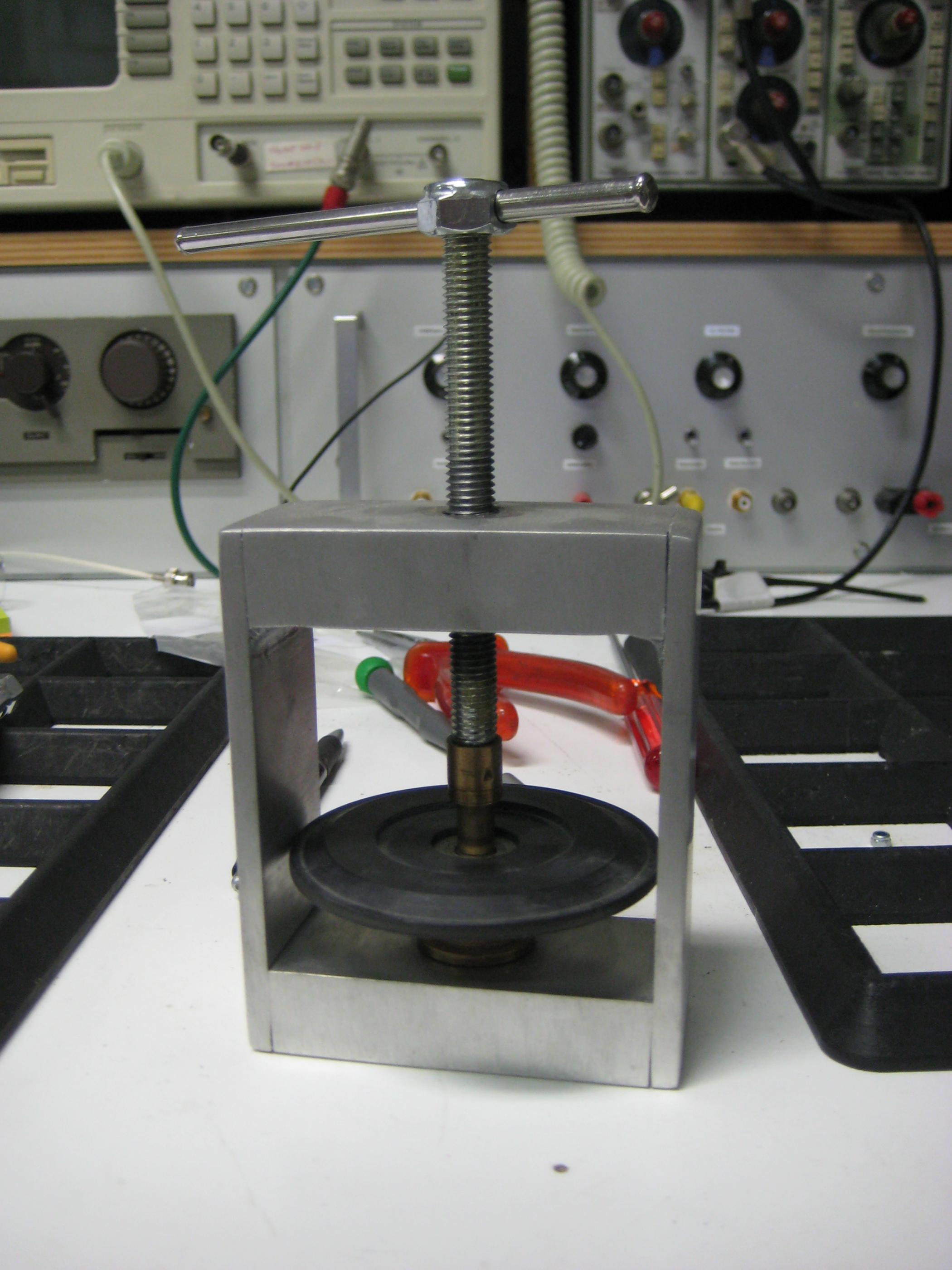

Hello everyone,
has anyone tried to change the bearing of the idler wheel? I've found an Ebay seller from Spain, who sells a replacement bearing with a very cheap price. It would very useful for me to reduce the noise, coming out from the wheel. How should the bearing be changed? Do I need a special tool or what?
Cheers
Maurizio
Cheers
Maurizio
Hi Maurizio,
You'll need to make a little tool to press out the old bushing. This at its simplest would consist of a short piece of rod with an outer diameter just a bit less than that of the bushing, and a piece of pipe somewhat more than twice as deep as the bushing, and a simple vice.
