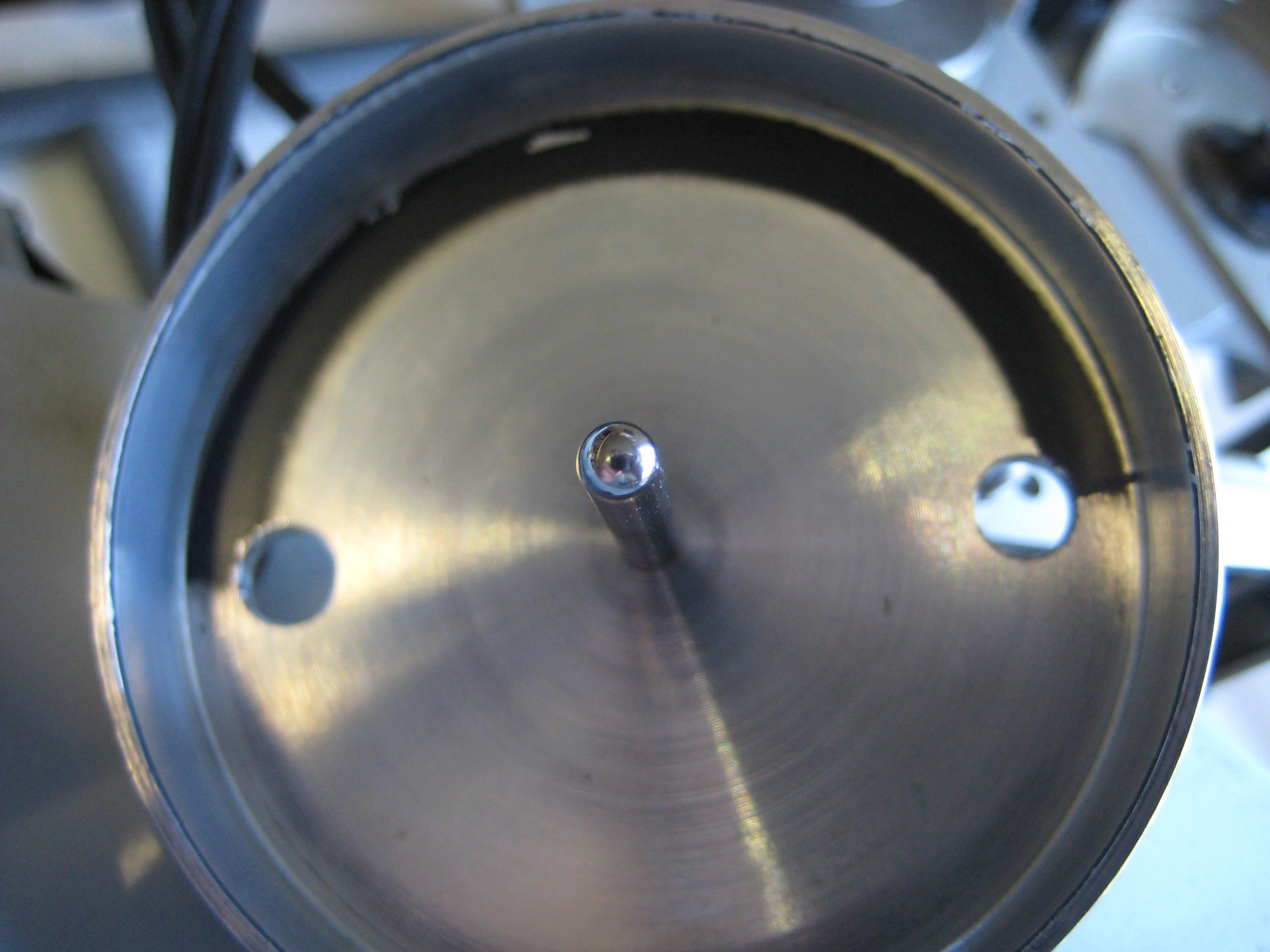

Concerning the steppulley please check the shaft mostly there is a small dimple on the bottom from the shaft see picture.
You can polish that and place a new pivot in the bearing or use the other side.
The steppulley can produce some noise by bearing wear , polishing helps and fresh oil.
For the idlerwheel you can use a teflon washer .

Volken - What is your procedure for polishing the bottom of the steppulley shaft? What products do you use?
Polishing in the lathe or drill with polish pasta !
Eating polish pasta while operating a lathe seems a little dangerous. Greasy fingers can slip! Joking aside, I'm looking at various grits of diamond powder polishes used in lapidary work, so I'm trying to determine what is the finest grit I can use to polish the steppulley spindle, motor spindle and platter spindle.

I am actually using a polish for removing the scratches from a car's body, therefore it's a polish that isn't so aggressive. I have obtained very good results, both polishing the spindle than the step pulley. The product brand is Arexons, here the link http://www.arexons.com/arexons/cms/en/car_care/exterior_treatement/7174_SCRATCH_REMOVER.html. I know that some people use polish for chrome parts too. After polishing, I clean every surface with a solvent for metals.

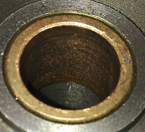

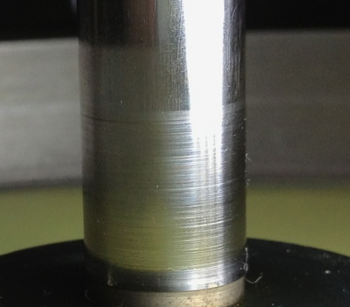

To give some idea of the condition of the TD 124 II I will be working on, I'm attaching some images of the platter spindle. As you can see, wear on the top of the spindle is much greater than the bottom. On the bottom it seems confined to a few light score lines. I'm also attaching an image of the platter spindle upper bushing. This image has been sharpened to bring out some of the detail.

Hi, my starting point was similar to yours; I had to polish the spindle about 3-4 time but, at the end, looking the spindle at the sun (yes, german sun so maybe not very effective!), it was clear of any trace of wear.
I'm still educating myself before rebuilding the turntable, but I have replacement bushings for the platter spindle and several other parts. For each of the spindles I intend to polish, my current plan (it might change) is to find a way to attach the spindle to a lathe and polish as it rotates. This should give me more control and help keep the polishing even.

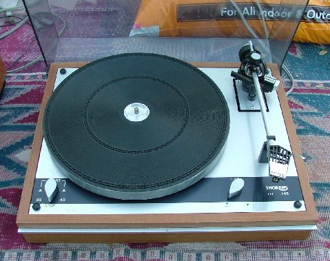

Meanwhile Thorens turntables are about to pile up here. The same friend who gave me the TD 124 II blew a whole $10 US and picked up a TD 125 II A/B and a TD 145, both complete with the stock tonearm and dustcover. At the moment the 125 does not power up. The 145 powers up, but turns very slowly. Still for $10 . . . Attached are shots of the 125 and 145 I just got from him this morning

For the idler wheel, I will try using the method that Kevin suggested us. For the step pulley it's a little bit harder, I have thought about a little extractor, which I hope will do its job! I need only to buy some components.
It's really a great deal, I hope one day to find a TD 125 too!

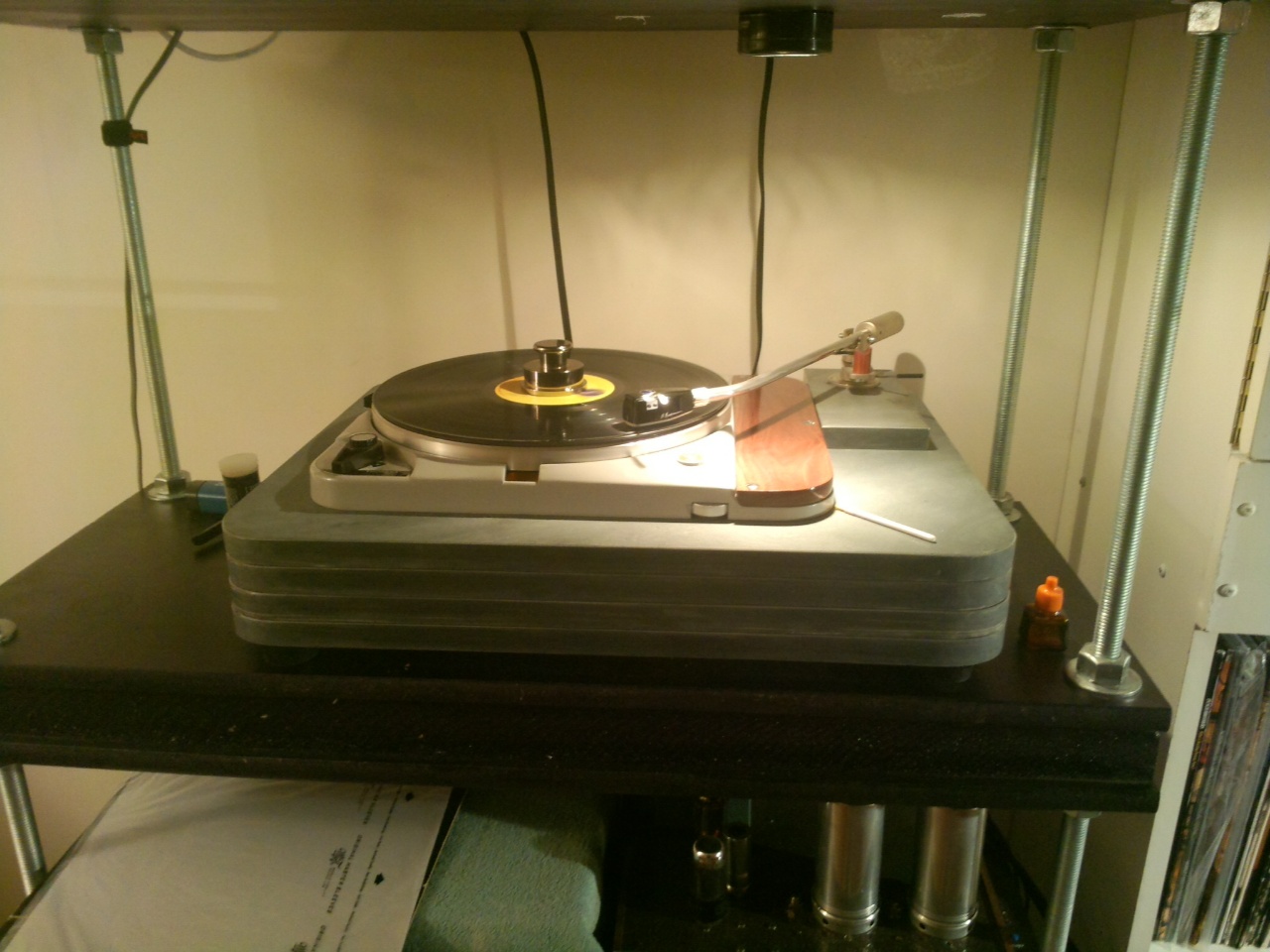

My TD-124/II has been finally installed in an uncracked plinth, the 124/I is now installed in the old cracked slate plinth..
kevinkr - is the new plinth a purchase or among other talents, are you a stone cutter now too?
