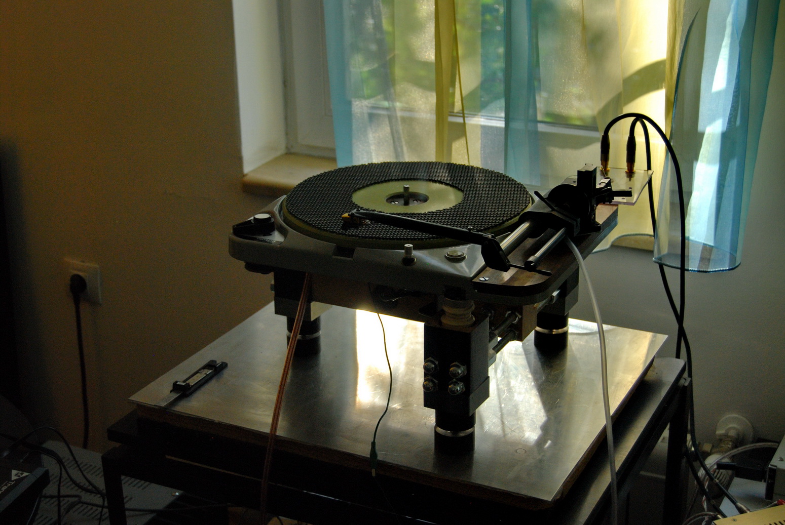

This is an interesting approach and one, I think, that could serve to illustrate something I am coming around to think.
First, an observation about the tinkering I've done on my own:
The quieter the motor runs. The quieter and smoother the belt/stepped pulley/idler wheel runs. The less one is tempted to categorize this model in the same league with other idlers known to produce obvious rumble.
Why? Because at a certain level of performance, it becomes apparent that this model does not produce any obvious rumble. At least not rumble that can be heard through the speakers on a needle drop into the lead-in groove.
Once the TD124 is operating to this level of performance, plinth selection becomes less of an issue. High mass. Medium mass. Naked? To mushroom or not. These things matter less to the sound output of the turntable.
And the key to obtaining this level of performance in my early model units has been centered around the motor and its bushings and thrust.
So the first I would check on the above pictured Thorens is to find a record to play and then drop the stylus down into the lead-in groove to see/hear if there is any evidence of rumble. And this would tell me if the experimenting that ultimately lead to this design of support, was chasing substantial audible improvements or if it had been chasing ghosts down blind alleys.
If no rumble, then the process that led to the design might be valid and worth a try. If rumble, then the result was achieved on false information and the sound quality of it being touted would not be comparable to that of a properly running TT in any design of plinth.
About the missing outer platter:
It is common to find these players with damaged or lost outer platters. The lightweight aluminum shell is easily dented and by minimal force. So among the latest generation of tuners it becomes somewhat popular to simply discard the outer platter and work without.
But this outer platter was more than just a disc jockey tool. It served to isolate the record from the bearing. A true-spinning outer platter on fresh rubber pucks and with a good standard mat should not be discounted. This piece may not be the "weak link" that some would suggest that it is.
-Steve

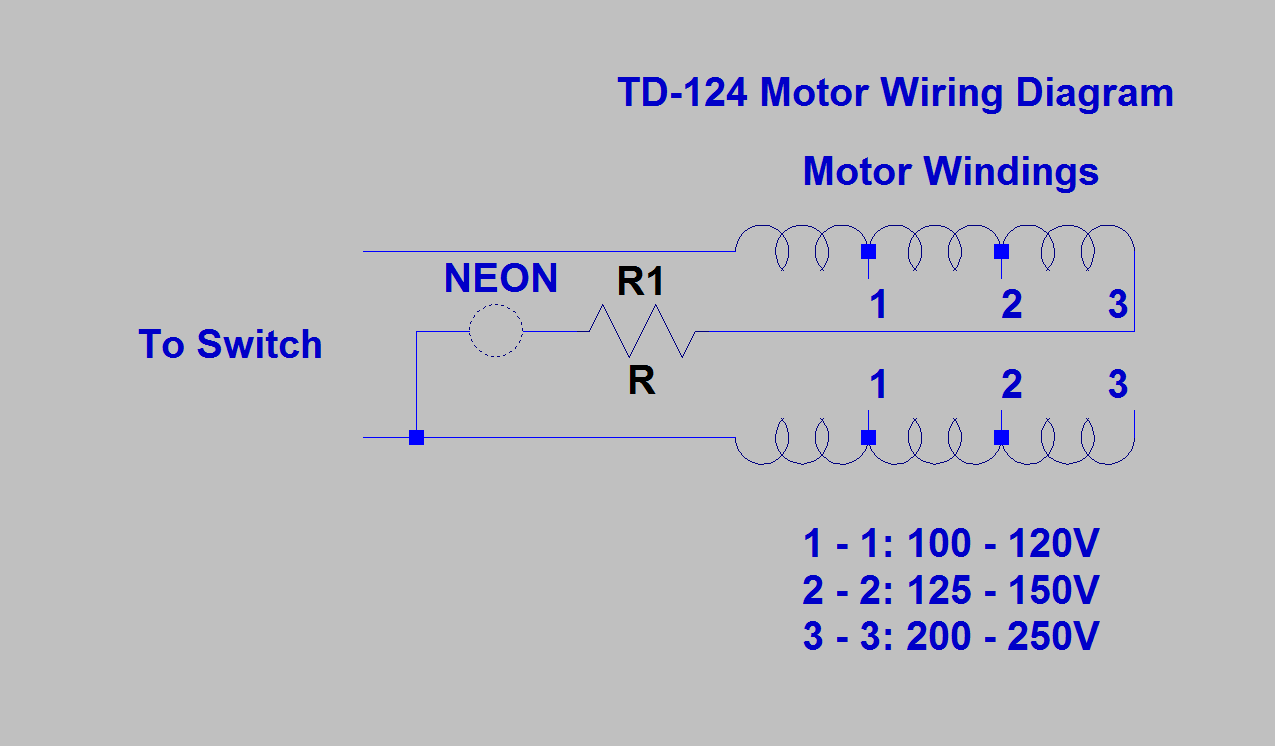

Nanook, interesting idea.. And I have plenty of variacs and a spare motor to experiment with once I rebuild it.. So at some point as schedule permits I will have a look at it.
I believe in fact that it would be possible to run one winding fixed and vary the other one +/- a few percent to see what effect that has..(Each winding independently end to end can operate from 100 - 125V)
The individual windings are tapped and connected in series at the taps selected for the required voltage operating range, but it is imminently doable without permanent alterations to the motor.
I posted some actual details regarding motor wiring on another TD-124 thread here: http://www.diyaudio.com/forums/analogue-source/223136-thorens-td-124-power-question.html#post3235028
This only works with the synchrone motor where you need a capacitor to get the 90gr.lead for the second coil then you can get much lower noise if you tune this .
I have done this for the Thorens TD160 motor with very good results.
The main vibration with the E50 motor comes from the ,,twice line frequency vibration, at your place 120 hz .
This vibration is always there and get influenced from the airgap between the stator and rotor, eccentricity of the rotor , bearing play etc.
If you carefull align the upper and lower bearings you can minimize it .
regards Volken
