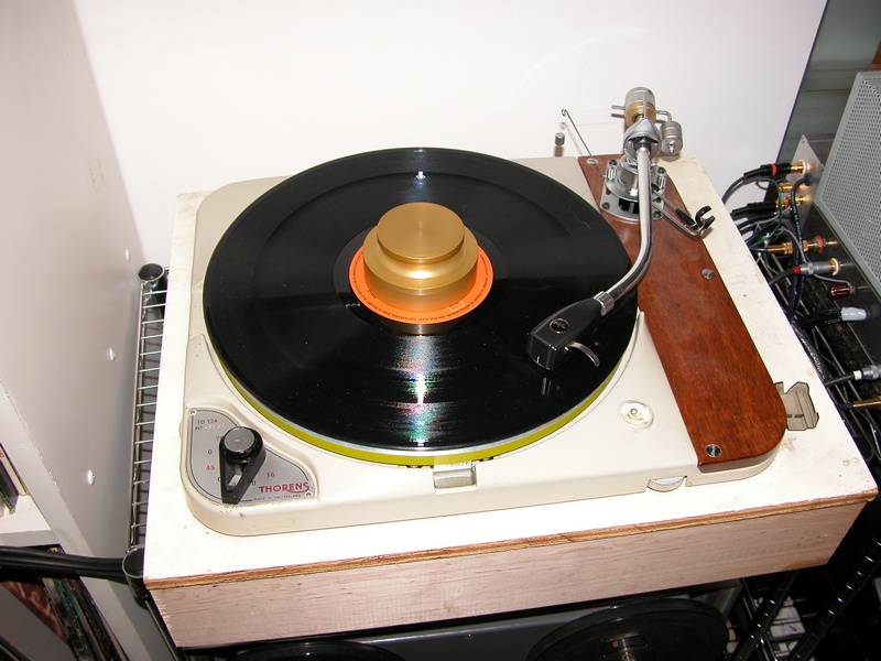

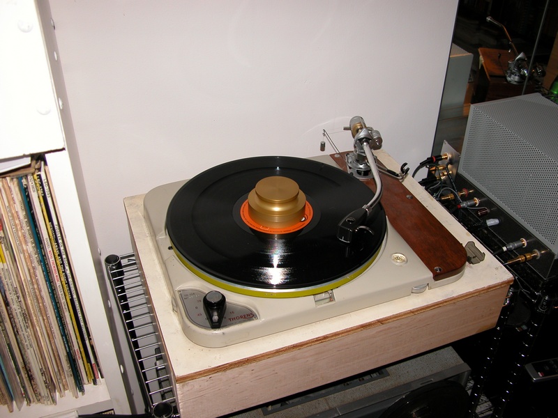

Rebuilt the motor today and happy to report the table now runs on speed and has been doing so for several hours now. The table after reassembly just refused to run at full speed, it was just slightly slow no matter what I did - even disabling the eddy current brake didn't help. The problem was evident on all speeds - pointing to the motor.
This is a tight budget project for an acquaintance so where possible parts are being cleaned up and reused.
The last picture shows the victim apart and the rivets retaining the bearing housings have been drilled out.
The first and second picture show the original felts in soak cycle 3 of 5 in lacquer thinner, and when clean and dry. The felts looked and felt pretty good after their soak in lacquer thinner, they were pretty hard from the oil gummy oil prior to soaking. I dried them thoroughly before impregnating them with fresh oil
The third picture shows filthy oil oozing out of the bearings in my dedicated workshop oven after being heated to 300 degrees F (149 degrees C), this was followed by a quick soak in lacquer thinner. Once clean they were soaked in hot oil in the oven for 10 minutes and then allowed to cool.
The fourth picture shows the upper bearing housing sans large felt, but otherwise ready to be reinstalled.
Fifth picture is the lower housing , six with lower housing completed, and seven is the motor reassembled. Make sure the bearings are aligned properly prior to tightening things down and check for freedom of rotation and noise (powered on the bench) prior to installation if possible.
The next to last is the victim being run in. So far running on speed for a couple of hours.

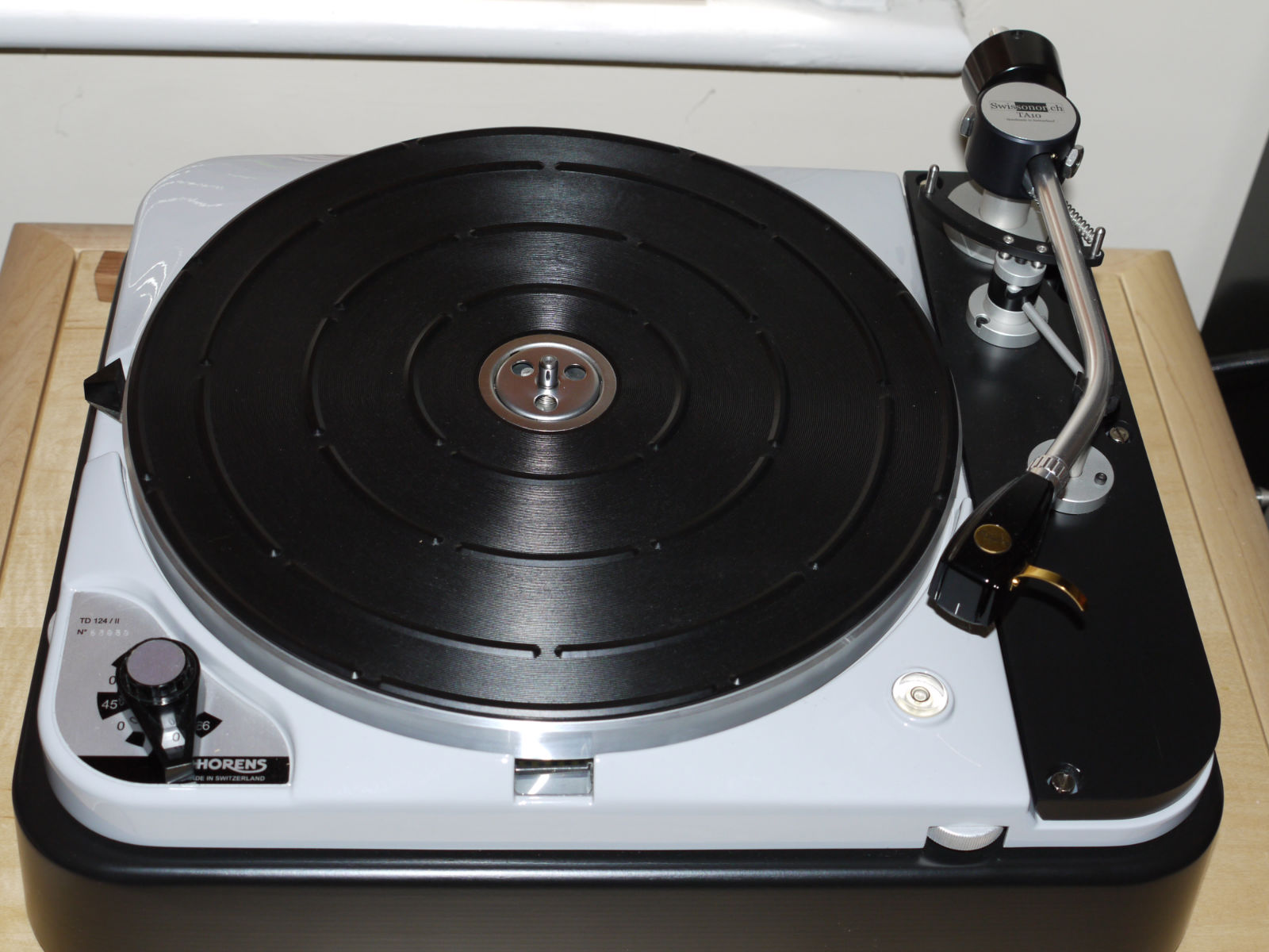

Parts replaced:main bearing; sub/lower platter and upper platter; solid plinth and Swissonor TA10in tonearm.
End result: tremendous pace, rhythm, timing and deep controlled bass.WOW.And a substantially reduced wallet...
Was it worth it? You bet.

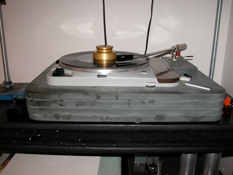

Surgery occurred yesterday afternoon and evening, I regret to mention that in all of the excitement I forgot to take pictures. The surgery was not entirely smooth, but concluded successfully..
I did in the proceedings manage to loose one of the balls from the speed setting detent mechanism, but for now one will suffice.
The only other area of difficulty was setting up the eddy brake adjustment knob and linkage where the inner shaft is about 100 mils or so shorter than required to allow the installation of the C clip with the knob bottomed. Turns out the slop is instrumental to the mechanism working properly or at all, took me a while to understand this, and a look at my TD-124/II confirmed this. So word to the wise - remove not the shaft from this knob if possible otherwise some iteration will be necessary. It also works backwards - I suspect I need to turn the linkage over. I will do this once I get a replacement ball for the detent mechanism since this has to come apart to install the ball.
The sharp eyed amongst you may notice I have an SPU GM E II on a 3009 Series II, no this is not an illusion. Adding an additional brass weight which a friend made to my specifications makes this possible, IIRC this weight weighs about 30gms.. It works well and sounds good.. (I'd recommend this bodged combo over anything else I've put on this arm.)

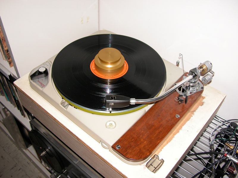

Not shown in the previous pix is my pride and joy ( :rofl: ) a very mint TD-124/II. It was almost as if it had spent the past 40yrs in a time capsule - which in a sense it had since it was in a console with a lid that the owner never opened after the very early 1970s.. 😀
The motors in these tables vibrate pretty badly, but the belt, good motor mounting bushings and a massive plinth keep the whole thing pretty quiet. Careful tweaking does help. Lots of torque comparatively speaking, when warm it is fully up to speed in about 1 revolution of the platter.

Never really bought the mass loading concept. Especially after trying to live with a Trio L07 for a while.
So, this summer at the prompting of a friend and the insistence of 20kg worth of slate in my basement i did some experiments.
Same result: hi-mass, slate, stone - definitely not for me, thank you. Robbing music of nuance, microdetails, tunefulness... Luckily i wasn't the one cutting the slate as it was one no-fun exercise.
What we ended up with was just an open frame construction, very stiff but still not particularly light. Polymer mushroom decouplings in the vertical plane and roller-block type couplings to isolate the horizontal movement and couple vertically the base. Best sound from a 124 to my ears.
