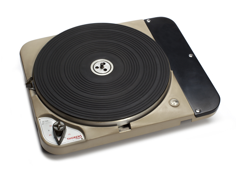

New to this group, and also chasing the rabbit on the TD124. Going to make this an "at it's own pace DIY project....
Serial number is 11,000 something, so guessing I've got a Mk.1
Hi Tonepub. Welcome.
Yes. The photo indicates a mk1.

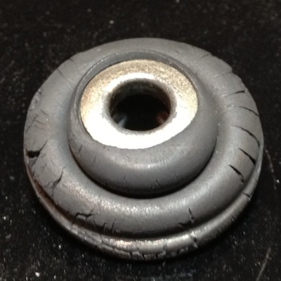

The mushrooms I have seen here in the UK all have been GREY in colour....LIGHT grey.
I suspect that these are not makers parts.
I have never seen one perished and suspect that stock mushrooms are some sort of modified rubber. ... but we don't get the temperature extremes which some of you experience.

Here's a more grayscale accurate photo of one of the mushrooms. While it was purchased north of Phoenix, chances are it spent some time in the Valley Of The Sun. It's quite common for it to be above 115 F. (46 c.) for much of the summer. In a storage locker, well the heat would probably kill you in under an hour!
