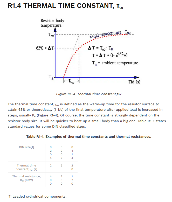

Getting back to thermal modulation: Does anyone have any ballpark thermal time constant data for CMF (or even more general purpose Yageo/KOA/etc 1/4W 1% metal film)?
How about a starter "back of the envelope" calculation for 4.5V, 360 Ohm, 20 Hz and CMF thermal characteristics or similar? I am fond of using "back of the envelope" calculations to improve the basic understanding of an issue.
It would be nice to have at least a basic calculation showing what order of magnitude the thermal modulation might be for a 1/4W metal film. Instead of going to 1k one could also look at 1/2W, 1W or 2W. Ti likely used 360 Ohm and other low values for noise reasons. But I have not seen a report of thermal modulation or more exotic resistors being needed for the PCM1794.

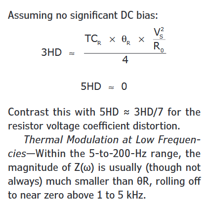

Very back of the envelope: a resistor with a 50ppm tempco will change its resistance modulated by 0.05% with a delta-T of 10C.
So if this is the feedback resistor, and there indeed is a temp modulation of 10C, you wont get very low distortion.
I know from measurements made by member simon7000 (unpublished) that at low frequencies temperature modulation can be measured. Maybe simon7000 can chime in.
I guess the slightly more difficult part of the calculation involves the thermal time constant and the frequency to see how much temperature modulation you will actually get.
See:
  1. Attached from the following links:
  2. Resistors – Resistivity, Thermal Resistance and Temperature Coefficient – Passive Components Blog
  3. https://hifisonix.com/wordpress/wp-content/uploads/2017/11/Designing_for_Ultra-Low_THD_N-1.pdf

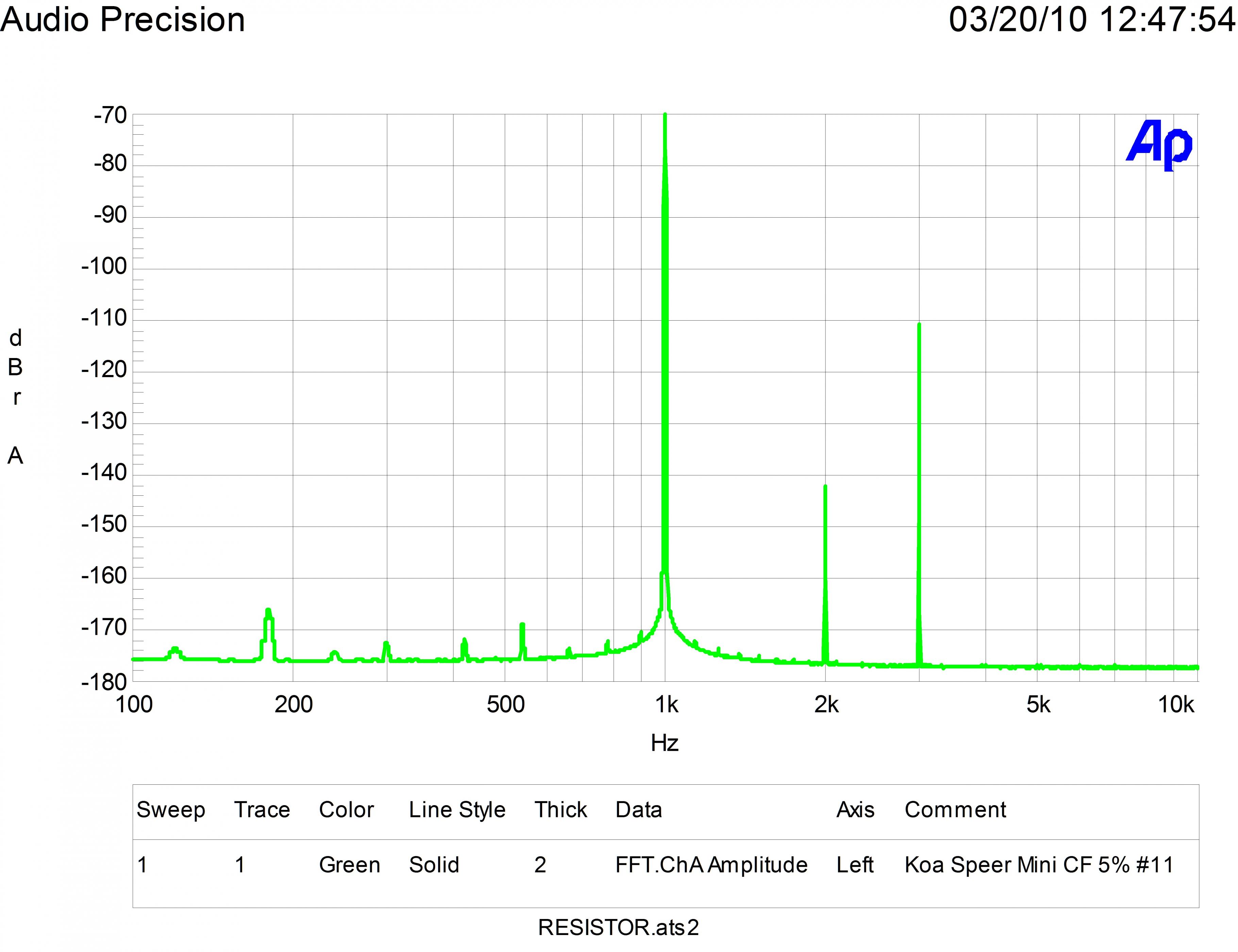

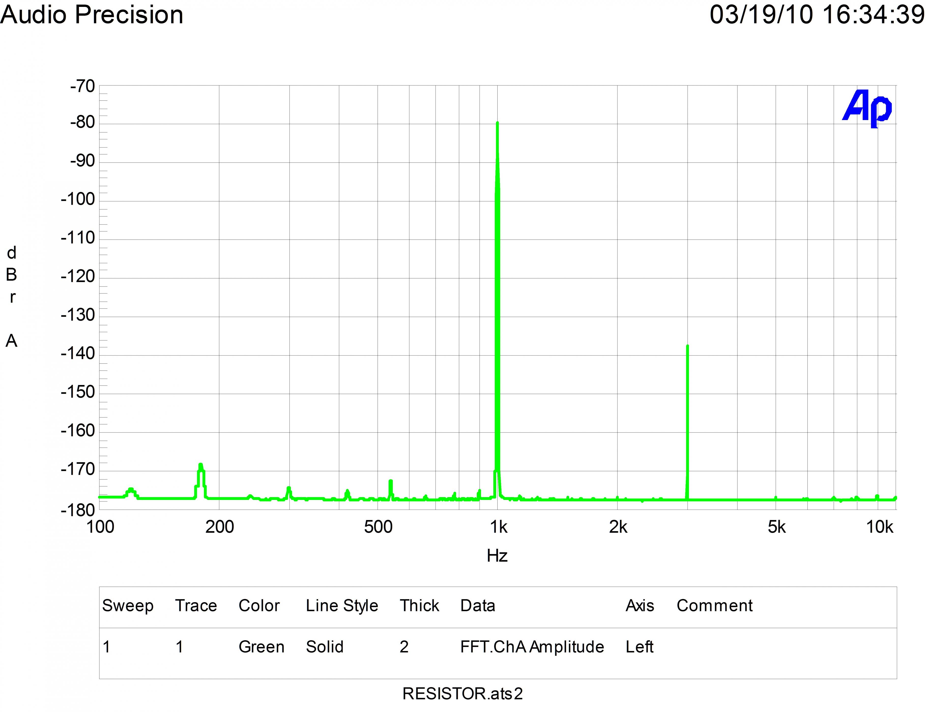

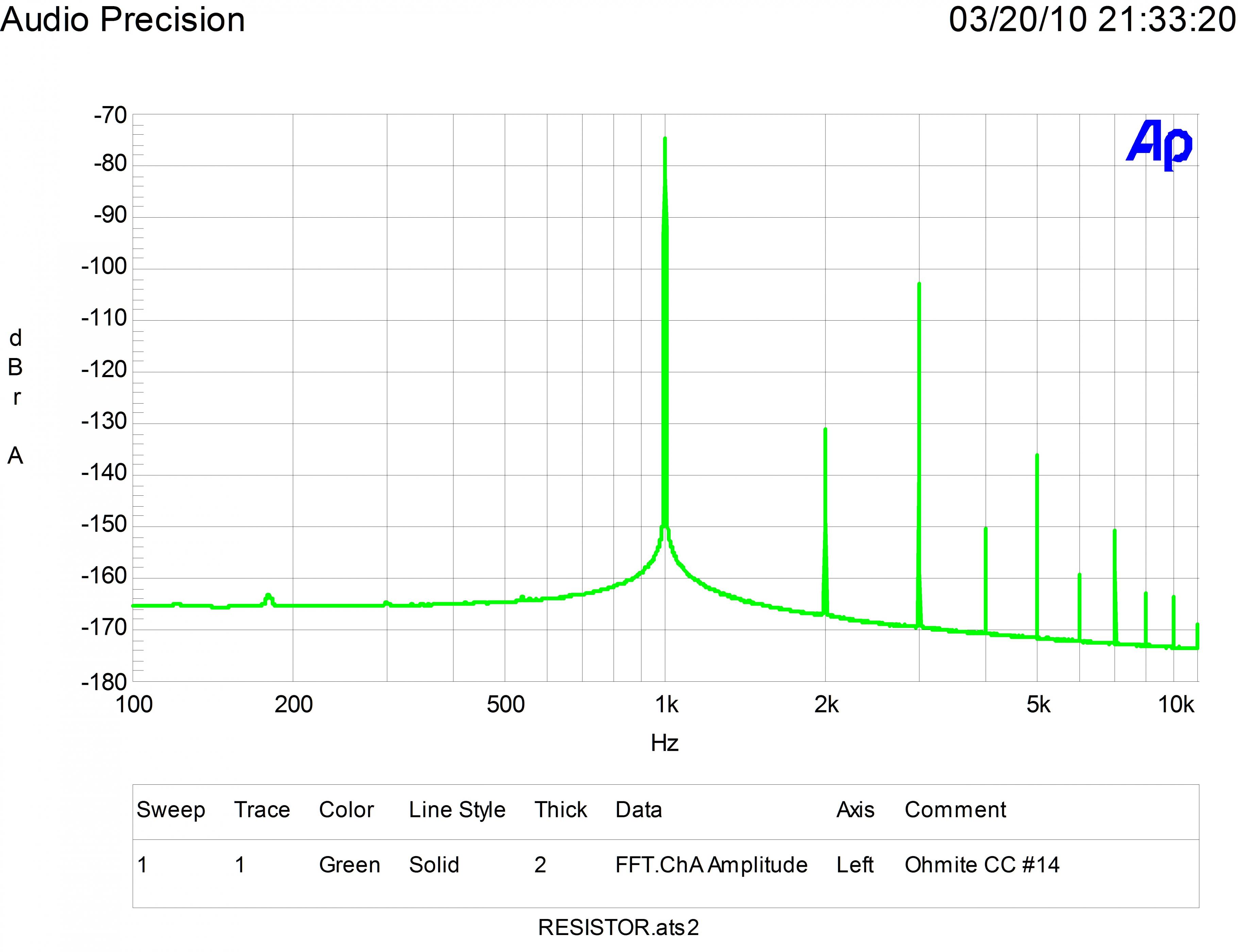

A few resistor tests. My standard method.

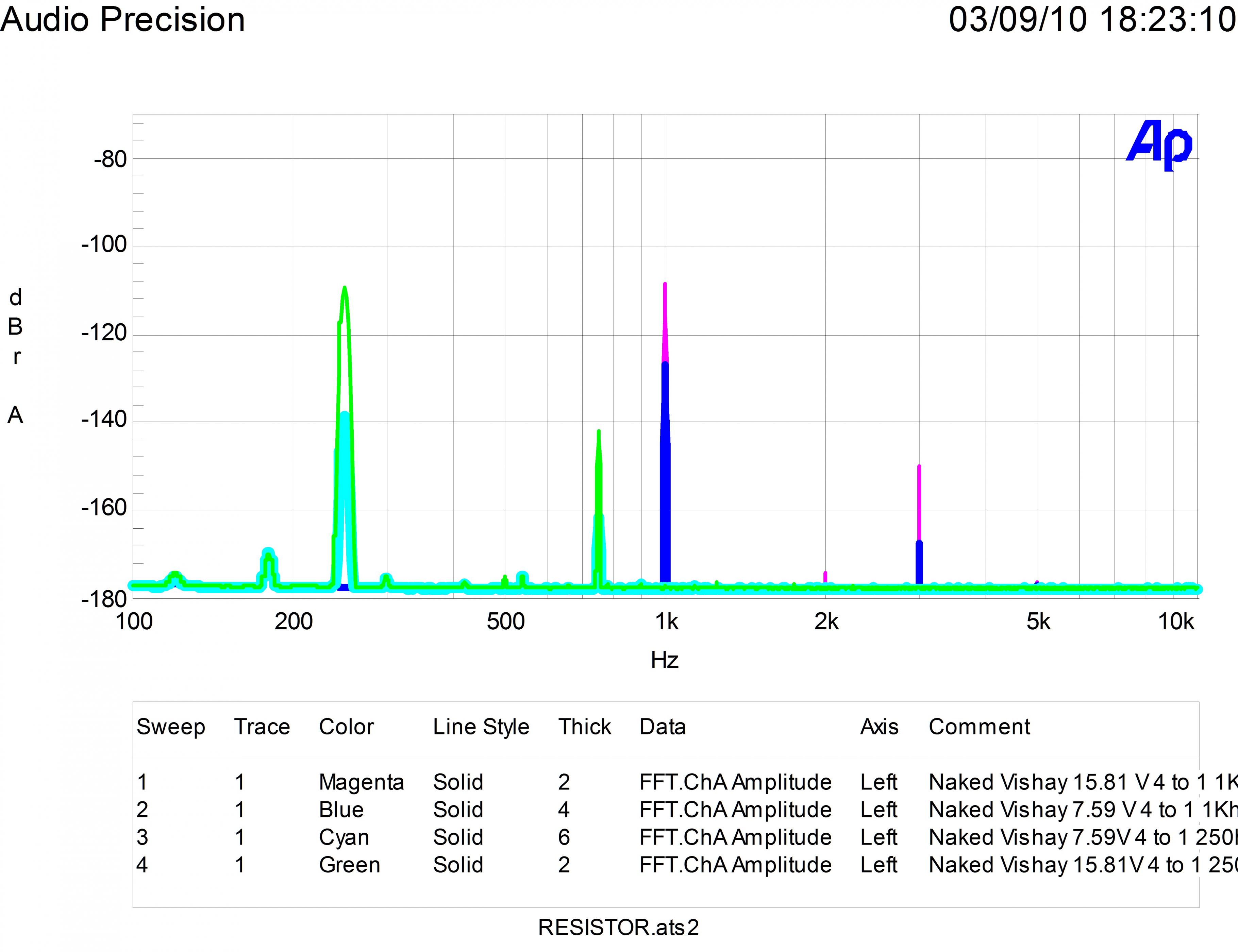

Ed, I was thinking about the measurements on the naked Vishays, wasn't there a clear thermal modulation? I will see if I can find it.
Found it. If you remember, I took your matrix of measurements and sliced it differently, with this result.
So you see that with the same level, but different frequency, the distortion is different, generally higher at some lf range.
(Of course, thermal modulation causes odd harmonics).
Jan

If the thermal time constant of the resistor is 10 seconds and the frequency is 100 Hz how much will this 0.05% modulation be attenuated?
Jan
That is shown on the first and fifth graph shown above. Also note in the last image as the power increases (applied voltage doubled) the distortion can go up by more!
